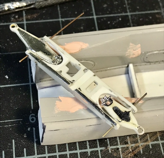

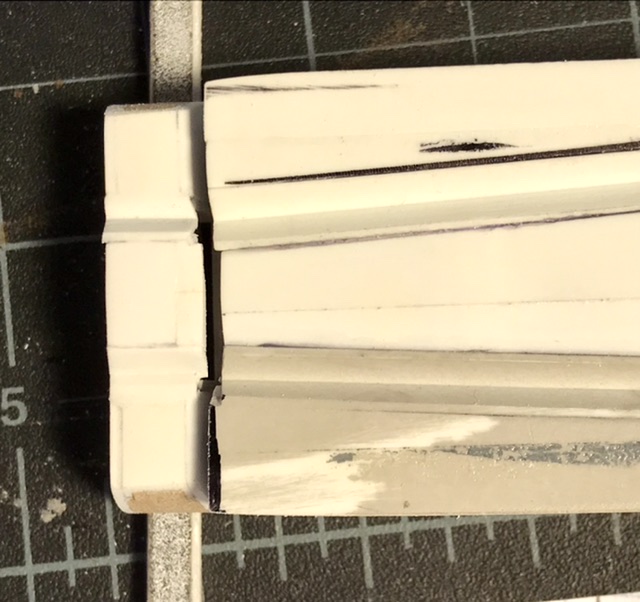

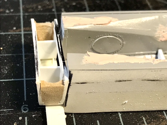

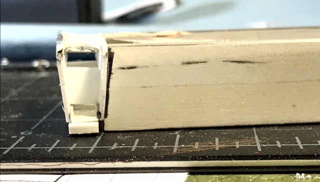

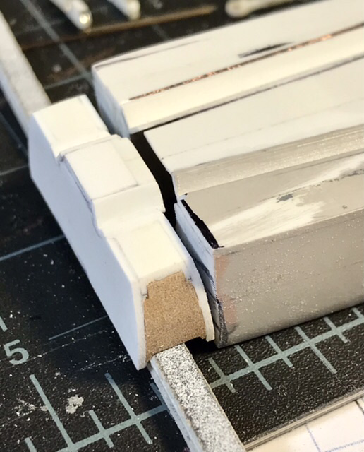

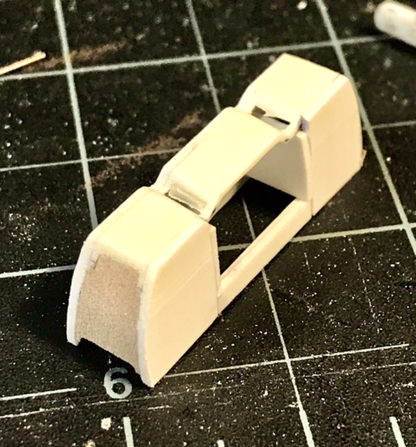

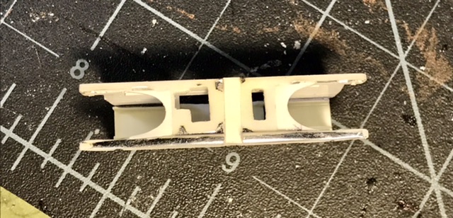

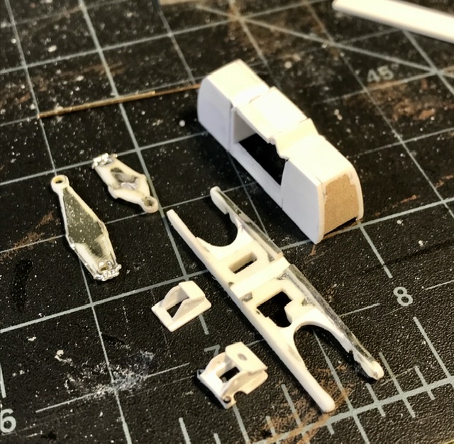

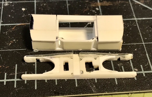

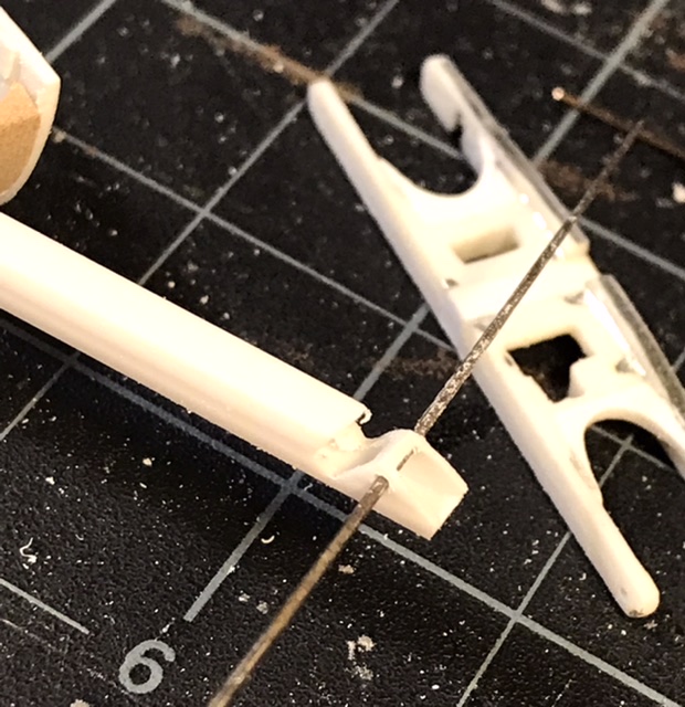

The cylinder heads on the Columbo 12 are, as I recall, 60 degrees opposed - the angle of the heads on the Reps and Mins block are perfect - or appear to be - so the sliver of black visible when the timing chain cover is held against the UMI cyl head tells me that the angle is not quite right on this part - also the left side cam box is too narrow - so this requires some surgery using .020 Evergreen strip …

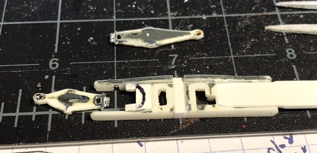

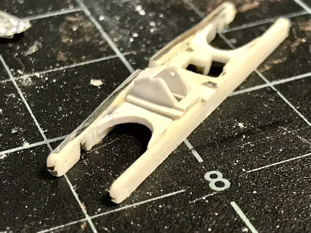

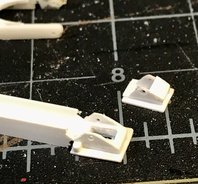

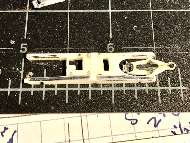

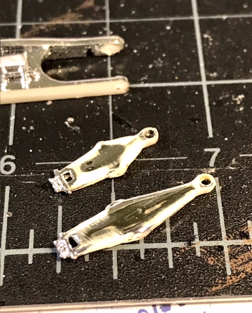

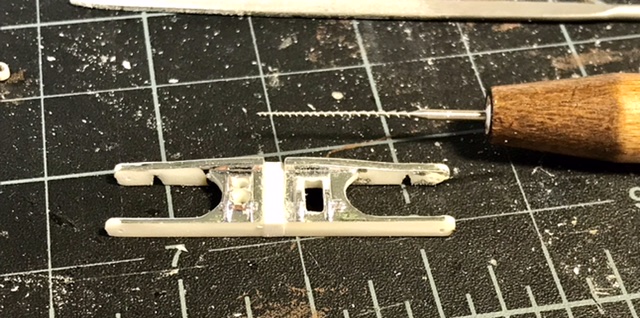

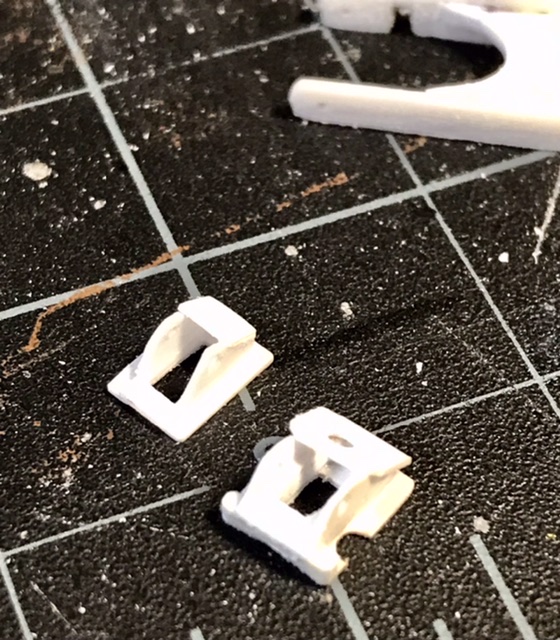

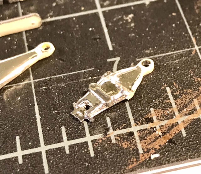

The motor mounts are cast on to the sides of the clutch housing on all of the Ferrari 12s - detached this part from the Reps and Mins block and will use it here - the Reps and Mins starter is quite good and correct for all of the Columbo 12s - so I’ll use it here.
Since I’m using the timing chain cover from the Reps and Mins castings I sawed apart the corresponding part from the GTO sump and attached it to the cover

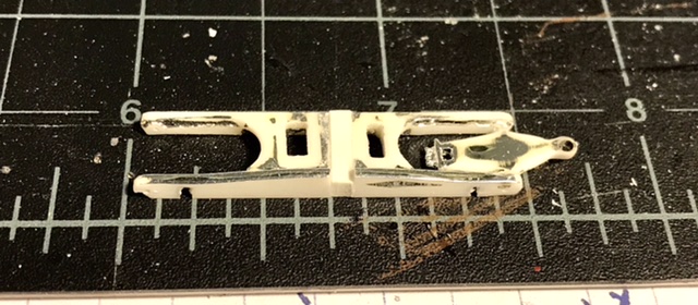

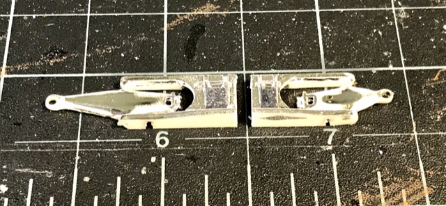

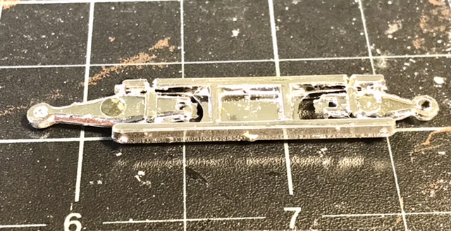

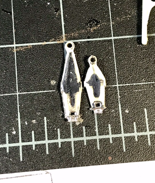

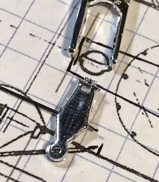

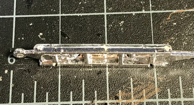

MotoR mounts - the factory drawing - and the mount on the Reps and Miniatures Columbo block - very correct - will duplicate this …

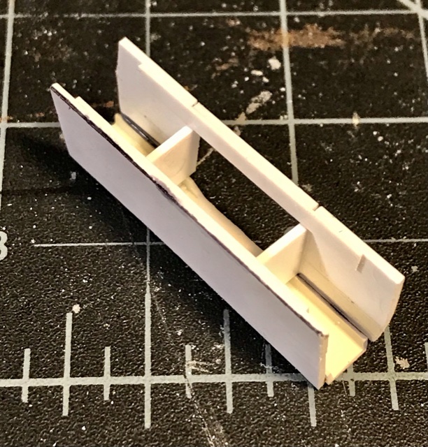

I’ve made the length of my engine block to match the GTO block produced by Reps and miniatures. This is scale 23 inches …. Just how accurate was the Reps and Miniatures engine ??
So I’ve modified the cyl head from the UMI Kit and grown the rest Of the block from strips of Evergreen … and improved the ribbing on the sump - Filing and sanding - and Tamiya liquid glue - lots of filing lots of sanding …
