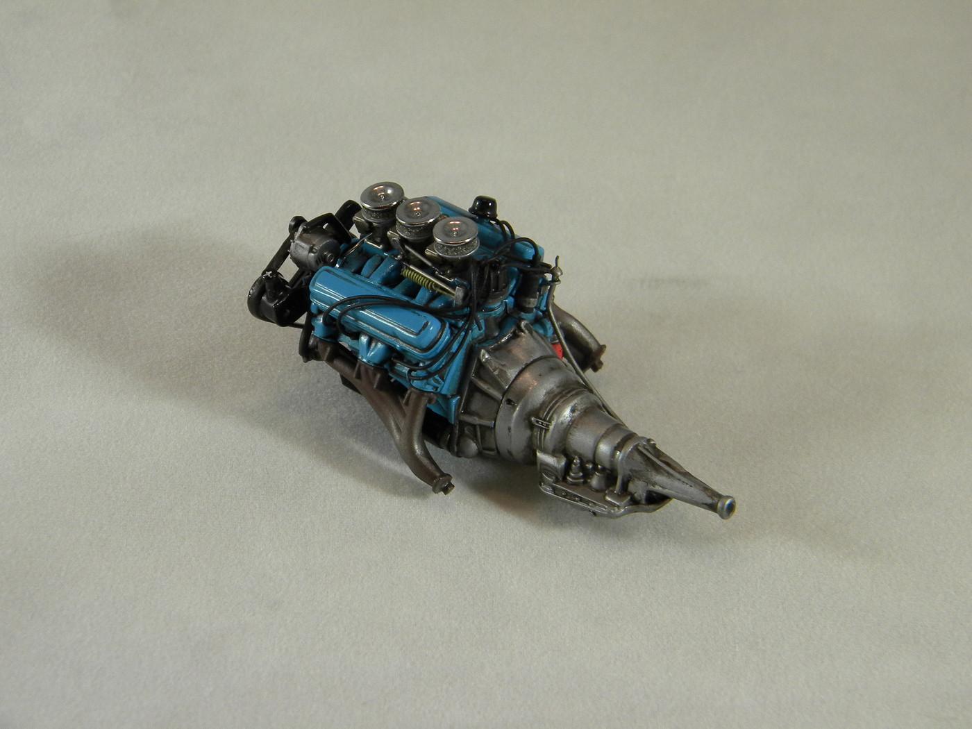

  1. Look at what Iceman has, I believe he has the 429 BOSS engine. I would be interested in the stock 429/460 myself. The closest thing I can find are the 390/427 ones. VCG resins makes a very nice stock 352.

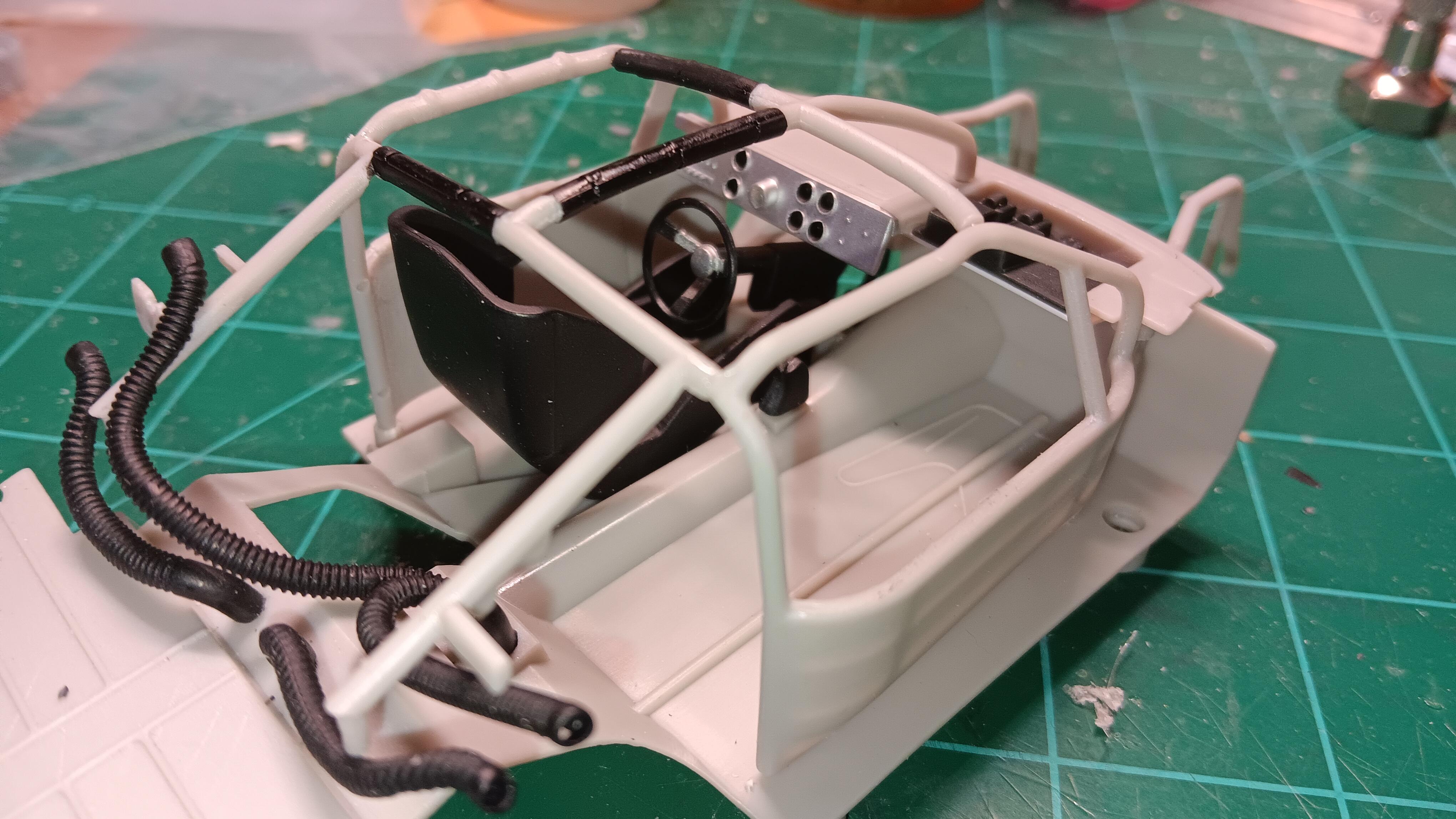

  2. I have an LED desk type lamp that is very bright. Anything I scrape the mold lines off I look at closely. Funny thing on round-ish parts like roll cages and axle tubes, from one direction it looks 110% smooth, look at it from 180 degrees and I see a ridge that will catch a fingernail.

  6. I like the nice FE 390 under the hood.

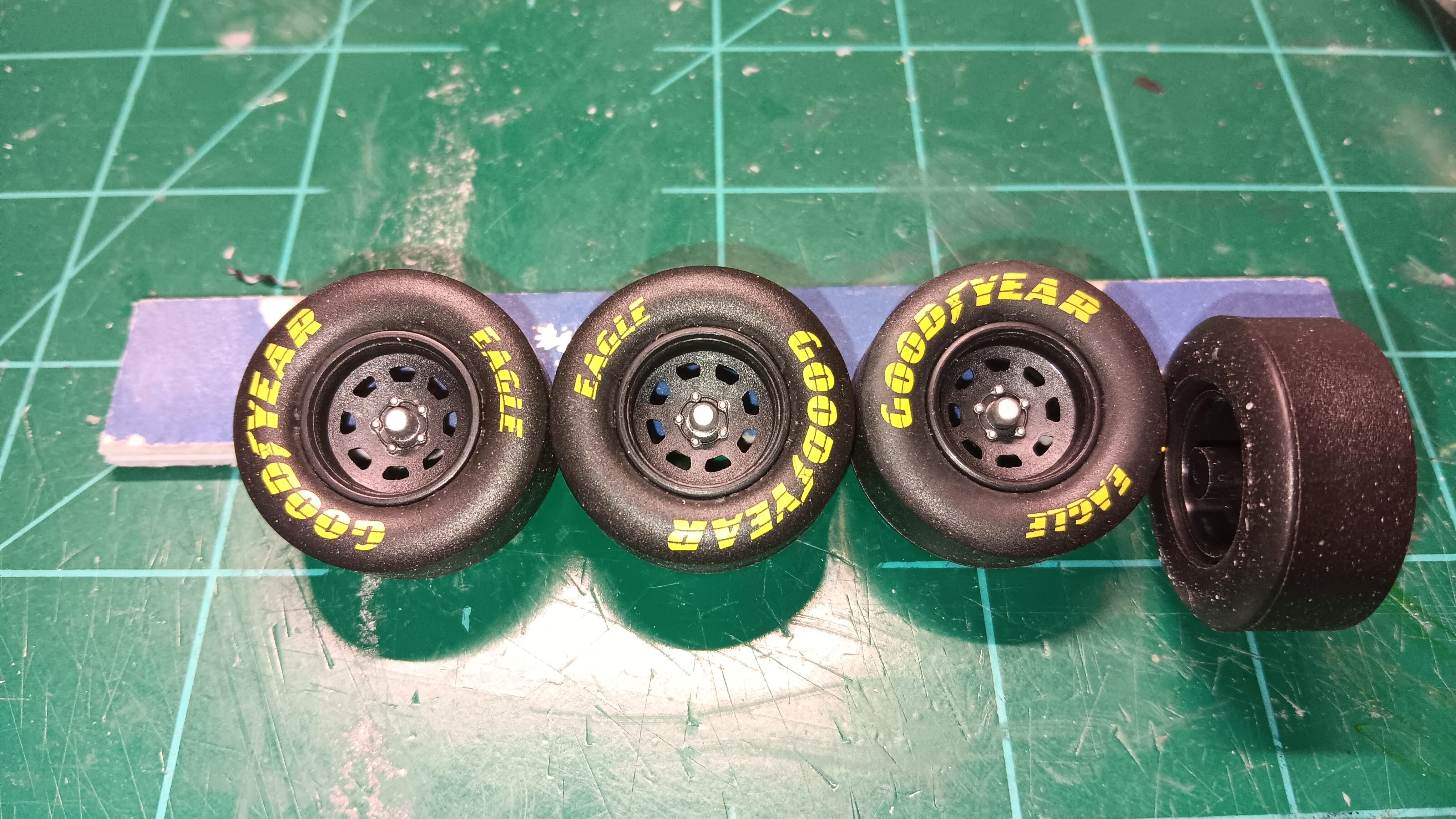

  9. The biggest asset we have in Ron is that he actually had a racing career. Which makes his parts more realistic and accurate. Just about nobody makes a lot of wide-5 wheel and hub options. I like his T11 and T19 tires too. On my '37 modified, I made those wide-5 wheels out of aluminum rod when I did have the use of a lathe. I used parts-box resin hubs. I do have CAD drawings of all my parts I have made up. I have a drawing for what I call a very accurate steamroller slick. Plans were to make the tread portion from PVC tube and the side inserts from aluminum rod. There was a place called Galtran, they made brass stud/nuts that added a ton of realism. They are out of business.

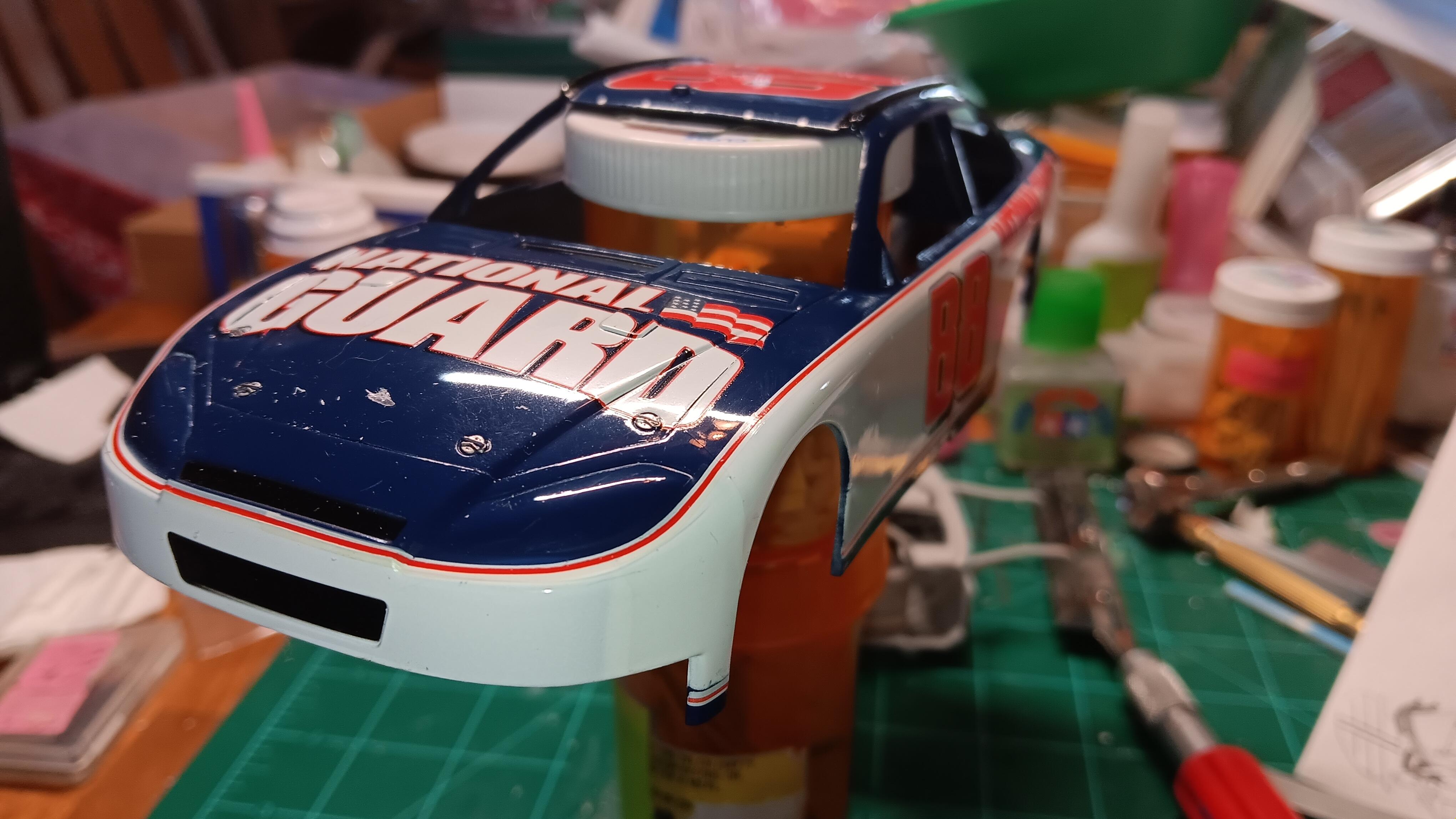

  10. I have used paper towels in the past, but paper holds the tape better. Maybe a paper towel under the paper next time. On this build, I ran into too many late-stage issues and did a lot of unplanned handling of a near-complete car. Something to avoid in the future.

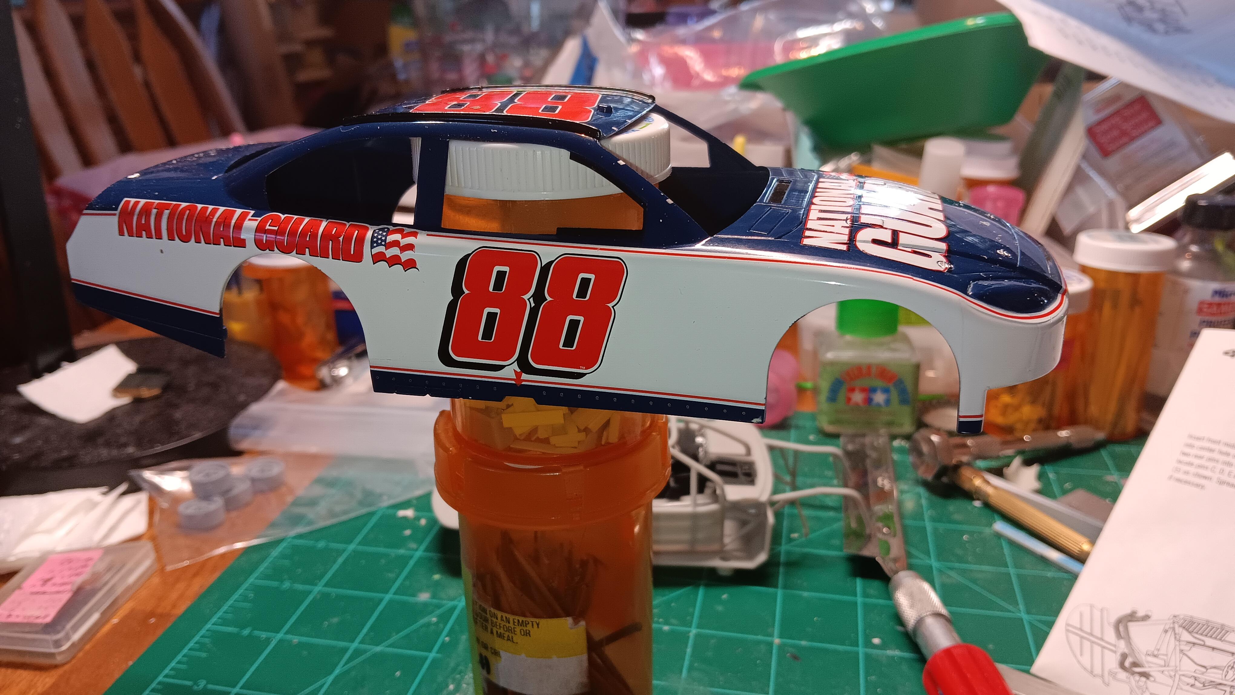

  14. Sometimes I do the roof decals last. But I did them already on this one. The roof takes a beating during assembly. I simply tape a piece of scrap paper over it with Tamiya tape, applied lightly. The car has to be close or completely done before I remove it.

  18. I use them a lot. The trick is to use parts box wheel backs that fit inside the wheels. On this I used some backing plates that fit perfectly ?. On the fronts I used 1/8" aluminum tubing and stepped up 1/16" to 3/32" tubing on the axle. K&S telescoping tubing is amazing stuff.
