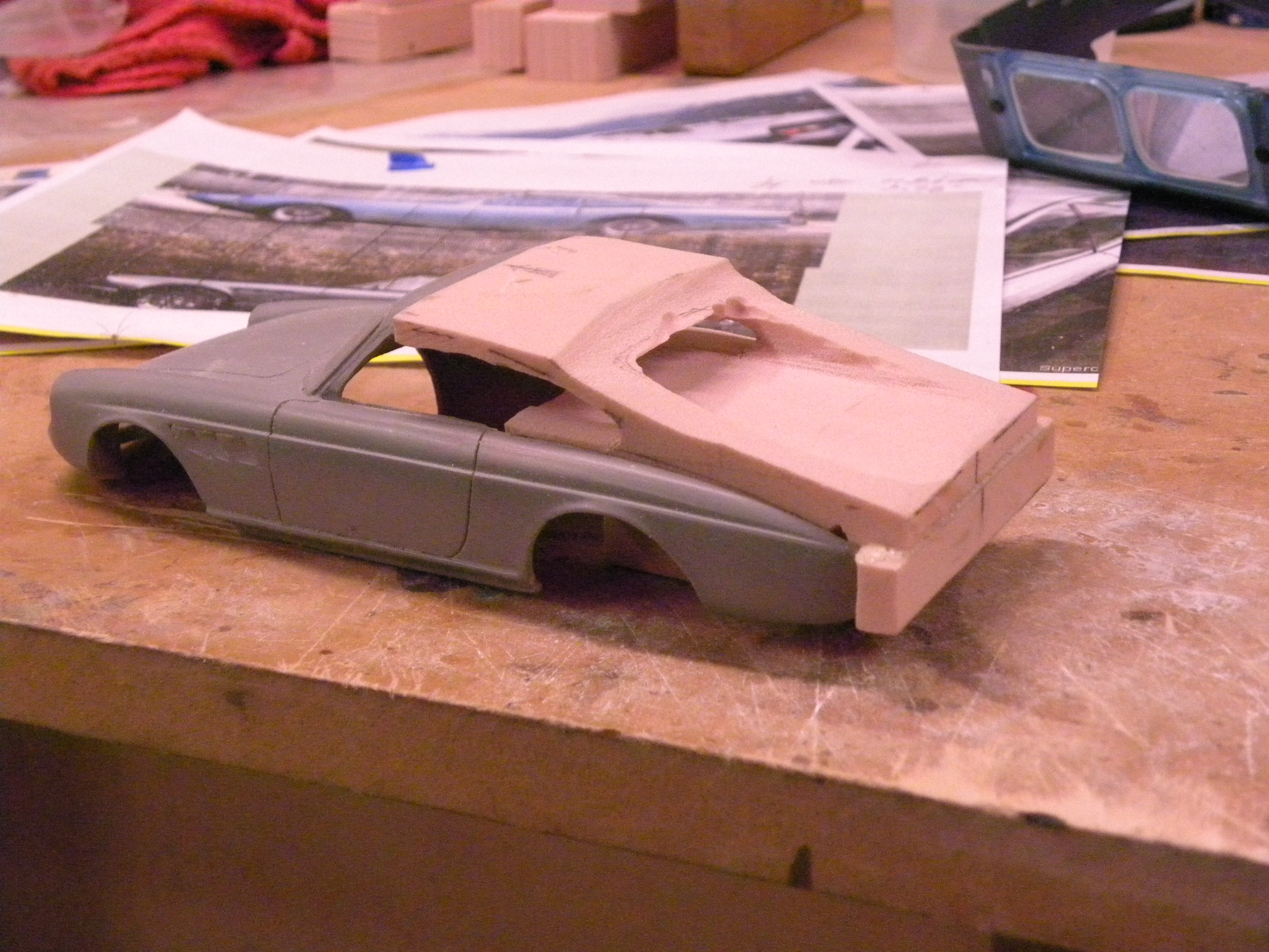

  3. Putty time. I use Aves Apoxy Sculpt: https://avesstudio.com/shop/apoxie-sculpt/ It has a long working time and is easy to sand and takes paint very well. Slow setting time, about 6 hours.
  4. When I build, I build to last forever.
  5. The Thrill has a prominent beltline running rather low, and forming the tops of the wheel openings, which I'm replicating with a strip of .040" glued and pegged into the body.
