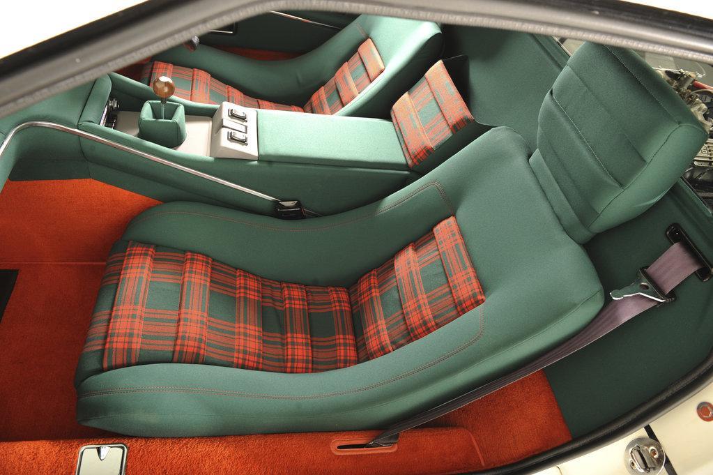

  7. The Spy Who Loved Me - Lotus Esprit S1 Hi guys. Slow progress for me, but a milestone reached in (finally) finishing the interior. All brush painted with plenty of masking tape. I’ve included a reference pic of a standard S1 cabin that would’ve been fairly close to the one in the movie, although the film footage was altered in post-production making the fabric appear charcoal grey: I chose to straddle the fence with my colour choice! I’m going to finish up the chassis next because the body has just been dunked in a brake fluid bath prior to starting again!! Keep up the great work folks ?

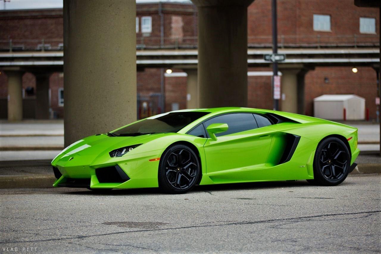

  12. I already have two other projects in progress but I’m starting this because I want to get another body shell sprayed while the weather is still warm. (I use rattle cans outdoors and things can get a bit tricky here in the U.K. in the winter months). I’ve wanted to do this one for a while now but waited to develop my skills a bit in order to do it some kind of justice & reduce the risk of mishaps. The moment has arrived! It barely all fitted in the box! Twice as many parts as I’ve been used to but looks amazing. The goal is to turn it into something resembling this: Controversial colour choice but I thought long and hard about it: the car is so exotic & spaceship-like that something a bit outrageous seems to fit. I’ve chosen Tamiya candy lime green which has got more flake in it than the above, but it’s pretty close. I’ve watched a number of forum and YouTube builds in preparation, which is just as well because the thing is relatively complex for me and it would take me forever if I just had the instruction sheet. I started with identifying, detaching and tidying every piece that is going to be body coloured. This task would normally be fairly quick but, with all the bits and treading carefully, it took me an evening. How much of it should be assembled before paint and how much after? When researching, I couldn’t find two builds the same here, so I elected to keep the tradition going! A major fork in the road was whether to attempt the opening doors. It would be great to have an interior easily accessible to show off all the hard work that normally gets entombed, but, having observed the experiences of highly proficient modellers, the risk of getting towards the end of the build and discovering the doors don’t fit properly is too high for my liking. Essentially, I have gone for maximum pre-assembly. This even includes the wing mirrors: a copied idea which appealed to me because putting glue on to a finished body brings me out in a cold sweat! The gluing took me another evening, followed by another sanding-out mould lines/surface prep and scribing panel lines. Then, just as it was ready for paint, I noticed small-but-unwelcome gaps on either flank above the big side vents. I was able to close one with just some pressure and quick-drying cement, but the other side needed a dab of filler and leaving to dry. Delayed another da, but pleased to catch the oversight in time. Wet sanded everything with 1200 grit. All went quite well but I discovered that, owing to the fact that panels surrounding the lifting engine cover have some play in their positioning, the cover is going to be a touch more snug than I would've liked by the time it's fully painted & cleared. I did a bit of (very minor) sanding & touching up to try & mitigate this, but I didn't want to risk messing with size/shape to any real extent. Anyhow, she's ready to go green... Thanks for looking ?
