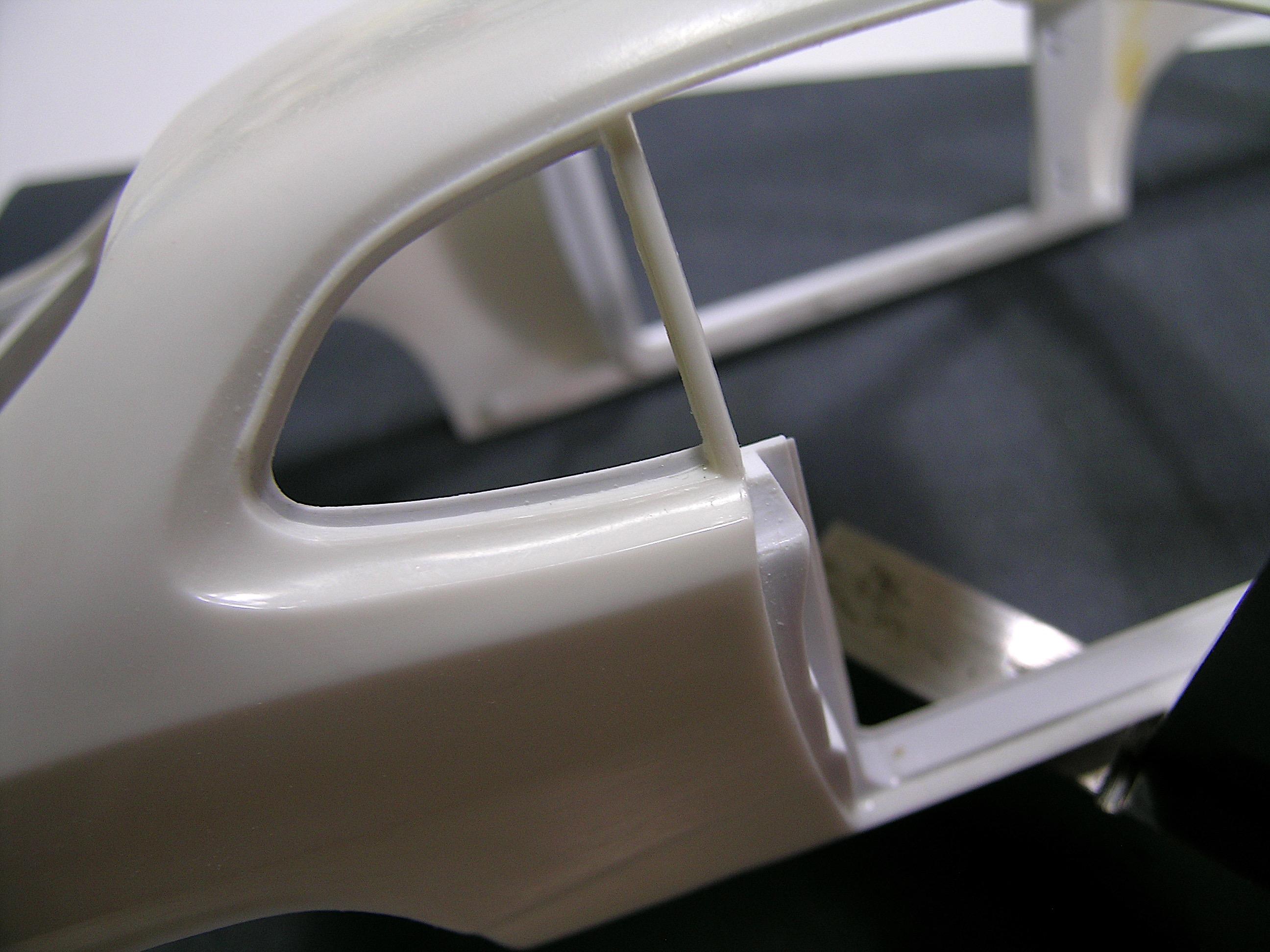

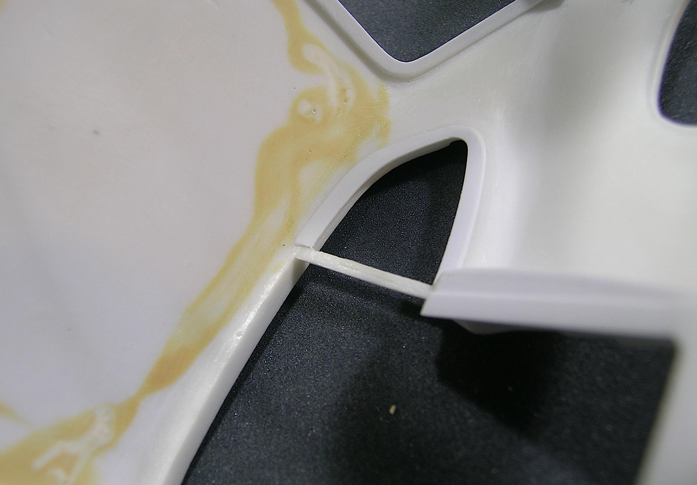

Hello everyone, This is my smallest update to date! I didn't have much time on the bench as I was forced to make an unexpected purchase that took up most of my weekend. Basically, I've started making the interior rear panels now that the door structure is complete. These will be glued to the body, the floor pan and the rear fender tubes (which are glued together) will fit together in the final assembly. Since I'm into this kind of fabrication, I intend to make the roof reinforcements to give continuity to the whole. The inside of the body was a bit damaged by the glue that held the windows, so this will be a good way to hide some of the scars left behind. I won't do all the details of these but I want to create a light car look with a partially emptied interior. Anyway, this will be a first for me and I will improvise as I go along in the making of the components, photos of this kind of detail are rather rare as you can imagine. Comments and suggestions are welcome. Francis I copied the radius of the rear wheel tubs onto a sheet of .020" styrene. I then cut and sanded them until they fit perfectly. I glued a strip of styrene to give them rigidity, these were sanded to fit inside the body before gluing them in place. This is what it looked like before I glued them in place for good. Of course, I used the floor pan to get the right position to glue them to their final location. Before I couldn't do it anymore, I had planned a seat for the rear windows but I had omitted to show you this because I found it rather simplistic. The hardest part was engraving a seat so that the syrene piece I added would fit into the roof. Seen from the outside, I'm thinking of moving and redoing the rear window support which should be closer to the side windows. Obviously they must be thinner than that, I am thinking of a solution... ? -

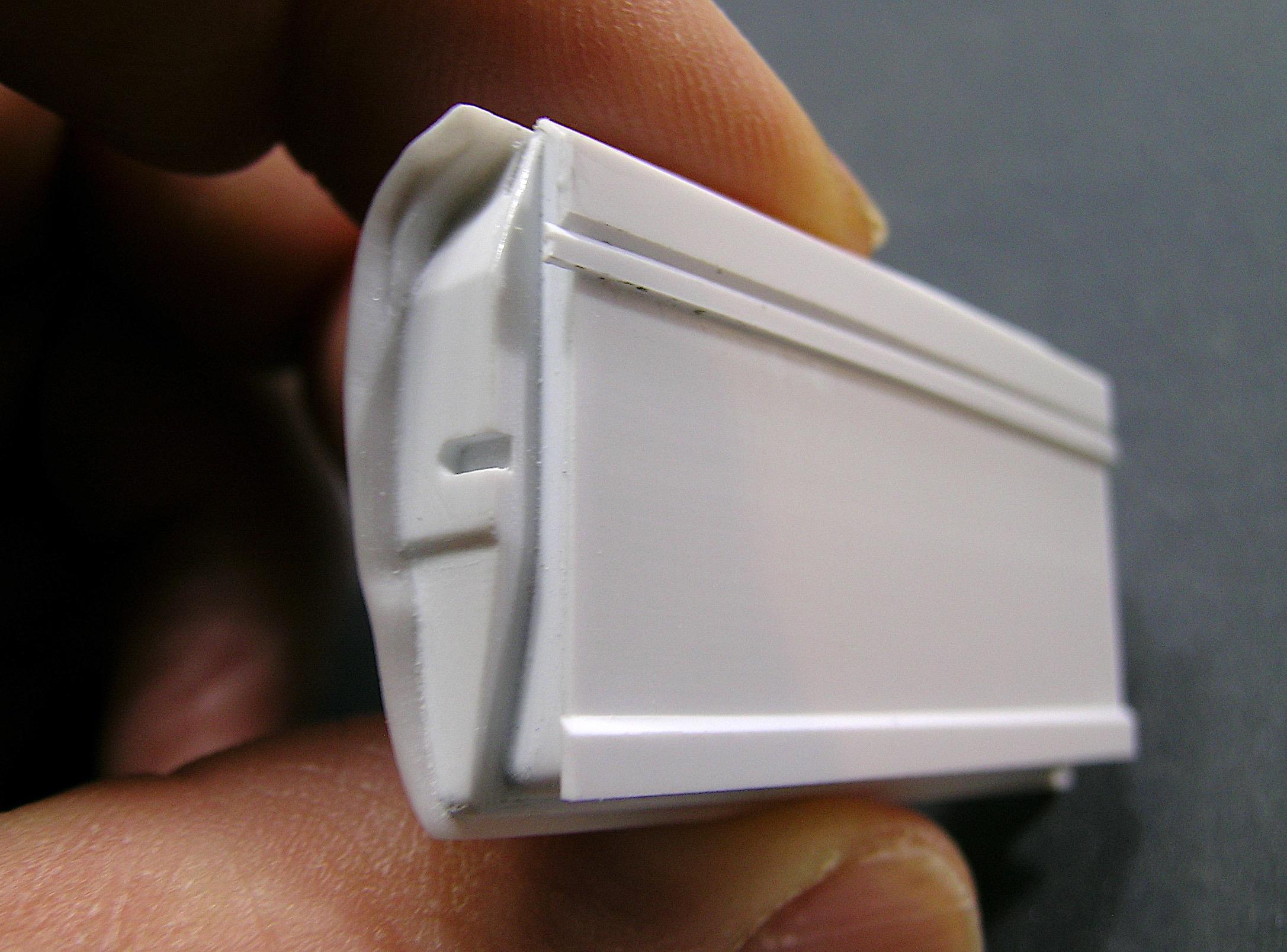

Hello everyone, I've had a lot of reason not to move forward lately because there's been a lot of action in my life. It would take a long time to explain to you but this site is not made for that so I will limit myself to saying that I hope that everything returns to normal soon! On the scale model side, I have almost finished the details of the doors and I will have to add an aluminum panel as interior trim, make the handles and the window cranks. For the latter, I will probably proceed later because I have to concentrate on finishing the structural components. The photos are in order of construction progress so it speaks for itself. I planned openings to insert side windows but it is not yet certain at this stage that I will put them in, at least the slots are there, that adds a little to the details anyway. I added a lot of bracing that will help support the panels on the interior side of the cabin. I hope you like them, I think they are my best so far although I haven't done many before. ? See you next time with more progress. Francis I used styrene strips to try to recreate the shapes of the doors on the interior side of the cabin. After a bit of sanding. I will add a thin aluminum panel as trim. Again, the dime is not to promote the Canadian currency, but to get a good focal point, this is the best trick I've found so far! ? -

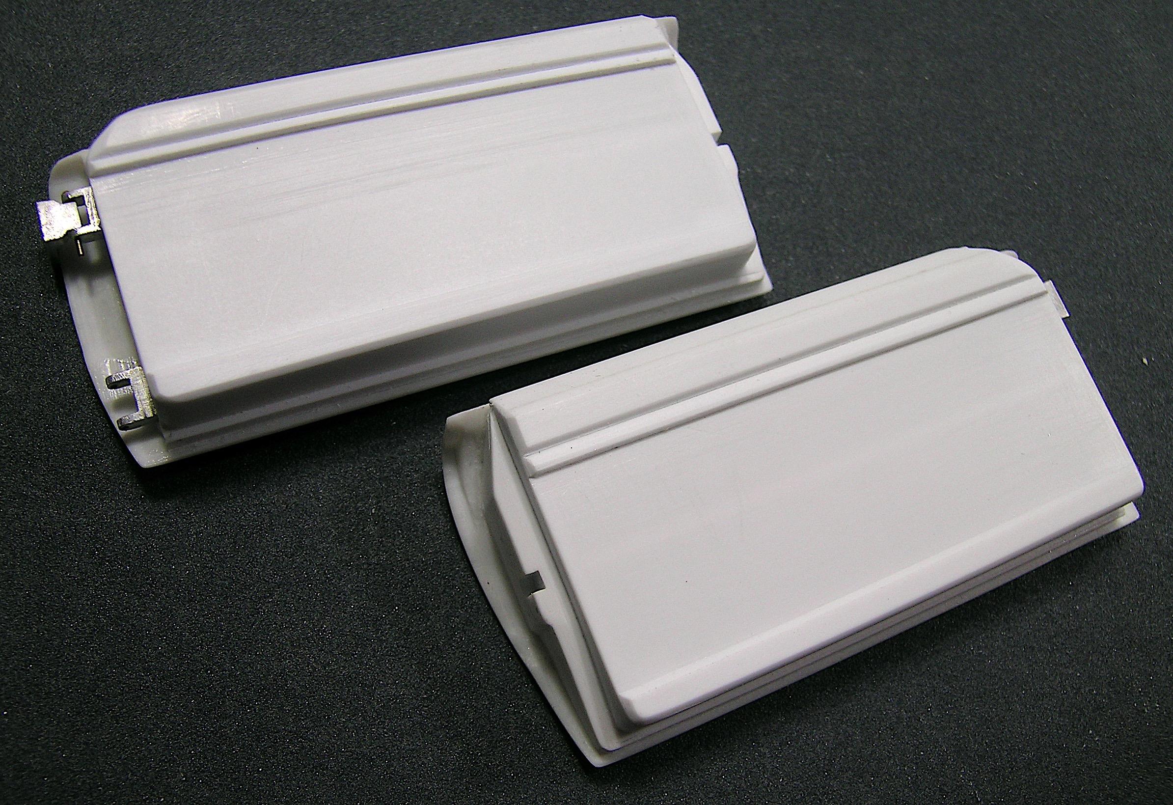

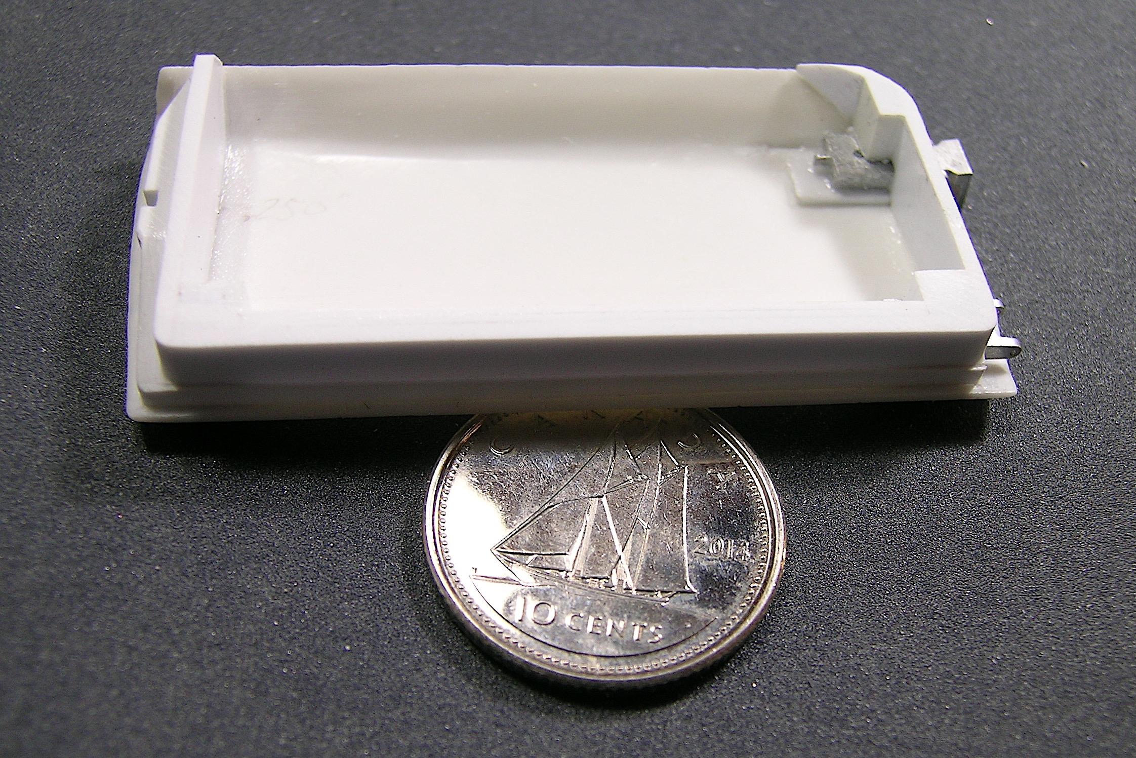

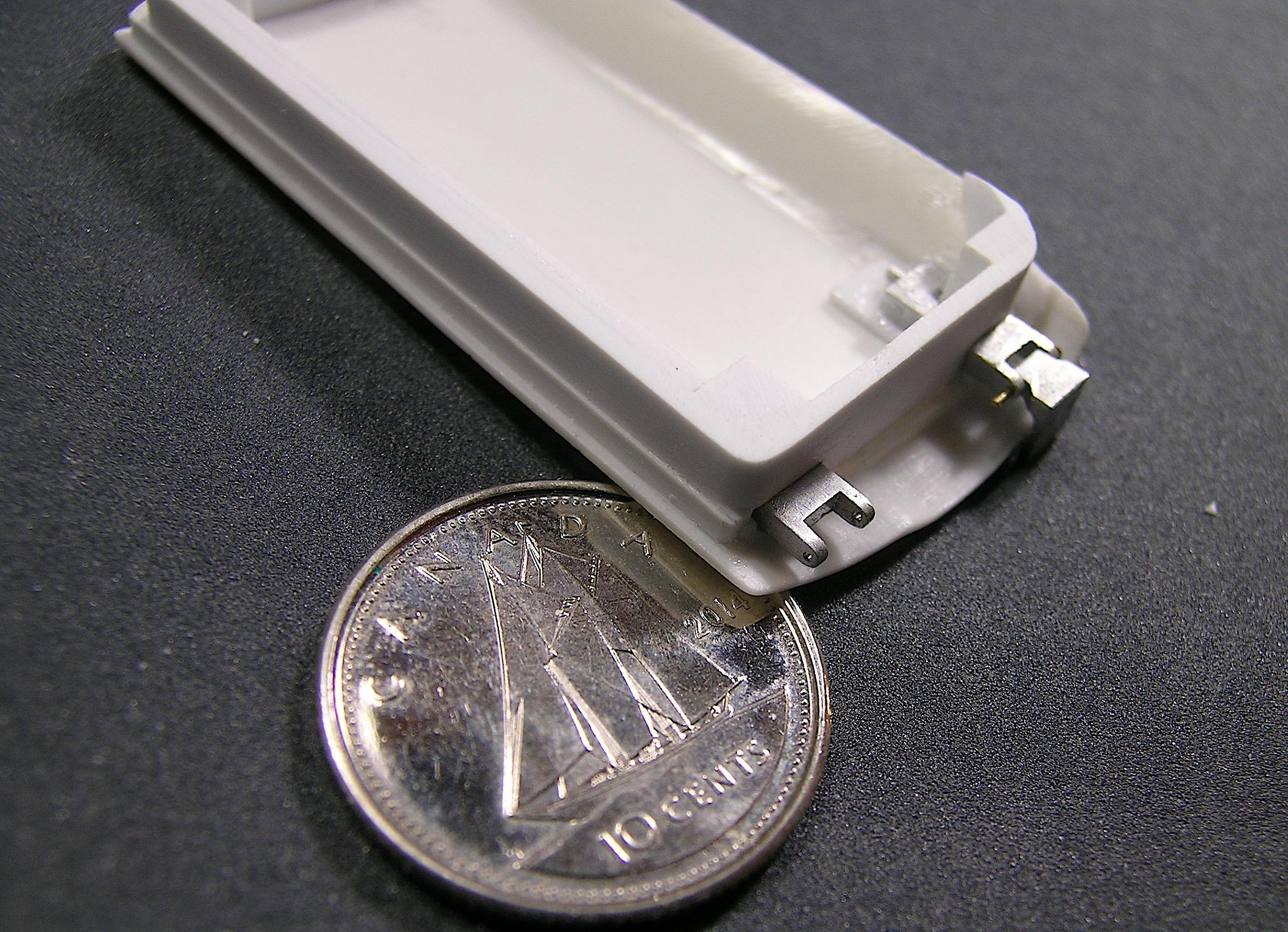

Hello guys, I finished the second part of the hinges and did a test to see if they will work as I planned. It should be fine but I have to admit that there is not much space left and the thickness of the front fenders must be as thin as possible not to interfere. When the details of the doors are finished, only the end of the hinges will protrude and will be visible, the rest will be used to glue them inside the door. It's not easy to adjust the hinges on a real car so I chose this easier way of doing it because I couldn't see myself trying to mount the second part on the walls of the doors, the adjustment would have been nightmarish. Now I can finish the door details and continue with more work inside the cabin. I'll be back soon with more updates. Francis Second parts of the hinges being machined in the rotary table. Temporarily installed with brass bolts to verify proper operation, I will use smaller bolt heads of course. The hinges can open 90 degrees but the door will limit the opening once in place. It's pretty simple, but it works... It's not over yet but it looks promising! ? To give you an idea of how they are fixed inside the doors. I will take better shots when I do the fabrication of the door walls. -
