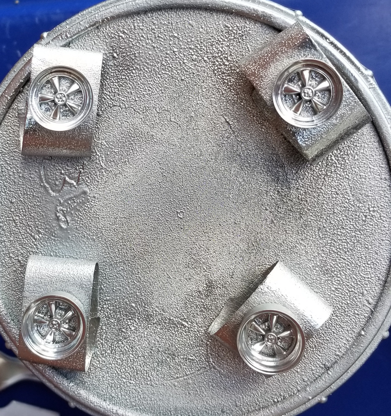

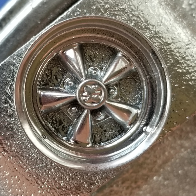

Black Chrome Wheels
TransAmMike replied to TransAmMike's topic in Model Building Questions and Answers
So Anthony, which picture is the black chrome because if its the top one it just looks black, really hard to tell if it has the chrome look. -
