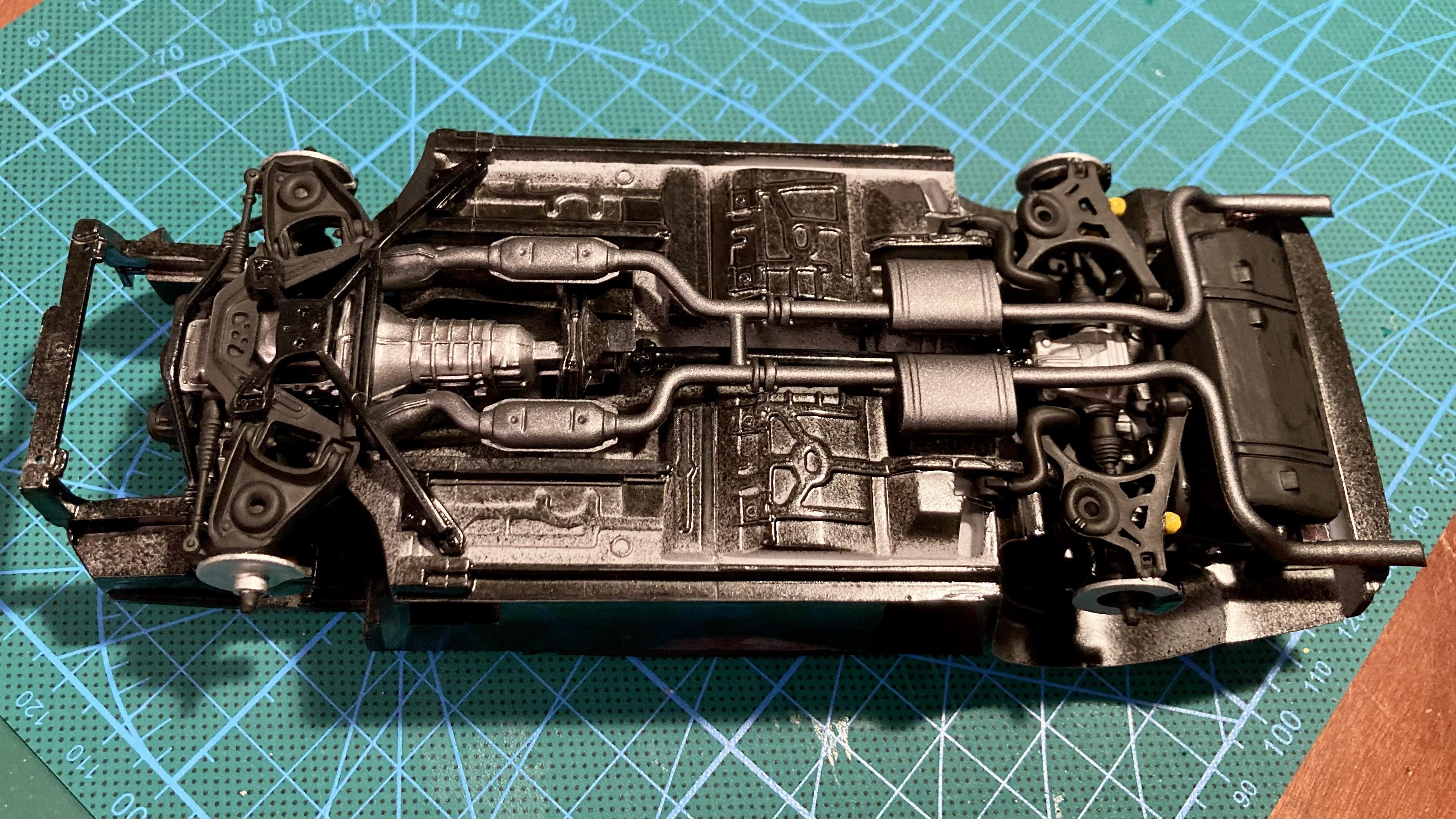

  13. I’ve made some progress, primed the body in pink to help cover the red plastic parts. At this point I was still leaning towards red or yellow but I decided to go with black. I should have done another primer coat in gray or black, because my black gloss coat didn’t flow into the body seams so now there’s pink showing through. I’ll try a black wash in the seams to cover it I guess?I’ll have to wet sand and do another color coat anyway so we’ll see how it goes. I might have to strip this one and start over. But I’m loving the triple black look so I’ll see it through!I did prime the chassis in gray and gave it a black overspray coat. Interior, chassis and drivetrain parts are painted and curing in the dehydrator. Detail painting to come!

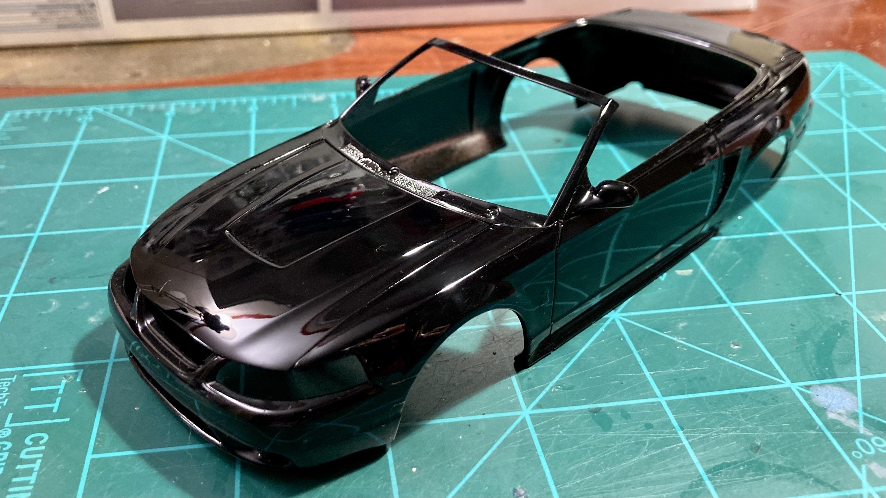

  20. Another update: the body mods are done and it’s ready for primer! I haven’t set up my paint booth yet after my recent move but hopefully I’ll get this primed and painted soon.
  21. Windshield frame is complete! I managed to get it cut and sanded without any more damage to the A pillars or header. I did manage to crack the windshield itself while trying to polish out a glue blob. Luckily these kits are $13 at Ollie’s right now so I grabbed another. I’m probably going to use all of the parts (except for the body) from the new kit instead of trying to save my old glue bomb parts. The ‘99 windshield does already have sun visors molded in so that’s a nice detail I won’t have to come up with. Plus they give a place for the up-top to rest on.

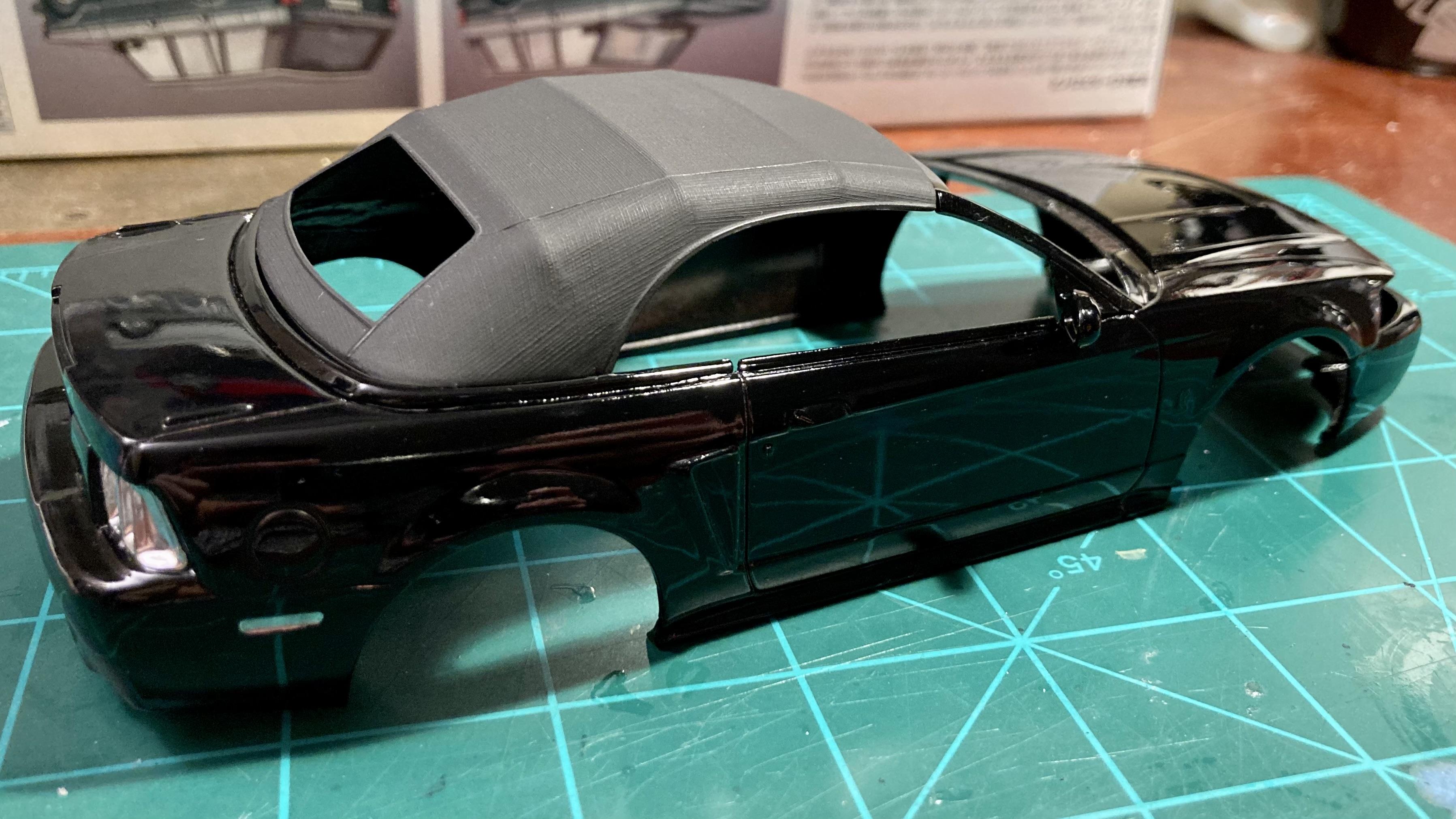

  24. Some progress! I got the paint stripped and some sanding on the body. To give the convertible roof trim somewhere to mount to, I cut a strip from the trunk lid of the ‘94 body and glued it under the trunk lid of the ‘99 to give it a lip. I of course managed to break the passenger side A pillar before even touching the windshield frame, so I glued it and added some supports out of scrap sprue. While rinsing the body, I snapped off the driver’s side mirror and it went straight down the drain. Luckily the ‘94 mirrors are identical to the ‘99, just like the real cars. I re-glued the mirrors to give more strength to the A pillars. The trunk edge will need some fine tuning but the roof trim is starting to look like it belongs there! Needed another mock up of the up-top! I am definitely nervous about trimming the top of the windshield frame. Might add more scrap sprue to reinforce it.
