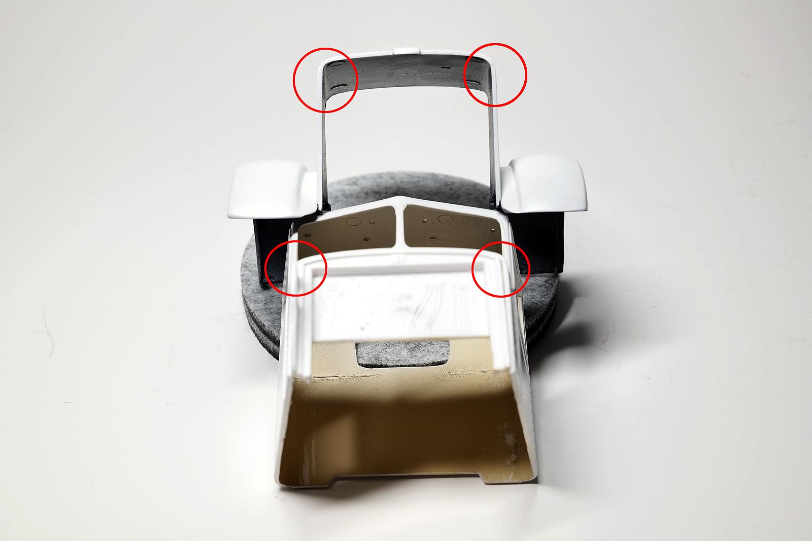

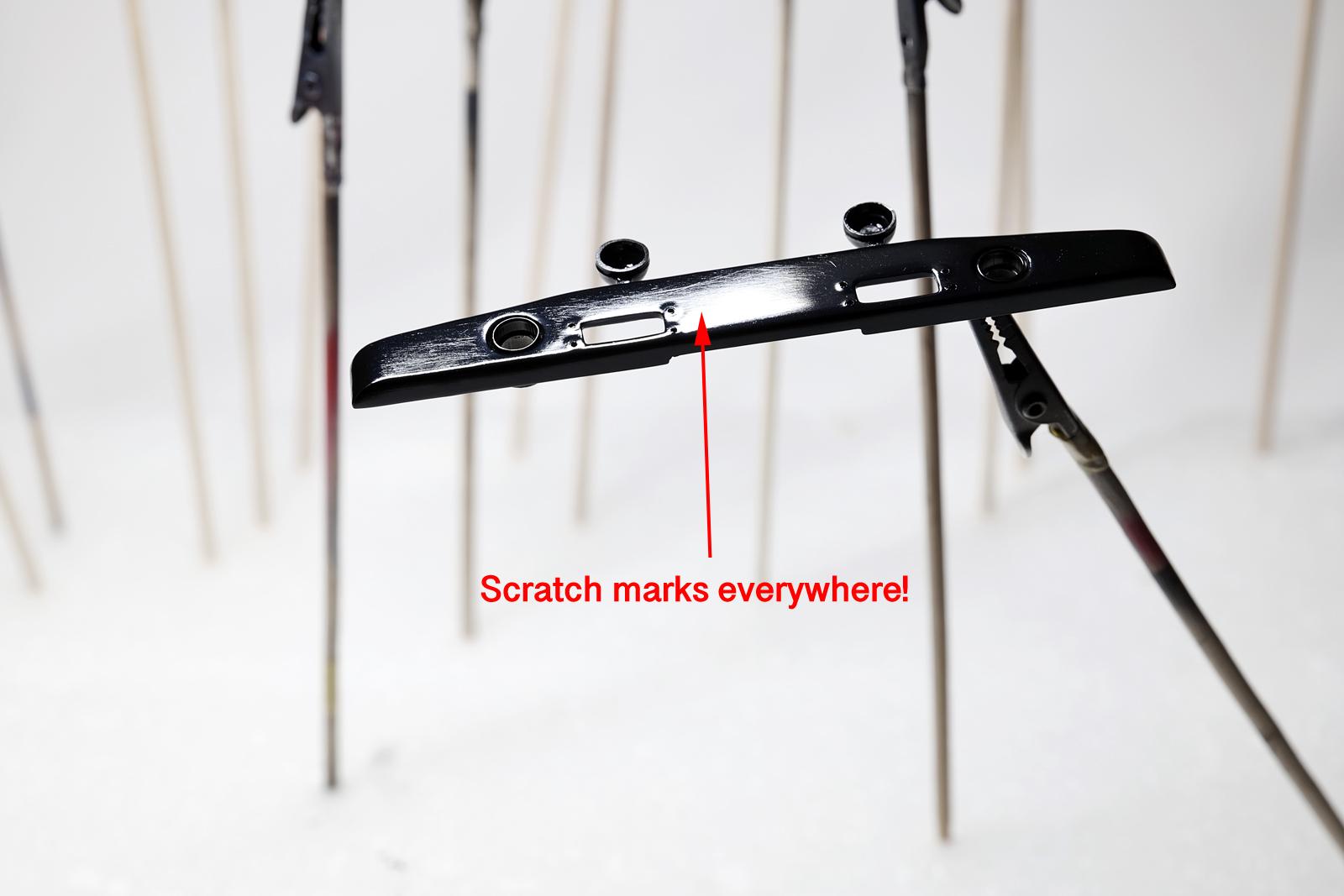

After Rob mentioned the asymmetrical wall thickness, now I can see definite discrepancies on them (circled). To me, both my hood and cab have issues. I think it is somewhat a minor of an issue that no one is going to notice unless someone pays close attention to it. Initially not knowing the cause of the problem, I found a way to "spread" the low part of the cab (close to the front) on one side slightly to make it look aligned. I thought I got it to look straight, but now I am thinking sanding out the wall to match the thickness may also work. These parts will receive shiny metallic silver paint, I am trying to lay down a glossy black coat as my base. Already found issues with my bumper, so many scratch marks are revealed. I will polish out the scratches and re-apply the black paint. It is important to me that I get my front bumper (front grille / front headlights / etc) to look nice. While building this kit, I wanted to know if "water" based clear can properly seal the lacquer based metallic painted surface. For being test samples, these wheels were not properly painted, but they all had lacquer based silver paint that I lightly airbrushed. Then I sprayed Tamiya's acrylic clear and Mr Hobby's acrylic clear to see if they can maintain the metallic color. I only used water to thin the acrylic clear paints: No protective coat Tamiya's acrylic gloss clear Mr. Hobby's acrylic gloss clear Mr Color's lacquer gloss clear (just to see how damaging it would be to the paint) I think Tamiya's acrylic gloss clear performed the best, but not still perfect. Looks like I lost 3-5% shine/metallic feel to the painted surface... I may consider using Tamiya's (X-22) acrylic clear on metallic surface where heavy handling is required.

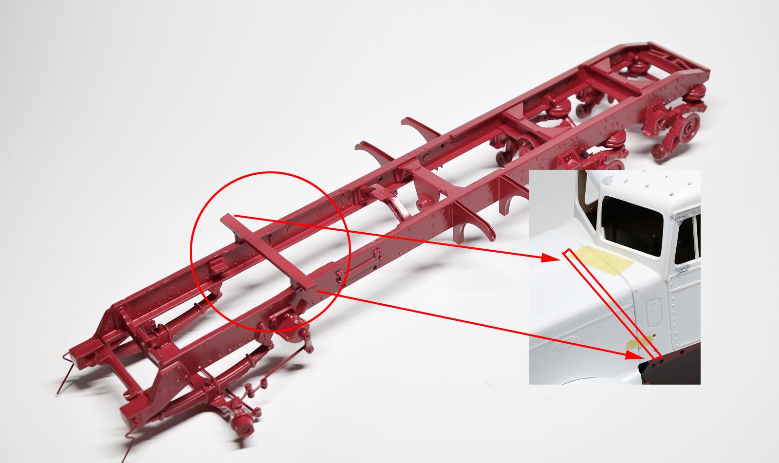

Awesome info, Rob! What a great analysis you are doing! Mine involves some eyeballing and measuring by feel, but you are actually doing some investigation based on visual photography study. I read somewhere that these scale models aren't always exact reduction in ratio, but rather each company does some fine adjustments to make sure the models proportion look okay in our eyes. At any rate, I am glad to get your support on tire sizing! Super cool stuff you got going! Fantastic! And you are right about the hood and cab, I do see mine having a thicker wall on one end! I didn't mention this feature in this build just because I wasn't sure why my cab/hood was skewed ever so slightly. Something wasn't right, but something wasn't wrong either... This is a little "dirty" frame rail device I had to add to correct the cabin position thinking this is what I would need to make things straight (I didn't know this was due to the asymmetrical cabin walls)! I originally blamed it on my frame assembly being slightly off, but looks like it is an existing defect. Good work~

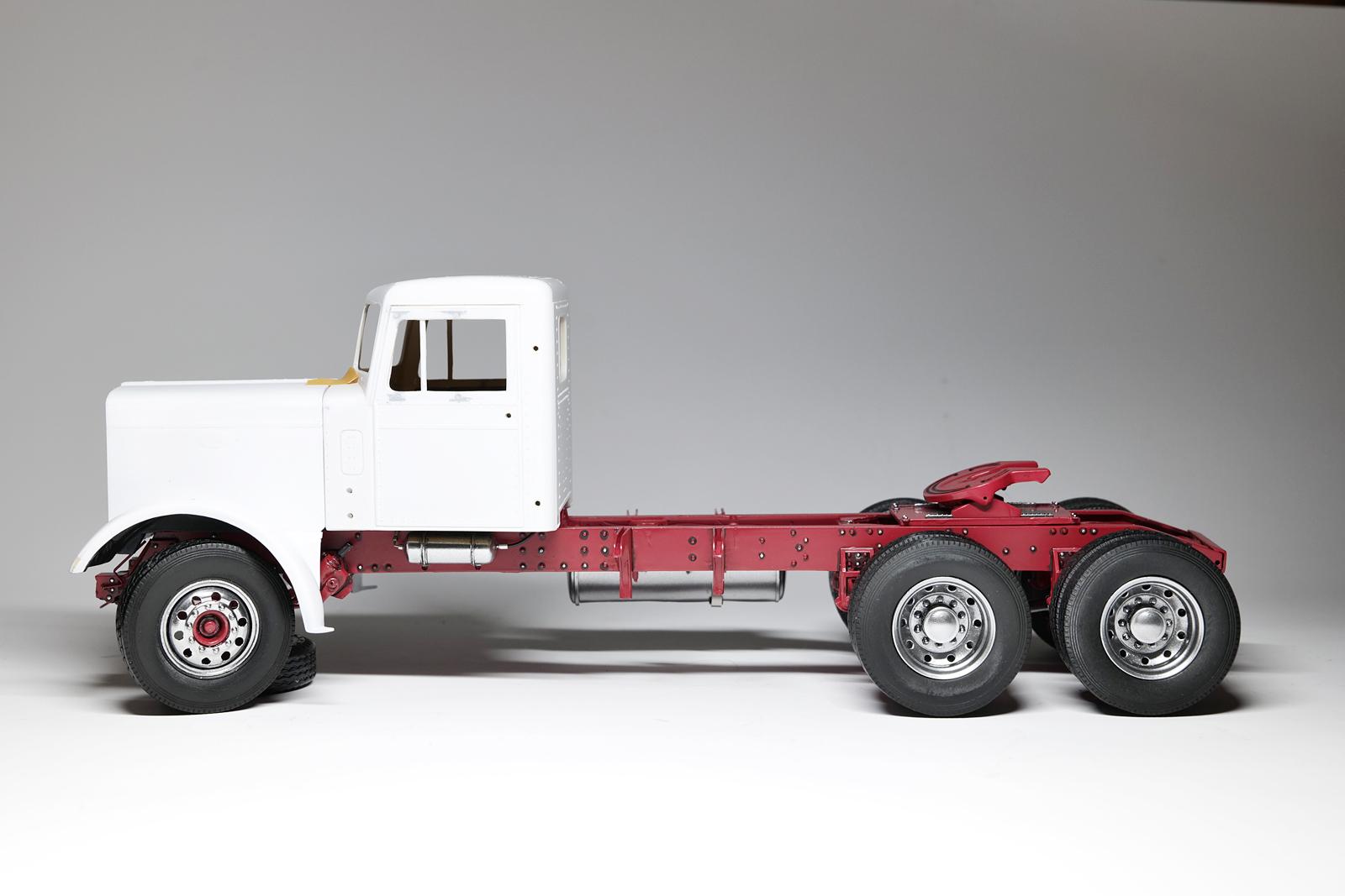

Once I was satisfied with the potential solution for handling the fuel tank straps, I began the work of attaching wheels. Attaching wheels requires some mental focus for me... At least it is an activity that I need to concentrate and go through "struggles". I believe this is an important step to get it absolutely correct so spending some effort is must. I tried to ensure these three requirements are met when mounting wheels: All wheels (10) must touch the ground (I know this sounds very obvious, but it isn't always easy) All rear wheels (8) must have same camber and all needs to be mounted so they are parallel to the frame (they won't be parallel without an effort). All wheels must be mounted at their ideal locations (I measured and adjusted all of these during the early part of assembly, so no bad surprise now) Again, I use the slow curing CA glue (mentioned in the previous post) which helps me to adjust and fine tune. If you see the above photo, I put a spare tire (using it as a jack stand here) under the front axle to hold the frame height while wheels are being glued on. Once wheels were on, I test fit other components including the fuel tank and exhaust pipe. As suspected, the extended fuel tank is hitting the exhaust piping. I will have to modify the exhaust piping to correct this problem. More homework for me, but not a big deal, I don't think. In real life, could this be quite dangerous having a super hot exhaust pipe touching the fuel tank? I would think diesel fuel won't ignite like gasoline, so it may be somewhat okay? As I get closer to painting the body, I spent some time today going through my usual surface preparation. I plan to document my findings here, hoping this may be useful for others thinking about building this kit for the first time. First, there were some molding lines on the cab (noted above). I simply remove these using 800/1000/2000# sand paper. I plan to wash the door trim edges after painting, so scribe door lines using a panel scriber (shown here). I filled the mirror mount holes thinking I would drill smaller holes later for my mirror mounts. This step isn't needed if you are planning to use the mirror mounting parts from the kit. All of these roof holes must be drilled prior to assembly. They DO require big holes for reason. Torpedo lights, air horns, AC unit, etc all have big mounting pins. But just make sure not to drill bigger than they need to be. The firewall piece doesn't go all the way up exposing some gap. This piece needs to be accurately attached. Some test fitting is required and I made sure it was flushed again the upper panel. It will hold the hood and also sit on top of the cabin floor which gets mounted on the frame. Without a proper fit, I noticed my cab leans one side when attached to the frame (mounted through the cabin floor). Fenders attach quite easily, but they need to be symmetrical. You can confirm this by allowing the hood to sit on a flat surface. There was a long molding line which also had to be removed by sanding. There are recessed pin marking under the hood. They should be cleaned if you are seeking perfection. I didn't clean them as they didn't bother me too much... Lastly, I sanded down the entire body parts using 2000# sandpaper to reduce the depth of all the rivets. I personally think they are way too pronounced and out of scale.
