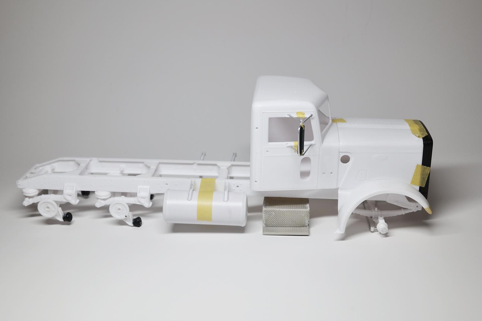

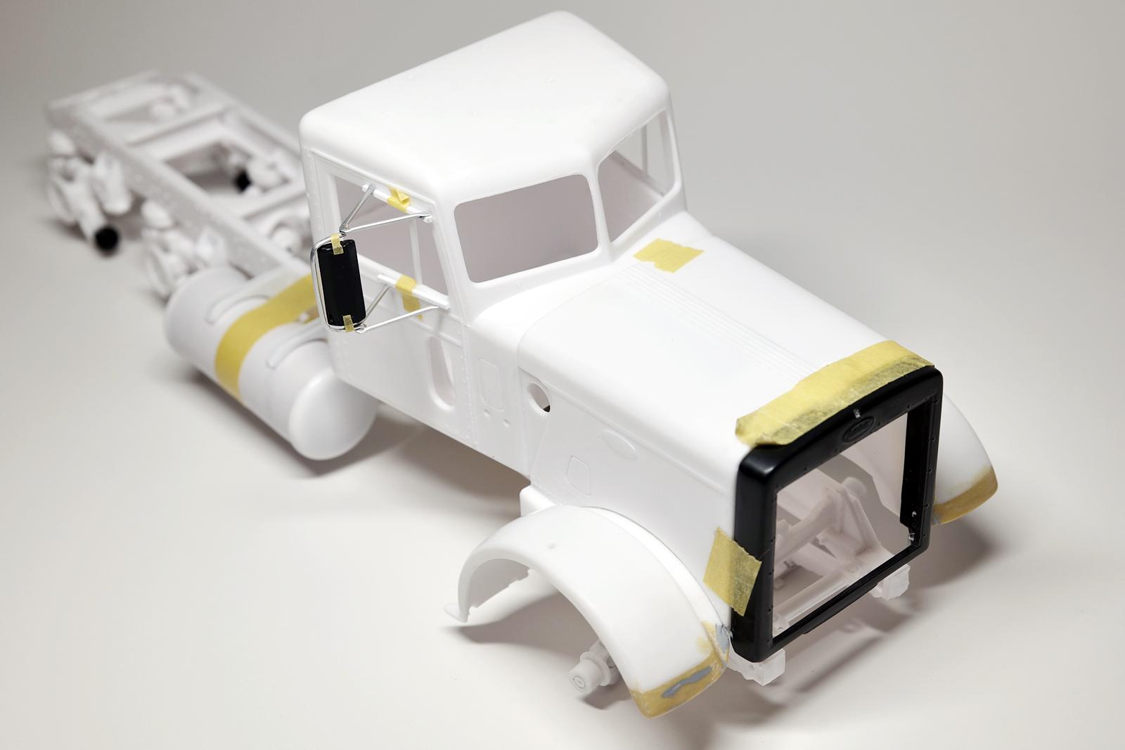

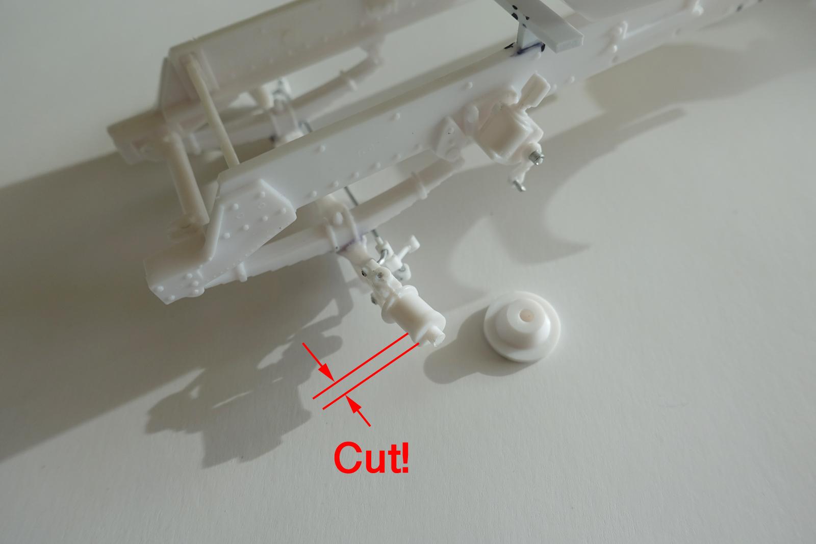

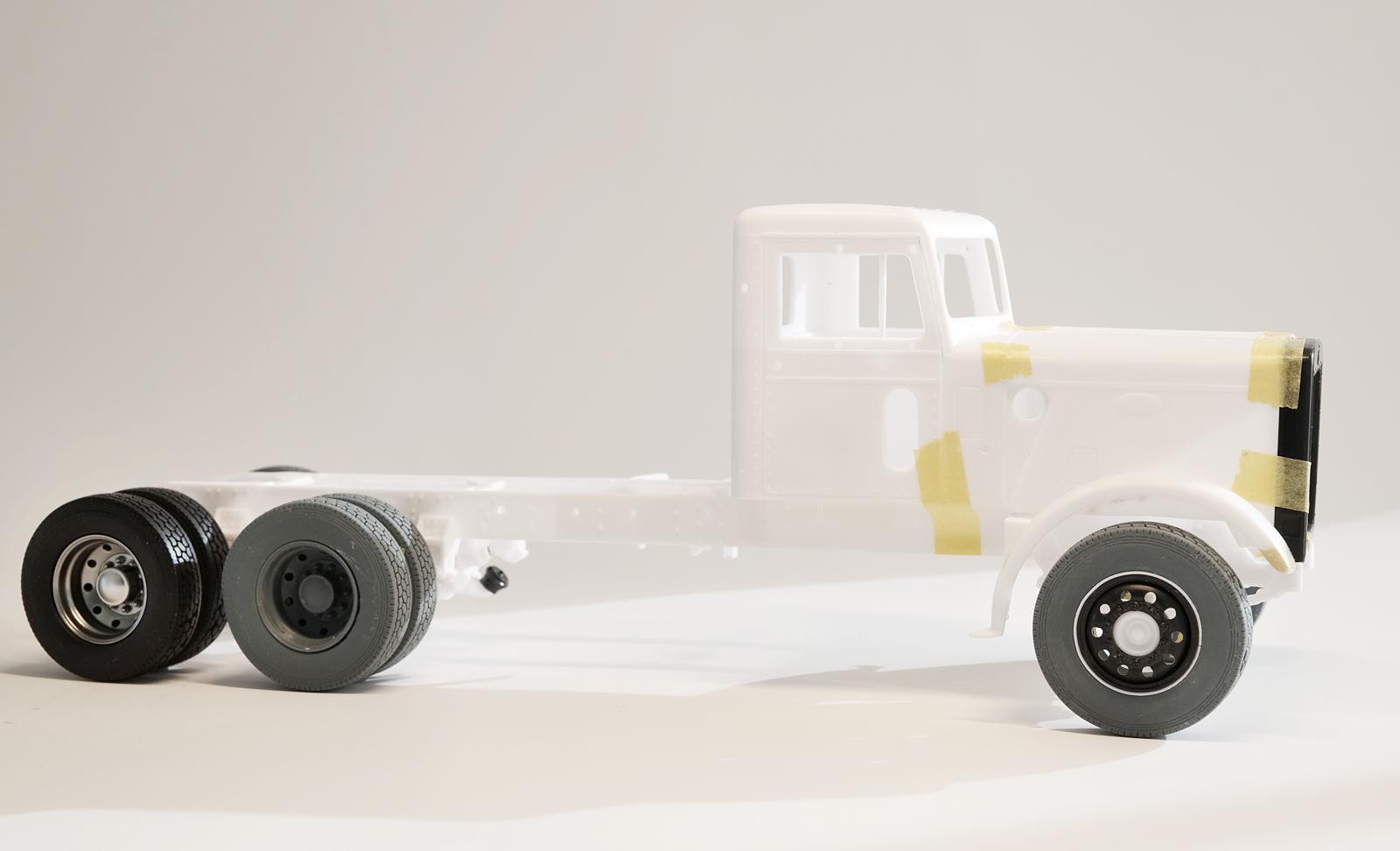

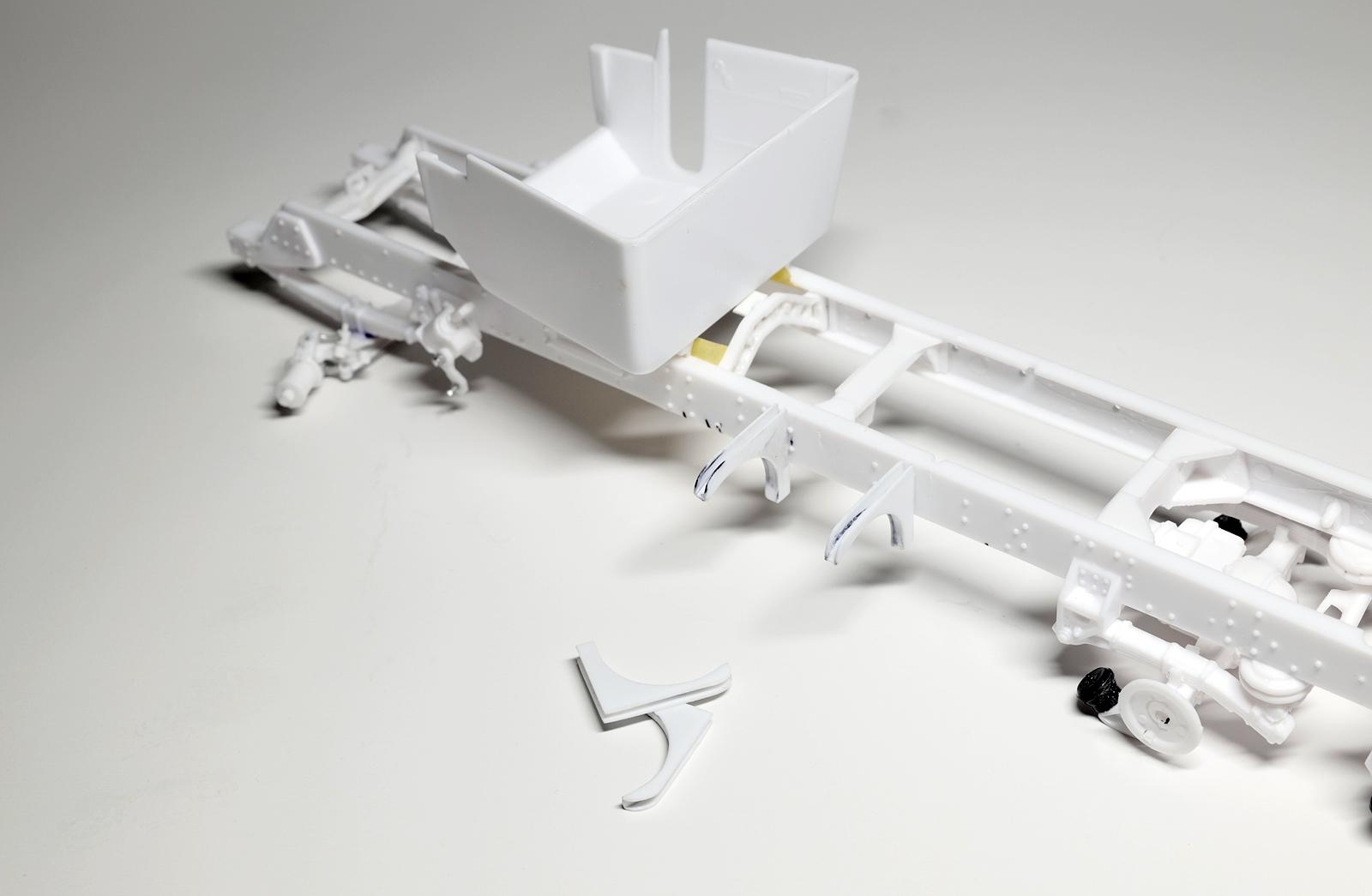

This one is turning out to be a tough build for me and mainly I am having difficult time deciding how I want to build this kit. All of the little details becoming road blocks just because each of them presents multiple choices on how I can go about... When I initially wanted to build this kit and started the work, I really wanted to build it straight and quick. Then I started to see different options, tough choices, several issues, and more opportunities... "For now", I made up my mind on wheels and height of the truck. This is how it is going to be built. The front fender gap seems okay to my eyes also. For some reason, it was my main concern for this kit. While I was lowing the frame height, I decided to tackle CHALLENGE 6 where the front wheels seem to be wider than they should be. Leafsprings pointed out also that the front wheels are supposed to be tucked inside of the fender. To correct this, I simply cut away the axle ends by 1/8th inch which I thought it as the simplest way to handle it. To be absolutely correct, I could have narrowed them to be more, but I do like wider stance (on all my vehicles) and only made them to be narrow enough. This is my feeble attempt connect the steering mechanism all the way by using plastic tubing parts mimicking ball joints and such. This isn't accurate either, but my goal was to make them to function as wheels turn left to right... I could have used some of the micro scale bolts/nuts to make things legit and luxurious, but I realized my supply was running low and I decided to preserve them for next build. As I mentioned above, This was one of the choices to consider and a decision to make... The quarter fender guards were made using plastic sheets and plastic tubing materials. I am planning to paint them to be shiny aluminum. Unfortunately, this kit does not have the tilting hood. If you want to reveal the engine, you will have to simply pop the hood away (remove). Surprisingly though, I found out that the latest AMT's Cross Country Hauler kit has the tilting mechanism! For my truck, I decided to see if I can add a couple of hinges to enable the tilting action. As usual, I design the hinge using my "trial and error" method. Basically, I wanted the hoot to pop upward and tilt forward and it seems to be functioning okay. I won't put this in my CHALLENGE list, but when I saw these side mirror parts, I didn't even attempt to build them. I began the work of making my own mirrors. I simply copied the design using plastic square rod and small aluminum tube. The work is somewhat easy, you just need to bend, bend, bend, and bend... The mirror fits well, so I will make the other side using the passenger side as a guide. I also wrapped my fuel tanks using thin plastic sheet; this will help me paint the fuel tanks better later as all surfaces will have the same plastic material. I may add small stainless bolt heads later on to these mirror arm joints to enhance the details, but then again, I need to preserve my detail supply.... Tough decision! This is my setup so far. The battery box is under the cabin and the fuel tank located under the sleeper. And I have this going on "BOTH" sides. Lastly, I decided NOT to plumb the truck with air hoses and brake lines. This was another choice to consider and a decision to make for me. I wanted to plumb the truck throughout, but I think the laziness and the fear of dragging the build made me to skip...

Håkan! Never disappointed! I totally forgot about the split rims and tube vs tubeless tires! Great info as usual. I need to rethink about my strategy on wheels, but I think I have crossed the border and it may be too much for me alter back. I will have to blame you for giving me more options though. Nevertheless, I think the reference photos are awesome here and allow me to contemplate even more on this subject. Man, you guys are totally on the subject understanding the shortcomings and such. If mine is going to go "incorrect", then I will have to go with the story of "all of the custom modifications done by previous truck owner".

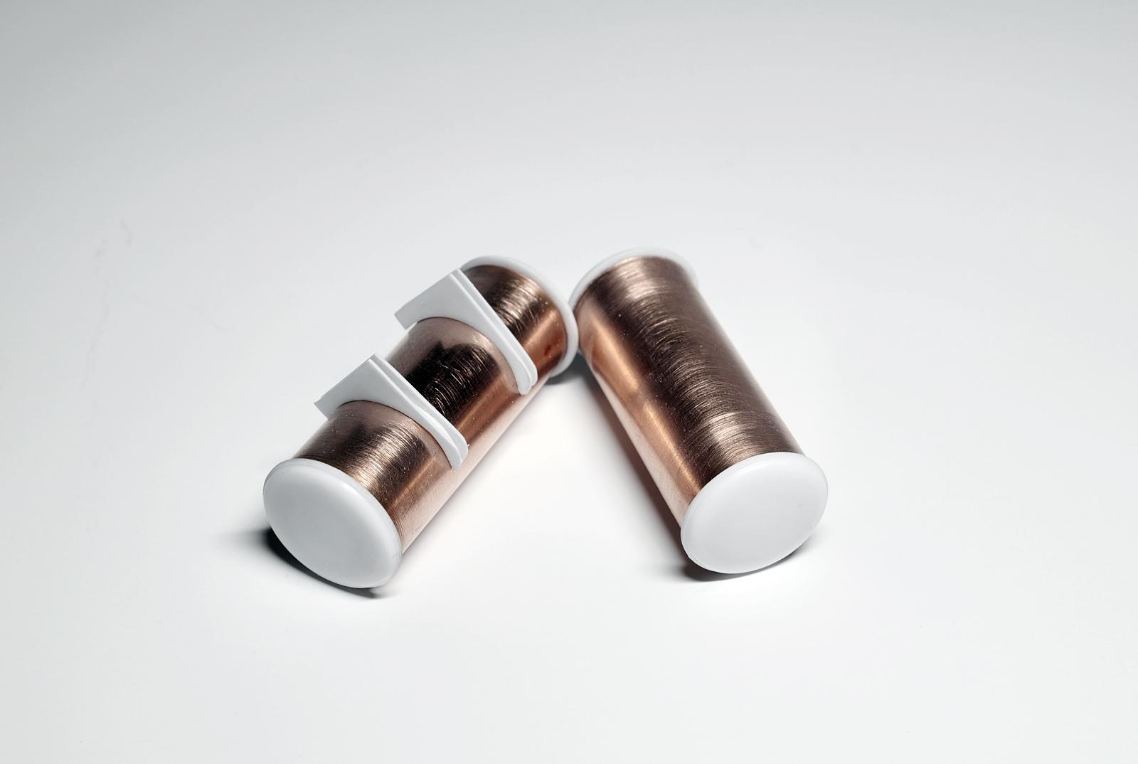

I also spent an hour or so assembling my version of fuel tanks. Copper pipes with end pieces from the kit were used. Unfortunately, I had to fabricate the tank carrier brackets. I test fit them to the frame to make sure I can position the fuel tanks without any interference. Lastly, I quickly drew my painting scheme so I can use them as my base template to paint the truck. I haven't decided the color yet, but I really want a red truck...

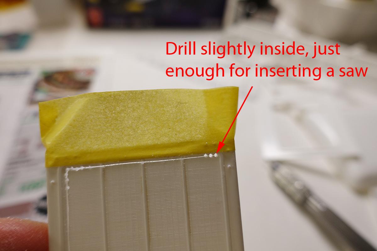

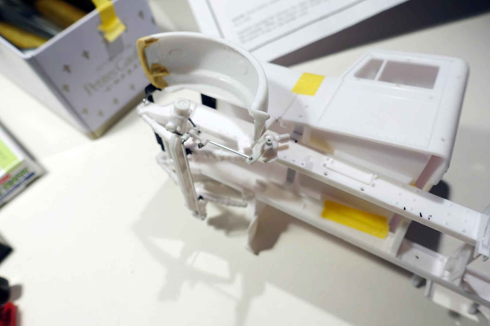

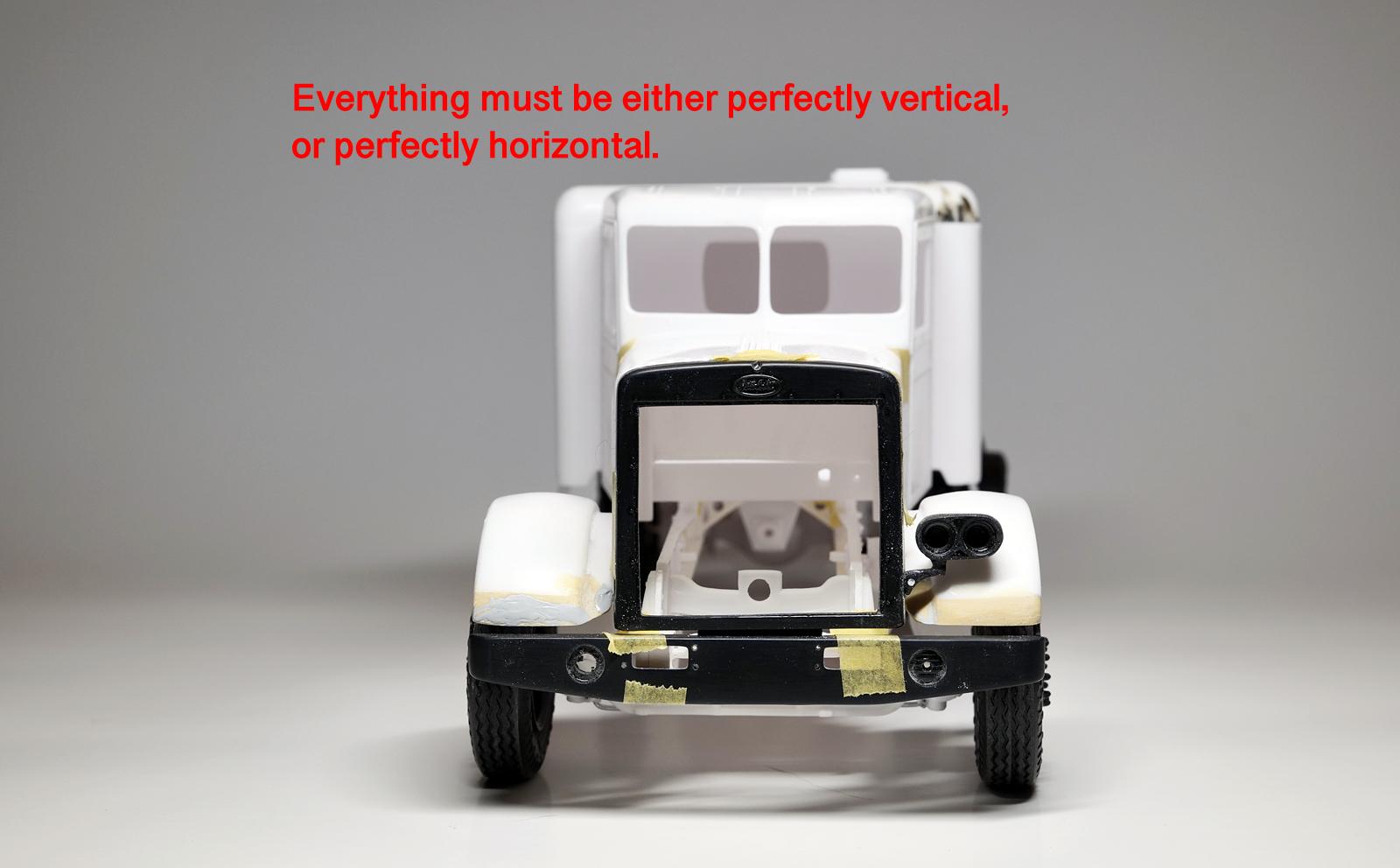

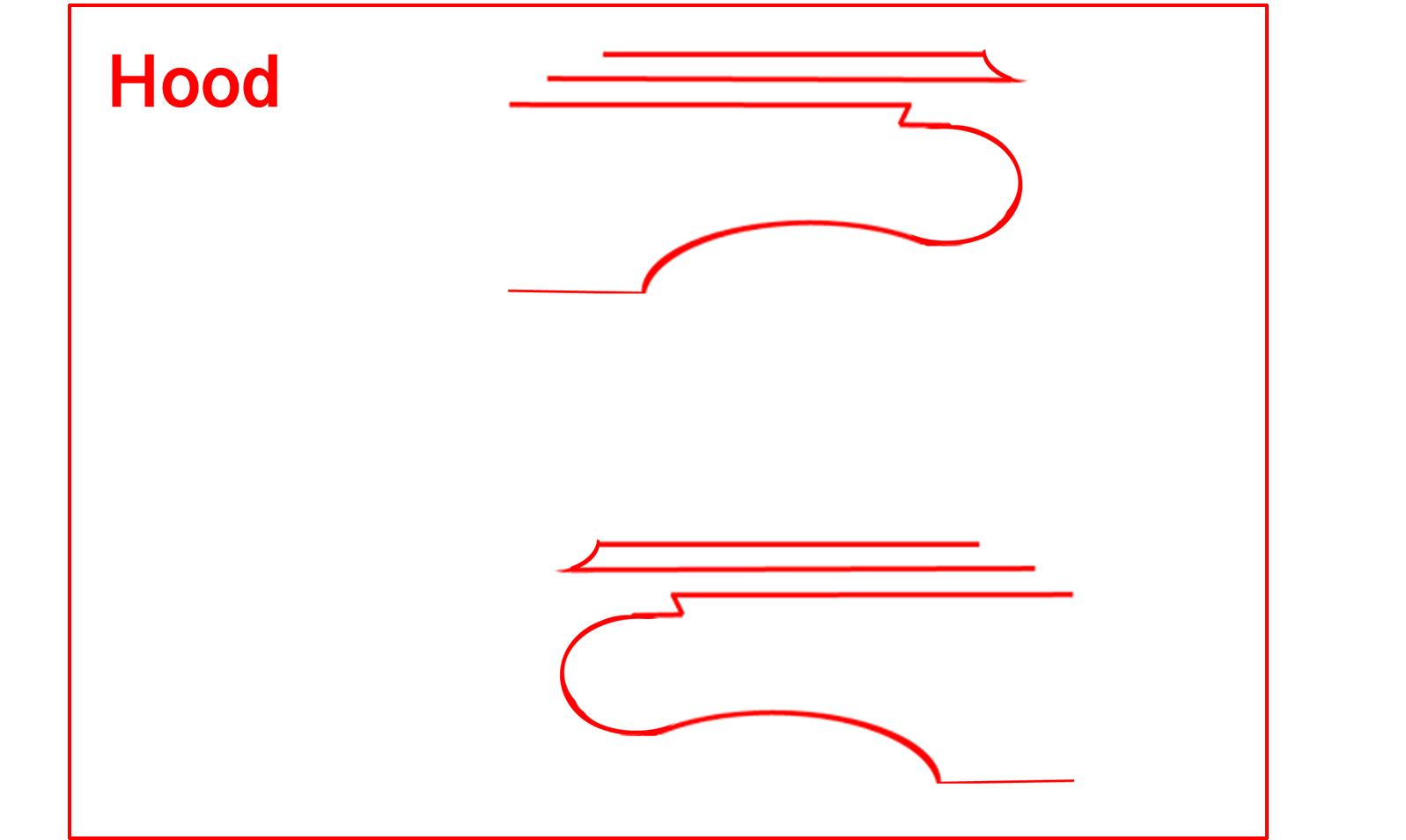

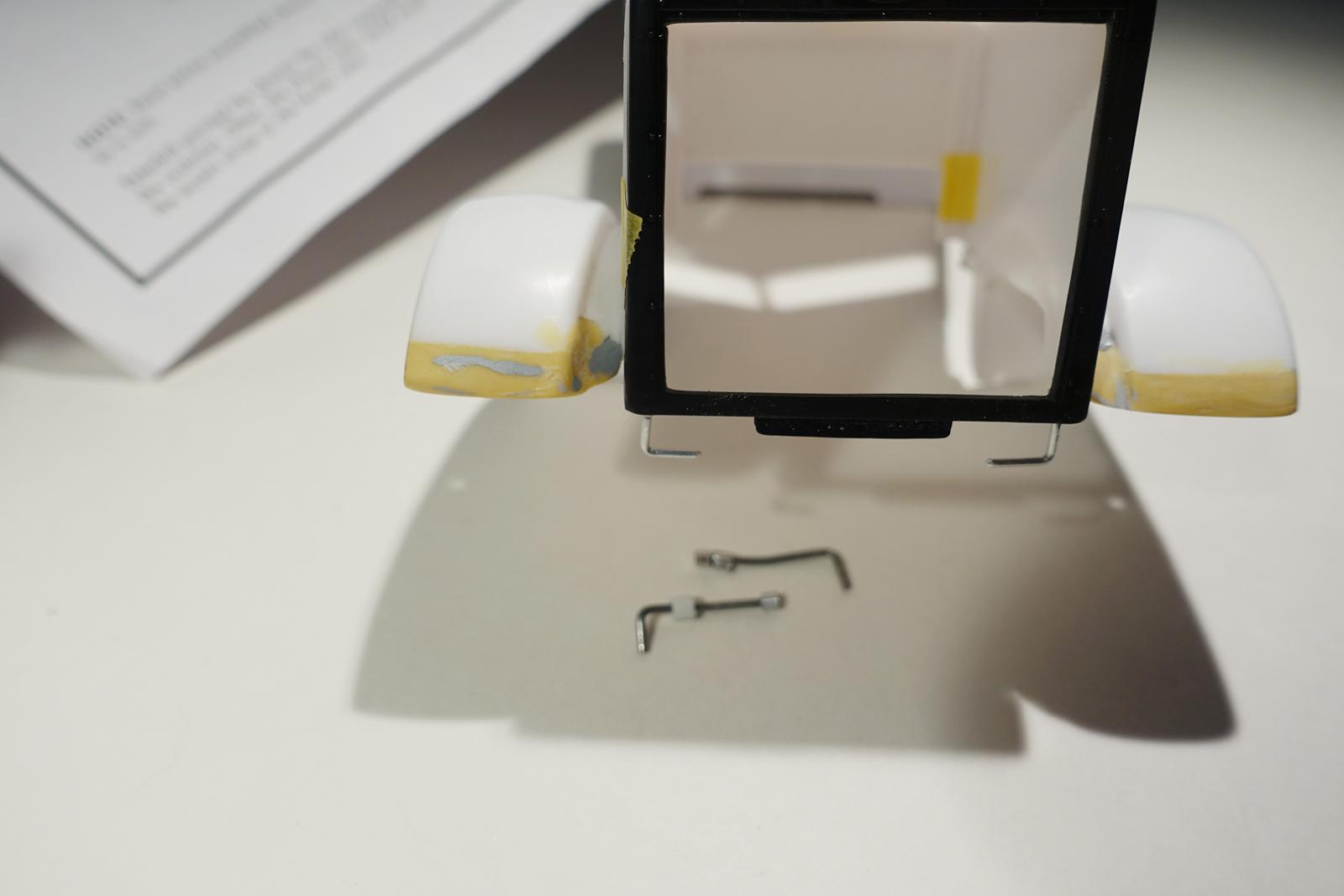

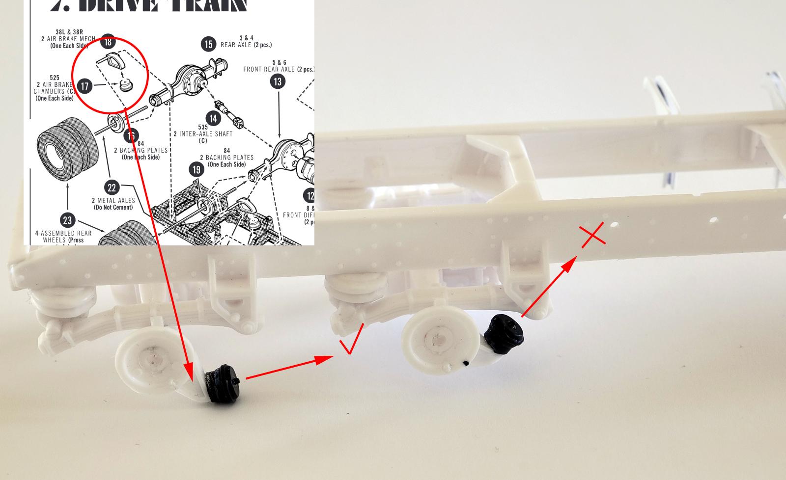

Talking about grille, it could be trivial to most of the folks here, but this is the technique I have been using to cut out the center portion of the grille: This one is from Revell's Pete that I worked on some time ago. I would drill out corners in linear fashion 3-4 times so I can insert a P/E saw blade (hobby knife won't work well). Using a masking tape as a line guide, I slowly saw out the center. Once you have inner portion cut out, then using a sand block to even away the edge (to make the line straight). I still need to even out the edges more, but basically you will have an open front like this to work with. As I start adding parts to the frame rail, I noticed that if you follow the instructions to attach brake champers, the chamber will almost face upward. I questioned this and based on some photos, I think these need to be slightly facing up. But I could be wrong as usual, please do let me know if my interpretation isn't correct on the brake chamber position.
@leafsprings Thanks for the positive feedback, and this photo helps greatly. Double thanks on this! 👍 Although, I don't think I have the necessary talent to make everything look exact, but I was able to pick up a couple of ideas for the truck. For one, I will definitely try to put the front wheels under the fender. As you pointed out, that front grille is definitely interesting to look at, almost as if there are operable blinds (white) to control the airflow. But I am not sure if things were that high tech back then... Or perhaps that white panels are the radiator front? And both of the windshield wipers seem to operate in same direction too.
