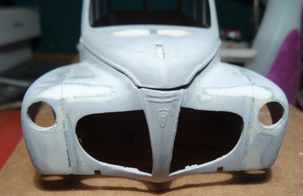

Jim It looks like you have the center trim bar right up at the top of the nose. It actually has a bit of body above the trim. Couldn't you just add a bit of body above the trim to close the gap?

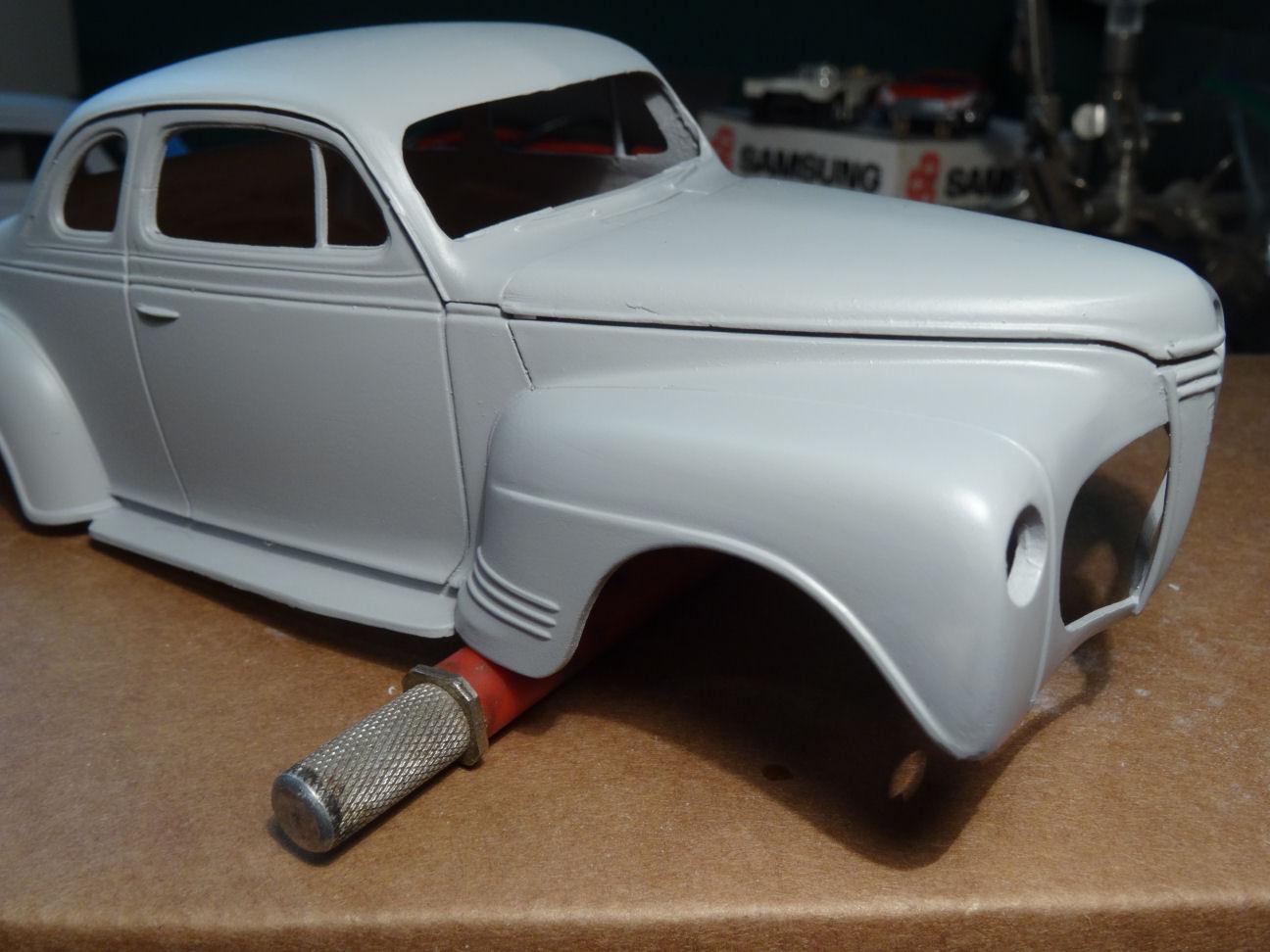

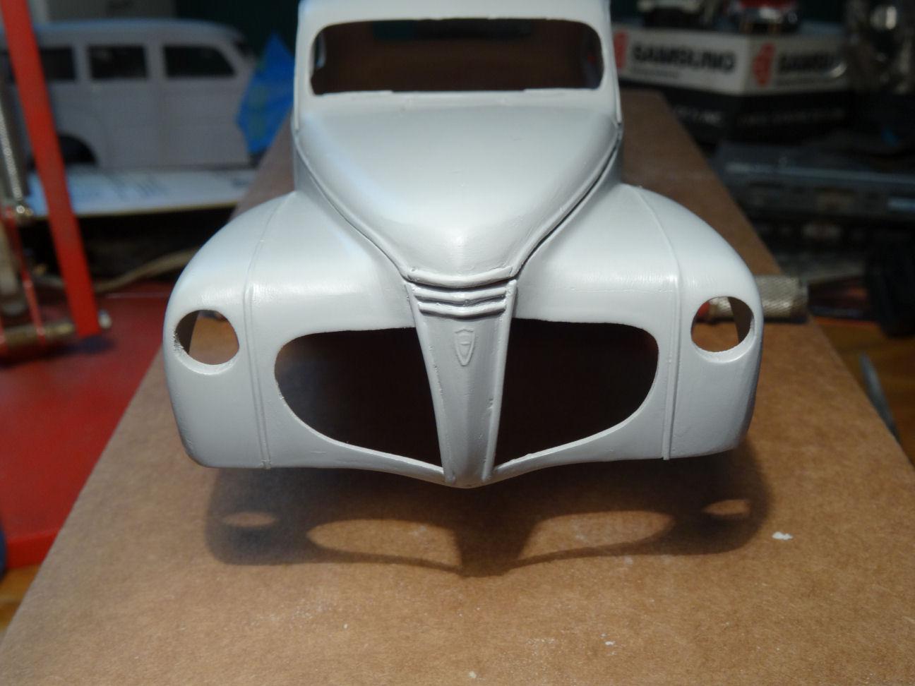

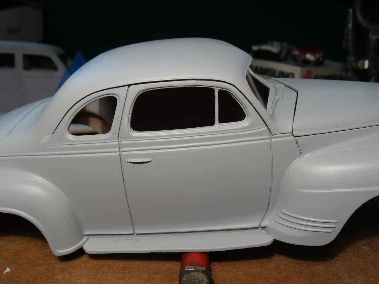

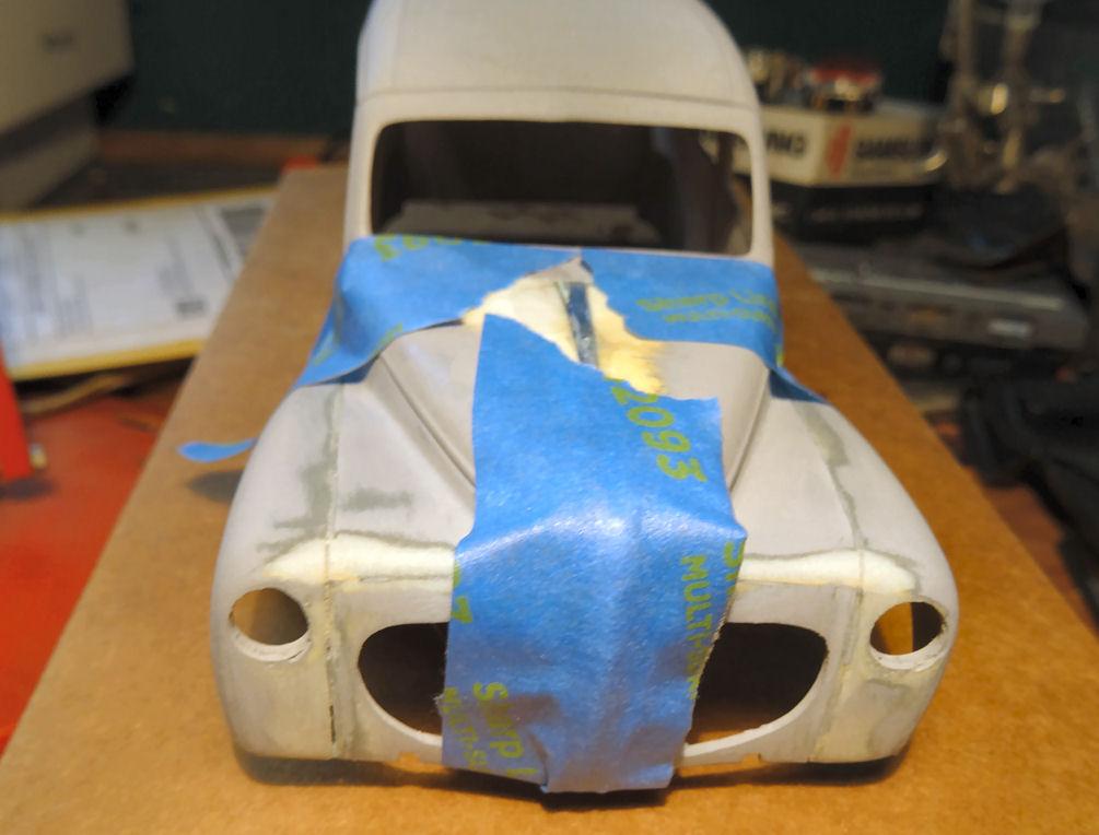

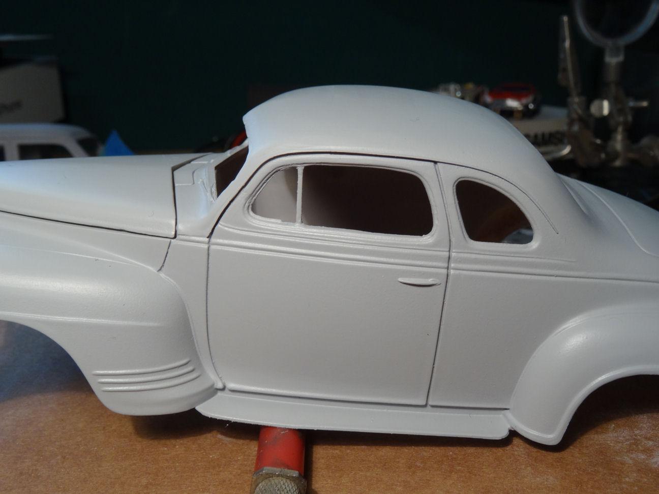

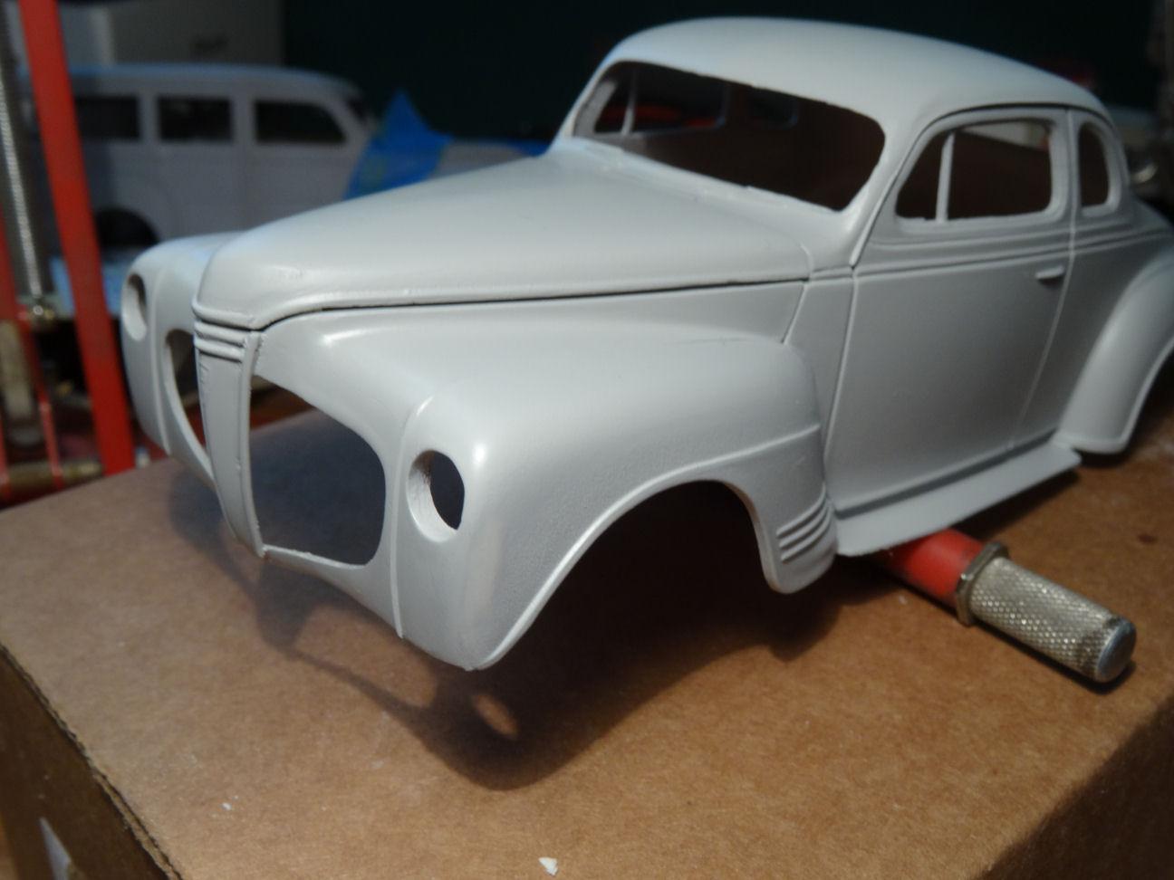

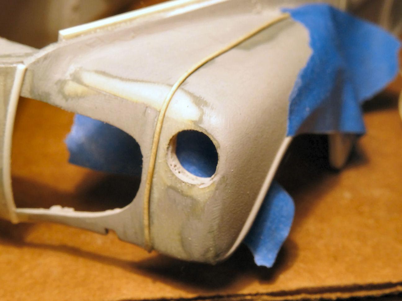

THE COUPE After some primer the coupe is starting to take shape. The top chop still needs some cleaning up on the right side. Left side is just about there Still need to figure out the fender welting issue. On the coupe right now the welting is the original kit on top and the rear of the fenders and the front piece is .040" half round. Not sure if I will leave that and do some black BMF over it after the body is painted. It's hard to see in the pics but the bead is uneven along the top. Might remove it completely as with the Woody as Customline has done and fill it in with some styrene rod. Also considered brass rod. Other considerations are solder or bead wire. Nose needs some more cleanup also. That's all for now.
The Woody Don't think for one minute I've neglected the Woody. It got some love this week also. The Woody is just hanging back a bit to see how the battle of the noses progresses. Meanwhile it has it's own issues, namely the hood. The hood is actually twisted and sits high on the drivers side front. Part of that problem may be my fault. The body of the Ford woody is a bit wider then the Plymouth. So rather then make the Woody body narrower, I made the rear of the hood wider. I cut a slice down the middle of the hood and added a pie shaped sliver. This afternoon I cut through that sliver, taped the hood down solid to the body re-glued it and hope that when the glue dries it retains it's shape. We shall see.... A keen eye may note that I have removed the fender welting on the Woody and right now it has a groove cut in it's place. That is for the ongoing indecision on how we are going to tackle the welting. More on that later.

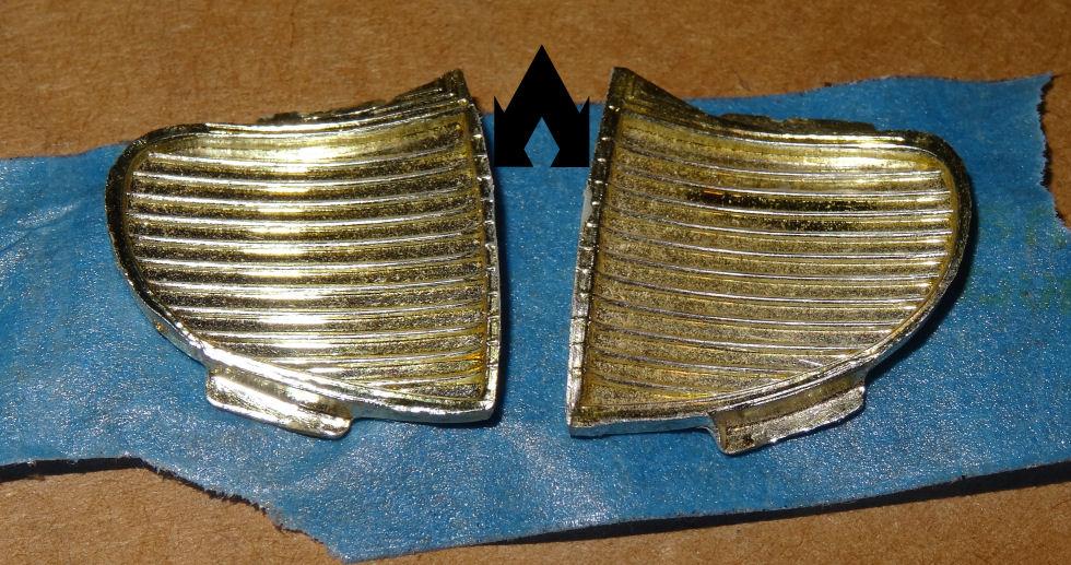

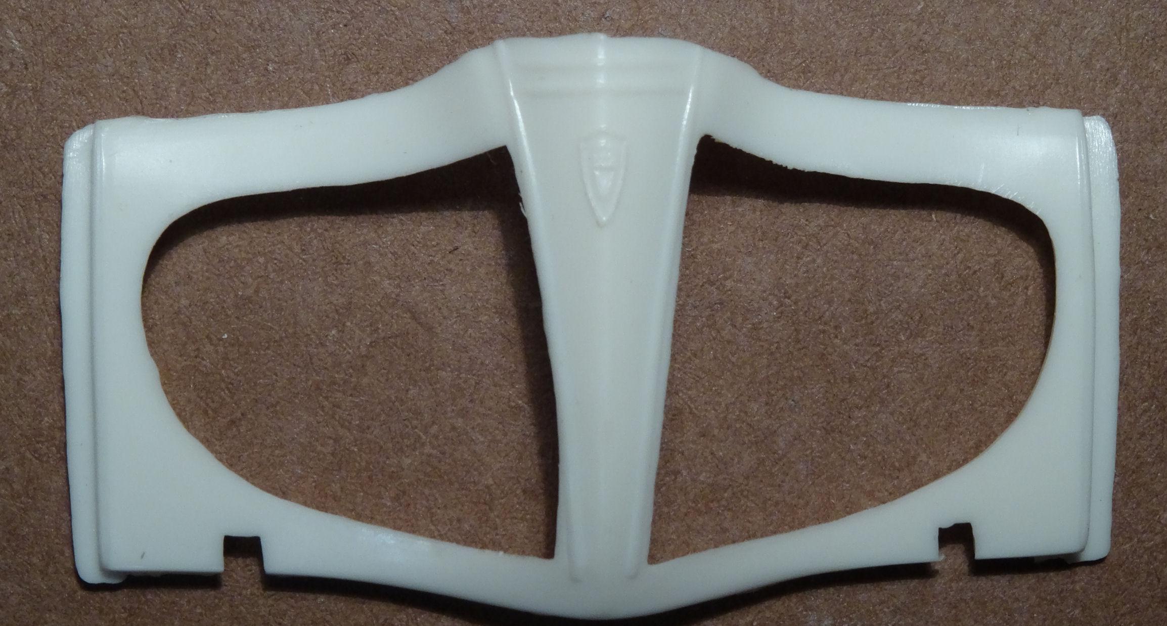

The sealed one in the attic is the original issue. Yes, I'm well aware you're not going to get a hot meal at the local diner by selling off one of these kits. ? I was thinking of putting the BMF over a bead. Tried to go out this morning and get some round stock but Hobby Lobby didn't have anything suitable, unless I wanted a 1/25th scale baseball bat. Gonna have to order some online. Not sure of the size, probably .040". Here is a shot of the wheel from the Rocker kit.

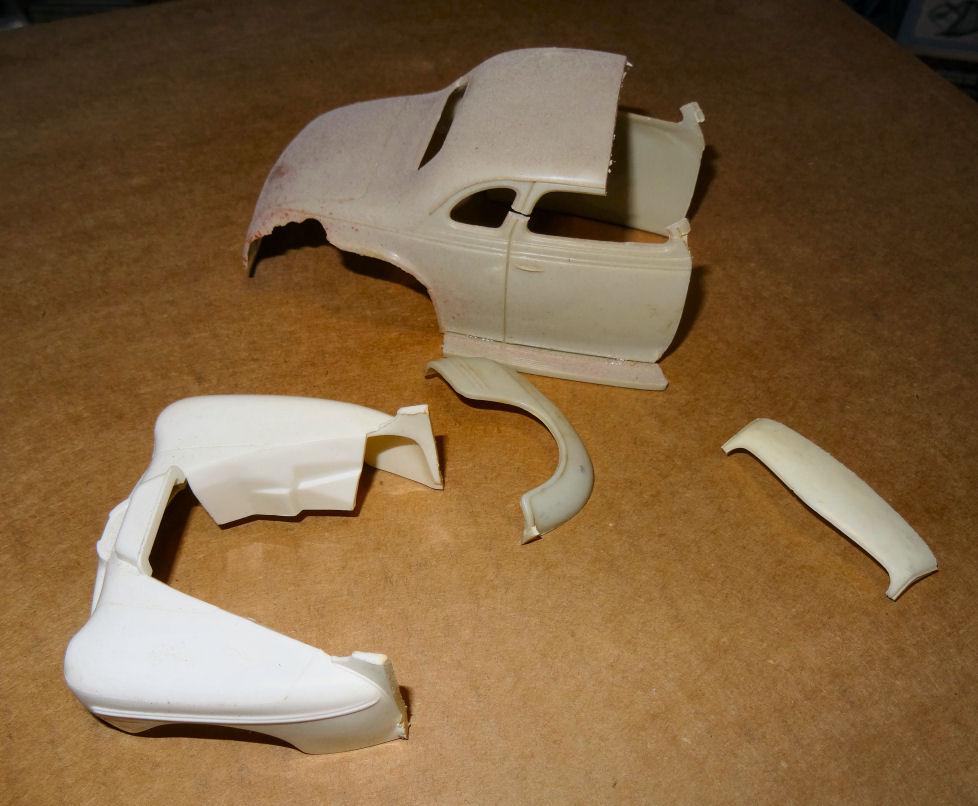

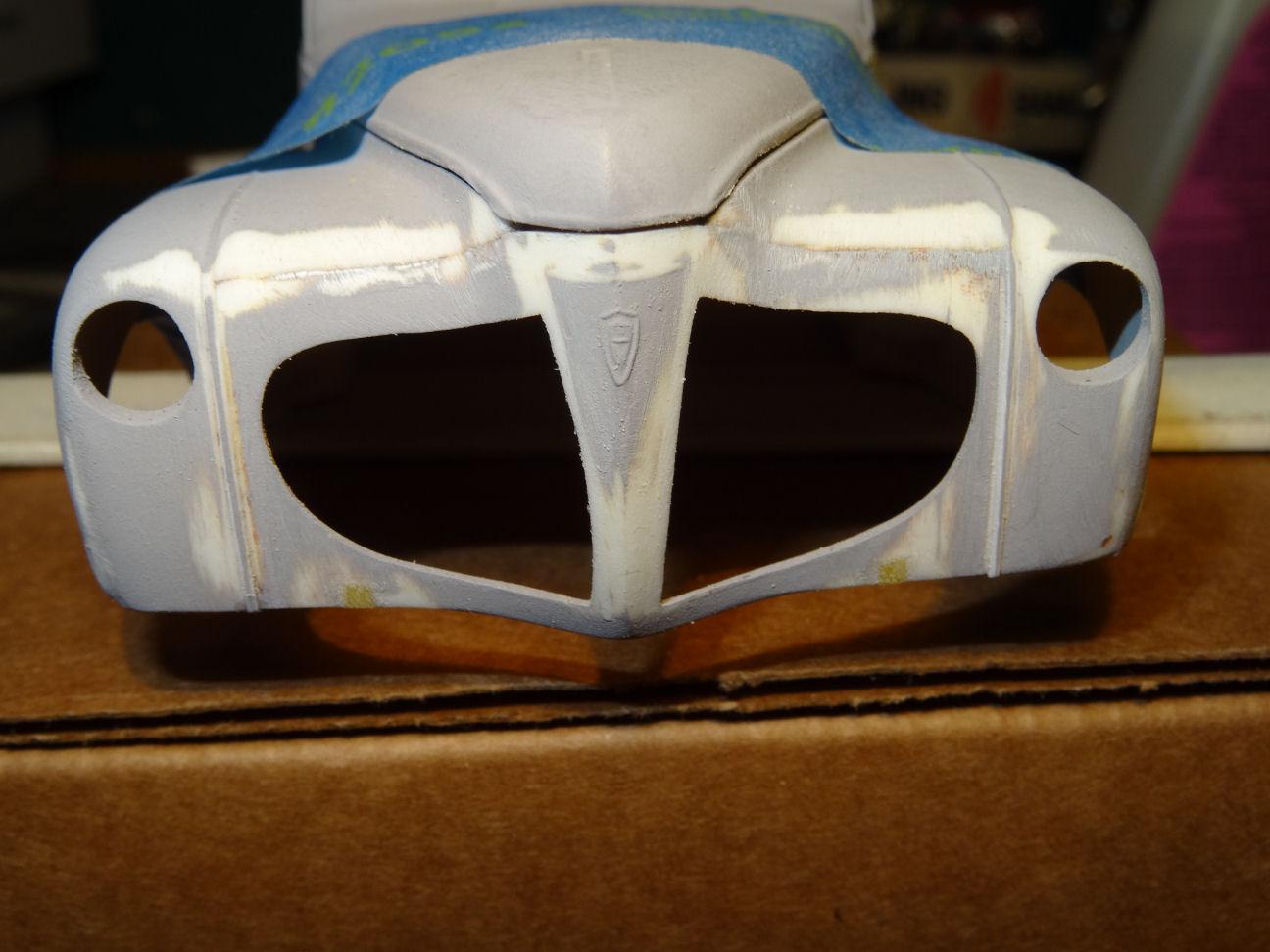

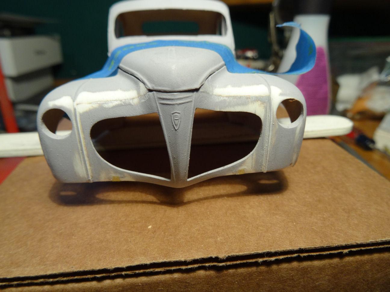

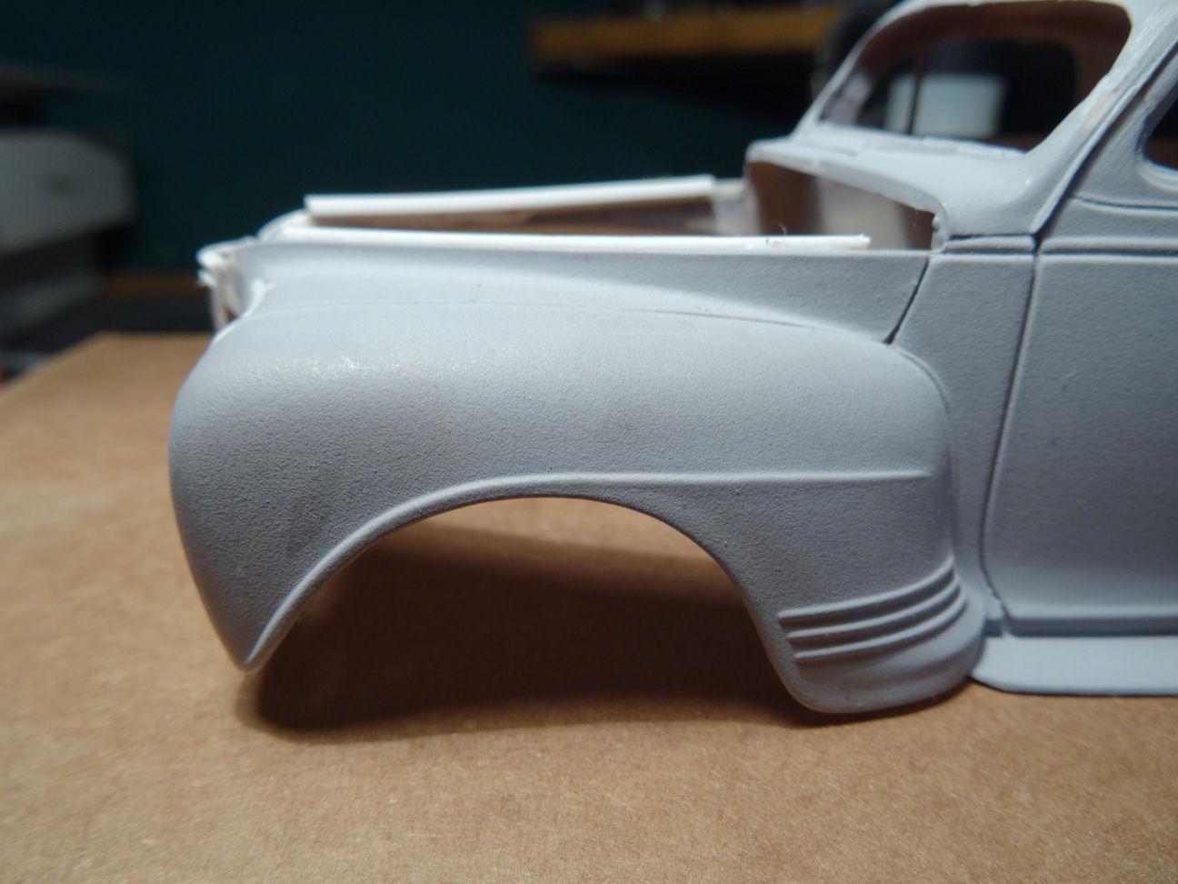

THE COUPE Spent the week mainly working on the Coupe which is a bit ironic as the Woody was the original project I started in the first place. To backtrack a bit the coupe only came about because of the bits leftover from dissecting a junk body for it's nose to marry to the Woody back half. This left me with half a coupe, and as I don't like to let anything go to waste, trying to figure out what to do with it. That half a Coupe donated the front part of it's roof to assist in the chopped top on this Coupe. So one coupe gave it's life so two others could live. What remained were these random bit of parts. I had thought about using the rear fenders on the Woody but changed my mind. Honestly, once dove into the Coupe I started having second thoughts about my first choice to get back into this hobby. A lot of issues with the kit started to reveal themselves. If you’ve followed along with Cusomline’s build you will see that we are both fighting with the nose. I guess it’s better to work out the issues now on the Coupe before I get too deep on the Woody. The Coupe is to be a resto-mod and I decided to eliminate the front bumpers so the cutouts in the body needed to be filled in. Probably the only easy fix on the nose. A little scrap plastic, a little glue and a little sanding. Found some inspiration on the net. I like the stance of the red one and the headlight treatment on the black one. Probably because of the known issues with the kit headlights LOL. The real issue with the body’s beak is the trim. The trim detail is a bit faint and off center. Also along the top center it is uneven. And the hood doesn't want to stay in place. Below is a shot of just the center section from the kit. Look at the top and the faint trim lines. Those vertical lines at either edge are meant to be the fender welting. Taking a cue from Centerline the trim has been removed and replaced with half round styrene rod. .040” for the vertical and .030” for the horizontal. Another issue with the nose is the grill itself. The inner edges have a vertical bar which is not true to the 1:1 Plymouth. So while adding the new vertical trim I placed it over this bar to try and resolve this problem Not the best fix but I feel a little better about it. The trouble with this fix as NOBLNG pointed out, the center of the nose piece is too wide compared to the 1:1 '41. And with this mod I just made it look widerI Well, we have to make concessions somewhere. But we still have issues with the hood. At first I thought about adding hinges to the hood to keep it centered. But was reminded of how the hood sits on the real '41 and had another idea. There is a wide edge under the hood upon where it rests. Those black circles are rubber bumpers. So to replicate this I added square stock along the inner edge of the hood opening and raised it slightly. This keeps the hood centered and helps to maintain an even gap. Now to do some cleanup work and hit it with some primer so we can assess where we are at. 'till next time.
Greg Great idea on that BMF. I was getting ready to order some of the regular BMF so I'll add a sheet of the black.
Went up in the attic when I go home tonight and dug out the Rocker release which is from 1978, it is the earliest one I have that isn't sealed. The grill center piece has the same issues.
David You have me curious now. I'm having the same issues as Jim and I thought I was working with two early releases on my project. I'll have to go up in the attic this weekend as I have one ore two un-built early releases stashed and take a look. Len

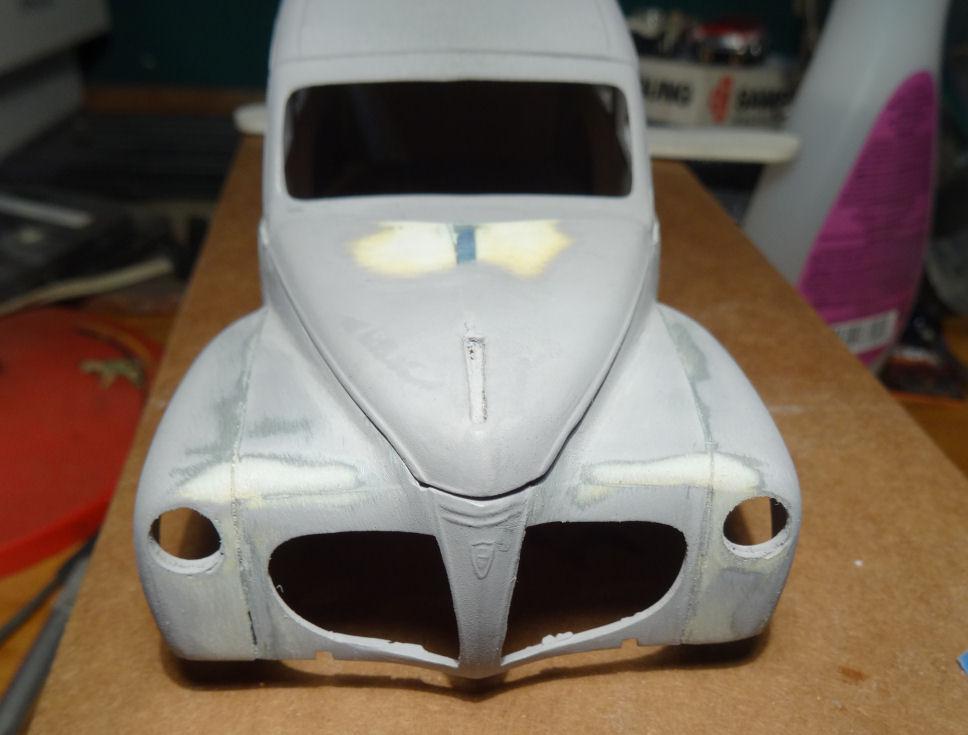

Yes, the hood is a pain. I filed away some of the bottom of the sides on the hood to get the nose to drop down a bit. But my hood is slightly warped and it wants to drift to the left rather then sit where it belongs. Probably going to need to fabricate some type of hinges to hold it in place as it's never going to sit in the right place on it's own. This is where I'm at right now. The glue is still drying so I have to let it sit overnight before I can clean this up and shoot some primer to get a proper look at it.

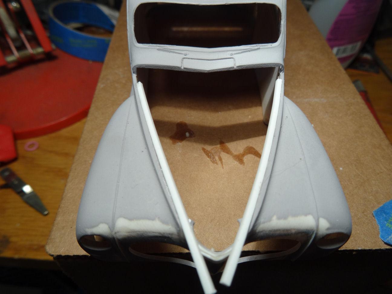

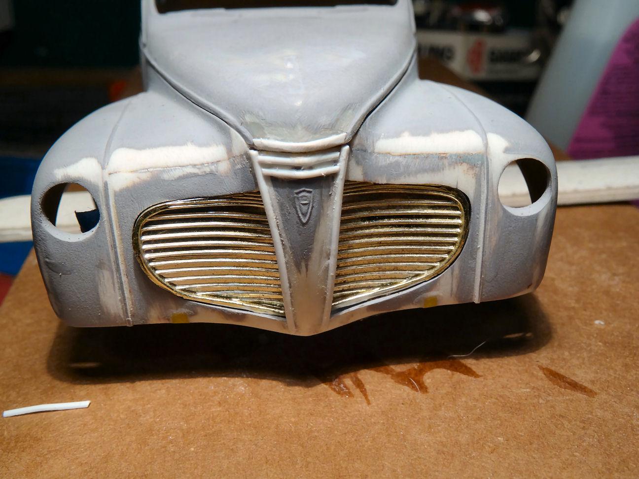

Jim I'm actually sitting here now working on the Coupe and getting aggravated with the front end. Took a day off from work as I need to take the dogs to the vet so I'm putting in some bench time while the snow comes down outside. The more I look at it the more I see it needs work. Started by filling in the cutouts for the bumper brackets as I'm eliminating the front bumper on this one. Which that part is easy. Then I put the hood on and looking at the alignment of everything the gap between the hood and the grill top are so uneven. Next I removed all the trim and am in the process of adding the trim back with some .040 half round as you did. That is in the process of drying right now so I can't grab a pic. I pulled out the grill and put it in place before I attached the vertical trim and it appears to me that the trim will actually have to overlap the grill a bit. As for the fender welting that should be black and I thought about the issue of scrapping thru the black and exposing shiny metal. Also thought about applying the welting after painting but that comes with it's own set of risks. For now I haven't changed the welting on the Coupe, but on the Woody I took it off for the solder or whatever to fill in the task. And you are correct, J. C. Whitney did sell, and probably still does, chrome welting. Many cars had the welting painted over also in a respray, but we're not going to be that lazy now are we? LOL. I was contemplating the headlight issue next but as I went thru my parts I found I only have one pair of headlights. As the coupe is a resto-mod I may just go with something different for the headlights, but the Woody will be correct. I know I have more kits stashed away but I don't want to cannibalize one for just the headlights. One last thing as I got to run, when I pulled out the grill from the parts stash I found one to have a gold tint to the chrome. Not sure who, what or why about that. Anyway, catch up later.
Jim I think adding that trim to the front really helps a lot. On the two I'm working on the trim on the passenger side is almost non-existent. I was working on the front end of my two last night and as you say there is a lot of work involved just to make the nose look right. On the Woody I sanded off the fender welting and made a groove for solder or beading wire as you did. I know it will be harder to form but I'm leaning towards the beading wire in black so that after the body is painted I can sand thru the paint to expose the wire rather then painting the beading black.
