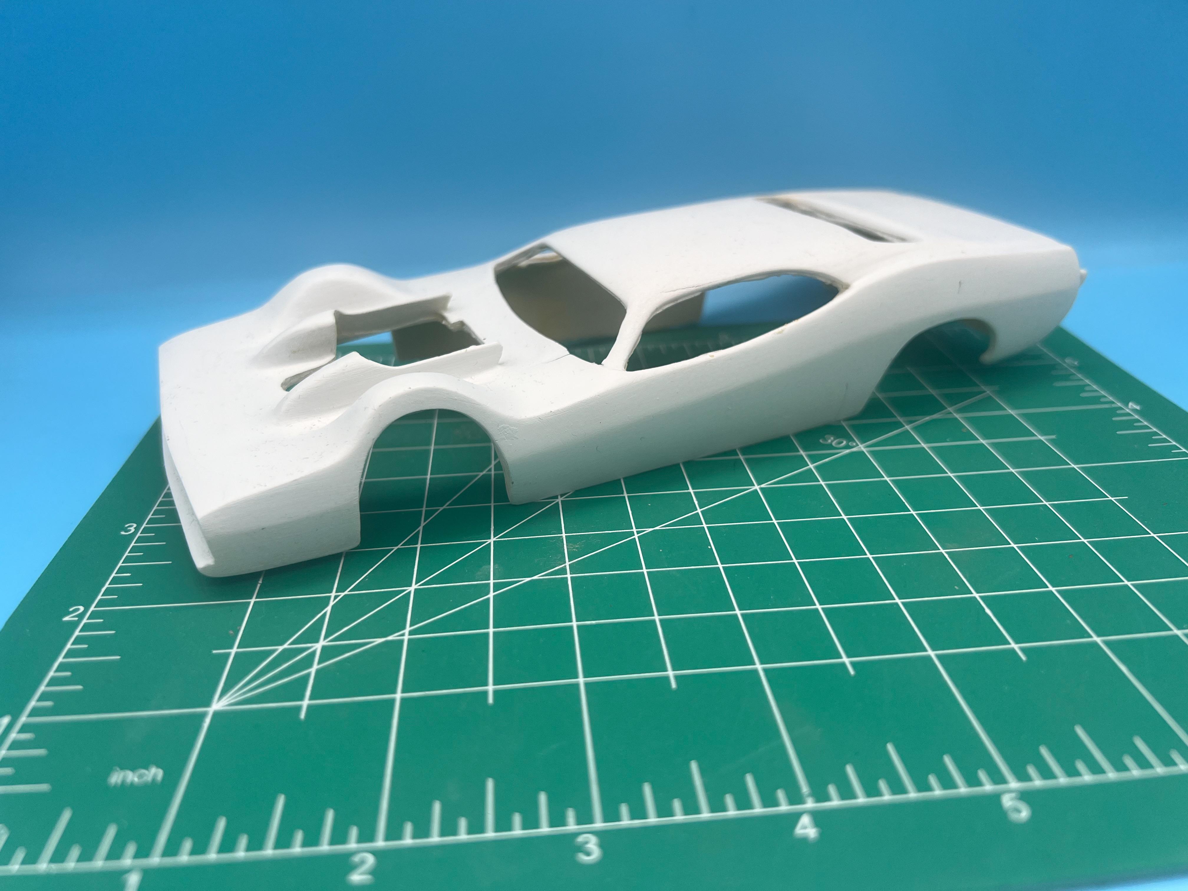

Thanks for all the replies everyone - and for the heads up on the Miss Deal engine…I’ve got that kit in the stash, I need to dig it out and take a closer look… A little more progress this past week - I had intended to do some modifications to the body on this thing since the start, so I’ve been piecing that together for a few days…my idea was to take as much of the fat out of it as possible, basically…the long overhang on the front end, and some of the length out of the rear. The front was easiest, so tackled that first… sliced the ‘hood’ into some pieces so I can shorten and drop it low over the frame with a notch for the front spring mount: Something like this: Just enough room for the engine, just clears the suspension linkages, and no giant overhang past the front axle. That gave me this: Next step was removing some of the length of that big overhanging tail - no easy feat given all the shapes and curves which didn’t leave many options for nice easy cutting and shutting…what I settled on was slicing right at the back of where the door would be (if there was a door), notching the tail, widening it to match the front half of the body and sliding it forwards. Sounds fairly simple, but I messed with it most of the weekend to get it about where I wanted it… Here you can see the cuts and slices more easily: And I added some material to the top of the rear of the body to blend the sharp edge at the back up into the roof to stop that area looking too wide and bulky where I’ve widened it: I started messing with fitting the glass canopy too, and I know WHY it’s important on a streamliner but I really don’t like how it looks… It’s too wide, too long and not organic enough of a shape compared to the rest of the car, even with the stock body. Luckily, in my research I found plenty of historic precedent for similar 1:1 cars not running any kind of glass or canopy, so I have some wiggle-room if I decide not to use it… Just a small update, but this part took me most of the week to get to - thanks for looking! Next step will be cleaning up the hackery I did on the body and getting it ready for primer…More soon, soon as I’ve done more! -
