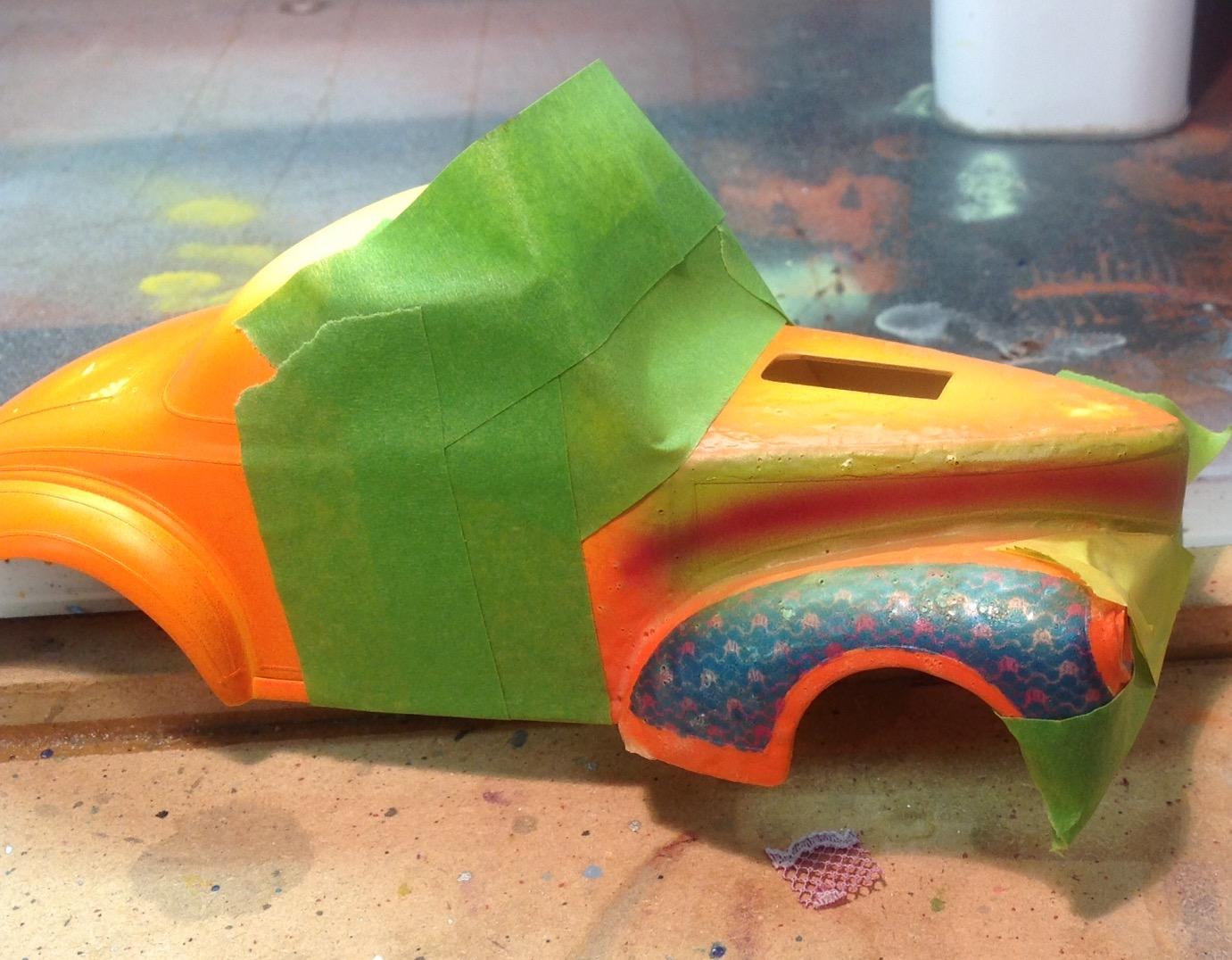

Well tonight I masked off the door panels. You can see the differences. The fish net lace is just so small there simply is not much surface for the glue to adhere to I order to create a good barrier. I sprayed this side with such low psi and at such a distance it took about 10 application to get decent coverage, and still the paint got underneath. I can assure you I burnished the heck out of it first. The pentagram is simply cut and laid mask. -

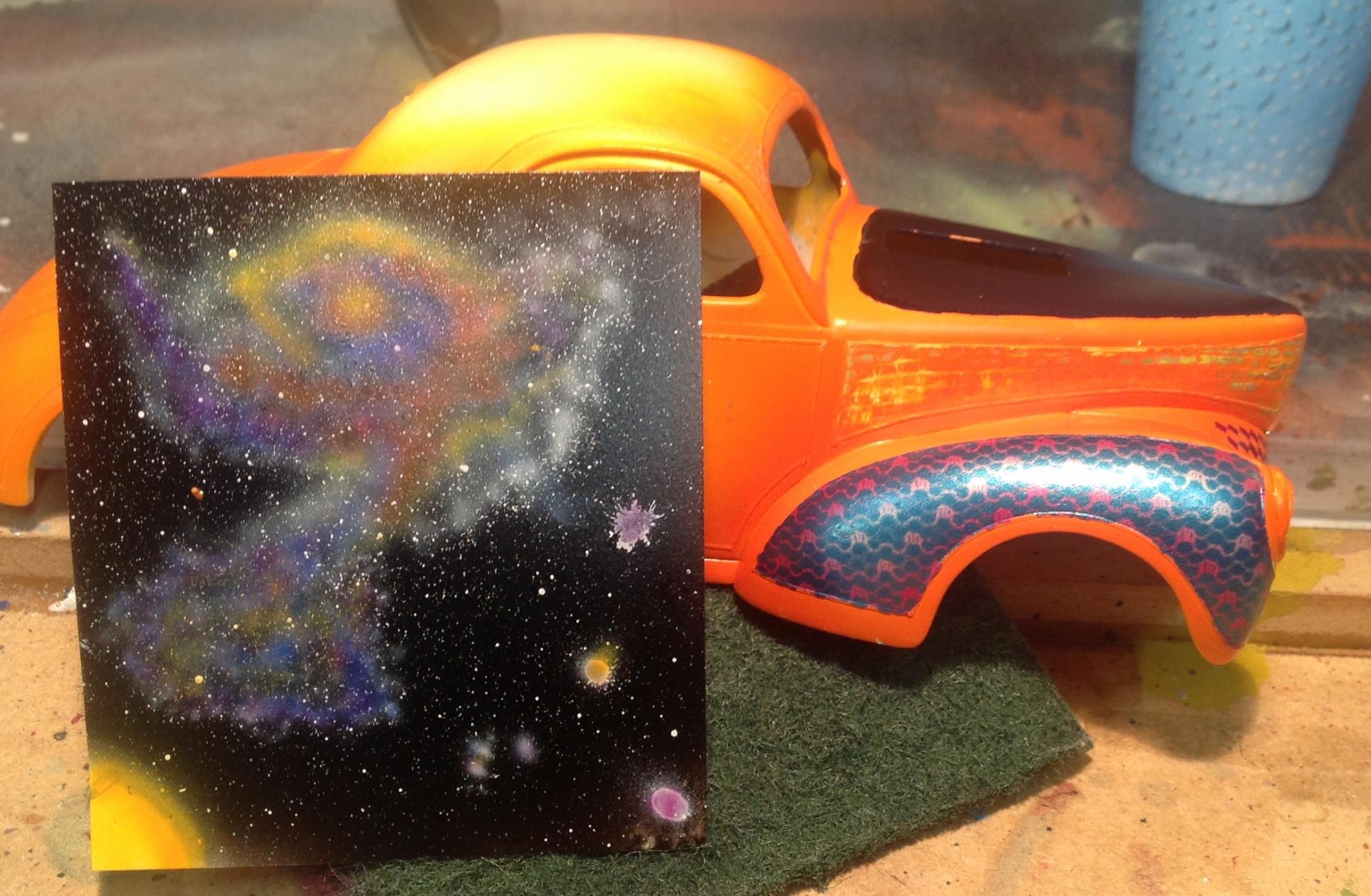

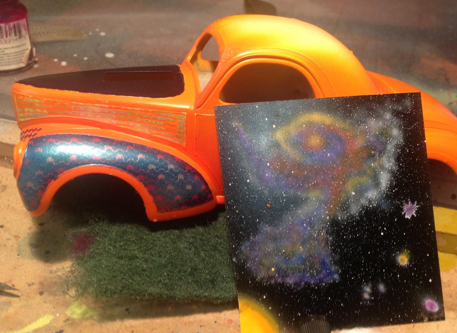

Thanks Will. So now that I have my AB working like a charm with the new needle and crown tip cap. The tip cap isn't really needed. It only protects the needle, but being such a klutz I figure I should keep it on because as you may or may not know needles are not cheap. Here's the cap I am working with now. And the results. Although I am now not sure if I am even going to incorporate them into the overall scheme. They are rather large at 3/16". Anyway I have learned a great deal through the process. These technique is something I thought of years ago, as it turn out it is used quiet often in custom auto painting. It is simply paint laid over water droplets then allowed to dry, the paint settles onto the surface. Then you clear coat it or add pearl clear, what ever work for you. This is white, lime green, then once the water as evaporated I shot clear Tamiya blue then clear violet pearl. It would then get the normal clear that will cover the entire car. This I am going to incorporate into this project. -

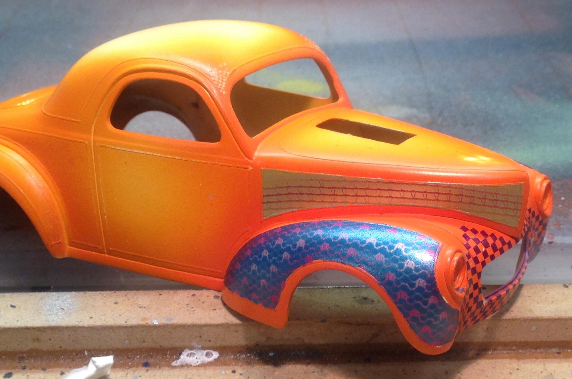

Even though this is an excersice in paining I have to be at least satisfied with each panel. So I decided to start stripping the panels on the side of the hood with easy off. There will need to be a few more application of easy off to get down to the raw shell. I also decided to mess around with the air brush a little. -
