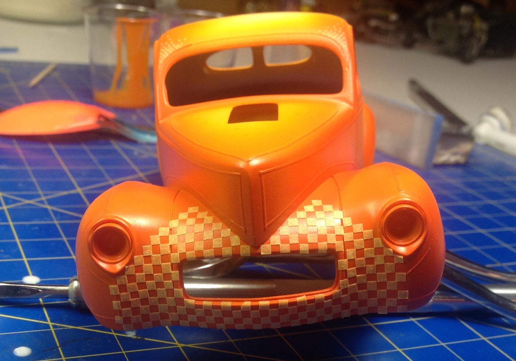

Thanks guys for following along with this process and the kind comments of support. Richard, no worries on paint creep, everything gets a coat of clear before the next colour step. The front end checkers are laid, 160 1.5mm checkers in total. Being hand cut they are not perfect, but after all, much of what we do in 1/25 scale is learning how to make things work. It's all a learning process. -

A-pilar roof junction checkers down, I wanted them t look like they are starting to come apart, unfortunately they look a little too ragged. This is the adhesive causing some of this, I can straighten them some what then they just squirm back. Working with them is kind of like bending spring metal, you have to bend it past the settling point. I am sure they will look fine in the end. Been working on the front, trying different methods of cutting 1.5mm checkers. Finally settled on a method that works. -

Some more messing around. I fashioned myself a double bladed knife to make some more checkers out of Tamiya tape. Wanted to see if it might behave better then the AIZU micro tape I used previous. It works the same, the tape will squirm around after it has been placed then positioned. The key it to place a corner exactly where it needs to be then press the rest of the "checker" onto the surface. Crazy hard to do. The checkers I laid previous were .7mm, today's checkers I am laying on the A-pilar are .4mm. One day I will come up with a better method of cutting far more consistent looking "squares". These were cut using the double blade then I just eyeballed the "squares". Currently working on the other A-pilar. I also fashioned some .24mm pinstripping. Just taking it on a test run on a spoon, hoping to incorporate it into this somewhere too. In keeping with my theme of trying new things I am also currently attempting to create that cracking effect when lacquer is laid over enamel. I am not sure it will occure as I used Acetone to thin the enamel. I currently have three spoons with three different base colours, Tangerine Orange, Light Blue, and Copper, with Tamiya TS-64 Mica Blue Lacquer over top. I really hope it cracks, it better BLAH_BLAH_BLAH_BLAH well. I have had enough back luck with past paint jobs If anyone of you more experienced builds have any sure ways to to this please post it up. I would gladly try your suggestion. If I can make it happen I will incorporate it into then lay out. I will have another update later today. -
