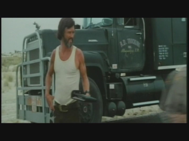

As I have mentioned before, I have this kit...so I will follow your progress. Regarding the tanks, it's not only the straps that are wrong, the steps are too short and the fillers are at the wrong place, they are in the middle of the tanks length wise in the movie as can be seen in the picture below (both sides are the same). I don't know but is the hood side emblem fixed, the ones in my kit reads RL700L, RL stands for R Western model with Lightweight frame (Aluminum), the movie truck had RS700L emblems and the RS stands for R Western model with Steel frame...slightly different but it should be right. The last L after the 700 stand for lightweight components on the cab, aluminum doors etc. -
