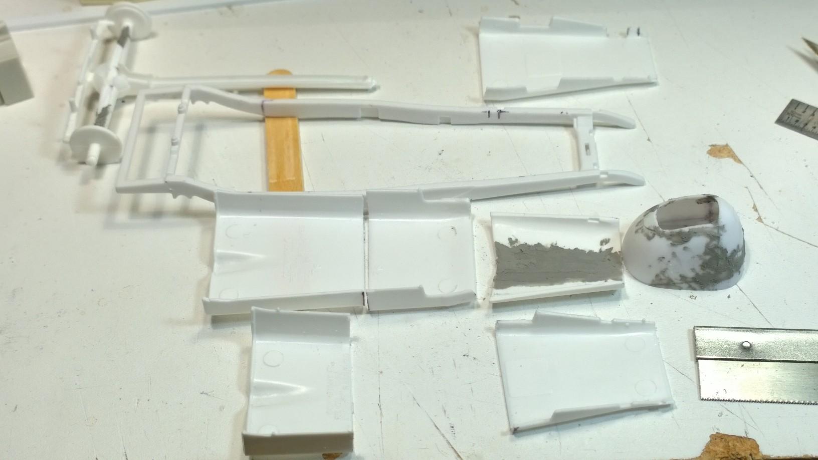

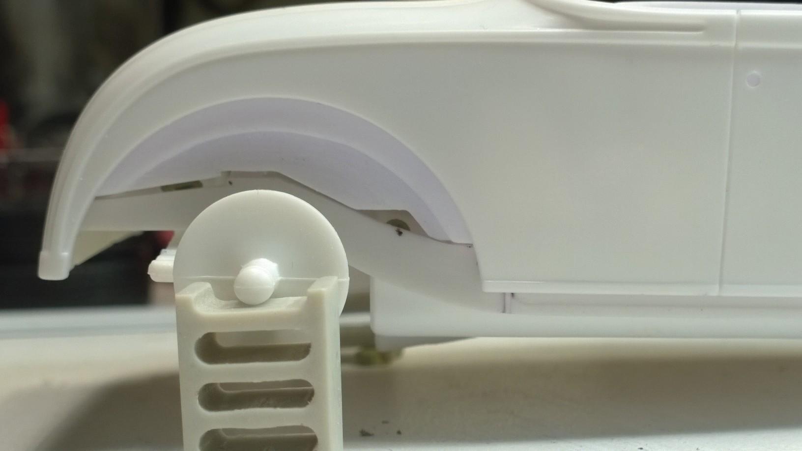

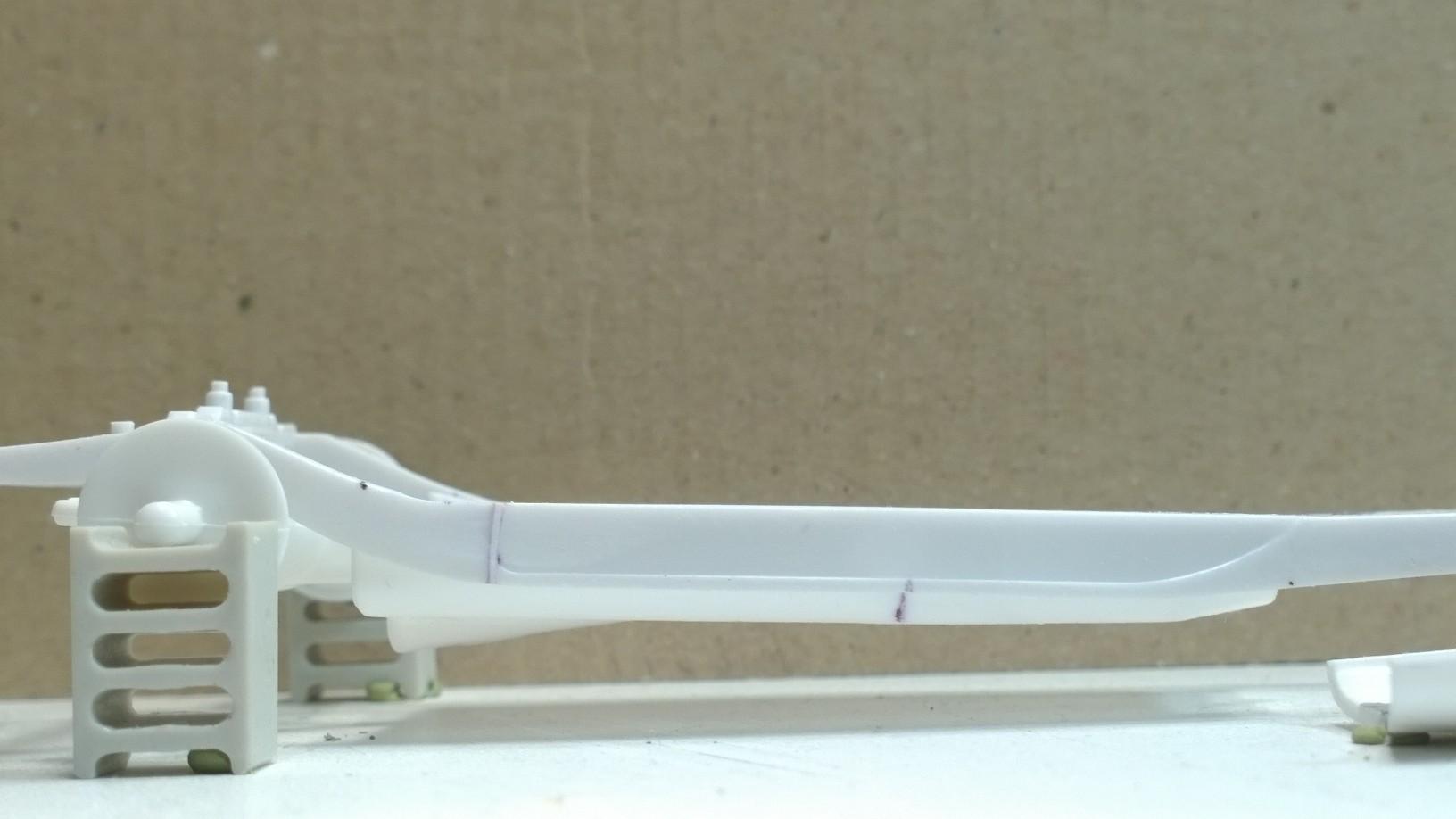

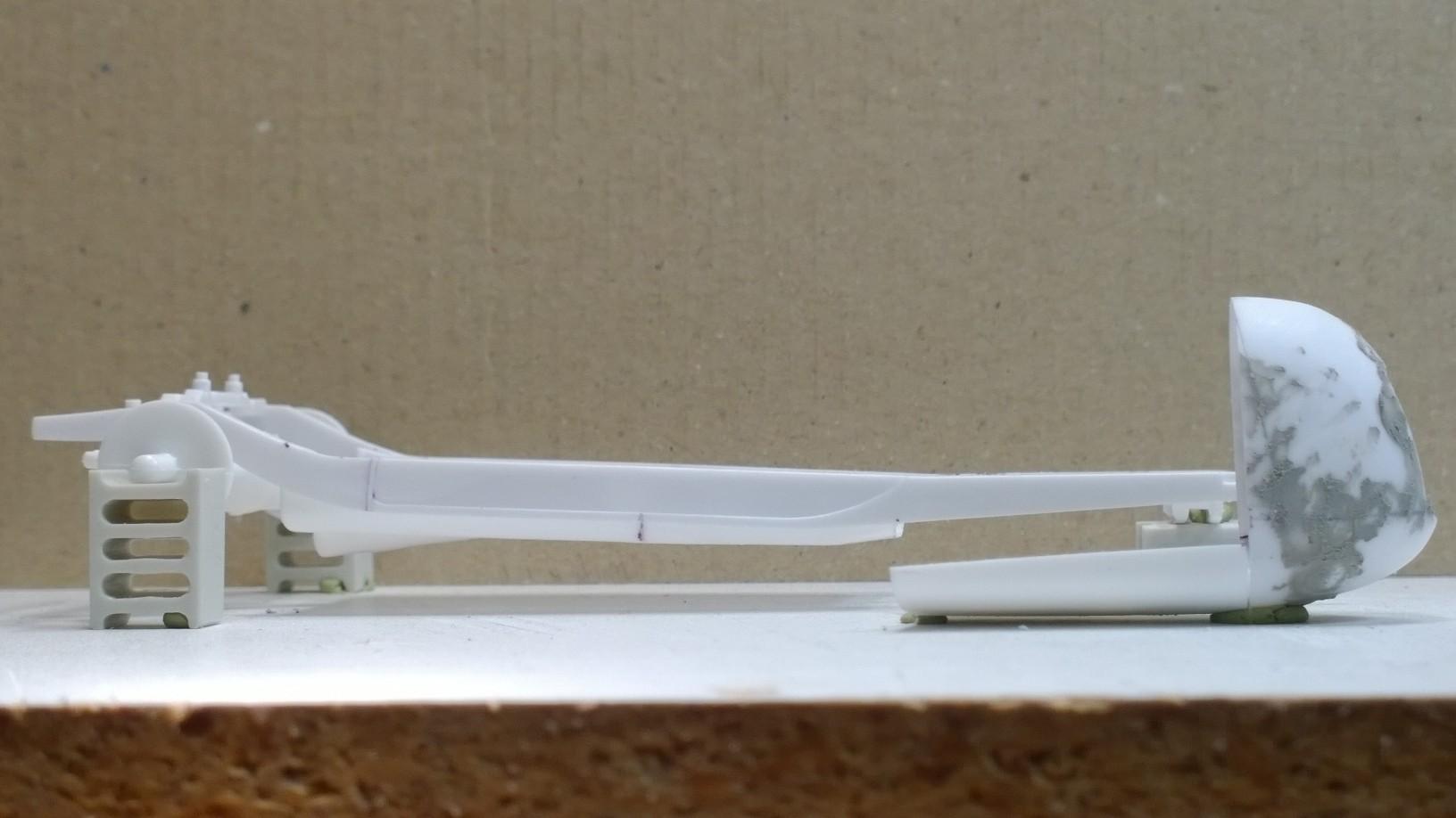

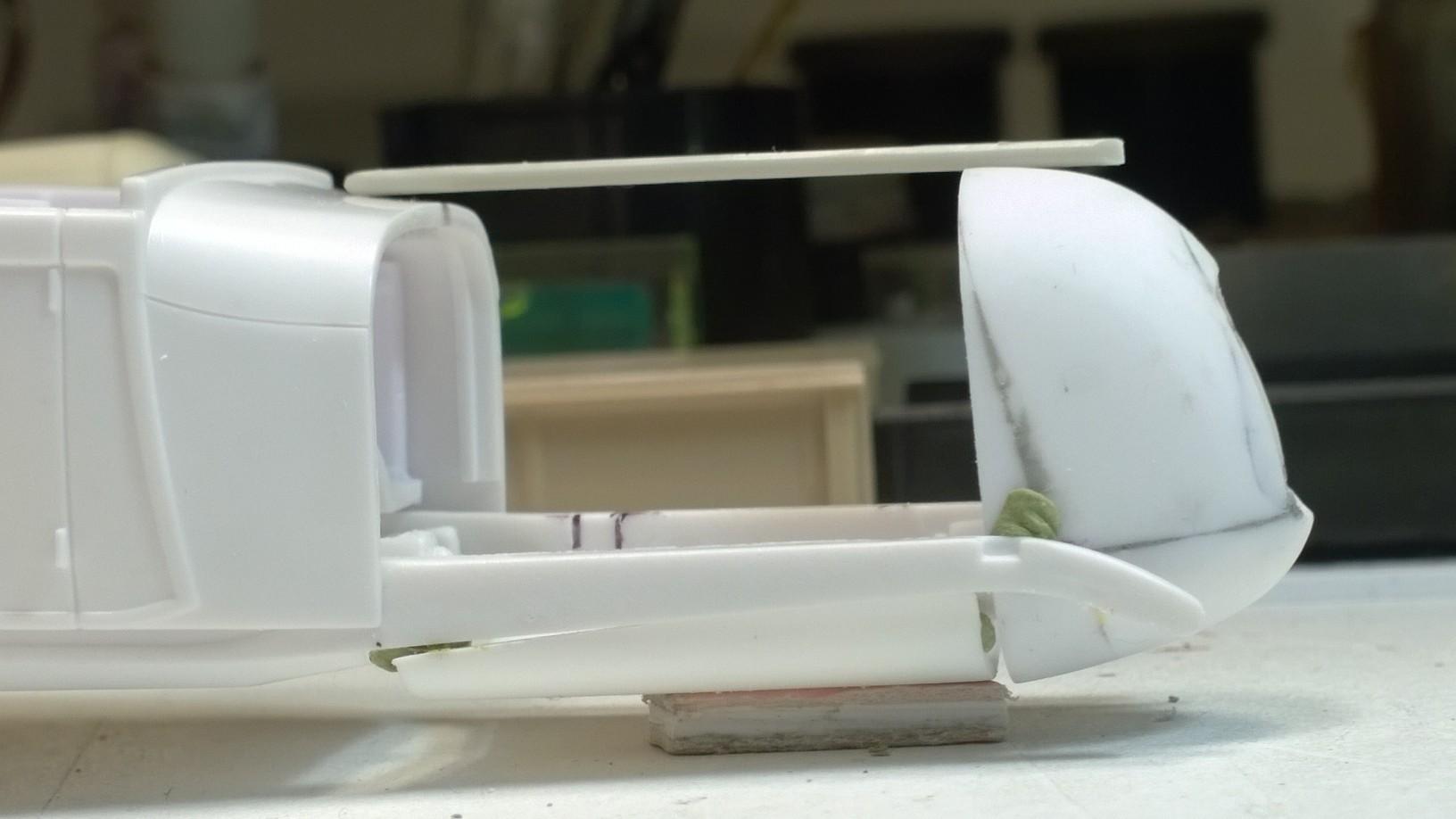

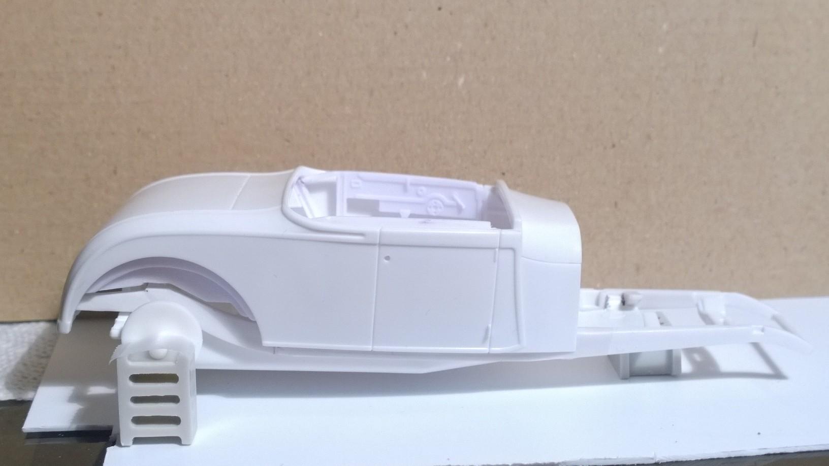

  2. Quick update: Wheel Wells set in place! Left Right Let's take a look at the belly pan: Inside: Underside: Backside: That's all, Folks! -KK

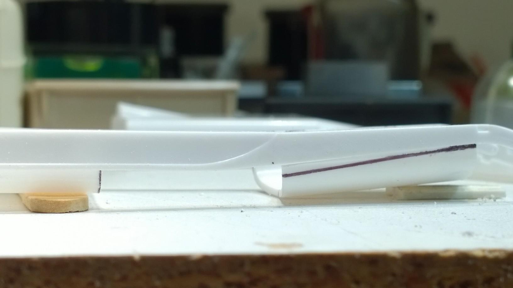

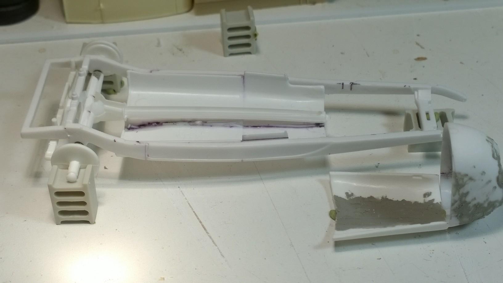

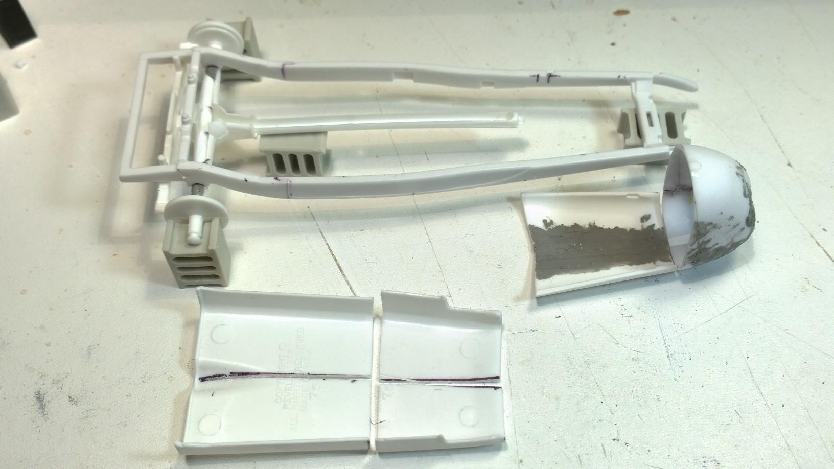

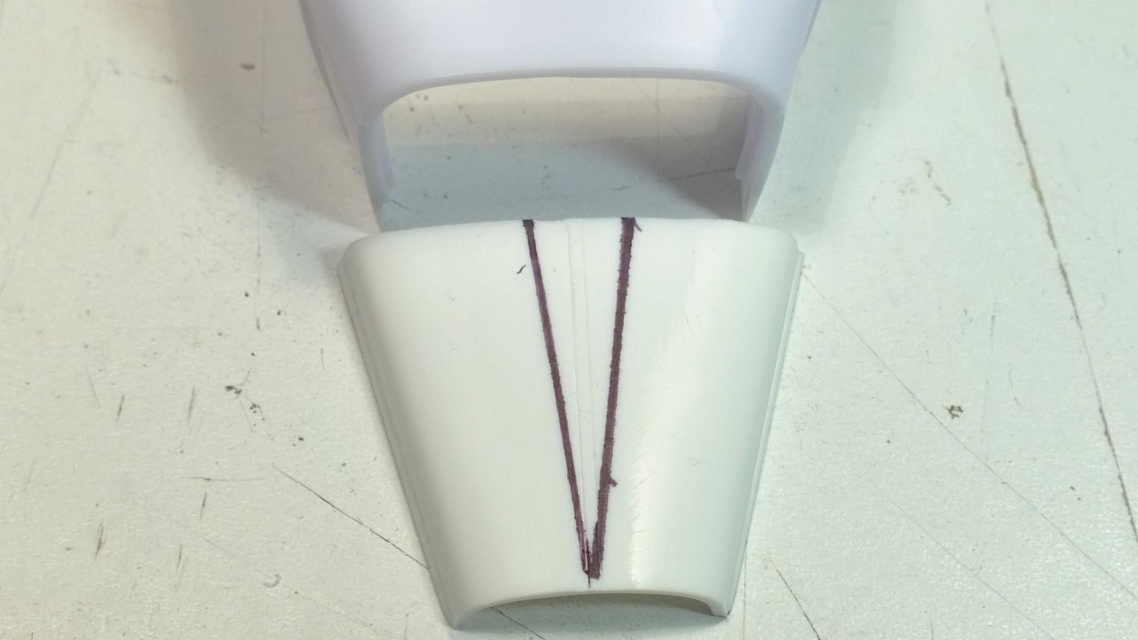

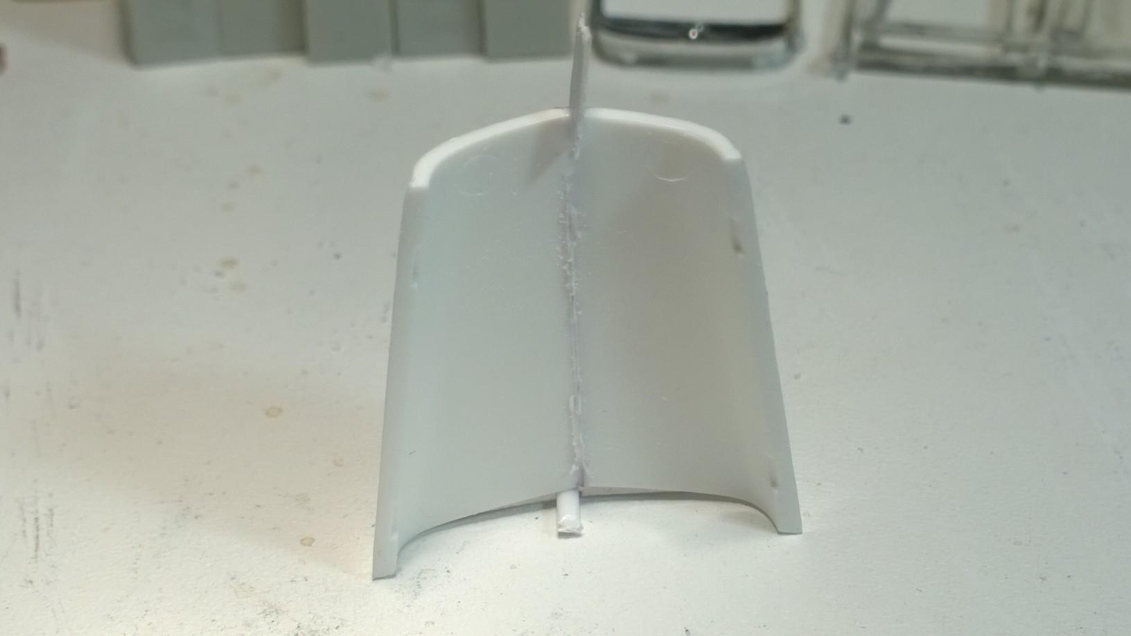

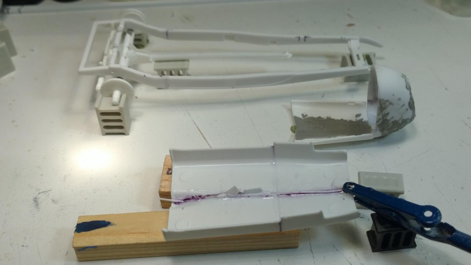

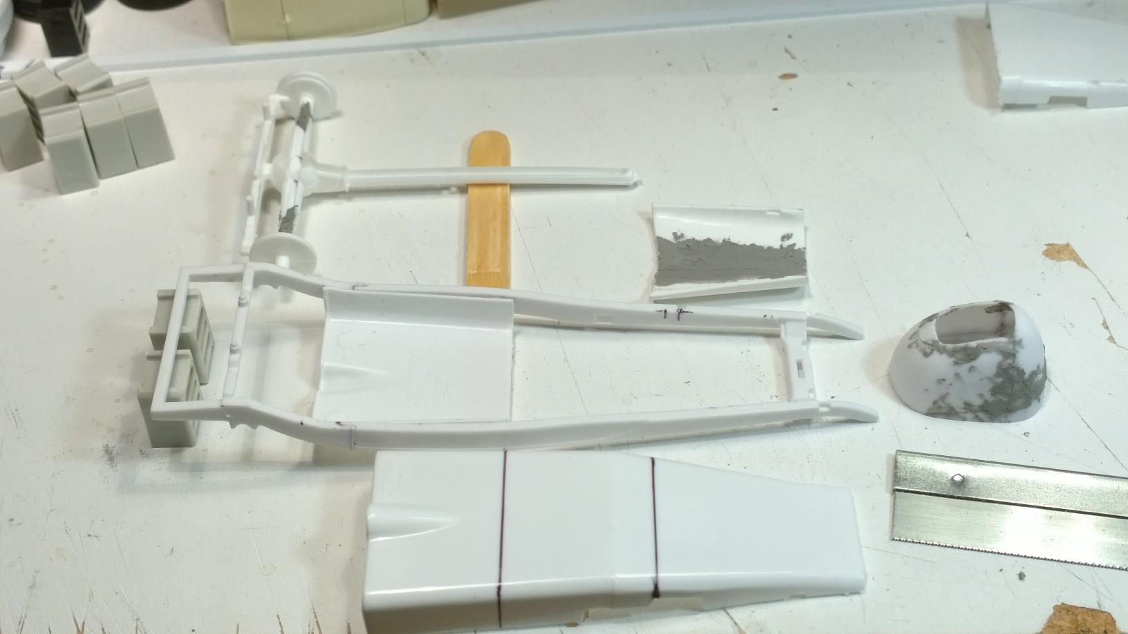

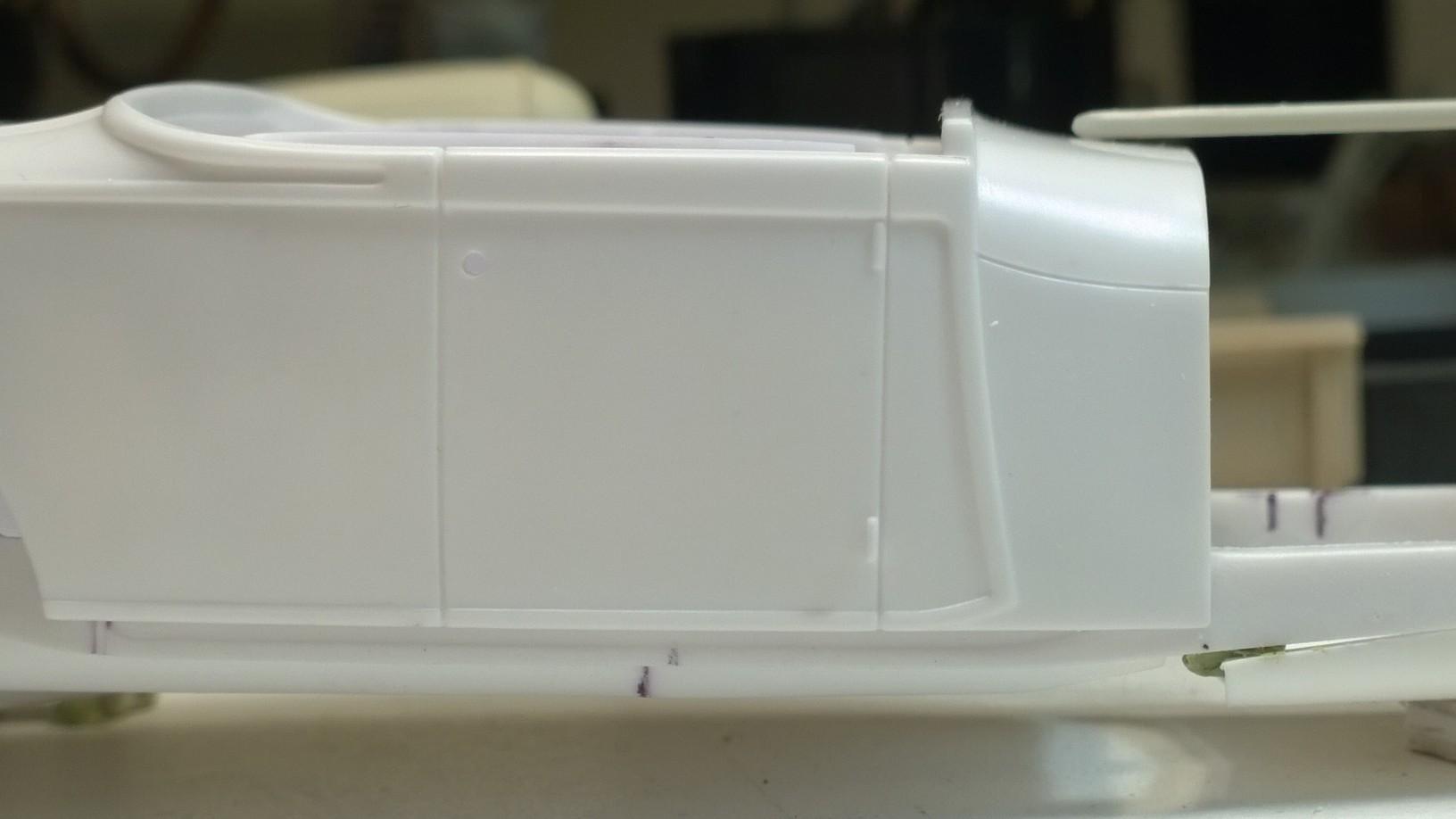

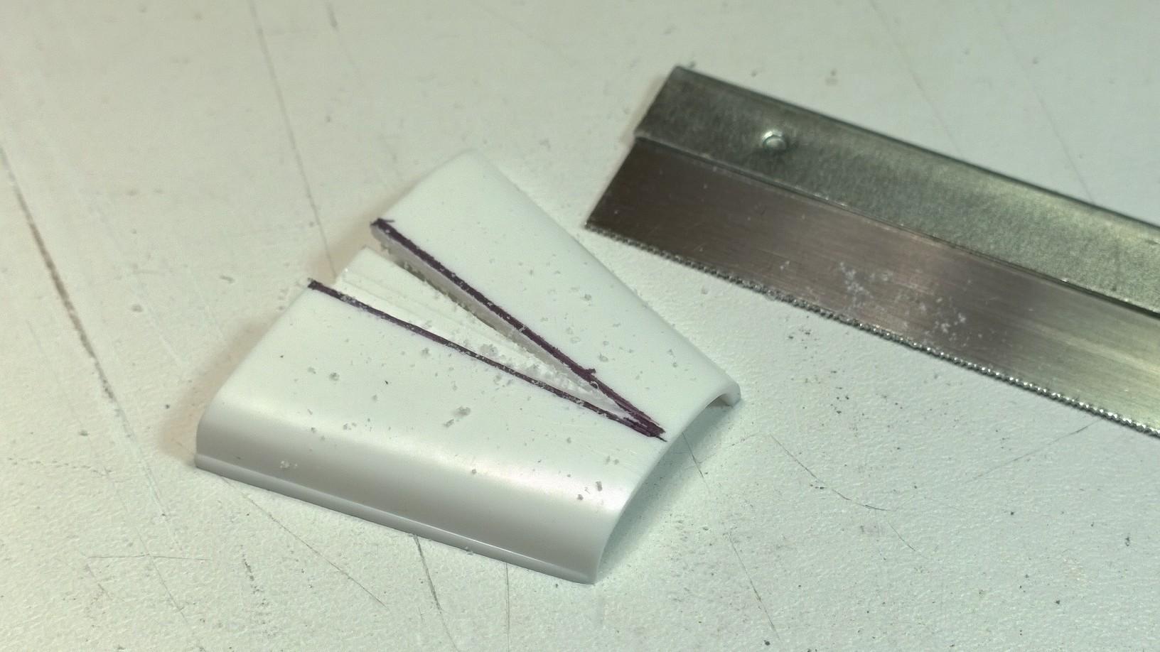

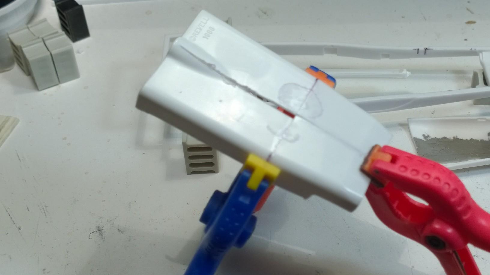

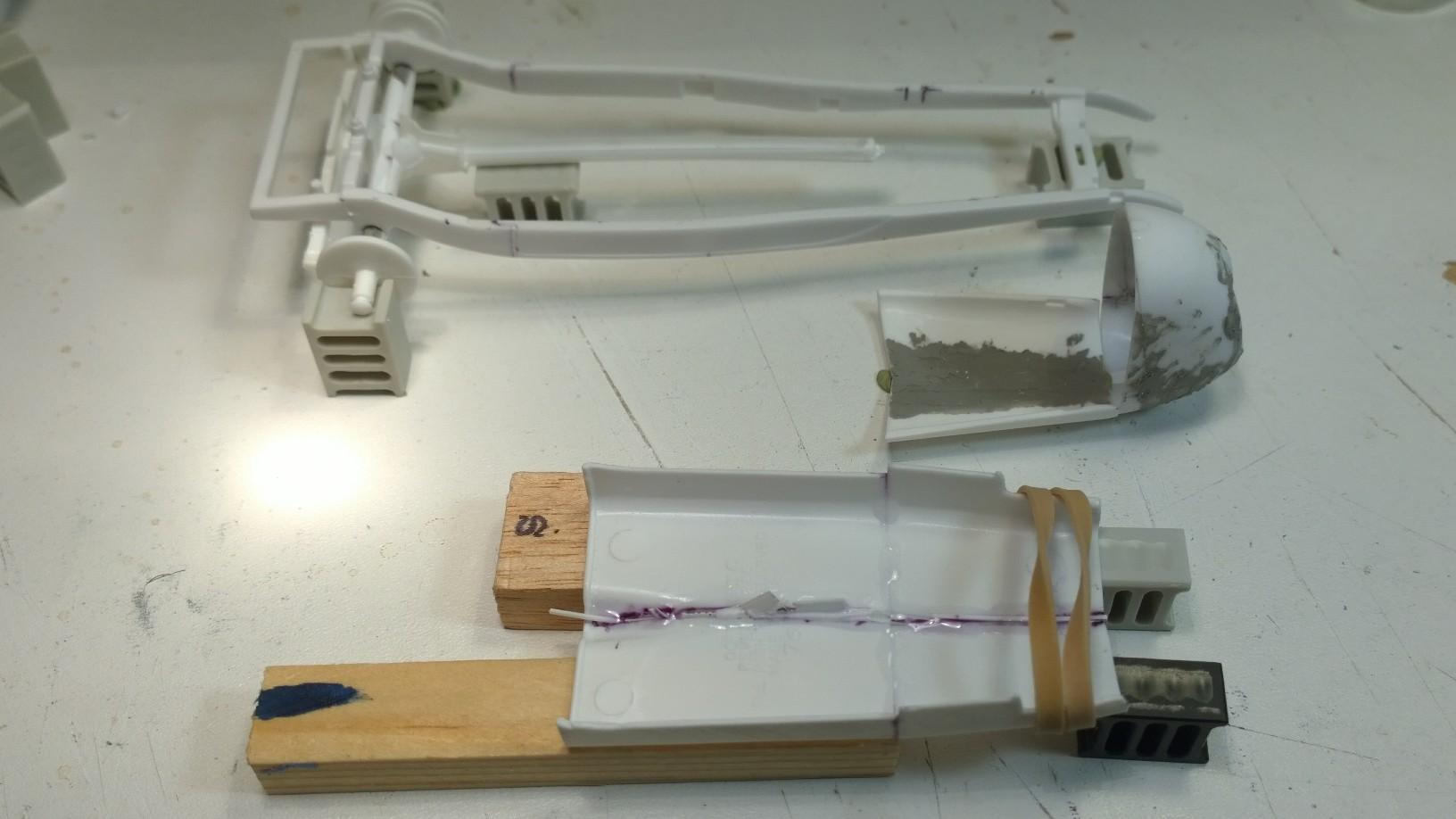

  3. Continued progress on the right side of the outer belly pan... Marking the cut line... Will be using toe line on the left to cut along... Angle cut leaning towards the outer edge... Tuck inside of the roadster body panel to mark the lower cut line... A little sanding... Beveling the inside of the outer apron to fit the rolled edge of the inner belly pan... Both sides shaping up and beginning to more closely resemble each other! The pinched inner wall will get a little relief and should stand pretty much parallel to the outer apron. Secured and moving forward... Marked out the initial cut lines... Shorten up the lower edge of the right forward apron... Minor patch... ...or two... A couple drops of CA and the rear section is laid in place... All bound up for the moment... As with the left side, laid a small rod in the seam between the inner and outer belly pans. Came out very much like the first side... ...and the second side, too! Add some mud... It'll have to set up a tad before hitting it with the sanding regiment bringing the surface down to final filing level. -KK

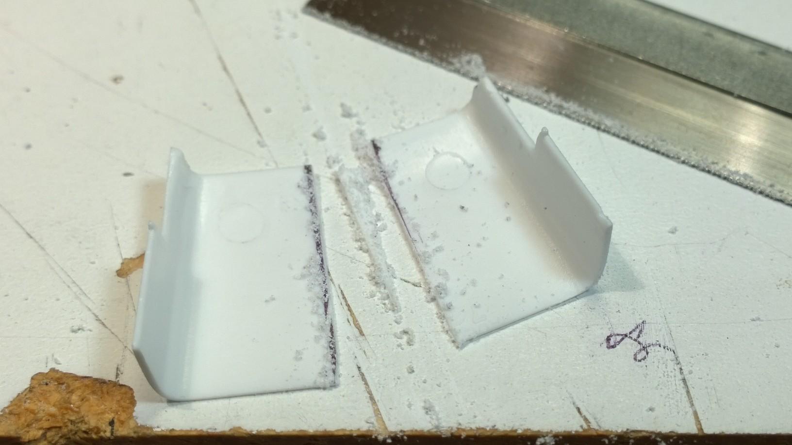

  7. Got a wild hair and decided to cut up some old plastic! Look close: Revell Orange Crate Belly Pan... used a couple to make the inner belly pan and will cut up the leftover pieces to extend the belly pan beyond the deuce rails... Looking at these they might work... Then the other forward piece... Cut the outside edges to add to the existing inner belly pan... Trim off a little wide (leave the line) to allow beveling the edge to overlay the outside of the inner belly pan... Looks like this might mate up end-to-end... Fast forward and test fit the left side apron: Looking very promising... Starting to take shape... Trimmed down the forward section of the outer belly pan... That'll buff out!?. Still a little rough around the edges... Laid a thin rod down the joint between the inner & outer skirts... A bit of slight of hand and it looks like it belongs there! -KK
