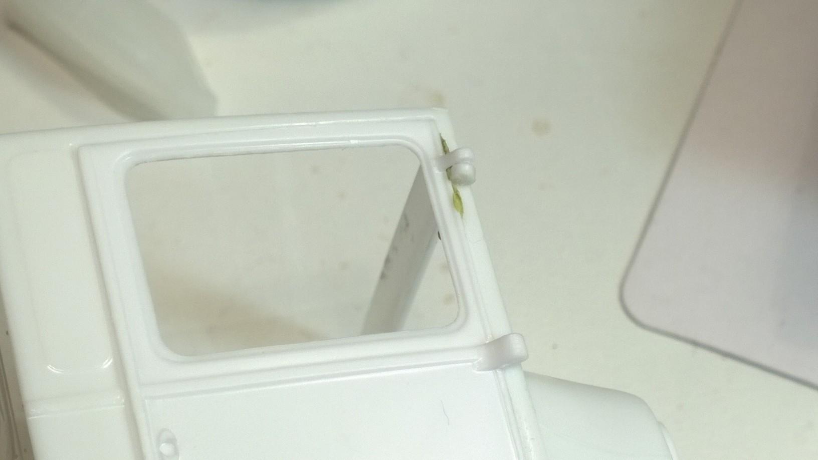

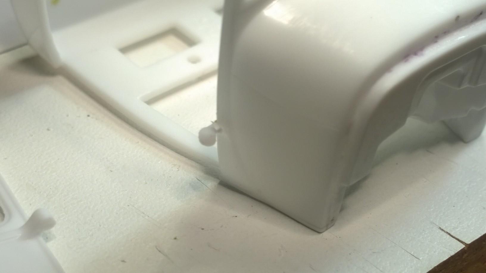

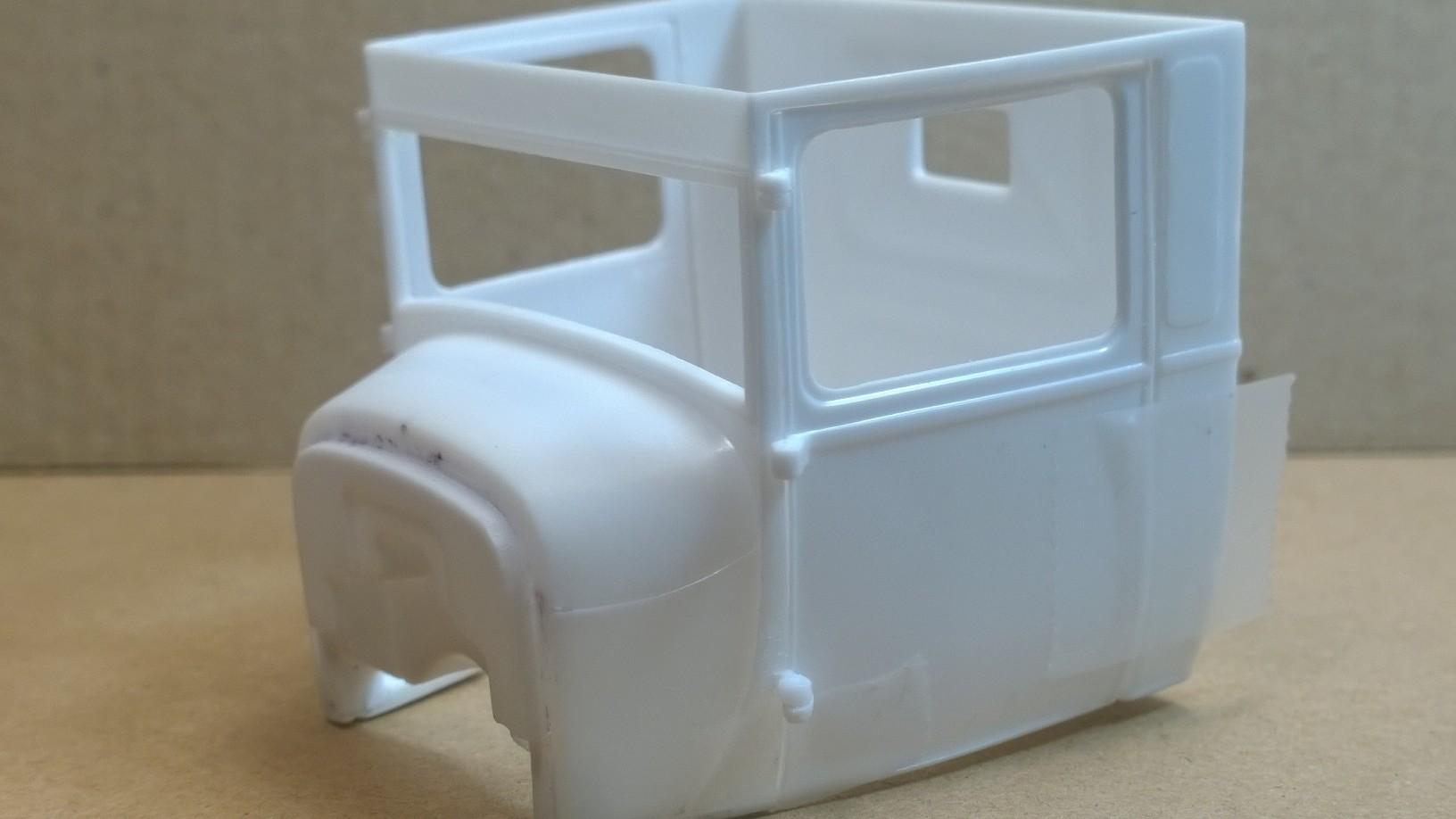

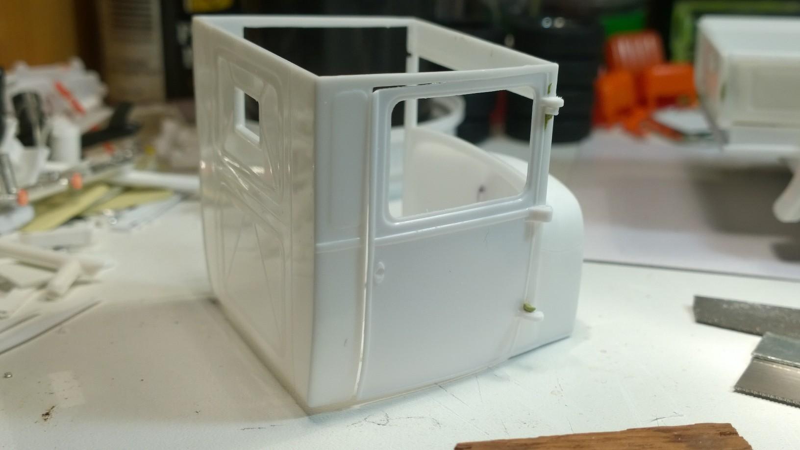

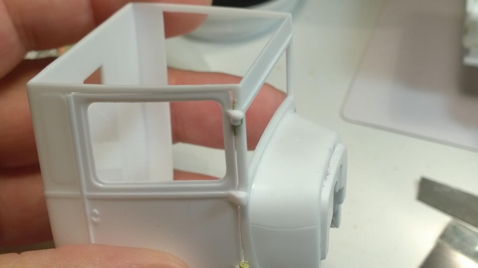

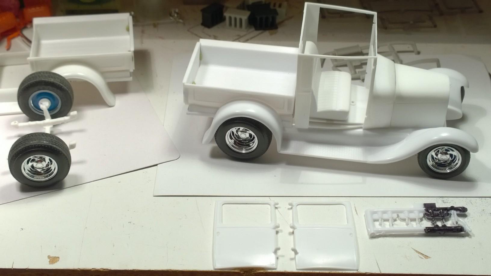

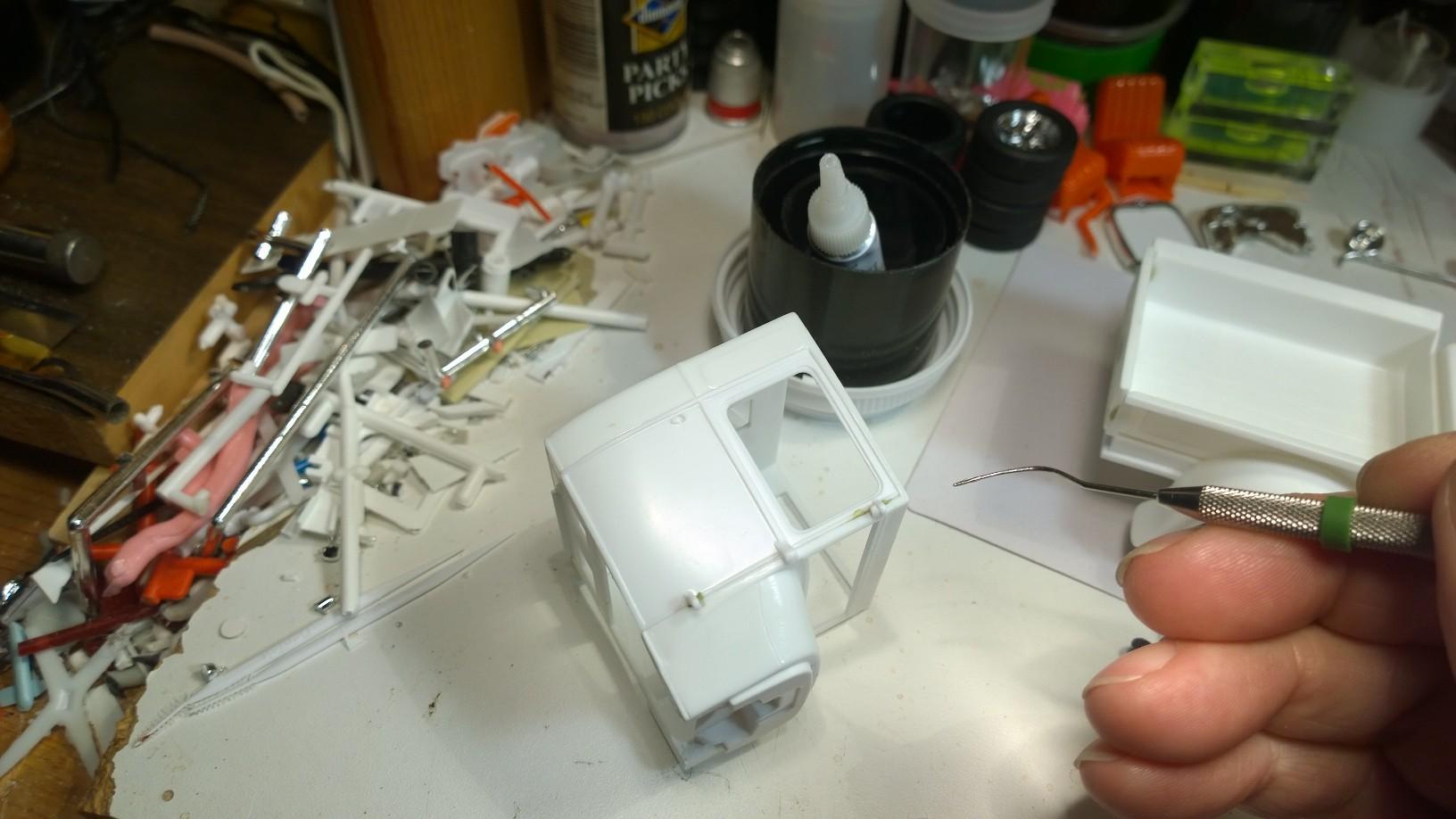

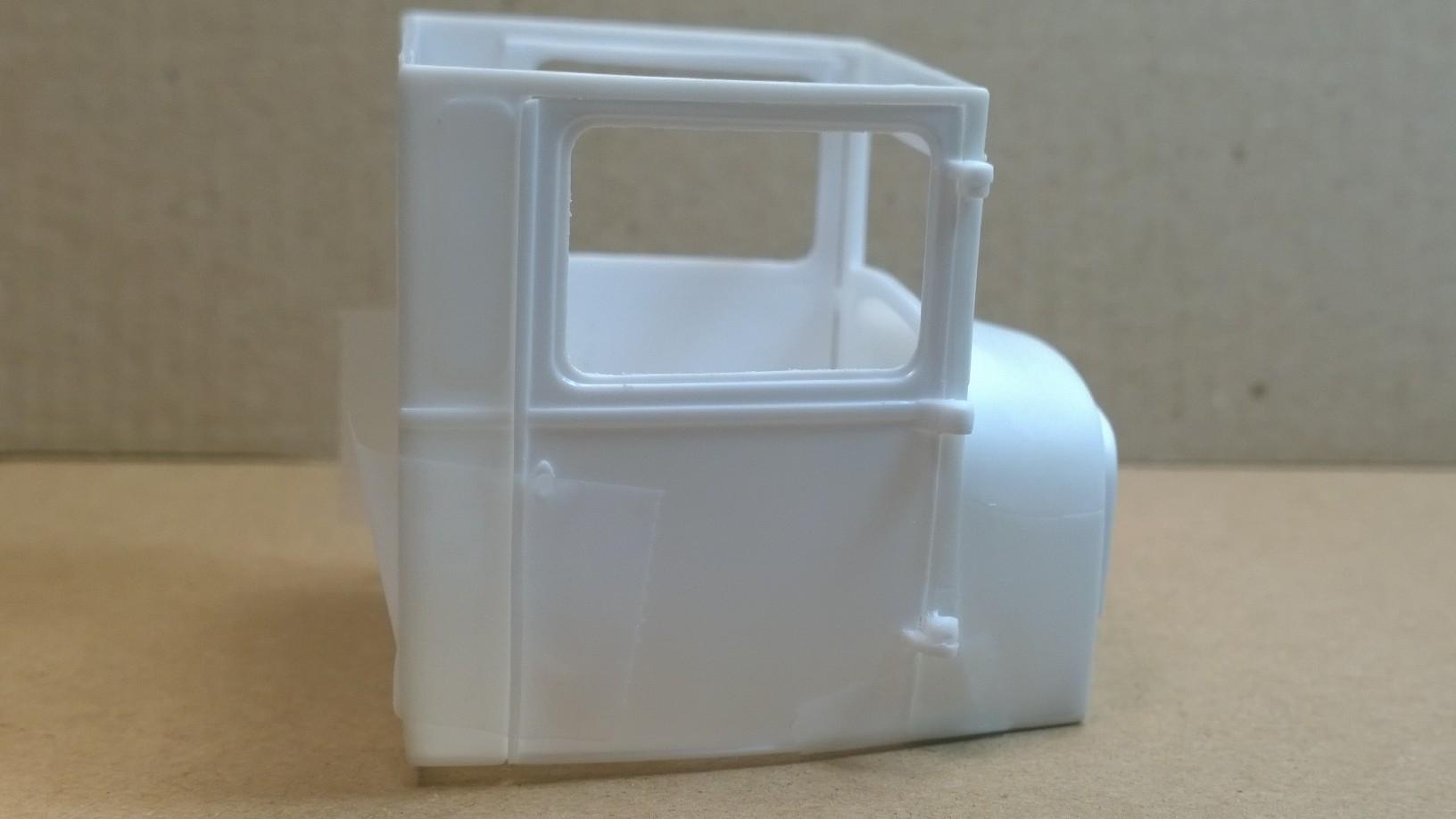

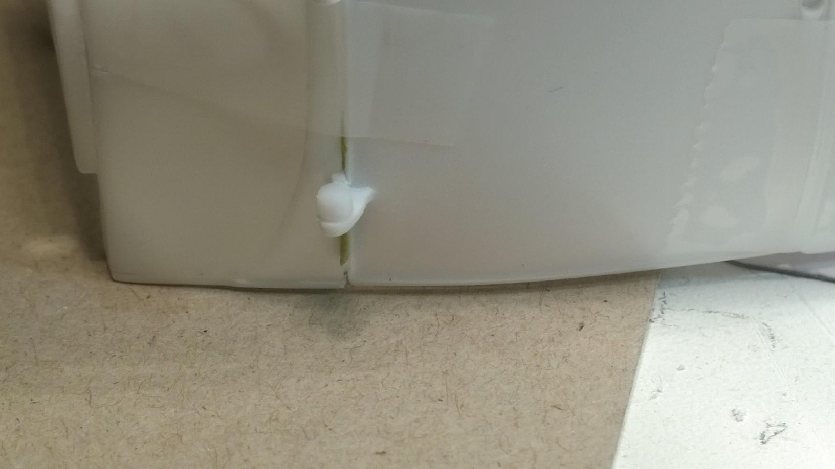

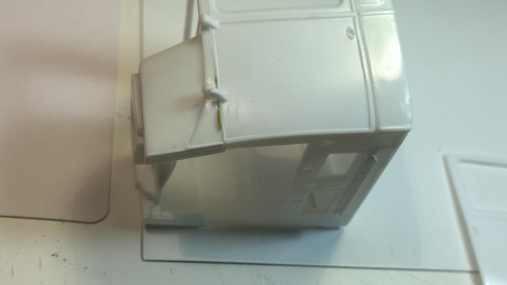

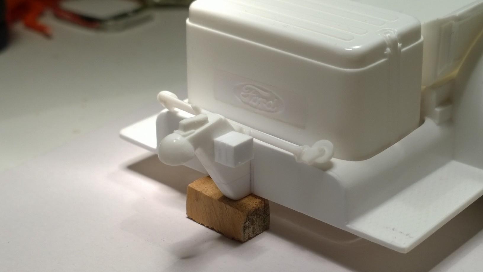

  5. Here are the step-by-step pics of the '28 Ford Sedan De-Construction: Cut measured strips of masting tape to create uniform cutting guidelines: The same width was used all the way around: Started by cutting alternate places to retain as much of the intrinsic strength as long as possible: Making sure that the cuts through the C-Pillars are cut all the way through... Just about done decapitating the Model A's top! Thought about stopping right here and going with a Chopped Model A Sedan! ...but, NO! We will be sticking with the plan!!! Lining up the cutlines across the first section cut: ...then lining up the parallel second cut... ...made sure that the cut lines were made as close to being right angles to each other! Let's check... Looks close... Let's move on with shortening the body... Off with the backend... Now, let's build the XPU Cab! Clear tape will assist in lining up the aft cab... Set it together and apply some adhesive... Check door fit... Rubber band the forward cab to the A & B Pillars! How does it look so far? We'll leave it here for a little while to let it setup...

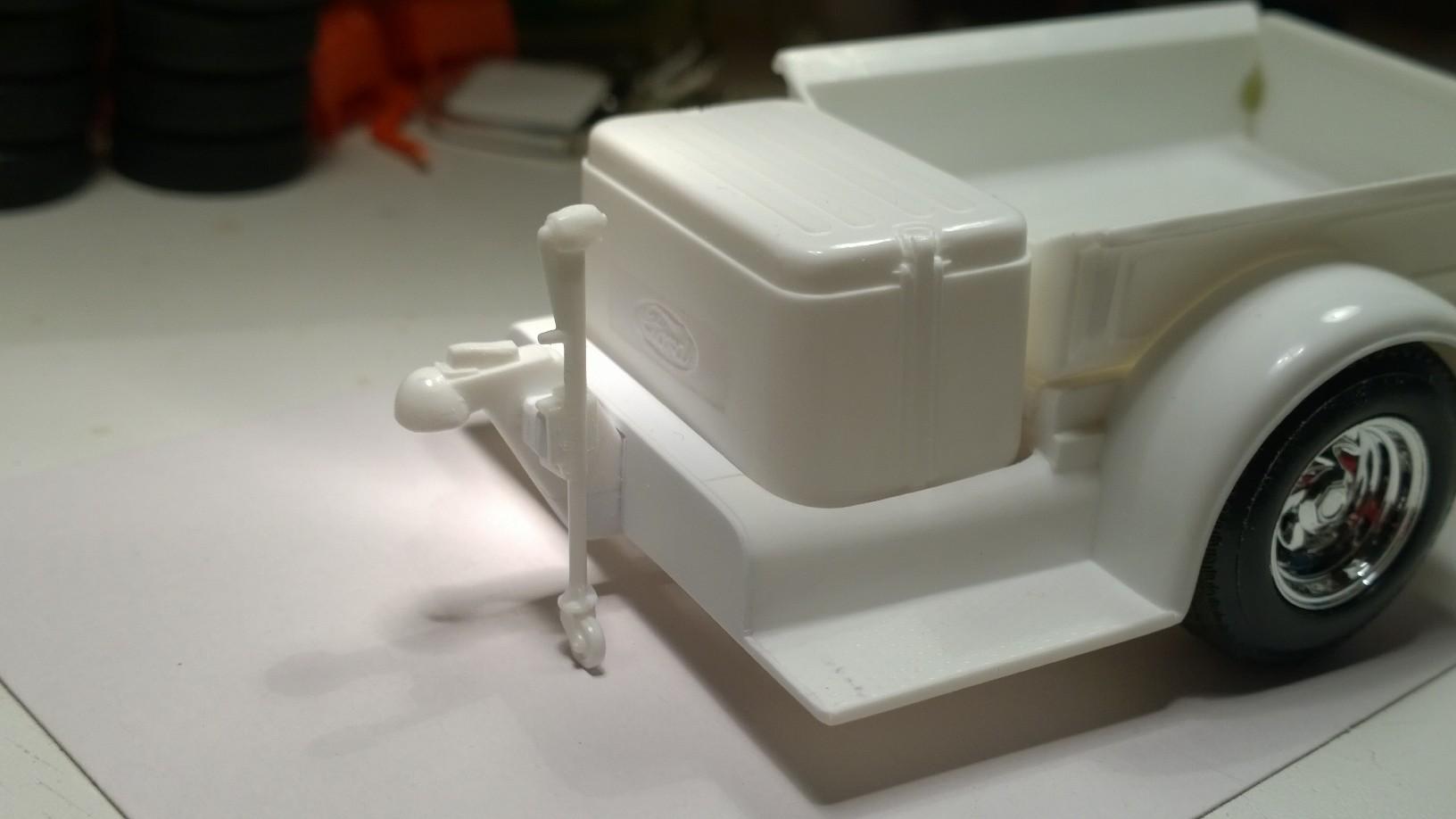

  7. ADL, we are so on the same page! From my initial measurements and considering the centered single seat version: The Steering Gear (suit sprint car) is from The Parts Box: http://www.thepartsbox.com/ It may require both centering the weight of the engine rearward and retaining legroom for the pilot as a rationale for a bit of frame extension. A longer wheelbase is also a plus along with a slightly stretched hood will add to the sleek style of a '29 Track Nose Roadster! -KK

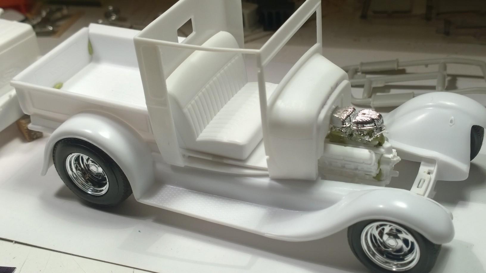

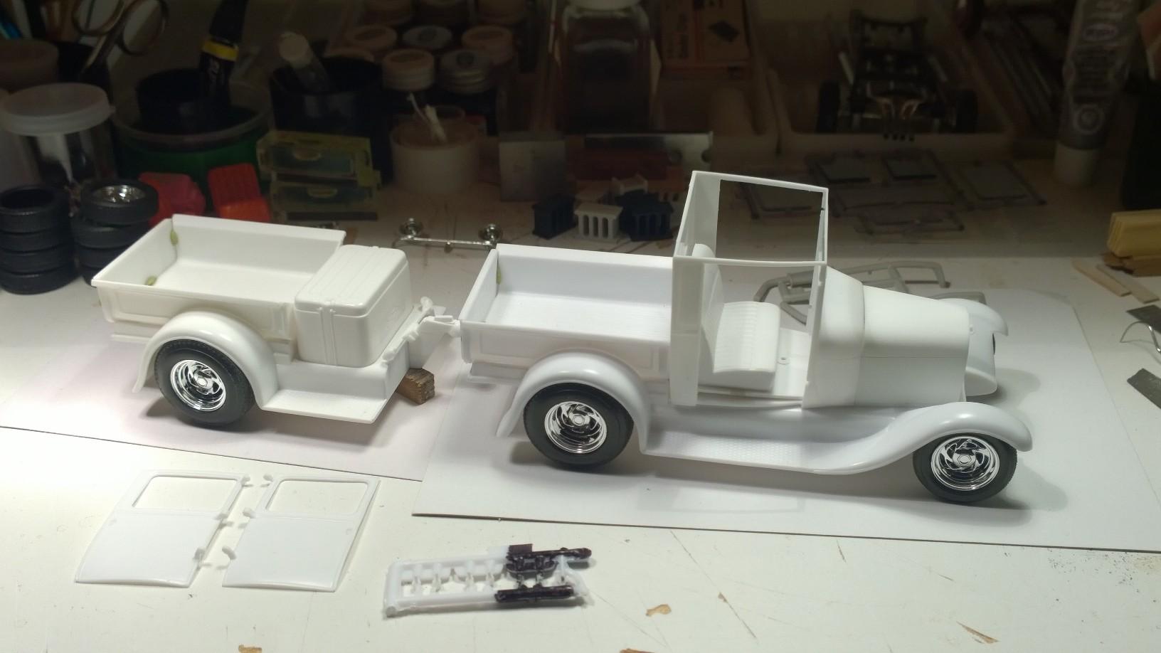

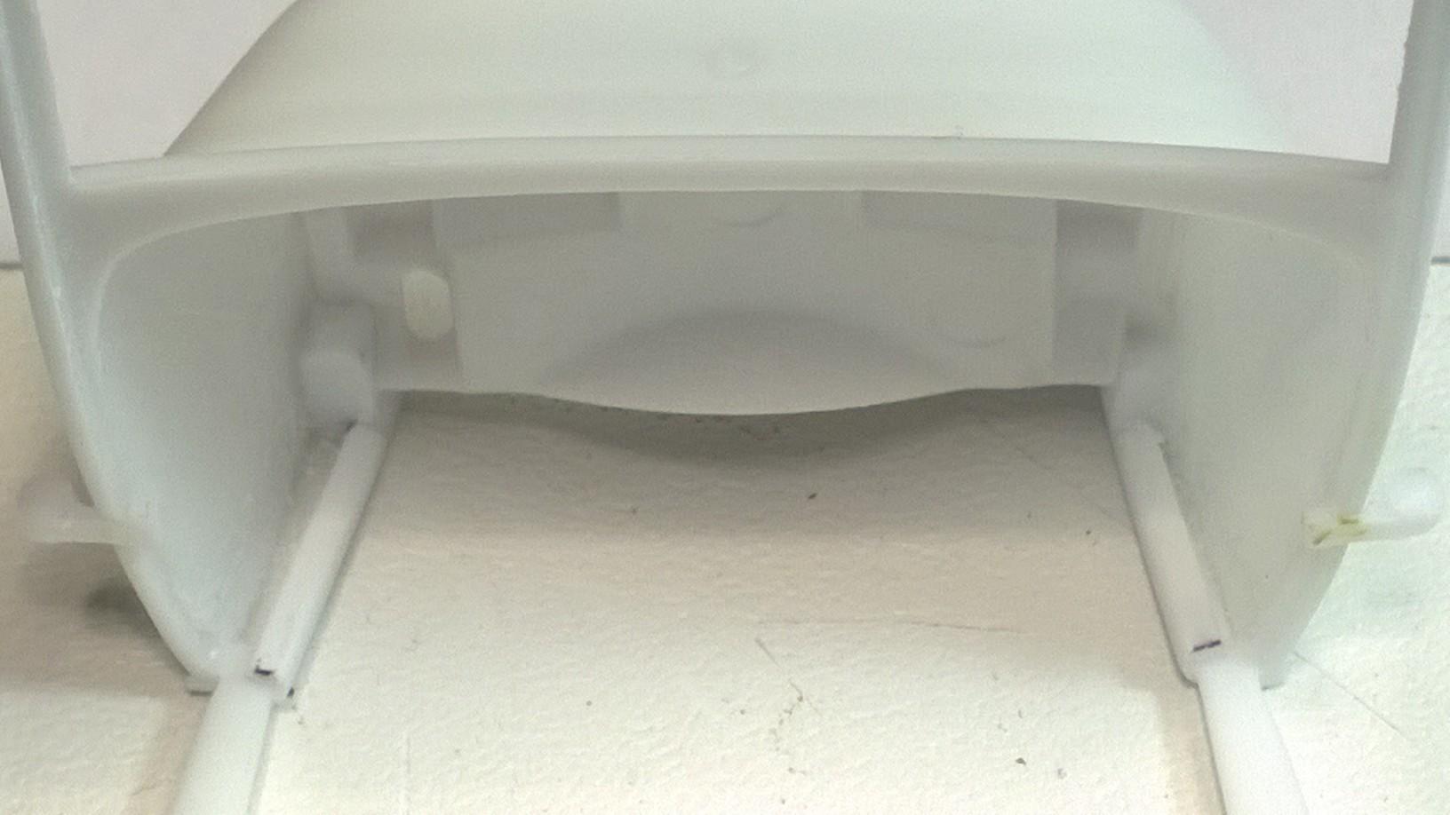

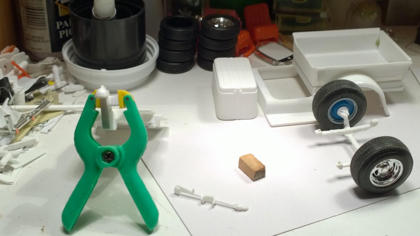

  10. Because the Revell '29 Roadster kit offers a choice of two frames, the '29 Track Nose Roadster will be running on the '29's Deuce frame. Revell's Deuce Rails are designed to allow the builder to have a High Boy roadster. Looking down at the deuce rails you can see the difference between the rear of the frame designed to fit inside and under the roadster body: To achieve the track nose's overall height the body will be channeled over the frame, so modifying the rails to fit under the body took some studying. Here's the before and after: Narrowing the '29 Deuce Frame Notches Kut Out Might have to lengthen the Narrowed '29 Deuce Frame to fit the '41 Lincoln V-12 Flat Head
  11. Me too, David! Although, I had to change the attitude of the track nose from the Revell '29 Roadster/PU kit: '29 Track Nose Roadster‏ Mock-Up after Surgery Need to lengthen the hood... -KK

  13. It's the stock manual transmission out of the Monogram 1/24th scale 1941 Lincoln Continental Convertible.

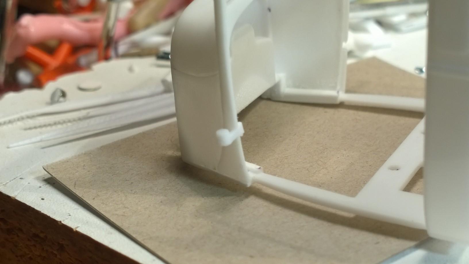

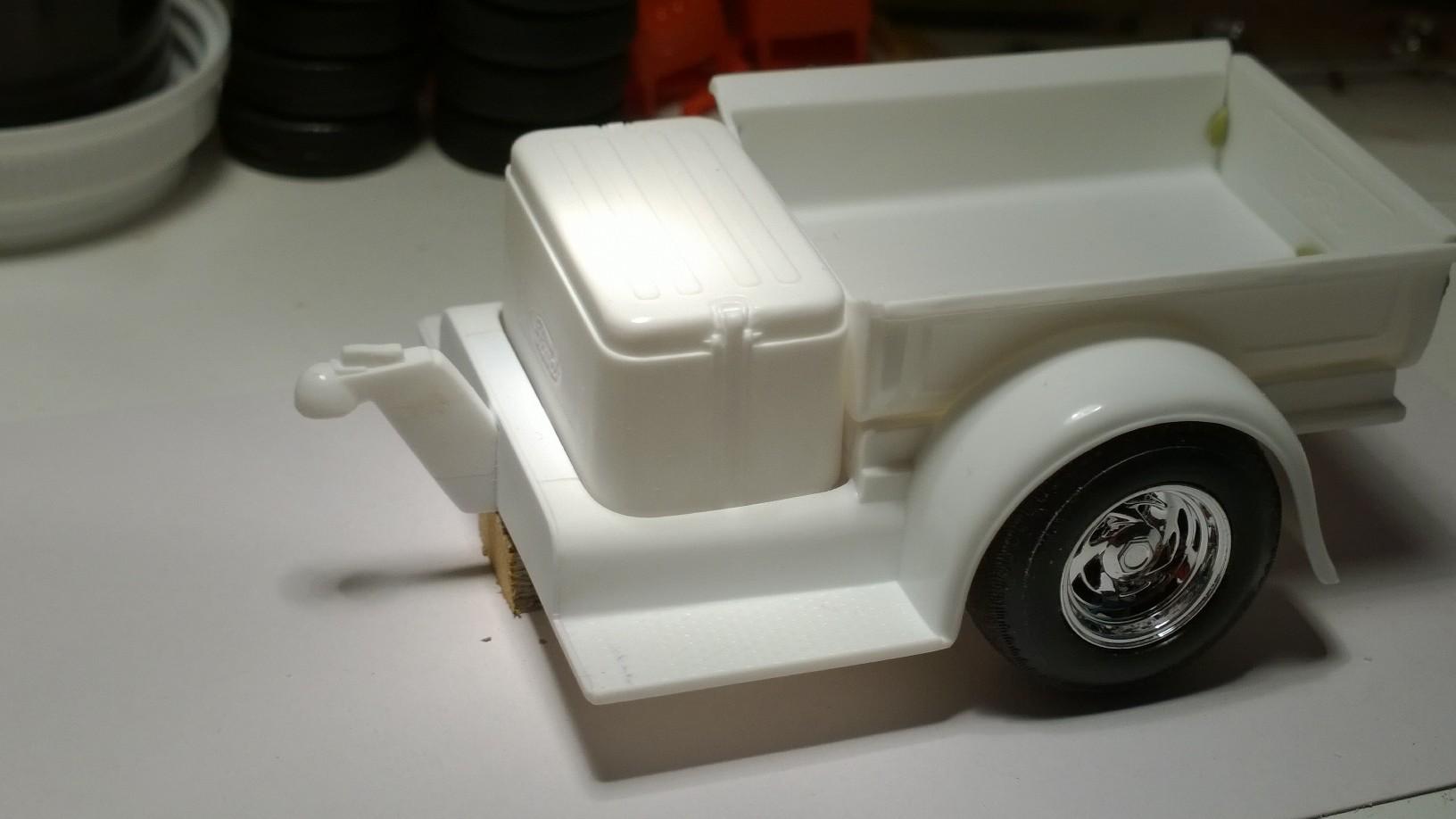

  14. WOW! Yous guys are really a boost in moral!! Let's not concentrate on if it fits in the COMMON KIT CLASS reg's... I quite building to win trophies decades ago. Often times, especially our own club NNL, I won't even resister my builds... I find a place on the right table and set it down and walk away. Over the years judged events have fallen under great criticism, from unqualified judges to overly strict rules. Oh, and the NNL's have their problems, too! Stuffing the ballot box to bias or awed crowd response that really misses the craftsmanship and originality of the builder. True "Beauty is in the eye of the beholder", but Mom always said, "Beauty is only skin deep" real builders notice the insignificant details, even if they will not be seen by the casual viewer. Don't get me wrong, there's an honest beauty in a well done "Curbside", whether stock or kustom even with shaved-down tires just to get it to sit lower! On one more issue... if it's not street able, then it belongs in another class than "Street Machine" especially if it has racing slicks out back. Enough of my rant... Spent a little time bracing all of the point cut lines to keep everything in place while cutting up the body: I noticed a couple of mismatched door seams, especially between the A-Pillar and the leading edges of the doors: Even though the body came out of a fellow builder's junk body box it's the perfect subject for this project! Here's a note of future interest: the same day I decided to pull the trigger on this build I mailed @Rocking Rodney Ratthe other '28 Sedan that came with the junkyard dog body featured here. If you haven't seen this kit before it's because it may predate many of the forum members. I had one minted in the mid '60s that was stored, untouched, in a shed behind the folks house when I left for bootcamp. Only to return to find all of my kits gone! -KK

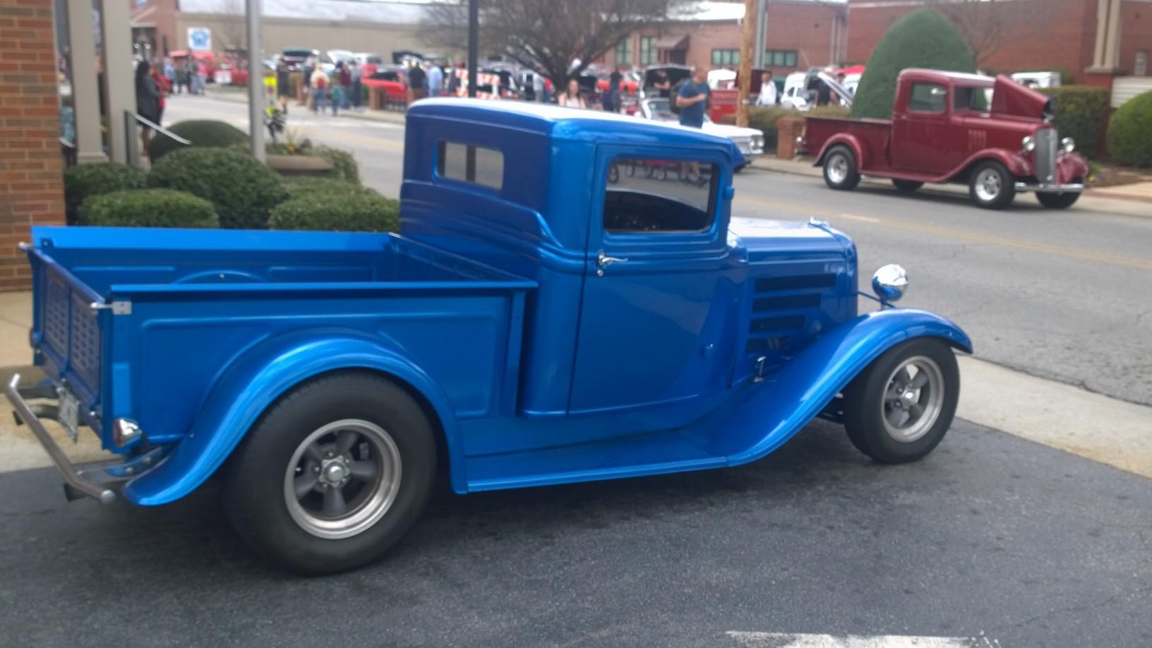

  18. A friend of mine built this from pickup cab using the Revell ‘30 Model A Coupe kit with the addition of a modified AMT/Lindberg ‘34 pickup bed. Facebook His '30 Model A Pickup started with the Monogram 5 Window Coupe
