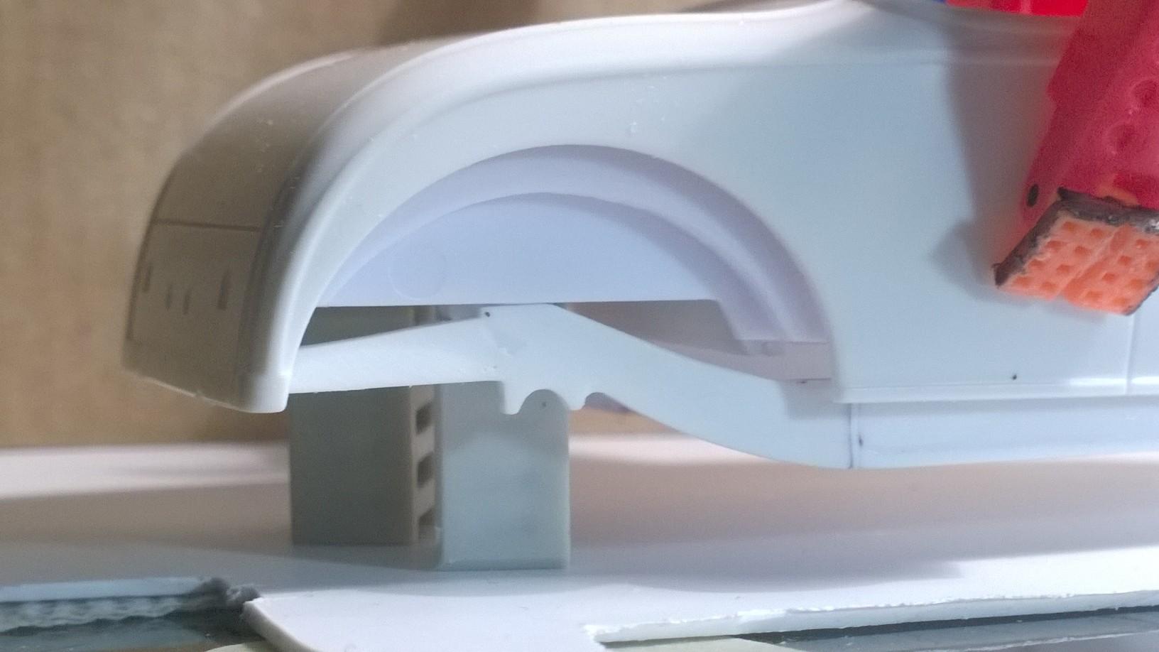

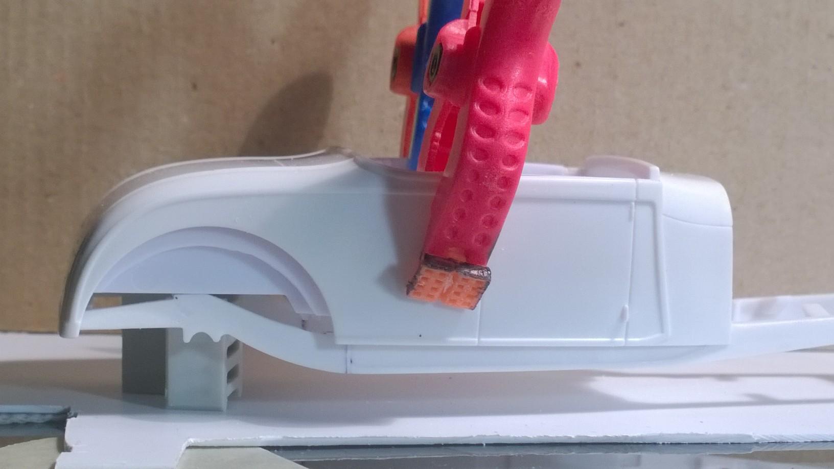

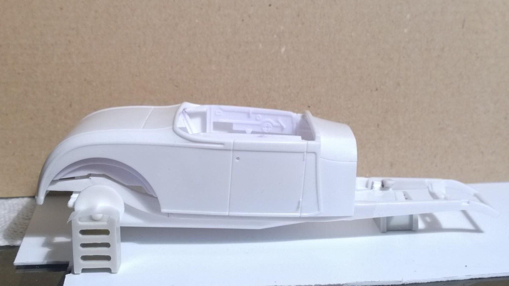

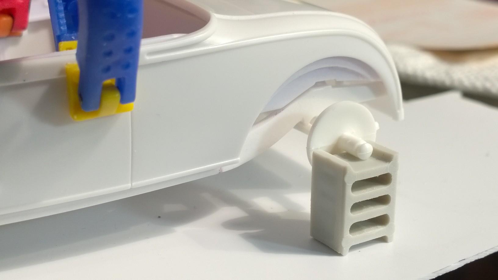

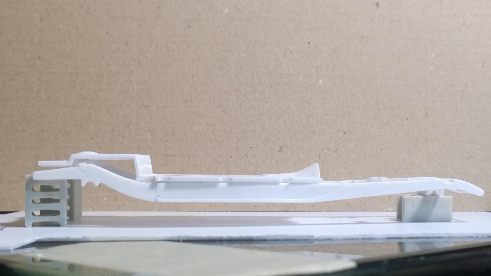

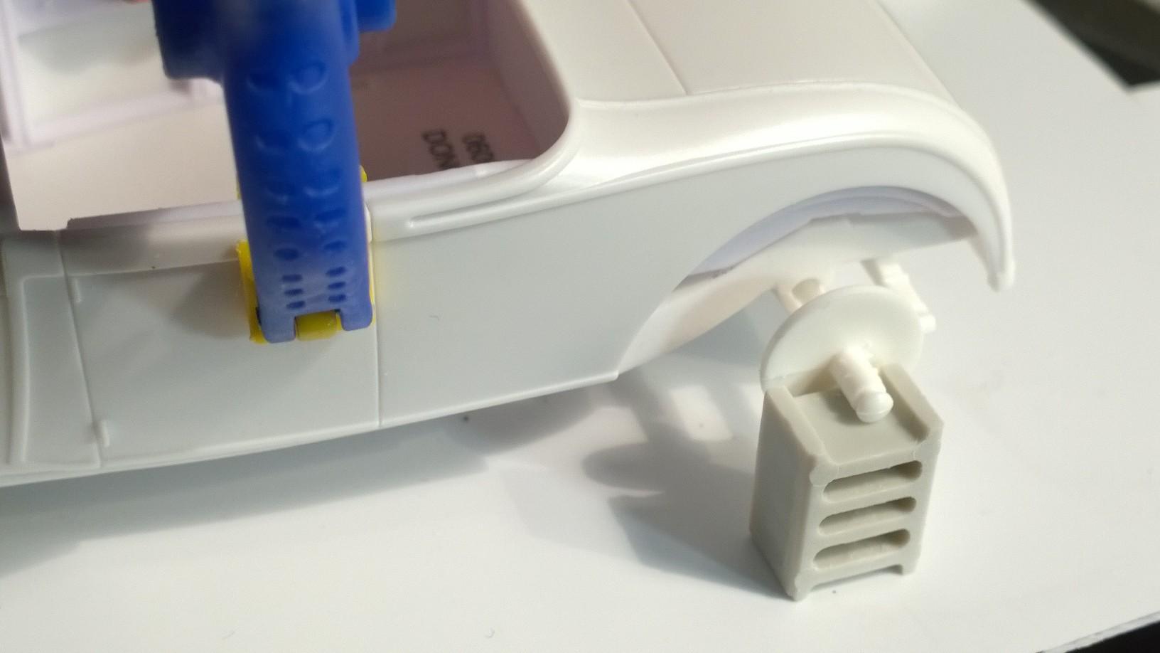

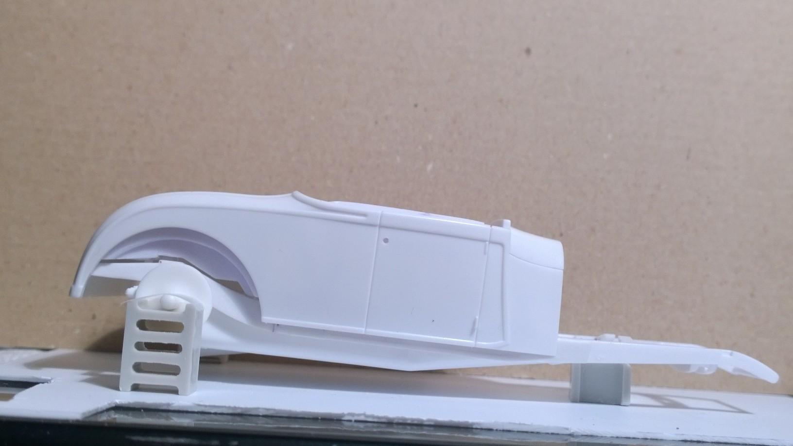

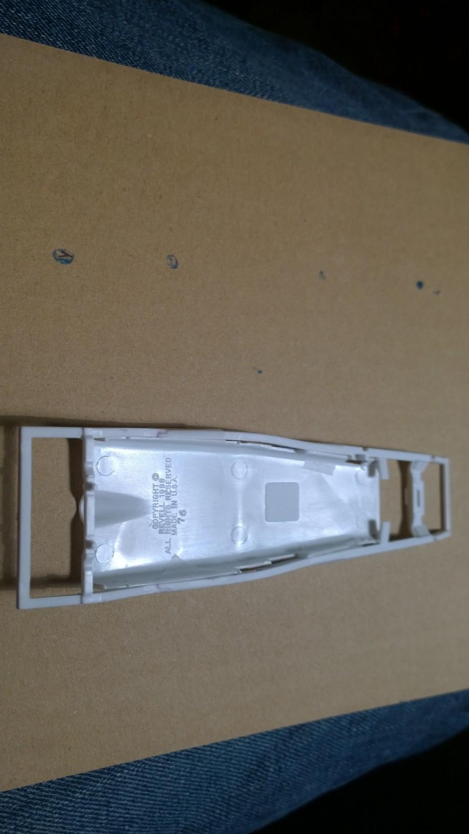

  1. Quick update: Wheel Wells set in place! Left Right Let's take a look at the belly pan: Inside: Underside: Backside: That's all, Folks! -KK

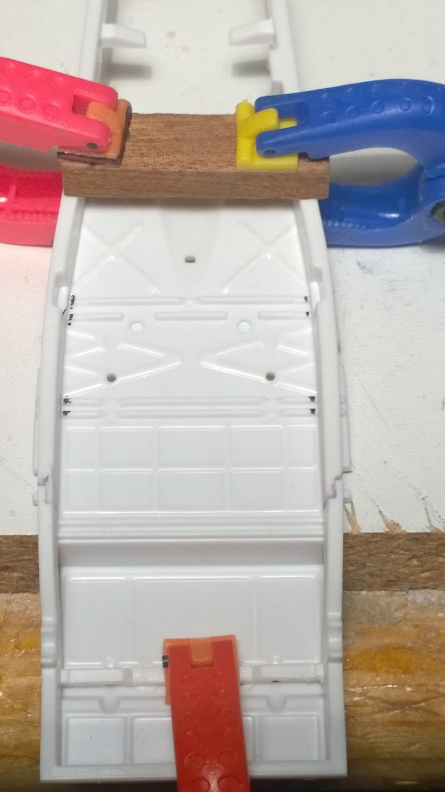

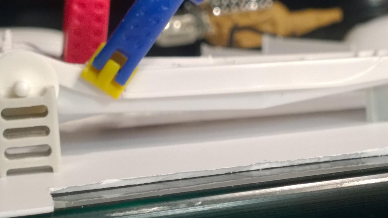

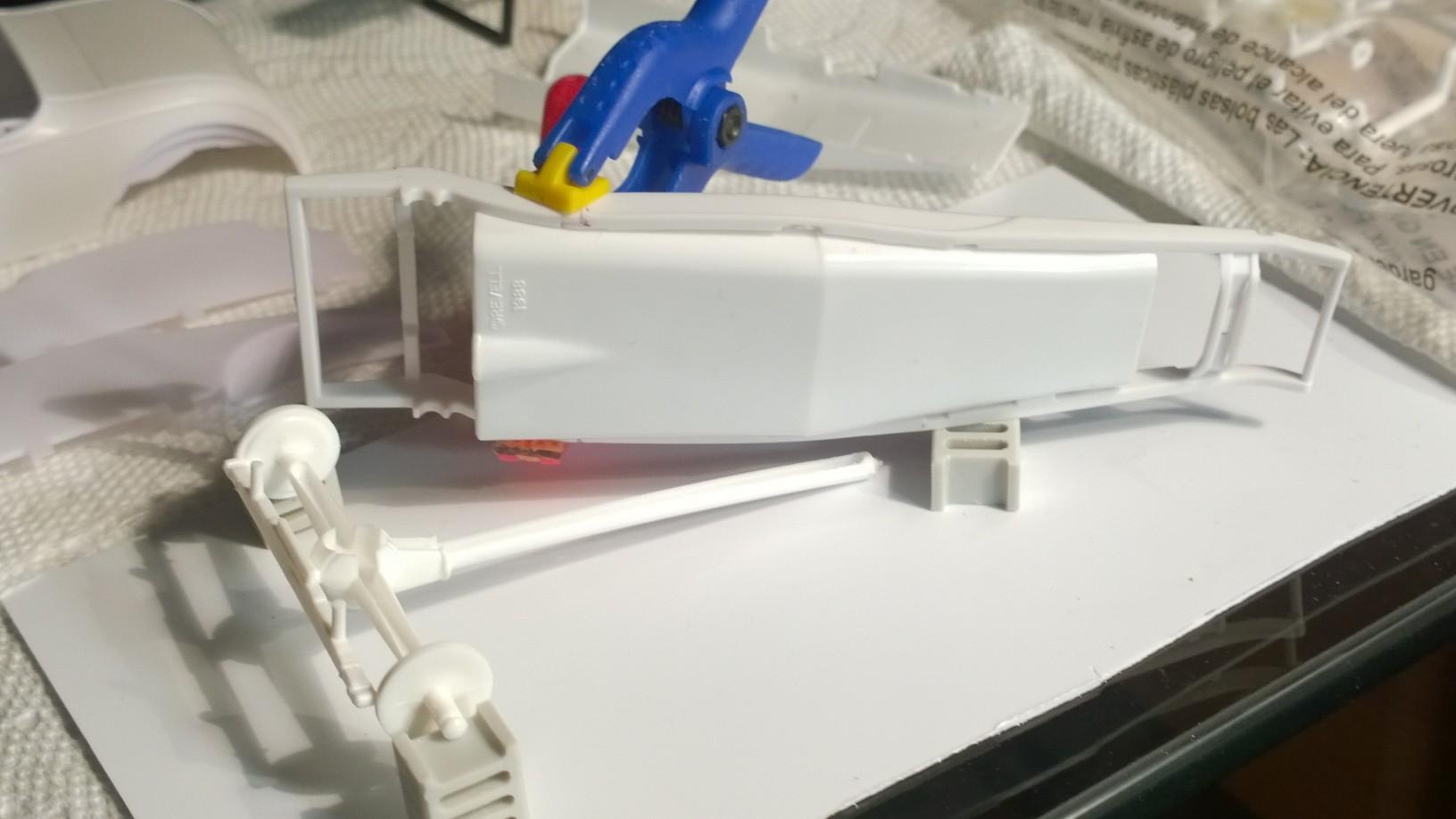

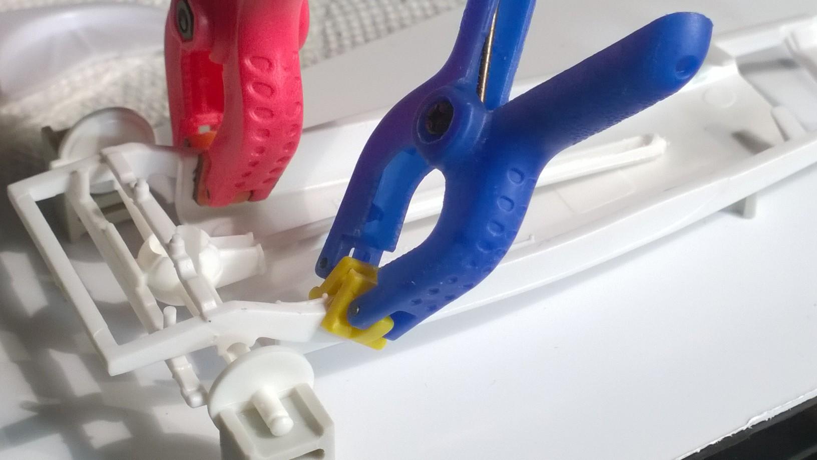

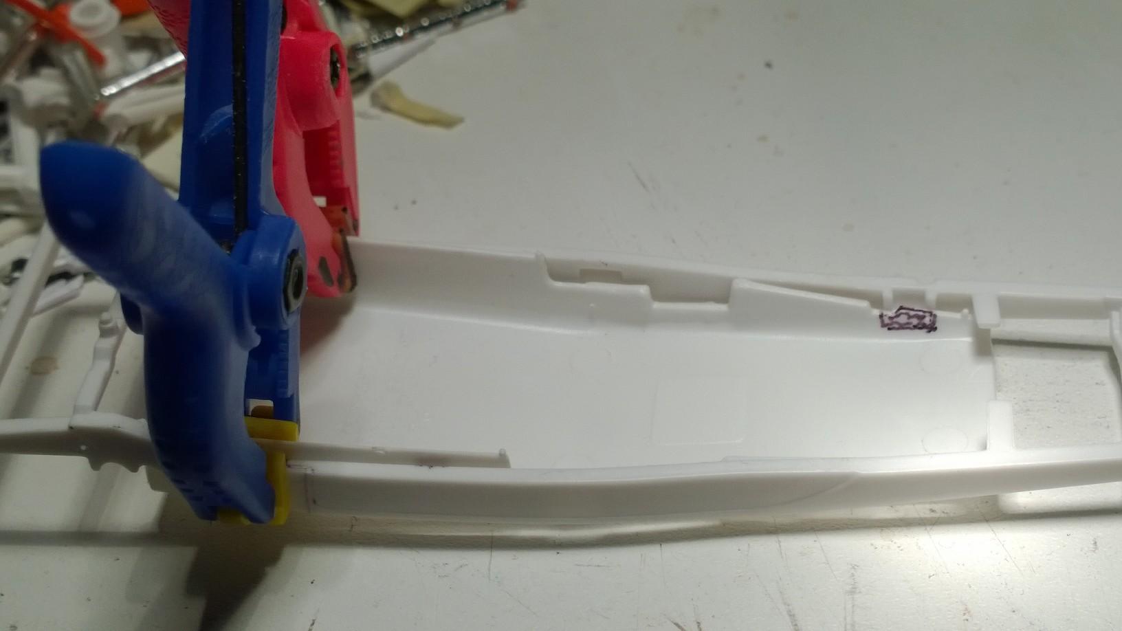

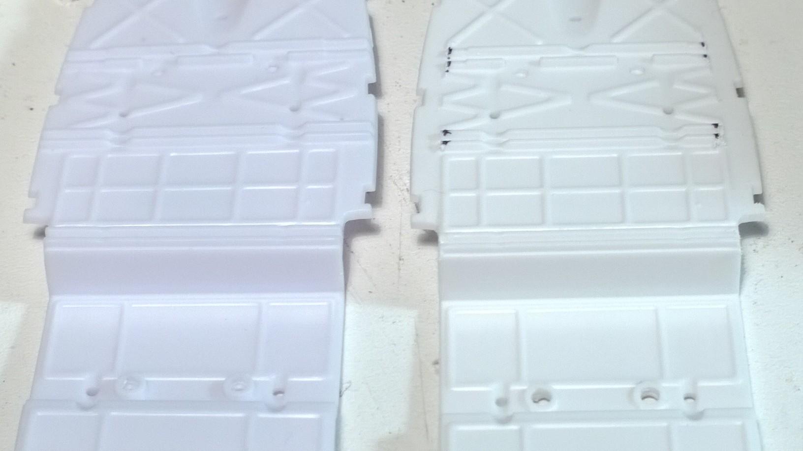

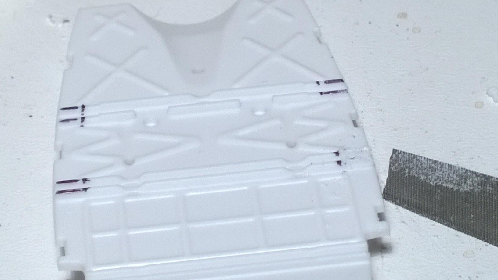

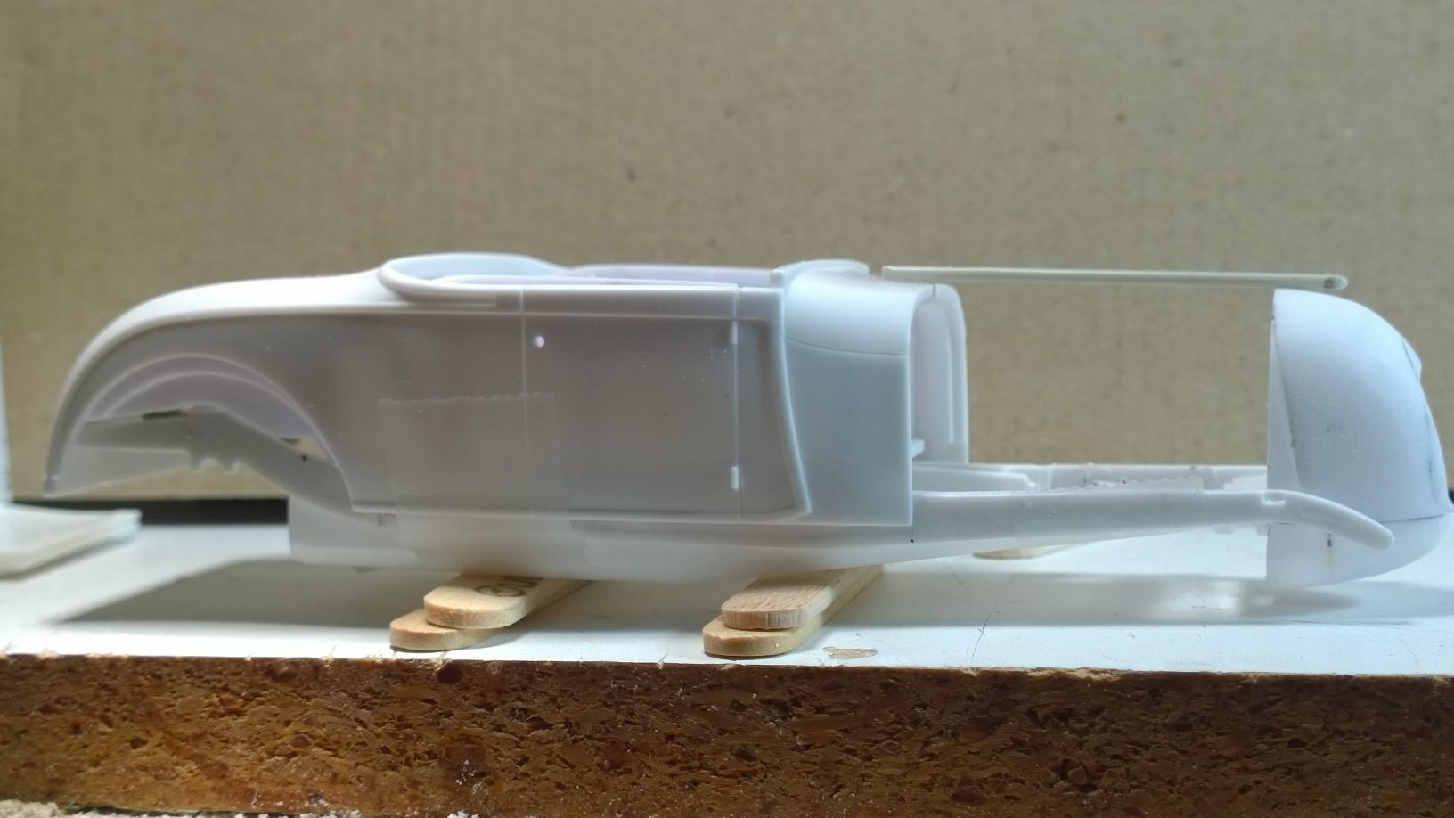

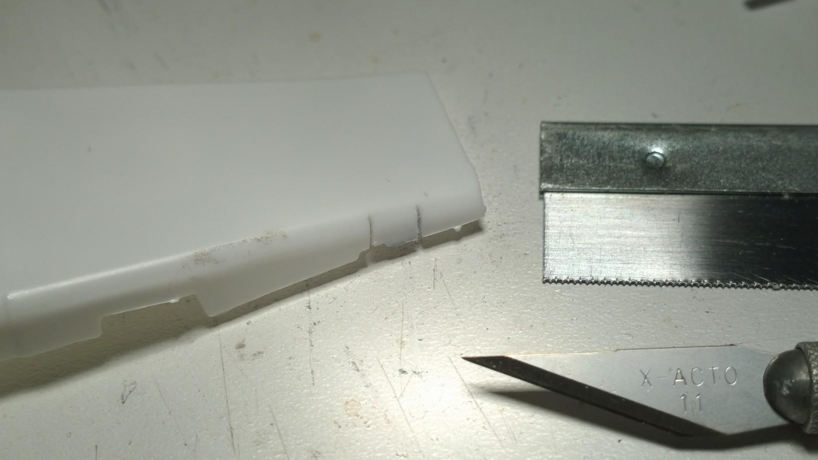

  2. Continued progress on the right side of the outer belly pan... Marking the cut line... Will be using toe line on the left to cut along... Angle cut leaning towards the outer edge... Tuck inside of the roadster body panel to mark the lower cut line... A little sanding... Beveling the inside of the outer apron to fit the rolled edge of the inner belly pan... Both sides shaping up and beginning to more closely resemble each other! The pinched inner wall will get a little relief and should stand pretty much parallel to the outer apron. Secured and moving forward... Marked out the initial cut lines... Shorten up the lower edge of the right forward apron... Minor patch... ...or two... A couple drops of CA and the rear section is laid in place... All bound up for the moment... As with the left side, laid a small rod in the seam between the inner and outer belly pans. Came out very much like the first side... ...and the second side, too! Add some mud... It'll have to set up a tad before hitting it with the sanding regiment bringing the surface down to final filing level. -KK

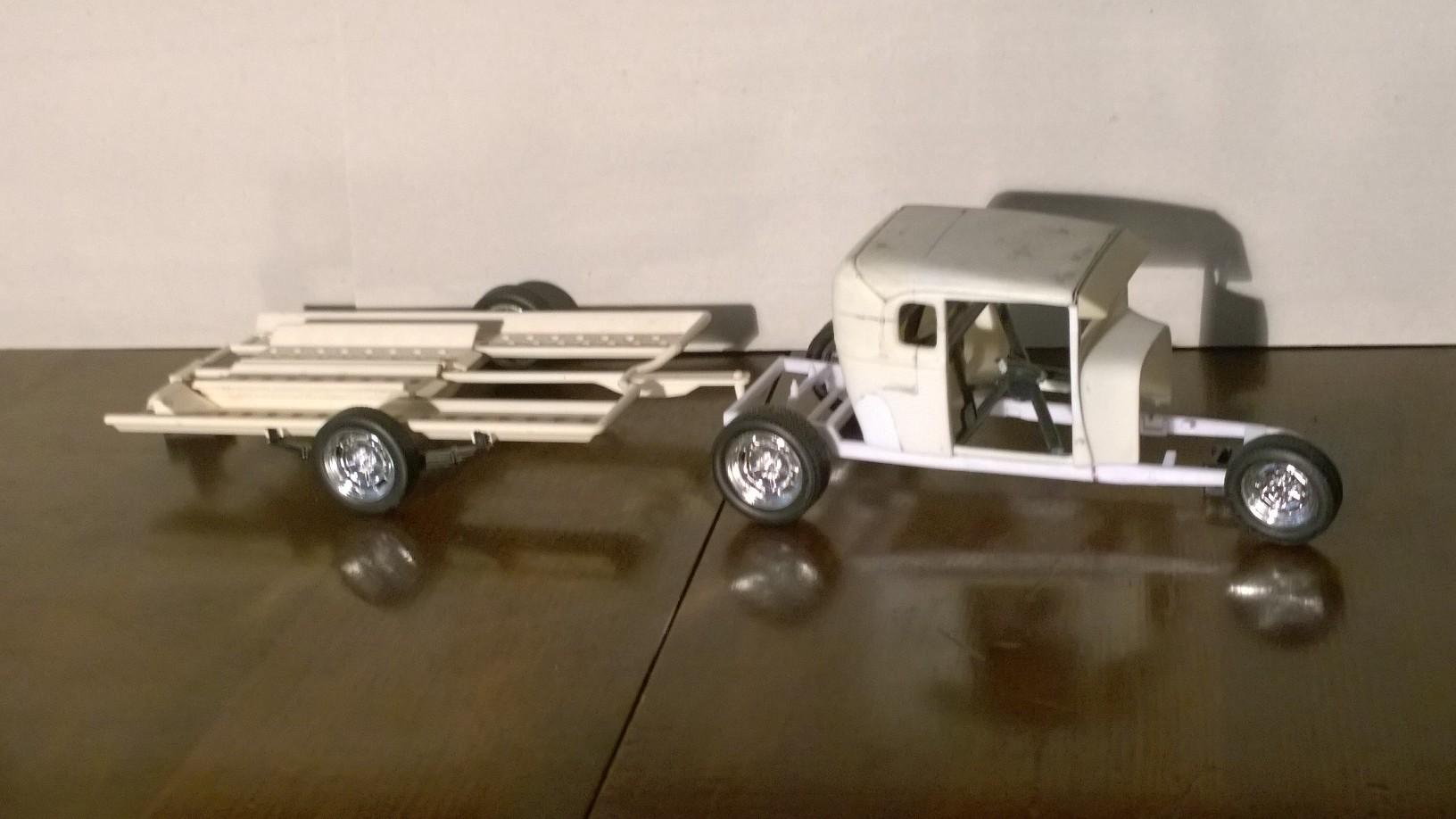

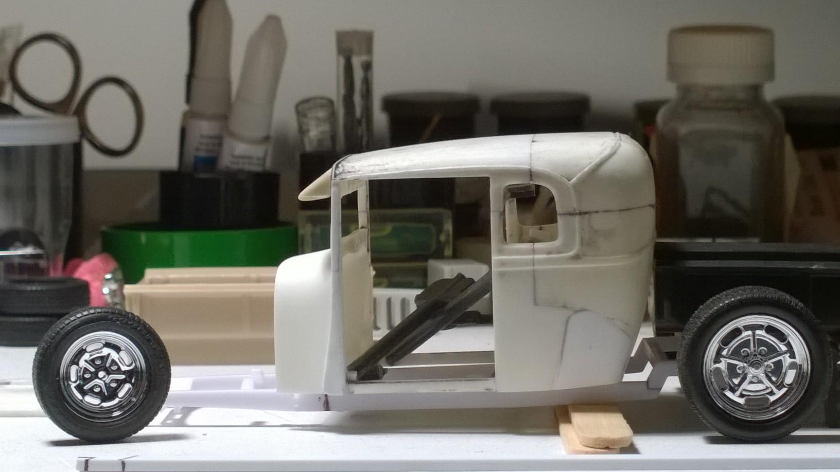

  5. Here's an idea of the future of the '29 Track Nose Roadster... Snap Kit Some may think that the idea that it all goes together (without any adhesive) might be kool, but really it creates a whole different set of problems yet to come. -KK ps Any guesses?

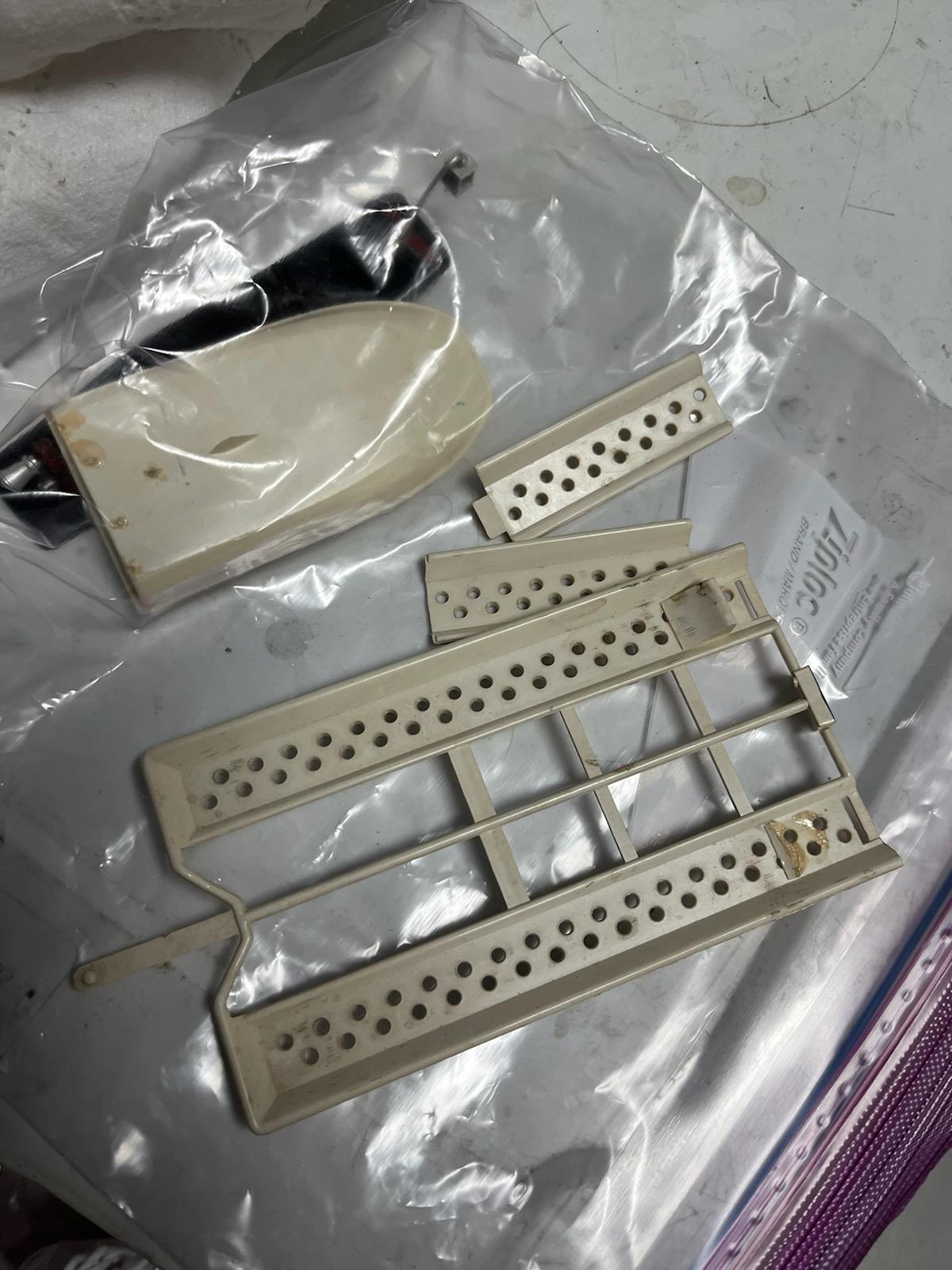

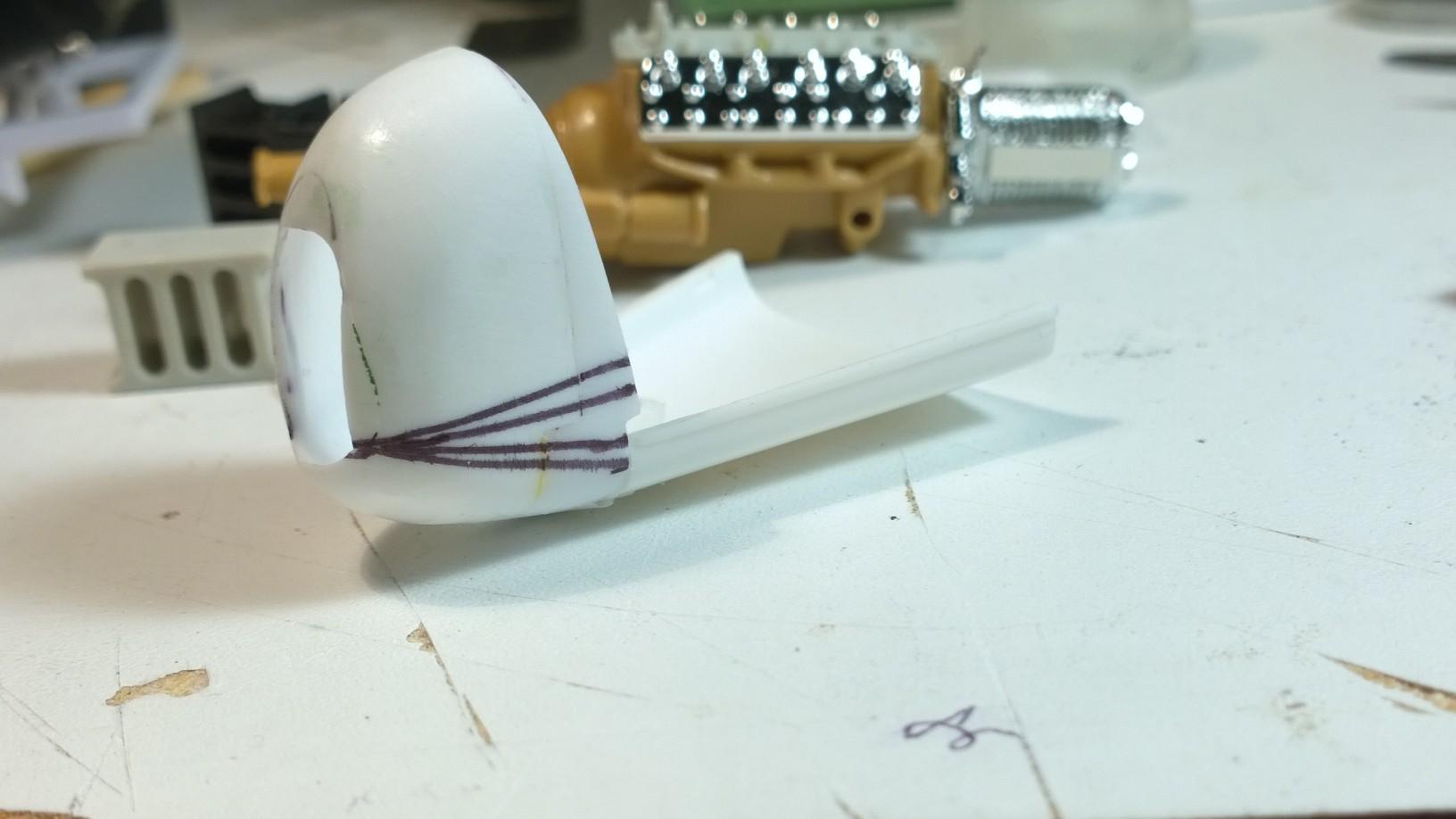

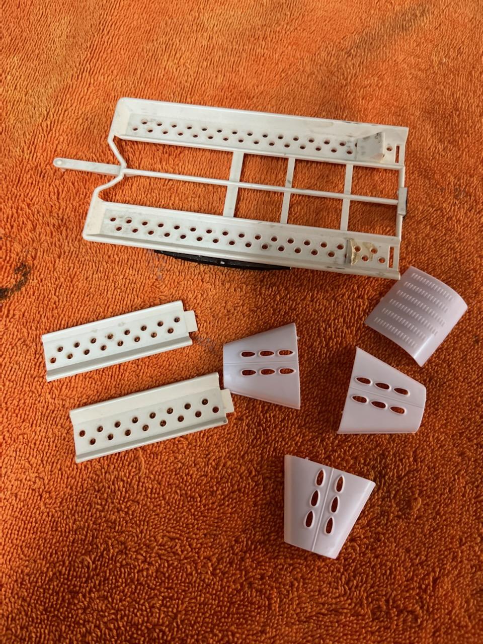

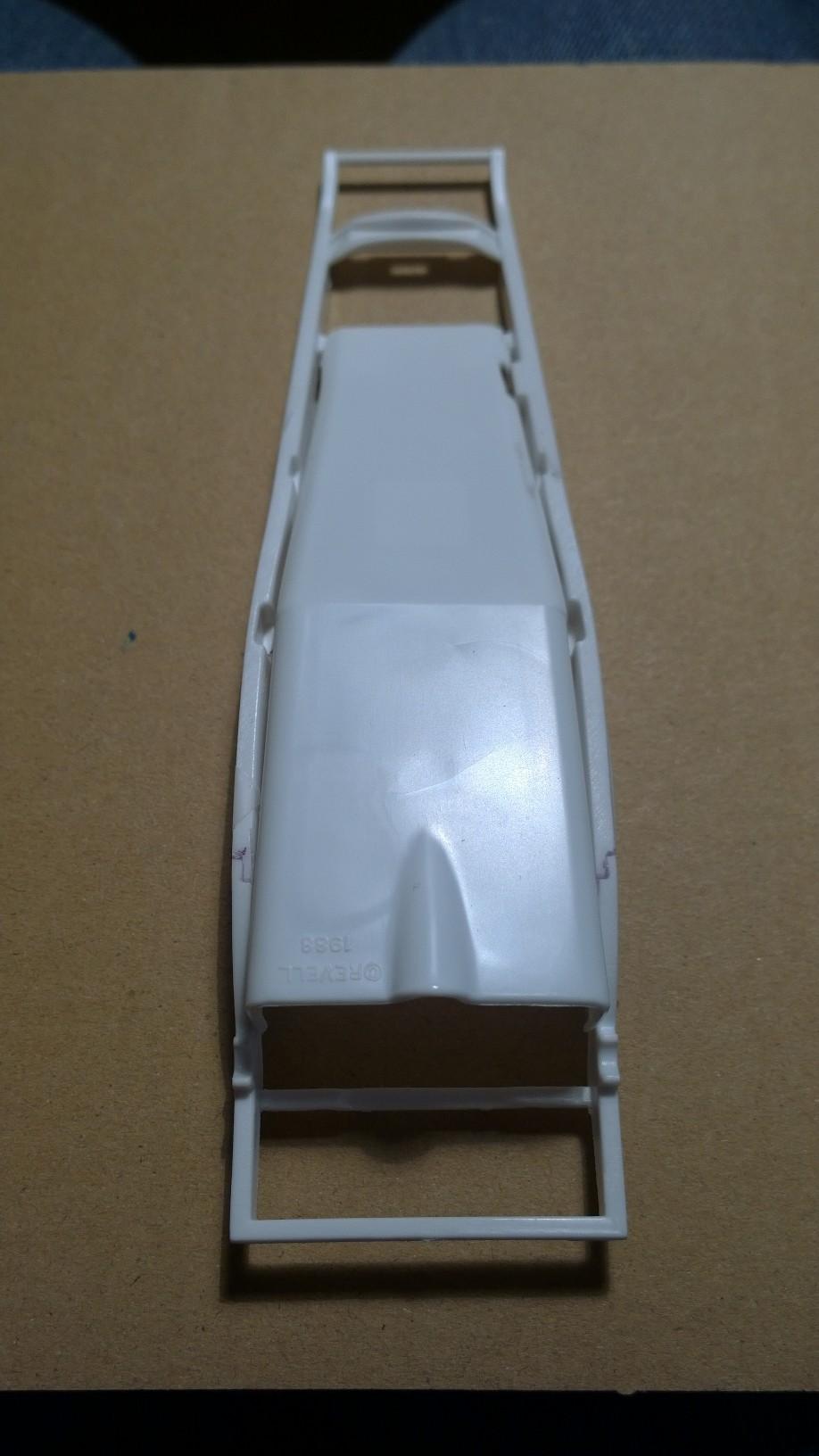

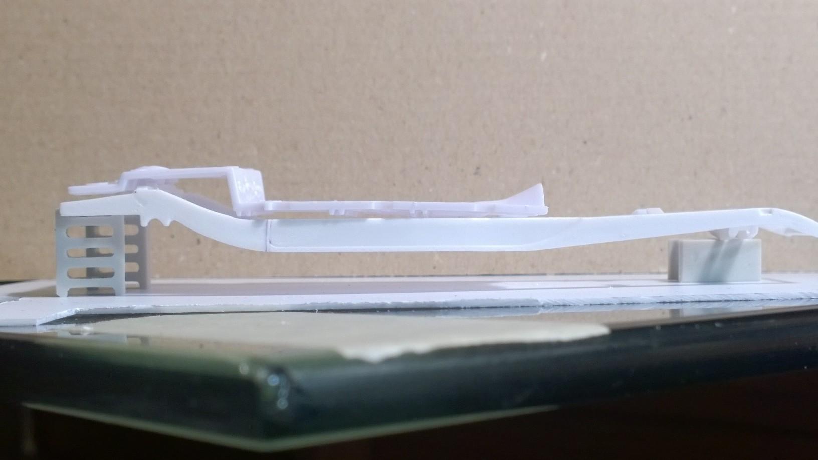

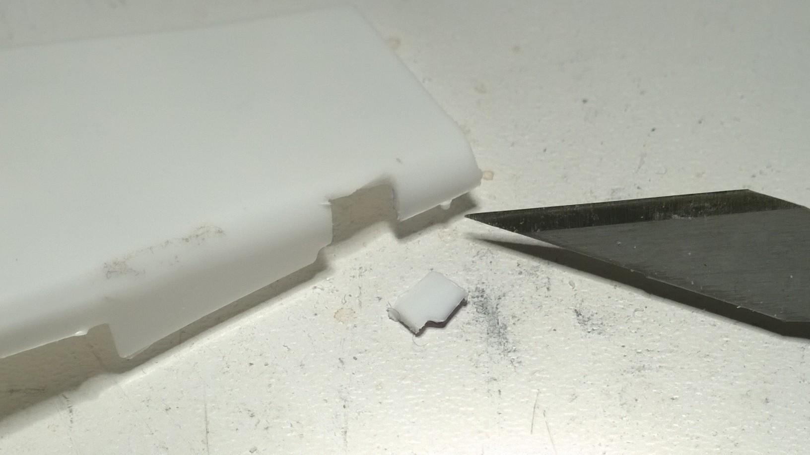

  6. Got a wild hair and decided to cut up some old plastic! Look close: Revell Orange Crate Belly Pan... used a couple to make the inner belly pan and will cut up the leftover pieces to extend the belly pan beyond the deuce rails... Looking at these they might work... Then the other forward piece... Cut the outside edges to add to the existing inner belly pan... Trim off a little wide (leave the line) to allow beveling the edge to overlay the outside of the inner belly pan... Looks like this might mate up end-to-end... Fast forward and test fit the left side apron: Looking very promising... Starting to take shape... Trimmed down the forward section of the outer belly pan... That'll buff out!?. Still a little rough around the edges... Laid a thin rod down the joint between the inner & outer skirts... A bit of slight of hand and it looks like it belongs there! -KK

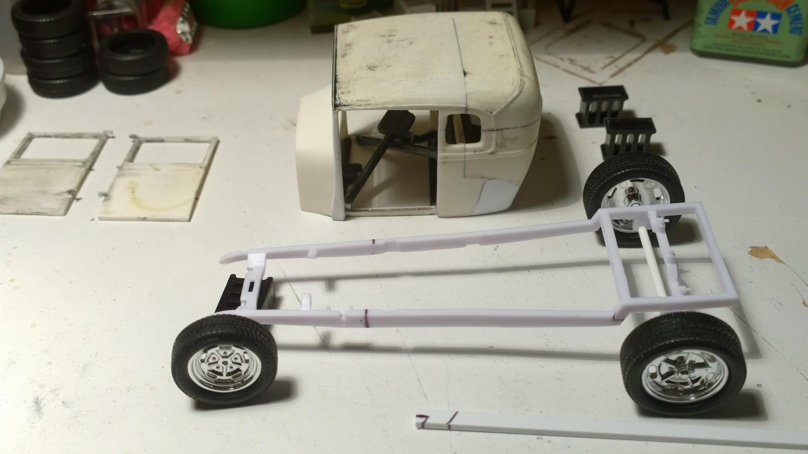

  8. Back a ways had to scratch a temporary rear bulkhead... Took out the top section and rolled down the header corners... A little bit more to do, maybe some bracing... -KK

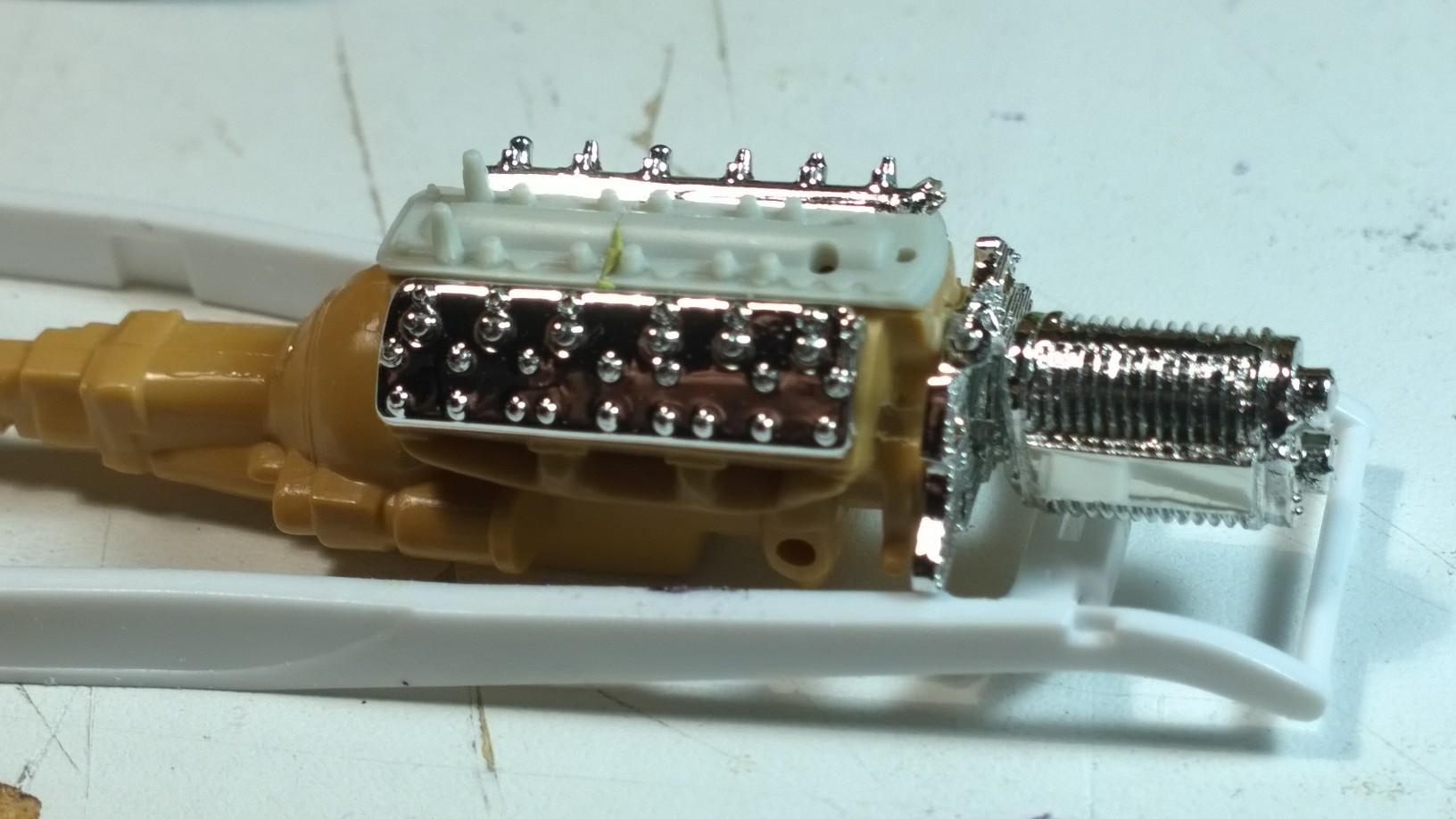

  11. TKO-500 poking up through the floorboard inside of the firewall and the bright stuff has been mounted on the resin block from The Parts Box! -KK

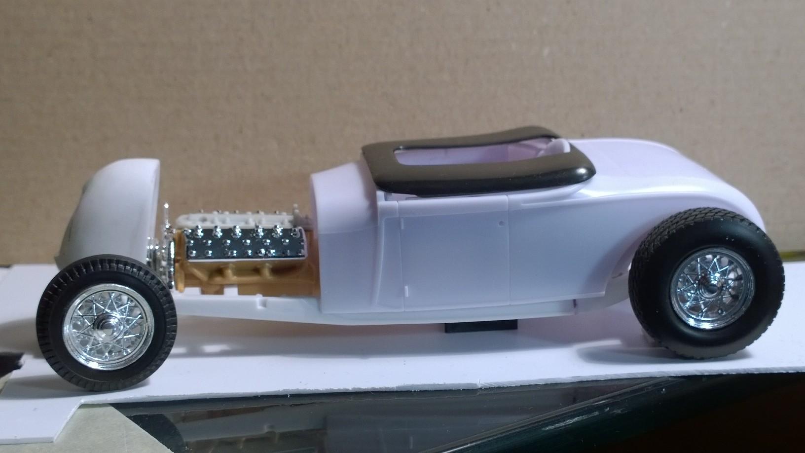

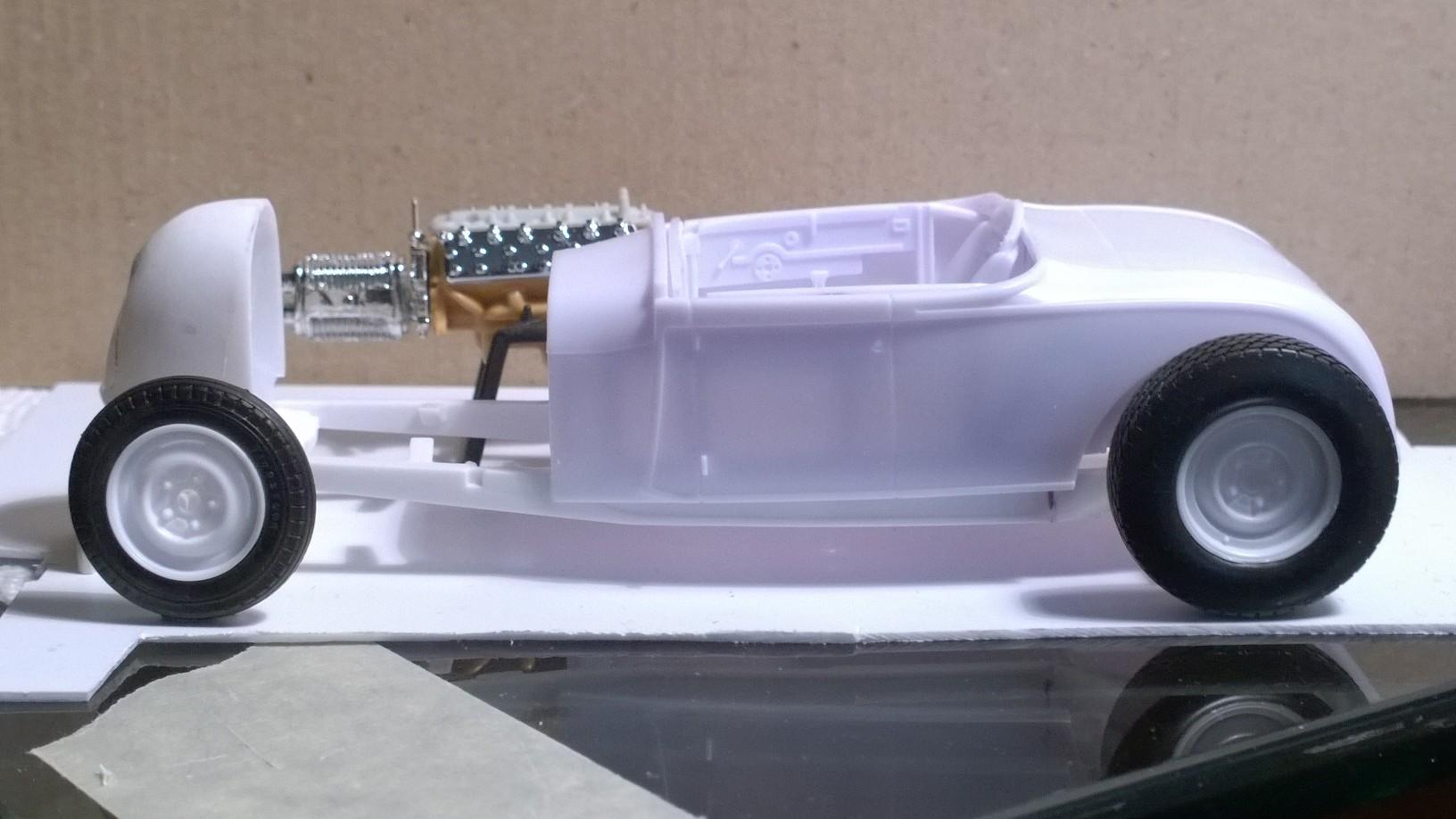

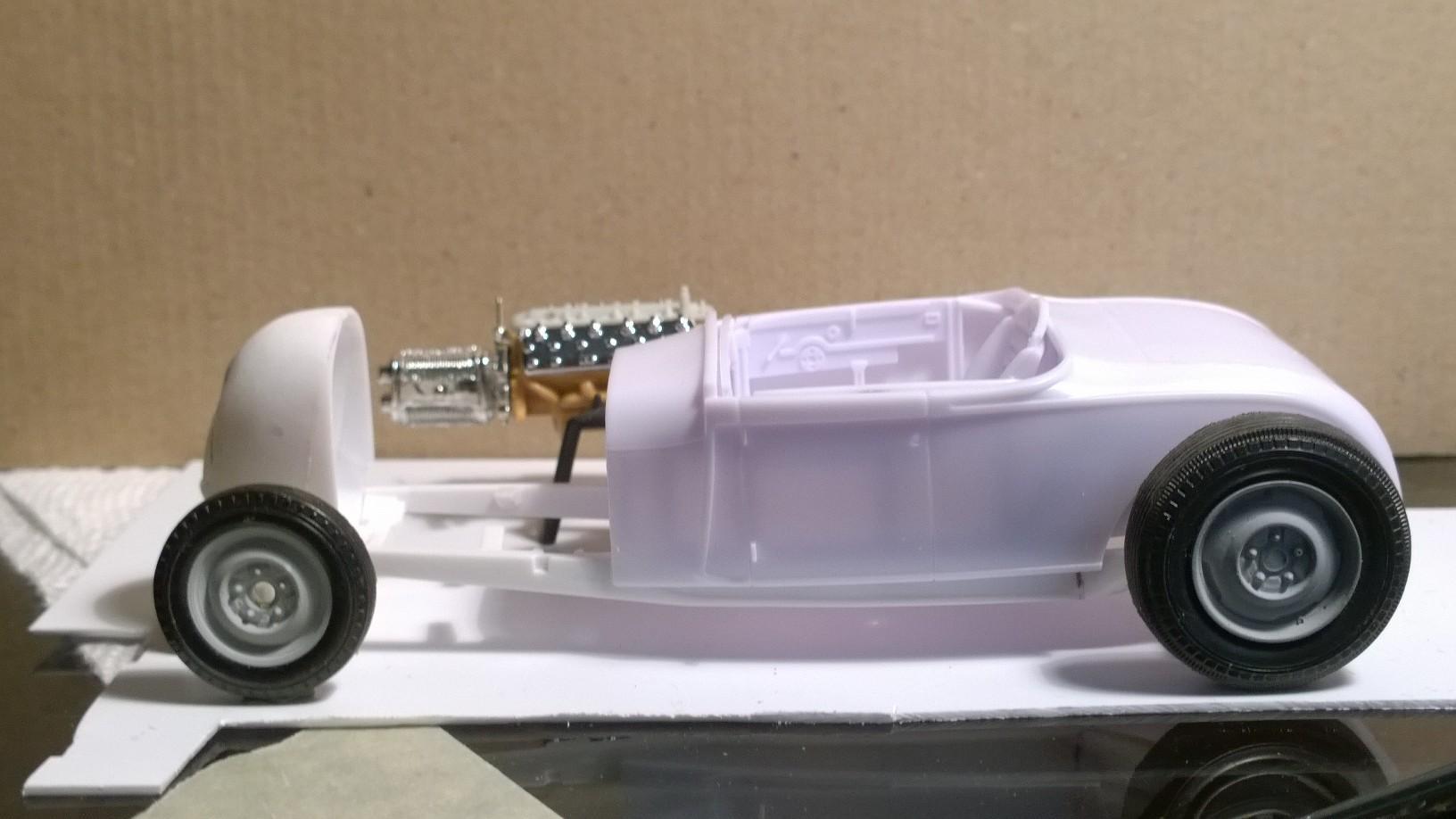

  12. Tweaking little things as they come together is a constant ongoing effort... Mockups help plan upcoming tasks and modifications... Looks like there will be a little room to set the nose back a bit... Drilled guide holes for the heads & manifold... Swapped everything off the donor dummy block on to the resin block... Here's the "Money Shot" of the day! On the other side of the firewall played with the Orange Crate Bellhousing and the Rat Roaster TKO-500... Locating the location of the trans adaptor & spacer to align them on the firewall... It fits! Added the shifter to the TKO-500... With a little detail it'll look fine... -KK
  13. Call me when you fire it up! I wanna hear it roar!! Kool little A roadster!! -KK

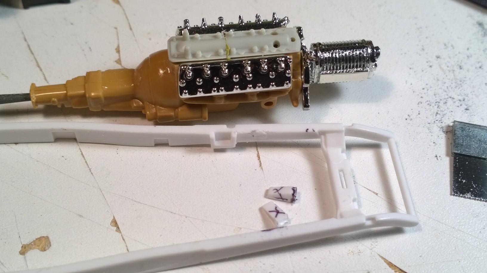

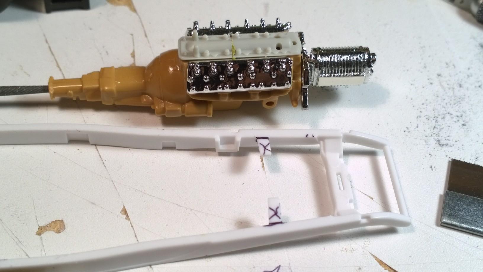

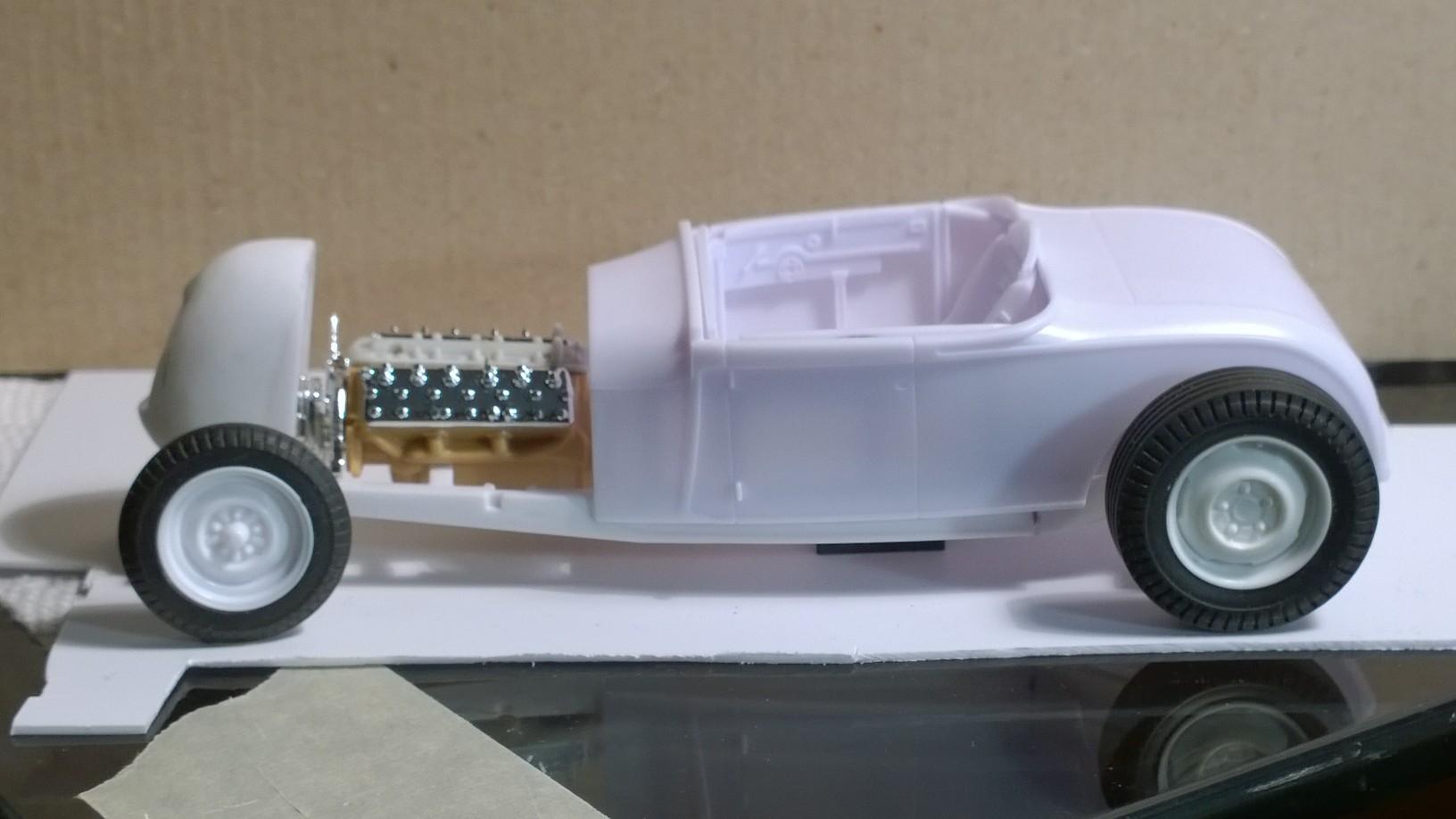

  14. Moving forward with the resin V-12 from The Parts Box: Off with the old... 90 degree cut... That's the story on this end! Located the AMT '41 Ford water pump belt and pulleys, a little modification to fit between the motor mount and the blower... Modifications that have been made to the front of the dummy block will be transferred to the resin block. Still have a little room to set the nose back a few inches... To mount the TKO-500 to the V-12 requires an adaptor... Here's the question: What kit did the trans adaptor (part #16) kome from? -KK

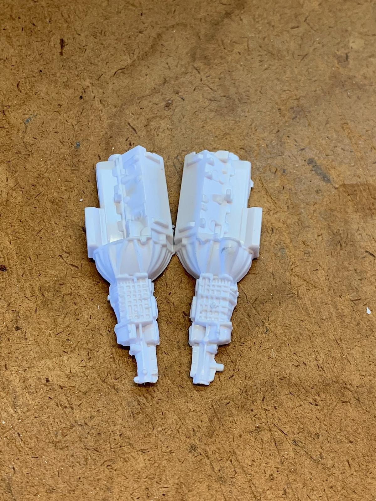

  15. The Parts Box V12 arrived... Slosh Cast and klean as a whistle! Looking back at the original compared to the resin version makes me think about kleaning up the Monogram '41 Lincoln V-12... Then again if I kan epoxy these two halves together... I will say, the accessories that kome with The Parts Box V12 Parts are klean & krisp! Nice enough to section a pair of Revell '32 Ford Flatheads together to make another hot rod V-12! Just asked @Rocking Rodney Ratto see if we have a crate flathead that he kould ship up with the tonneau kover! -KK
