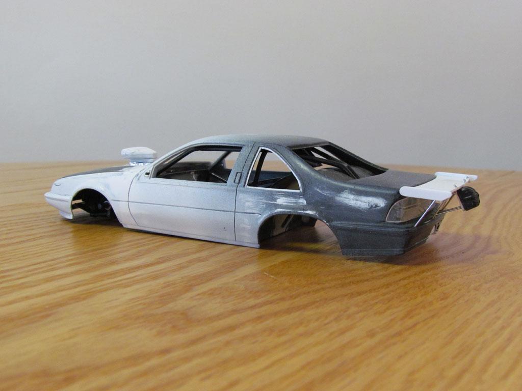

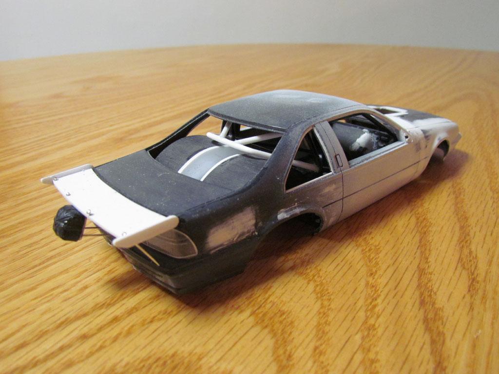

After hours of working with the kit's hood I gave up and made one. The kit's hood had the area where the original scoop was that needed to be filled in and I added a piece to the rear to stretch it. I also filed it down to flatten it a bit and it became a mess. lol I cut the front off the kit's hood and attached it to 1 mm sheet styrene. I bent the styrene at the sides a bit and did some shaping with a sanding stick. On the underside I glued in a curved support made from 1.5 mm sheet styrene to hold the shape. The kit's hood is a bit too curvy even for a stock Beretta. I wanted the hood to resemble a fiberglass stretched hood which are even flatter than a stock Beretta hood. This hood I made still has some curve to it.

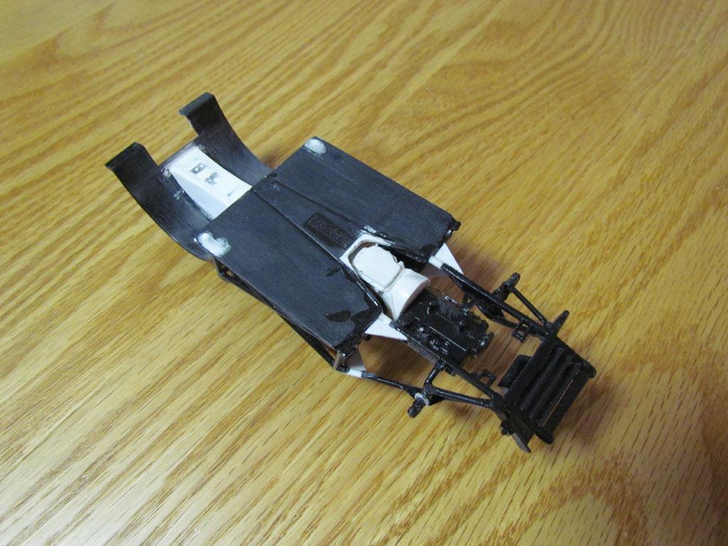

I decided to remove the large tunnel on the interior side of the firewall. I cut a piece of a transmission tunnel from an AMT '66 Nova parts kit and attached it to the front of the Beretta's transmission tunnel. It doesn't look like a van's interior anymore. lol The front of the Beretta's transmission tunnel looked like an interior engine cover in a van. The Beretta's transmission tunnel is a bit high but I think I'll leave it. The dash board is almost done and I added some more bars to the roll cage. There's still more to add. Now I have to decide what to do with the underside floor. The kit has it represented as a belly pan covering the chassis. I might leave the belly pan but I'm considering sanding it down to get the center raised section off and adding some 2 mm half round rods to the bottom to look like chassis rails. Then I would remove the center to show the transmission and drive shaft. What do you all think?

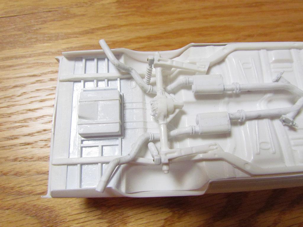

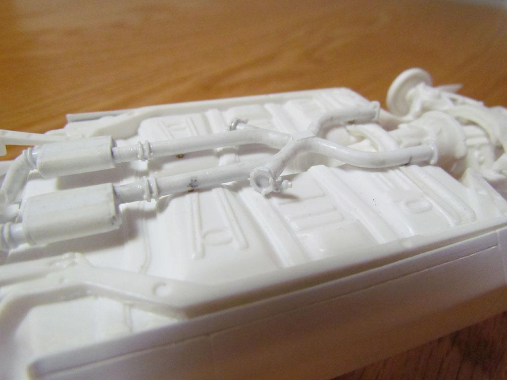

I finished adding the details to the exhaust system. Other than the fuel pump which I need to make the bottom is done. -

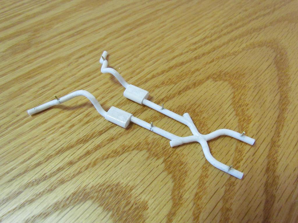

I did some more work on the exhaust system. I made the mufflers, added the cutoff pipes that allow it to bypass the mufflers and installed 1 mm brass pins to attach it to the floor. I still have to add some clamps and details and also the collectors on the headers. -

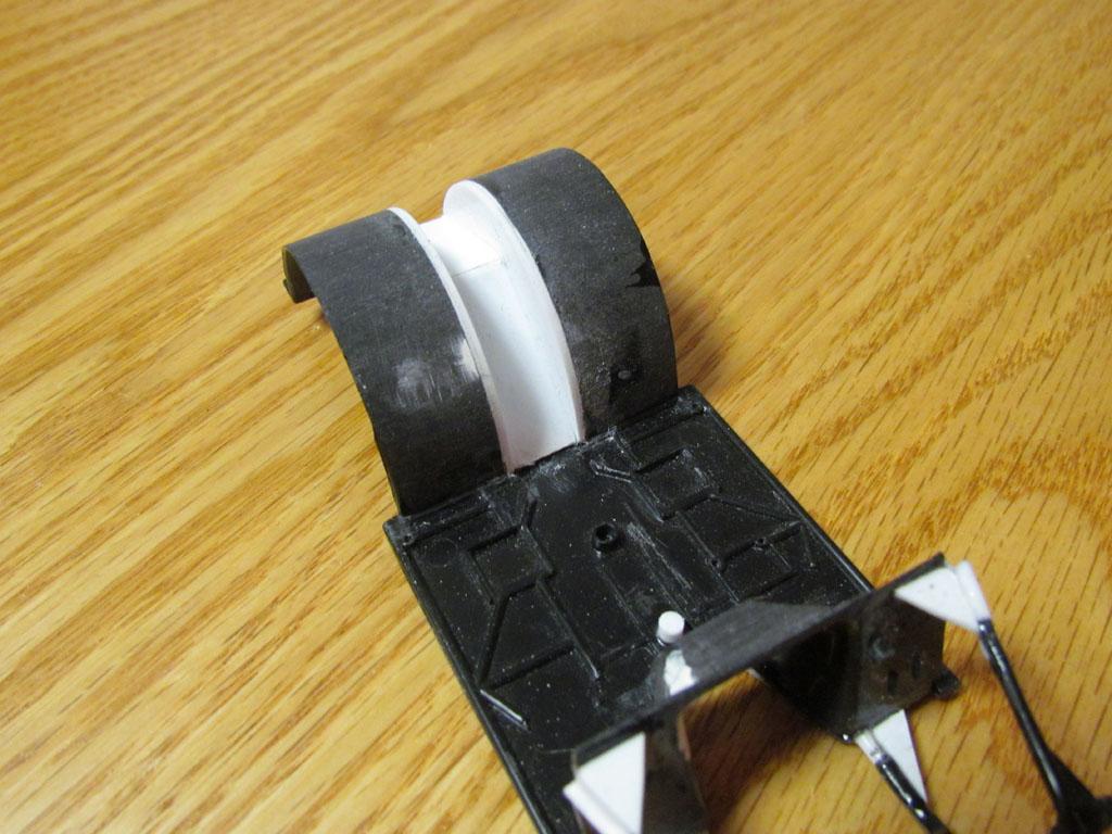

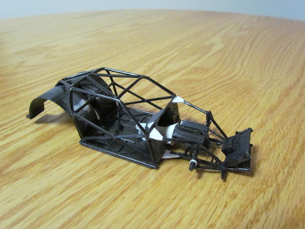

I wasn't happy with the way the rear bars of the roll cage looked and the lack of space between the wheel tubs. Today I widened the space between the wheel tubs and started changing the rear of the roll cage. The kit's rear bars of the roll cage looked too stylish and not enough like a real car. I still have to finish adding some rods. I used 2 mm rod. The diameter is slightly larger than the kit's roll cage but once it's painted they should blend in. The white styrene is making the diameter appear larger than it looks in person.
