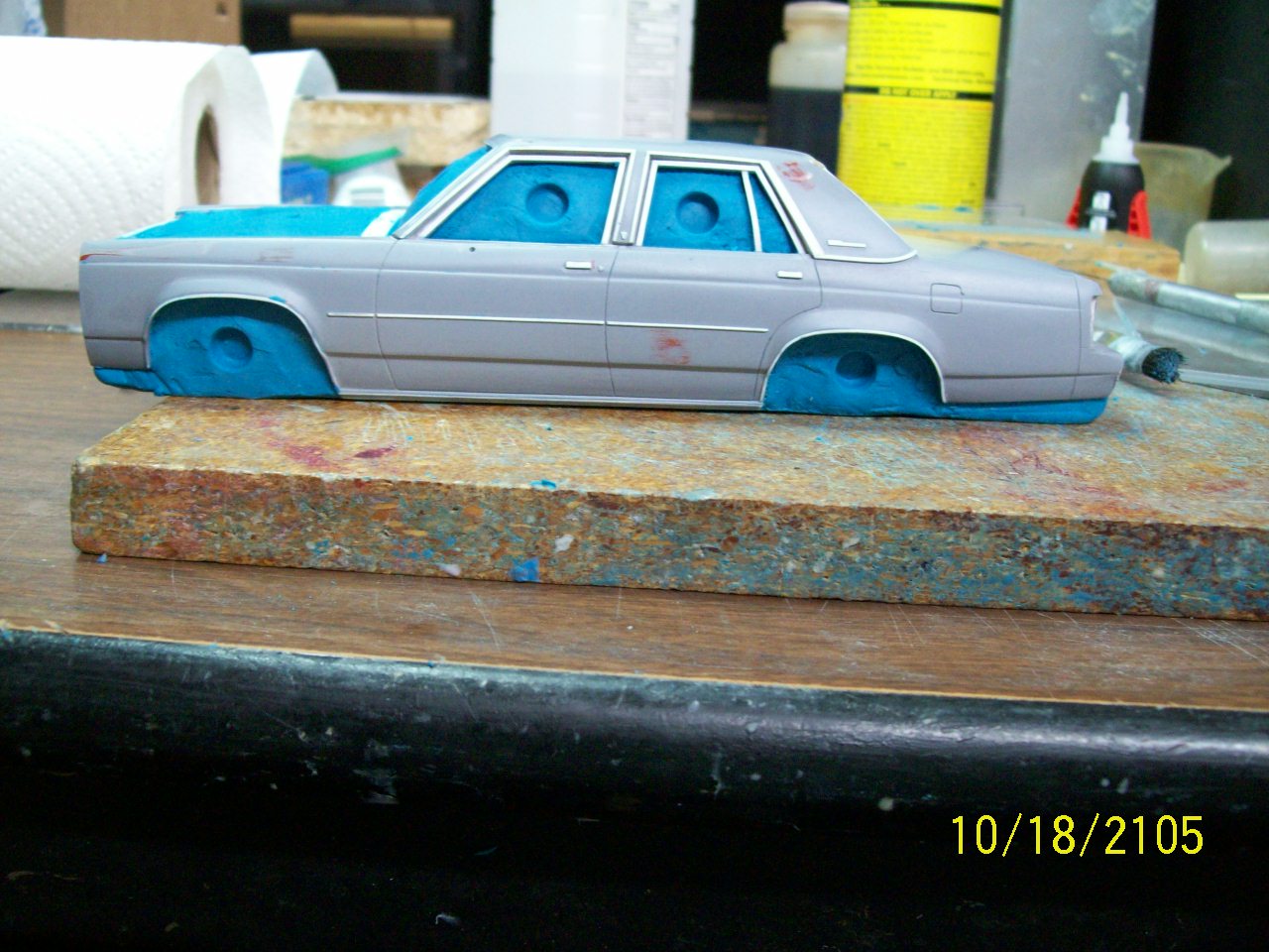

1988 - 1991 Ford LTD Crown Victoria Scratchbuild
Greg Wann replied to DEL's topic in Car Aftermarket / Resin / 3D Printed
Got the body from Mike Last night. It is good news that it fits in my 6 quart pressure pot and also fits in this sheet metal. I think I can make it work. I was hoping I would not have to use my Big Bertha pressure pot to cast a body. It is now after 10:00 PM. I have the body mostly clayed up and cleaned. I take the handle of my exacto knife I push it into the clay to make these dimples. I think they help keep the inner core of the mold well seated in the mold so that it does not shift under pressure. There are a couple more layers of 3/8 inch thick clay to form the base. I might have a body by Saturday. I should have the tires soon too. So, the sheet metal is important. The finished mold will be set on a couple of those cheap shopping bags and then it will be cradled in the metal to keep the sides nice and tight. Body molds take a lot of post work too. -

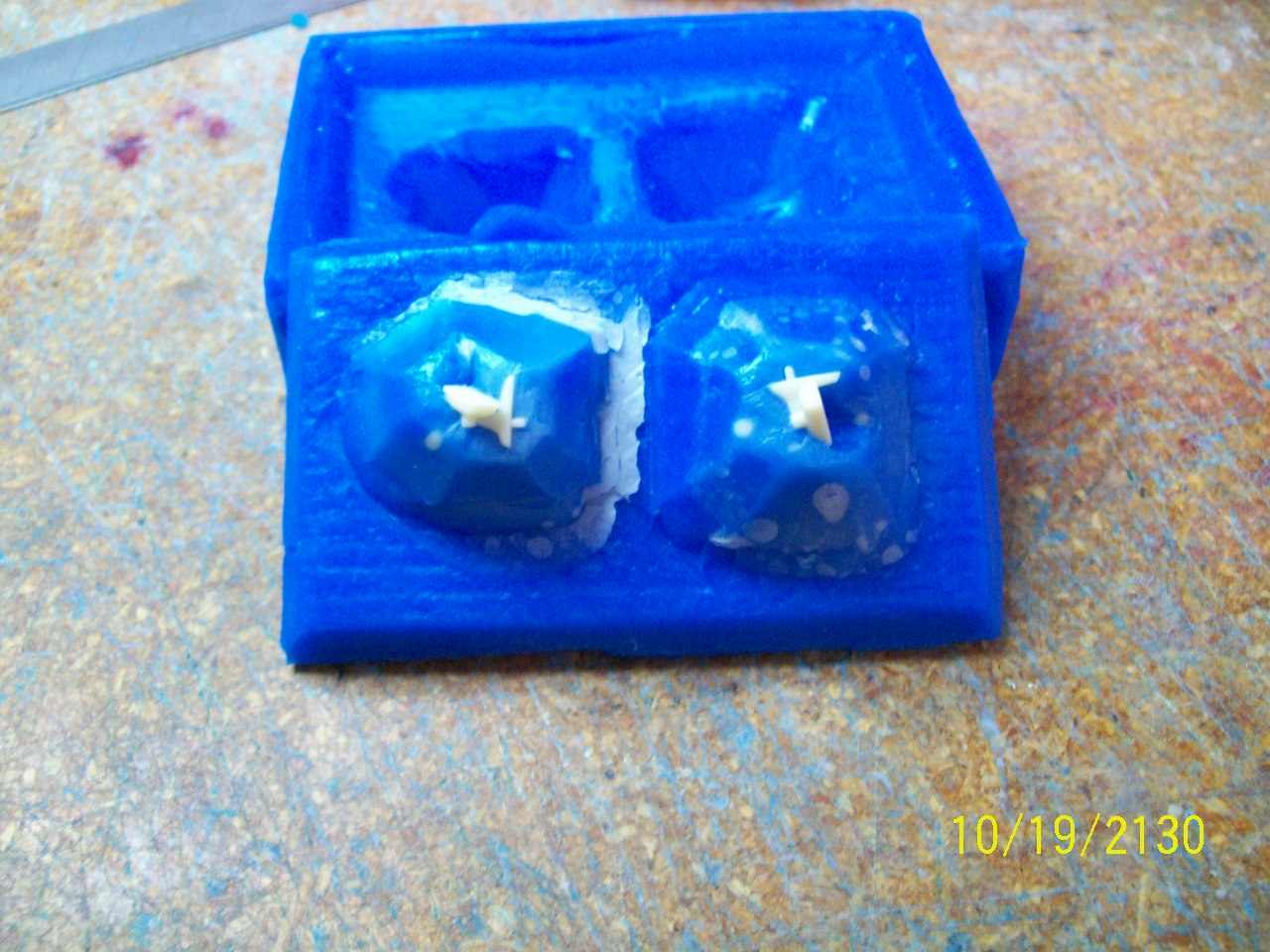

Here is another set of mirrors with a bit more weight added to the top in the pressure pot. The flash is nearly non existent. Dang! I forgot to change the date on my camera. I did not want anybody to know I am a time traveler. -
The photo is a bit grainy. These two bright light colored dots are the vents filled with resin. They are close enough to the part to be effective and not be directly connected to the part. I think this is much nicer than the typical sprue attachment points in model kits. I think it is a advantage. Some parts on sprues are as small as the sprue itself. -
Here is the mirror mold finished. I cut in vents with a piece of brass tubing then I take a exacto knife and create these wells. I like the excess resin to pool here while it is in the pressure pot under 65 PSI. I will make a few sets and then create yet another mold that will make several sets at one time. I should have added the hood ornament in this mold. -
