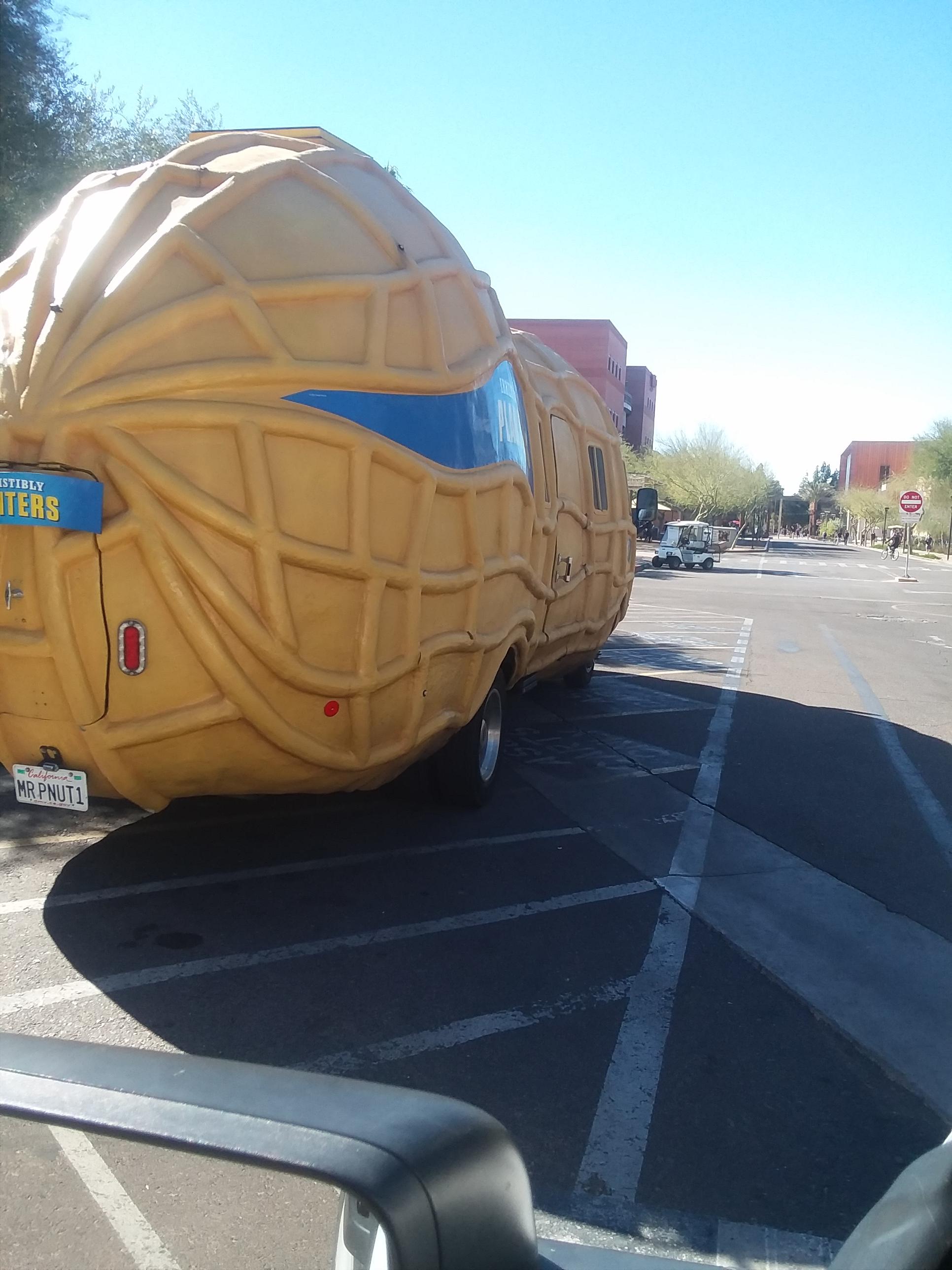

On the Arizona State University campus today was something I never knew existed. I have been inside a Wiener mobile once but I have never seen one of these. Thought someone here might consider a scale model to entertain us with. I was kind of in a hurry and too lazy to get out of my work truck to take the photos with my cell phone. Greg Wann
