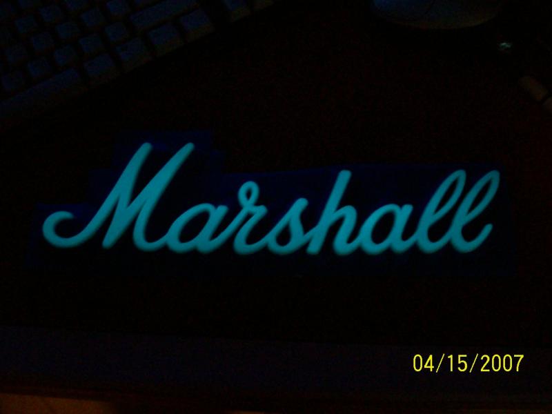

http://www.monsterkolorstore.com/ I have purchased these dyes. They offer some glo in the dark colors. I made this badge using Smooth- On 325 Clear resin. It has the Monster color blue glo in it. This is the color of it with the lights out. I think you can use a laquer paint too I ialso use dyes from smooth on. You might try micheals for casting kits and dyes. They might carry the Alumilite line. Here are some faucet handles I made. I mixed the gold and maroon dyes from primary colors. I made the resin gold first and then just quickly swirled in the maroon. If you are using a cheap white resin like their 300 series you could swirl in some red and blue dye and create a red, white and blue themed item. You might try experimenting with nail polish. There are some really cool colors and cheap at a dollar store. You can refrigerate the resin before mixing. This will buy you a couple more minutes of working time. I use Task 8 resin for most parts. It will take a lot of heat. Great for making parts for real cars too. Pressure casting is the best. Having a vacuum pump and vacuum chamber are important items to have too, to be successful. -
