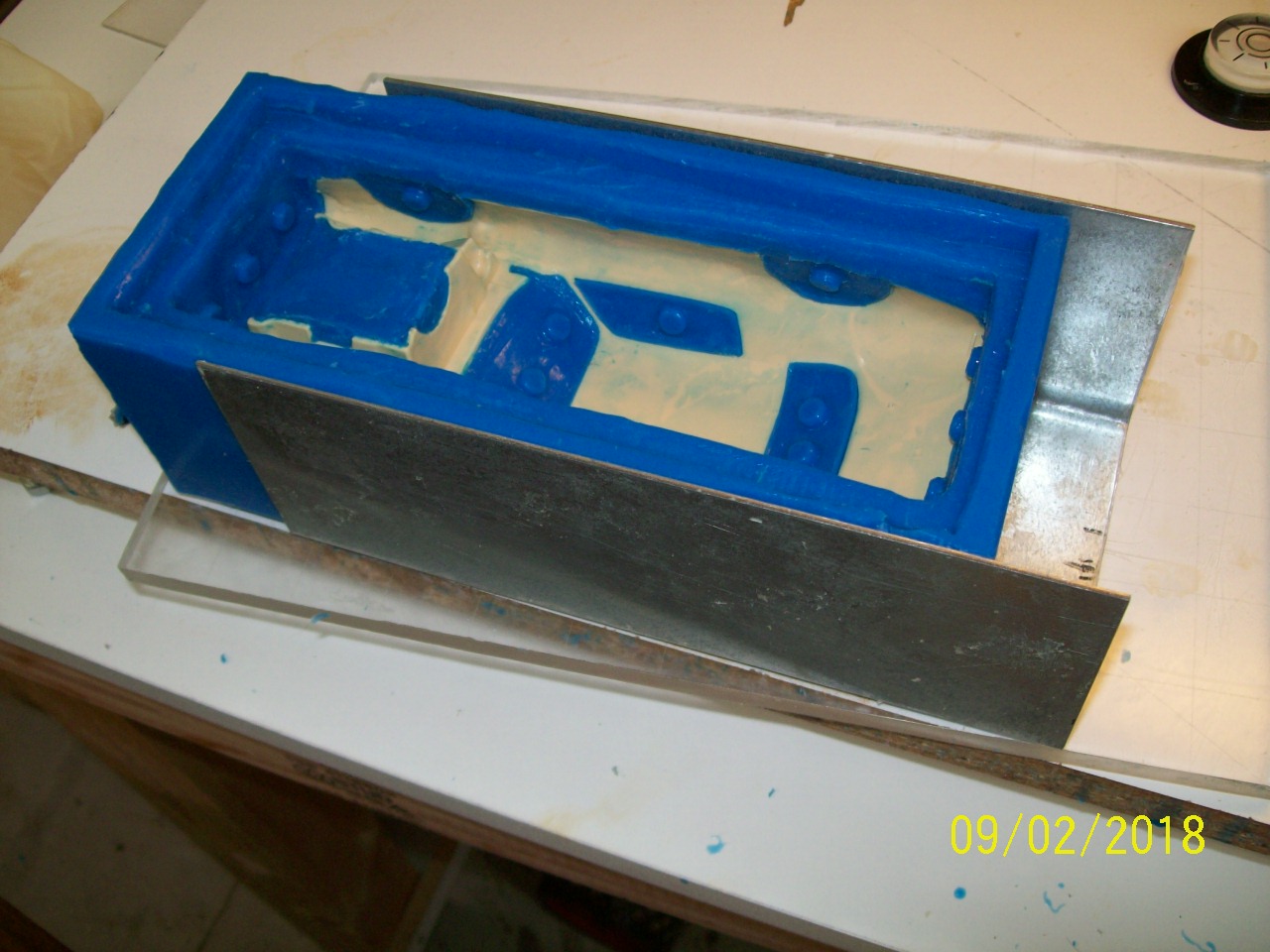

Thank you, Tonio. Here are the first couple of bodies out of a fresh mold. Once again notice how thin the flash in the window openings is. Some of it just pops out on it's own upon demolding. Cradling the mold in heavy sheet metal and adding the dimples was a great invention for myself. While these inventive ideas are probably considered my intellectual property, I share them so that other casters might be successful in making parts that are actually useful to a model builder. My parts are Modelhaus quality if not better. -

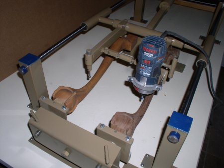

I found a piece of woodworking equipment called radarcarve. Hopefully this post won't go way since I did not post the website. I was told by the moderator that posting a link to a site that was not model related was a huge NO NO. That is what I thought off topic topics were for but shame on me anyway! So this is a cool tool if you want to copy something into a wood item. I am going to need it for my speaker cabinet design. Thought you might like to know this exists. Instead of a link I will push my luck and post a photo. He didn't say I could not post a photo Greg

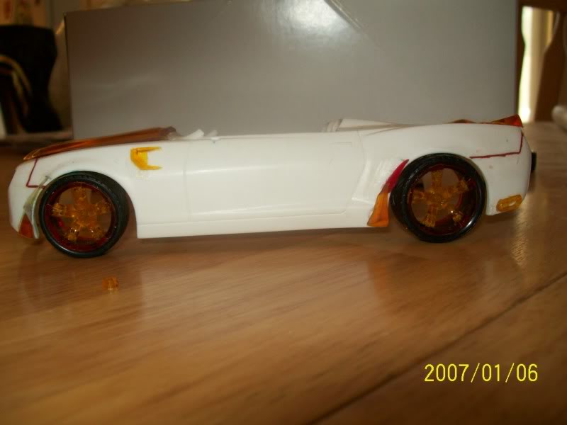

http://ponchoperfection.com/ https://horsepowersports.com/clear-wheels-for-your-car-by-forgiato/ Thank you for your suggestions, Snake. Mike Schnur has looked at this 67 kit. He said the body is the most accurate one that he has ever seen. Tim Sickle made contact with me about the parts above. He writes for Pontiac Perfection Magazine. He wants some of these parts to write a column about them. Here is a experimental project I worked on a few years ago. Someone was selling a concept convertible Camaro body. I thought a Pontiac Trans Am Roadster was a better idea. I made a few parts that would be created in a "What If" scenario for a car to be built out of modern materials that were transparent. I really like the spoiler I made. Actually if you do a search for transparent wheels. I found that such a thing really does exist for real cars. Unfortunately for me my interest is all over the map and I am a horrible organizer too. I have trouble staying focused on things. My head gets full of ideas. I also have a interest in vacuum tube stereo equipment and speakers. I have built some kits. It is quite a lot of fun to build these amplifiers. I am a member of a Audio Video club here in the valley. The group met at a record shop. The owner also sells audio equipment. I mentioned building kits. He said that he did not think it was possible to build such a thing. It is a shame that the allure of Heathkit is long gone. Most everyone today wants that instant happiness. These gold transparent parts had House Of Kolors Pagon Gold Kandy dye added to the mix. Transparent resin is not always fun to play with, it can be a real pain. I also made this hood with the traditional shaker scoop. At some point I dropped the body and broke the windshield frame off. The fender vents and spats were in my MPC 76 Formula kit. The spoiler parts are sanded down wheel spats. I do like my deck lid spoiler. One of these 1 to 1 would look cool and have a real attitude! -
