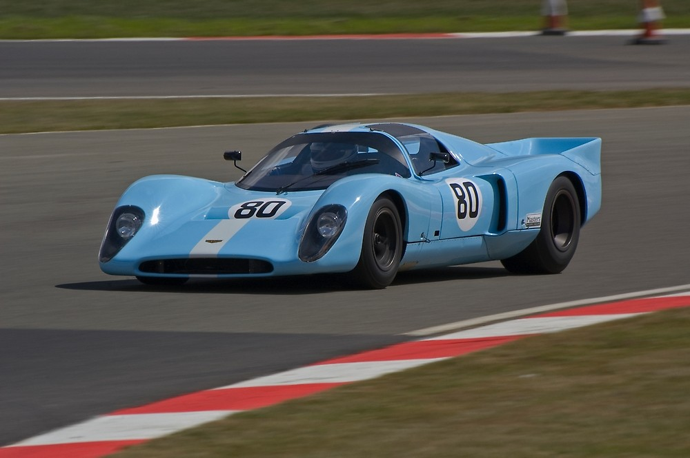

Only reason I knew this one is 'cause I've followed limited production cars with fiberglass bodies...and all things early Porsche...most of my adult life. Those canted-quad headlights make it pretty hard to forget, too.
