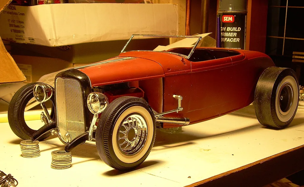

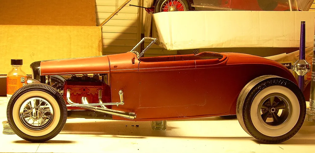

OK...those wheel backs and the way the brake drums fit them was really bugging me. I found some mystery chrome backs and made a test rim from one. Assembled, they just didn't do it for me. They're about a scale inch smaller than the old 16" rims, and though you can't see both sides of the tire at the same time, the finned drum didn't look right with no clearance around it either. That's the '50 Olds generator getting its bracket finished up on the right. What to do? I remembered I had a gluebomb AMT '40 with the old 16-inchers. Trashed, not restorable, but 2 of the rims looked salvageable. Red too-small test rim on the left, a black 16" rim salvaged from an AMT 16" wheel, and another wheel...plus the wheel and tire that'll be on the front of the car. These things were a double-barrelled bugger to work with, as they had the tire-melt blues, and one insisted on crumbling a couple of times. Got two done and primered, finally. Had to turn down a dowel to make a tapered sanding stick to do the insides without breaking the damm things. Assembled with the right amount of clearance around the fins... Yup. This'll work. Painting the things has been a nightmare too. OLD can of Testors dark red enamel, almost no gas left in it, and it wants to bubble more than anything else. I can't believe I'll be sanding and polishing inner wheel rims. Oh well. Then they'll be done. (I shot the wheels years ago with the same can, 'cause it glossed so nicely with no additional work; that's procrastination for you.) Made a shim for the back of the hood and dialed in the fit at the cowl and radiator shell to my satisfaction too. -
