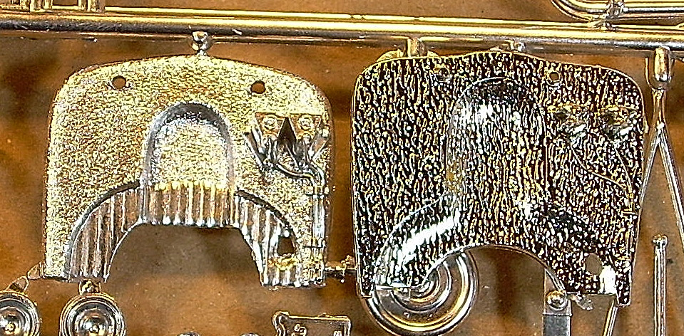

New-tool windshield on the left. Fairly similar in proportion and height. Old tool firewall on the left here. It represents the original car more correctly IIRC. Now for the real insect in the ointment. The new-tool valve cover is on the left, and is ridiculously under-scale. This has been debated endlessly, but the original Dodge Red-Ram valve covers are scaled almost dead on the money. Tiny little heads to match, in the new-tool kit. The new-tool block (bottom part in gray plastic) is also under-scale, but the trans is about right. Go figure that one out. The gearbox in the old kit is actually one of the best early Ford gearboxes ever mastered. And the really odd part: there IS sufficient room in the engine bay of the new-tool kit to fit the correctly-scaled engine. Yes, it's very tight, but it is on the real car too.

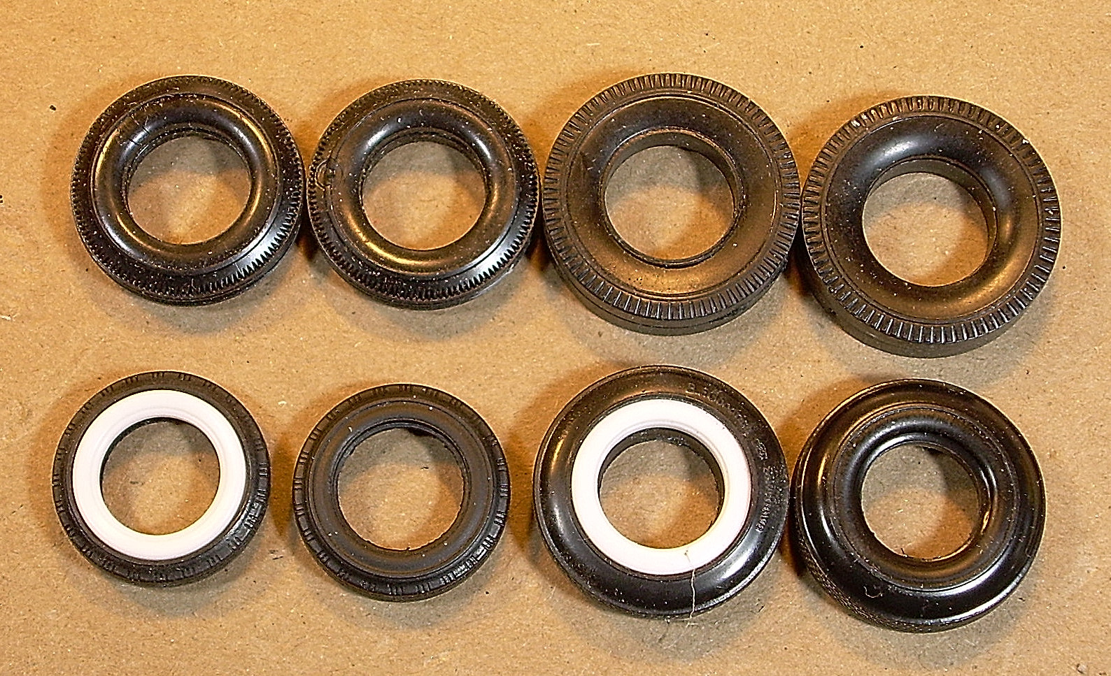

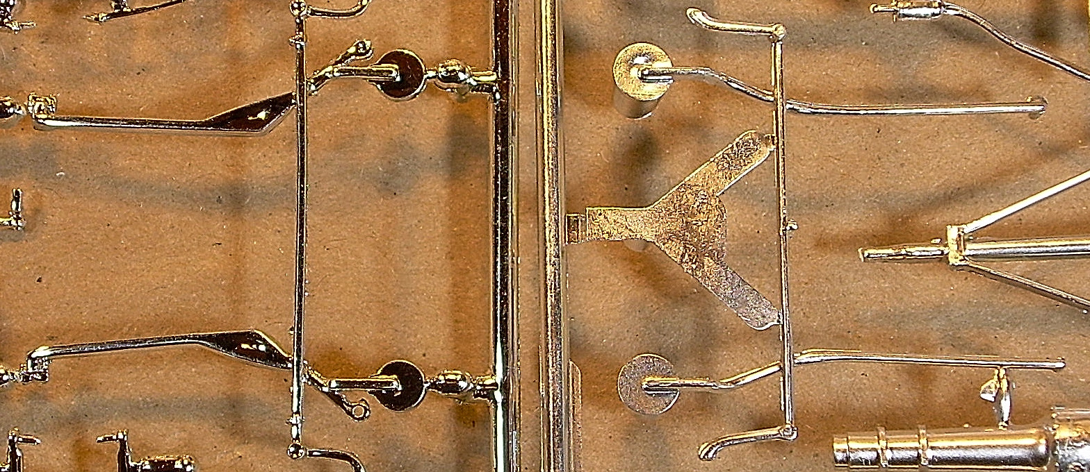

For those who are interested and would like easy access to Part One, or who missed it entirely, click here: It's been a while. But here are more shots of the parts of the two kits, compared. Original issue tires above, "new tool" tires below. The new versions are nice, with insert whitewalls. They also appear to be scaled to 14" rims, while the early ones were 15" Original issue wheels on the left, new-tool on right. Again, the new-tool parts appear to represent 14" rims. Rear axles, original to the left. The newer part looks a little better, but it fails to render the diff center section correctly. Front suspension wishbones and steering linkage, original on the right. The newer parts are probably preferable here too, but they need some work. There are pretty significant proportion differences on the top. I tend to think (without measuring yet) that somewhere between the two is correct. There are differences in the trim stitching as well. New tool part on the right. The original frame is on the left, new-tool on right. Pretty similar. I don't honestly know if the real car has a chromed rear crossmember. Need to look into that.
