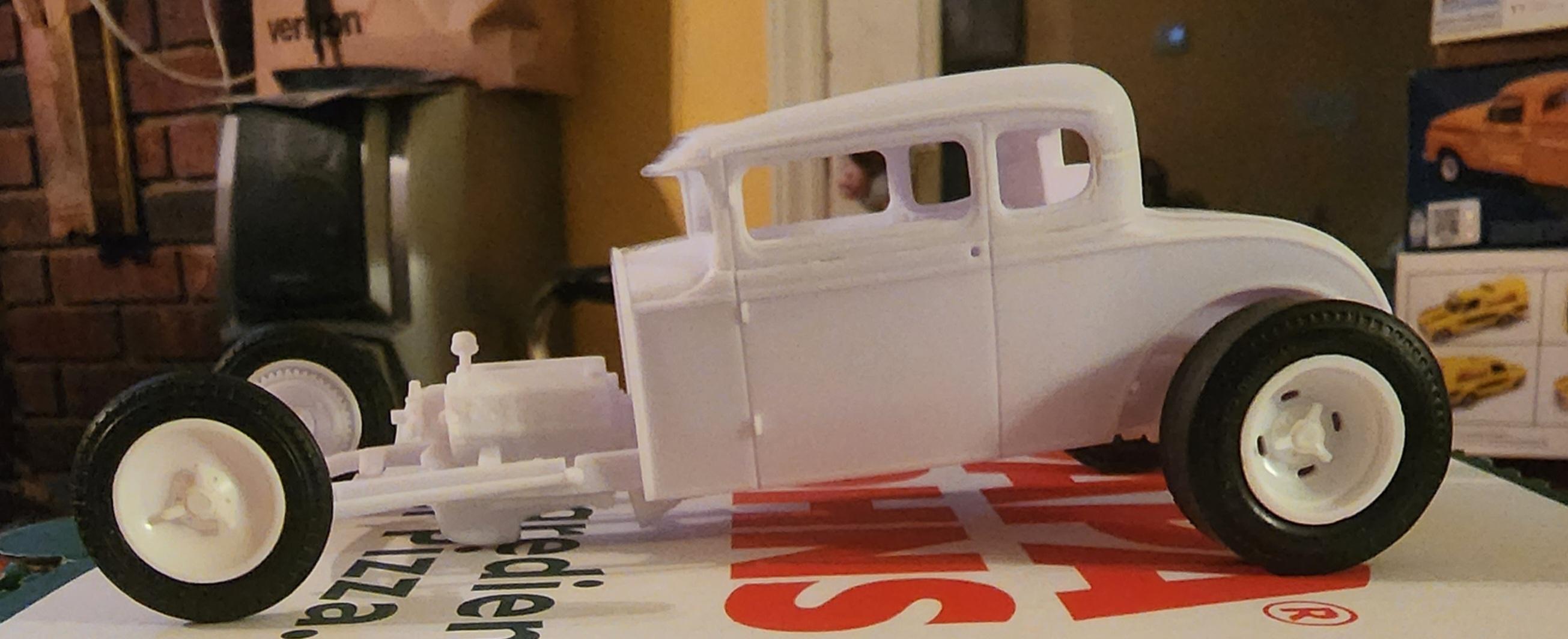

  18. See is there's enough meat in the sides to thin them down a bit. Even if it won't fit in the notch the 29 firewall does you could remove about 1mm from the back of the 31 firewall and just flush mount it to the front of the body.
