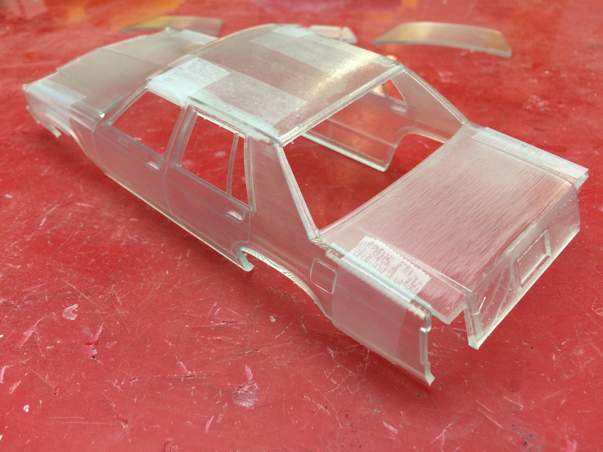

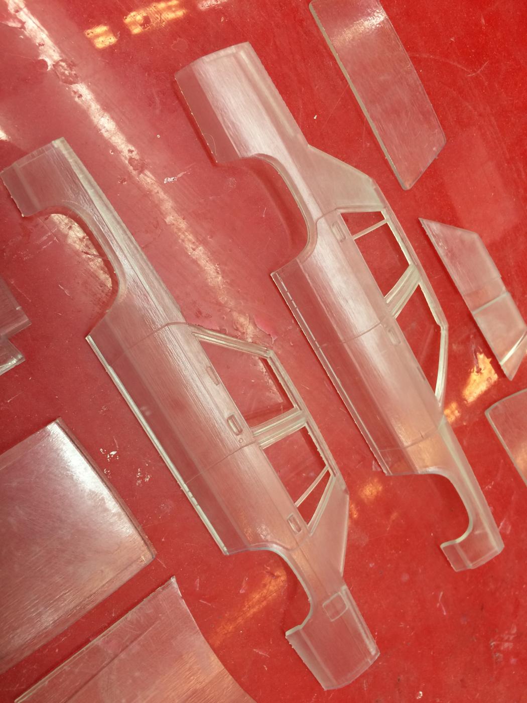

Yes, I'll paint it because I want the castings to be glossy. The material is Watershed 11122, which polishes easily to a rock hard finish, so I'll polish the glass parts.
 Veg oil in this case would screw with the primer so I can't use anything like that. These parts will be as clean as possible. No washing needed due to the alcohol scrub bath after removal from the 3d resin in the printer.
Ive never had anything react badly to printed parts. I use superglues, exceleraters, acrylic clean, paints, primers, etc. Plastic solvent won't work as a glue, but UV solvent glue will. I've stored parts for 8 years with no ill affect.

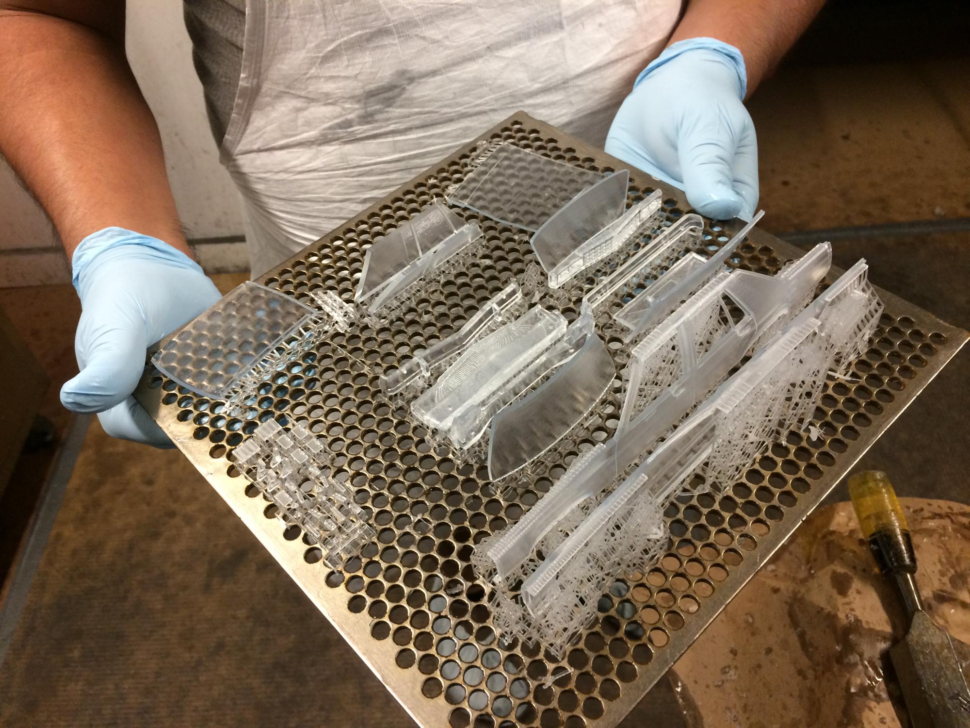

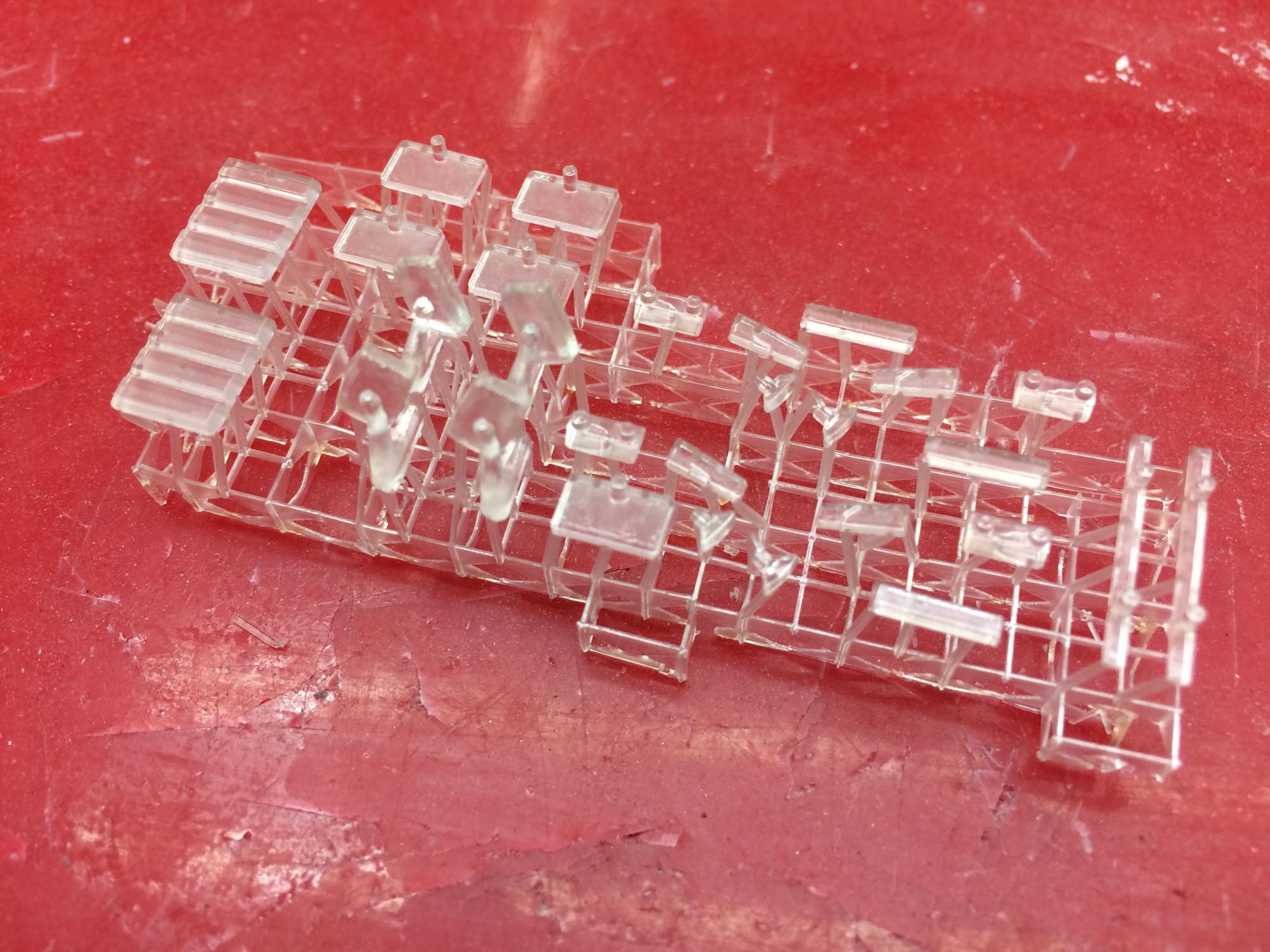

The only only issues with 3D SLA printing are:
1. that it is pricey at this time for one offs
2. A lot of sanding layer lines for most printers (unless you use a super high resolution printer where you can't see the lines. I've used these for cockpits)
3. not archival. They sag over time unless you support it with other parts or material. FDM and SLS do not have this problem, but don't have the same detail.

I'm sure this will be a popular model to have and I'm amazed at the lengths you going to ending up with an injection molded product! I'd be interested in seeing how the body comes from a 3D printer as I'm just beginning to have some parts made that way.
thank you Foxer. Photos are above

The Lindberg chassis fits so far. The backs of the front wheel wells need to be shaved. The front and back of the chassis need to be trimmed to fit.
With the body done, I'm now able to make the interior.
I don't like the grille and will redo it. It looks a little squat.
i think I can add some thickness to the turn signals and lower the bottom line of the grille
That looks really good. I agree that the bumper is too close to the headlights.  The other thing that jumped out at me is the gap around the fuel door.  It seems awfully wide and deep.  The door lines seem much more subtle (which to me looks better).
