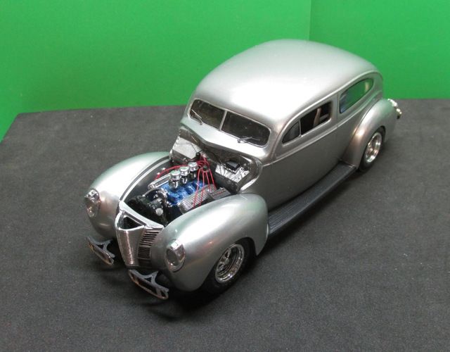

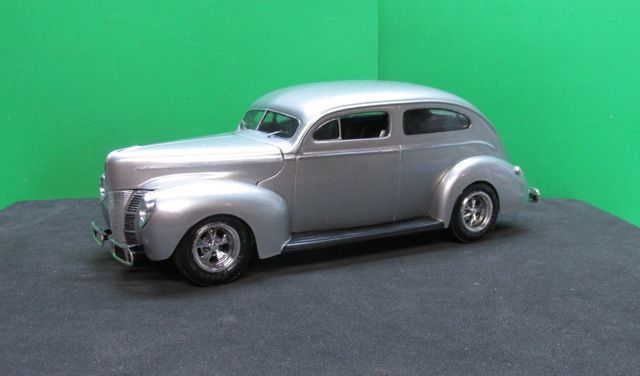

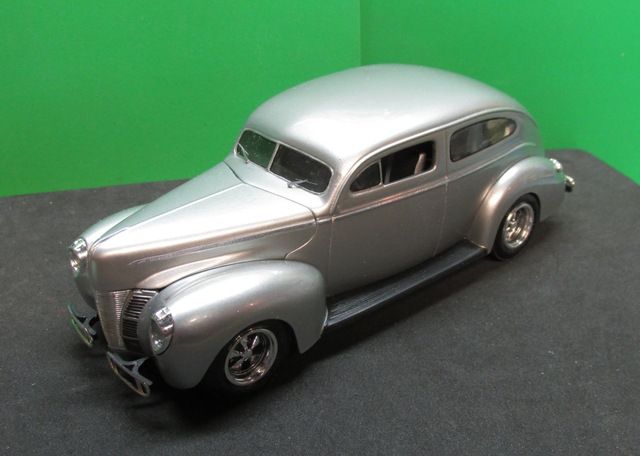

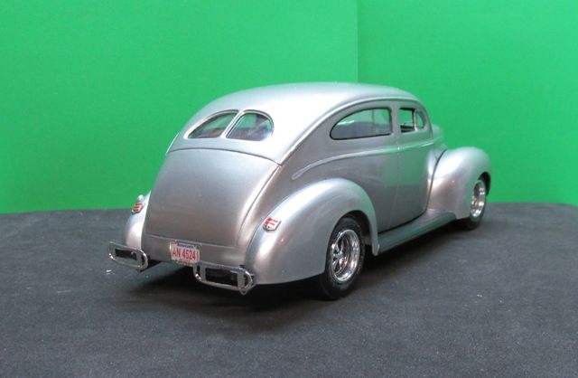

This is a first for me as I am usually in the truck section with some fire apparatus models. But a friend asked me to build this custom Ford of his 1:1 ride. The body is a resin casting that was already chopped. I did blend in the full size rear window as that is what his car has. The glass was also individually cut to fit inside each opening so that it would not look like it was so far inside the resin body. They are held in place with two part epoxy. Paint is a Chysler silver.
Easier than it looks, PeeKay. I laid the plastic glass inside the opening and then drew around the perimeter of the opening with a fine tip marker. Then each one was cut out using a dremel with carbide disk. A bit of sanding on the high spots was about all it took. When the fit was right I used a Magic Marker to coat the edge of each piece. Two part epoxy was mixed up and used to coat the edges of each opening. When it began to set the "glass" was pressed into place. Since the epoxy was still soft it was easy to get the pieces set evenly all around without the epoxy messing up the surfaces.
