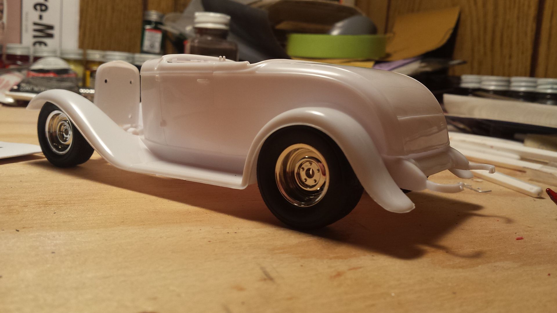

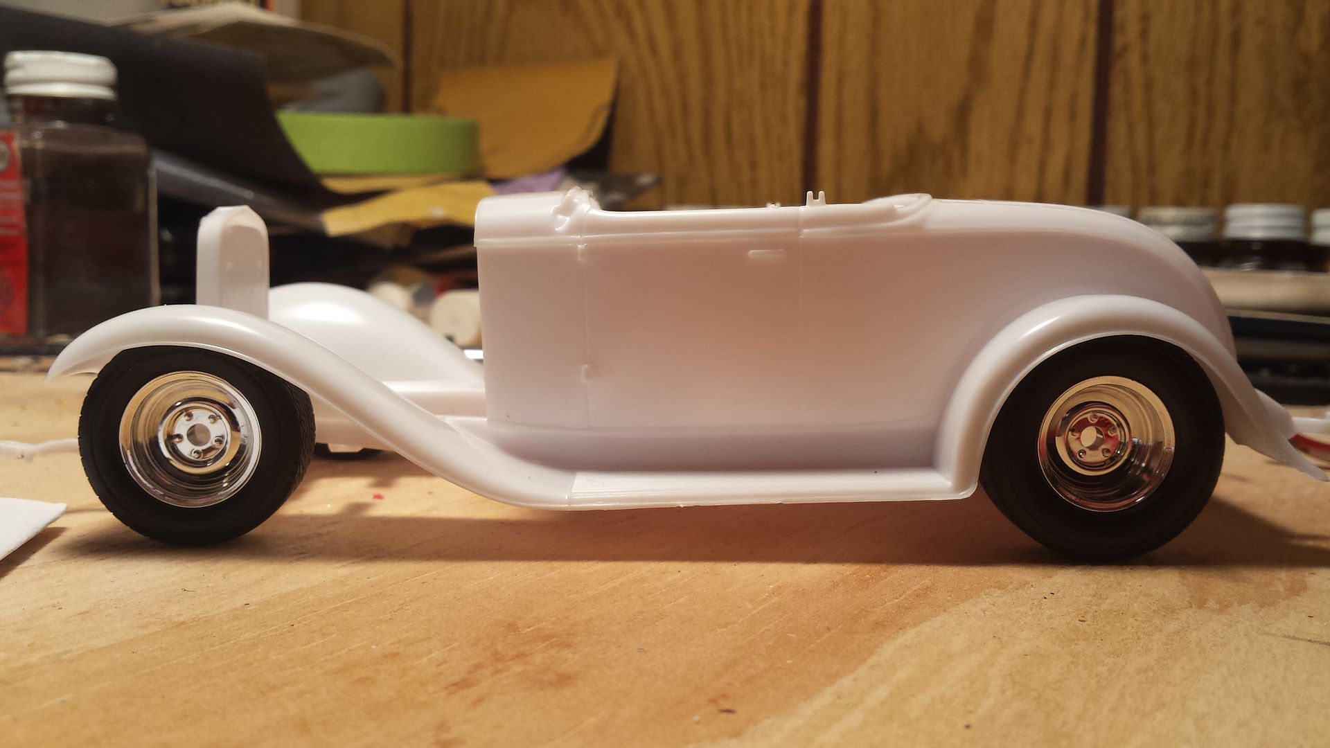

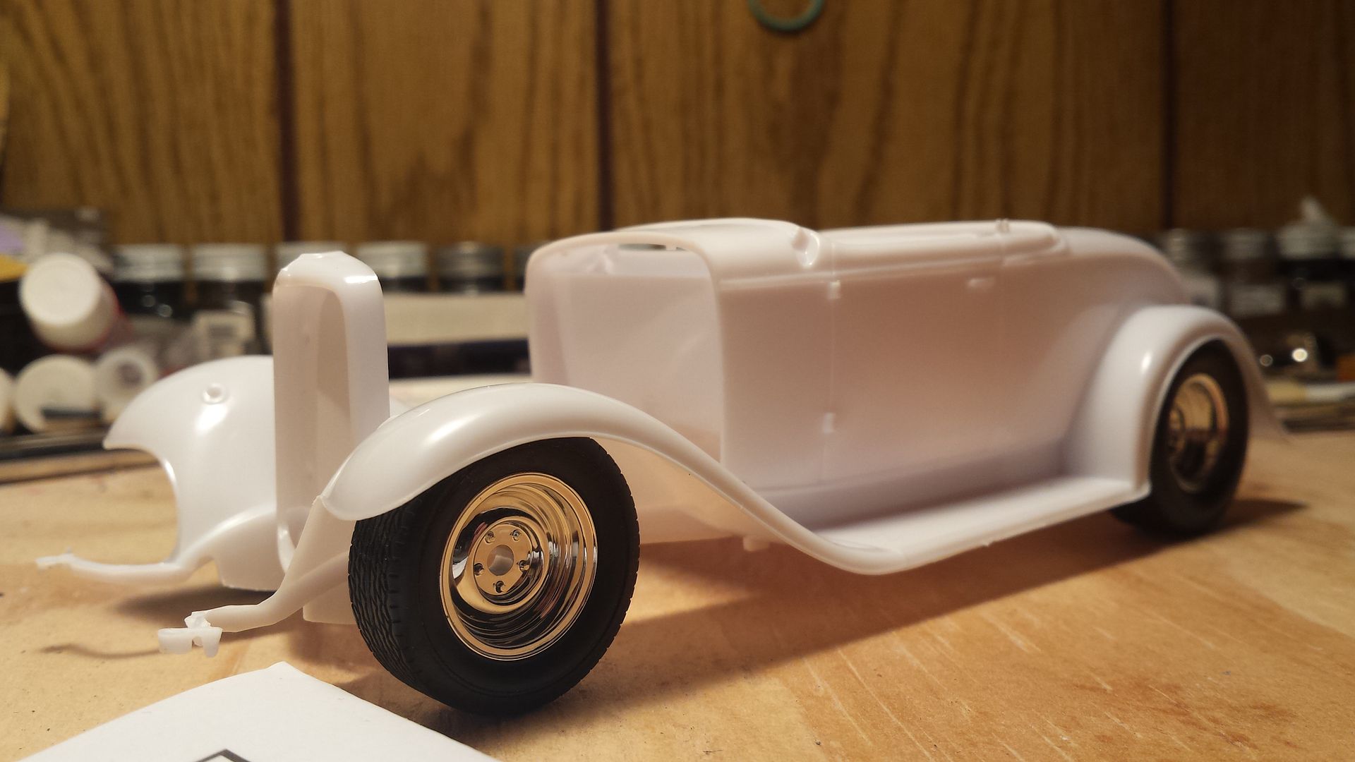

JTalmage Posted July 8, 2015 Posted July 8, 2015 (edited) Pulled my most recently purchased kit off the top of my stash because I was drawn to it. It's the monogram topless 32 ford with the fenders and frame as one unit.I would like to make it sort of a 60's hot rod with a bit of patina. I found some finned valve covers in my parts box and realized I wanted a 3 carb intake after I already glued the single 4 barrel intake on... whoops.Anyone know off hand what kit I could rob a 3 carb intake from, for a smallblock chevy?Anyway, I was initially thinking of painting it cliché flat black... but remembered I had a can of model masters honduras maroon. I think I'll paint it that color and hit it with flat clear. After some weathering of course. Complete with an off-white firewall and maybe a touch of rust here and there. What are your opinions? Edited July 21, 2015 by JTalmage
jacoballardtattoo Posted July 8, 2015 Posted July 8, 2015 Sounds like a great project, can't wait to see it come together.
carnut Posted July 8, 2015 Posted July 8, 2015 (edited) You got the stance already nailed down, looks cool. The Monogram 32 Roadster is a decent kit to build. As far as what to use for a triple carb setup in 1/24 scale you have me a little stumped. Can't wait to see more. Edited July 8, 2015 by carnut
JTalmage Posted July 8, 2015 Author Posted July 8, 2015 It won't be that low, but I'm going to try to get it close. Pics were mostly for attention. Haven't done anything to it other than gluing the engine together to test fitment.

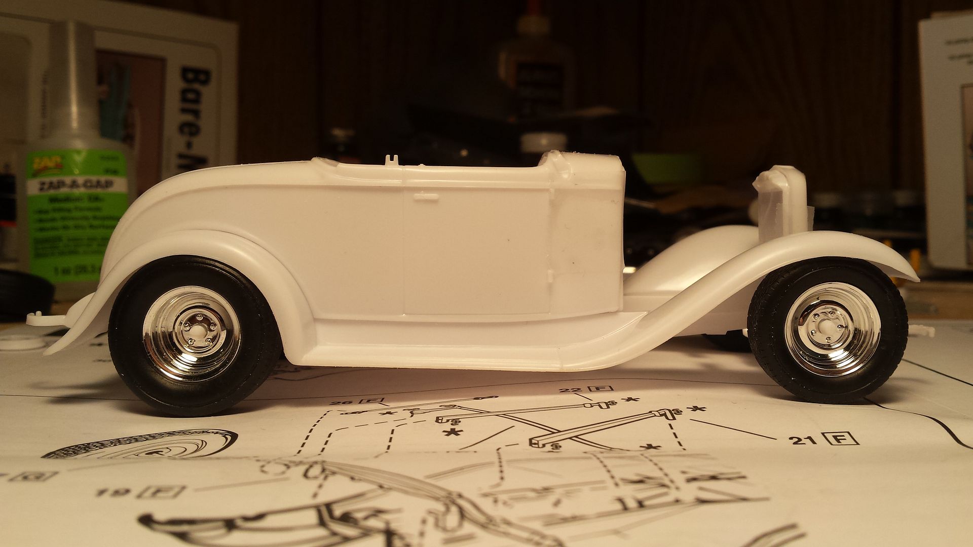

JTalmage Posted July 9, 2015 Author Posted July 9, 2015 Well go figure, I overlook the 30 model a touring sedan hot rod for like a year at the hobby shop and the one time I want it it's gone. Oh well. I'll probably just stick to the kit engine. I'll check my parts box this weekend for something just in case. Tonight I worked on lowering the stance. And now it's about as low as it can go. No pics because nothing is glued in place and it raises back up a touch when I let go. Soon though
oldnslow Posted July 9, 2015 Posted July 9, 2015 Looks like you have a nice start on your car. I built one a little while back and used an old Nascar kit for suspension and running gear, The engine fit headers and all, the rear suspension dropped in too, all I had to do was add a strip of styrene to the inside of the fenders assembly to replicate the missing frame rails.
JTalmage Posted July 10, 2015 Author Posted July 10, 2015 Here's a pic of the final ride height. Took a bit of sanding and shaving and tweaking. I had to even sand/shave the insides of the front fenders so it would still roll lol

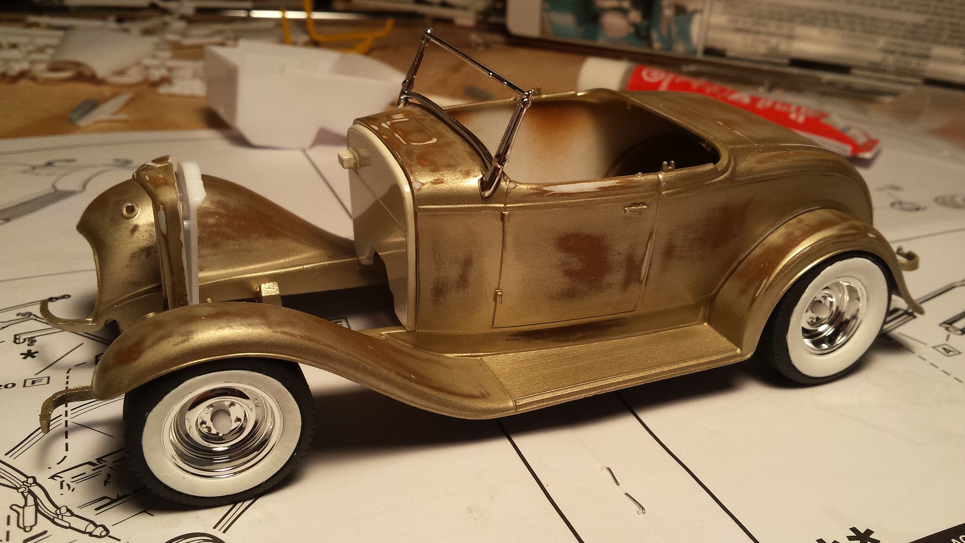

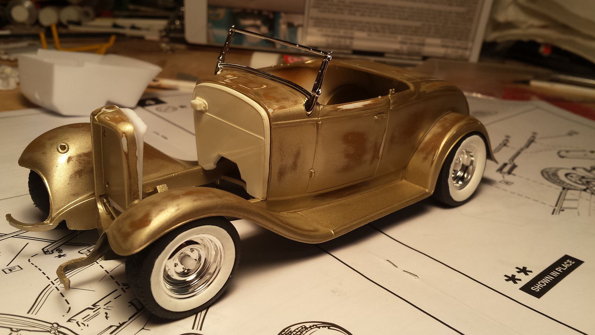

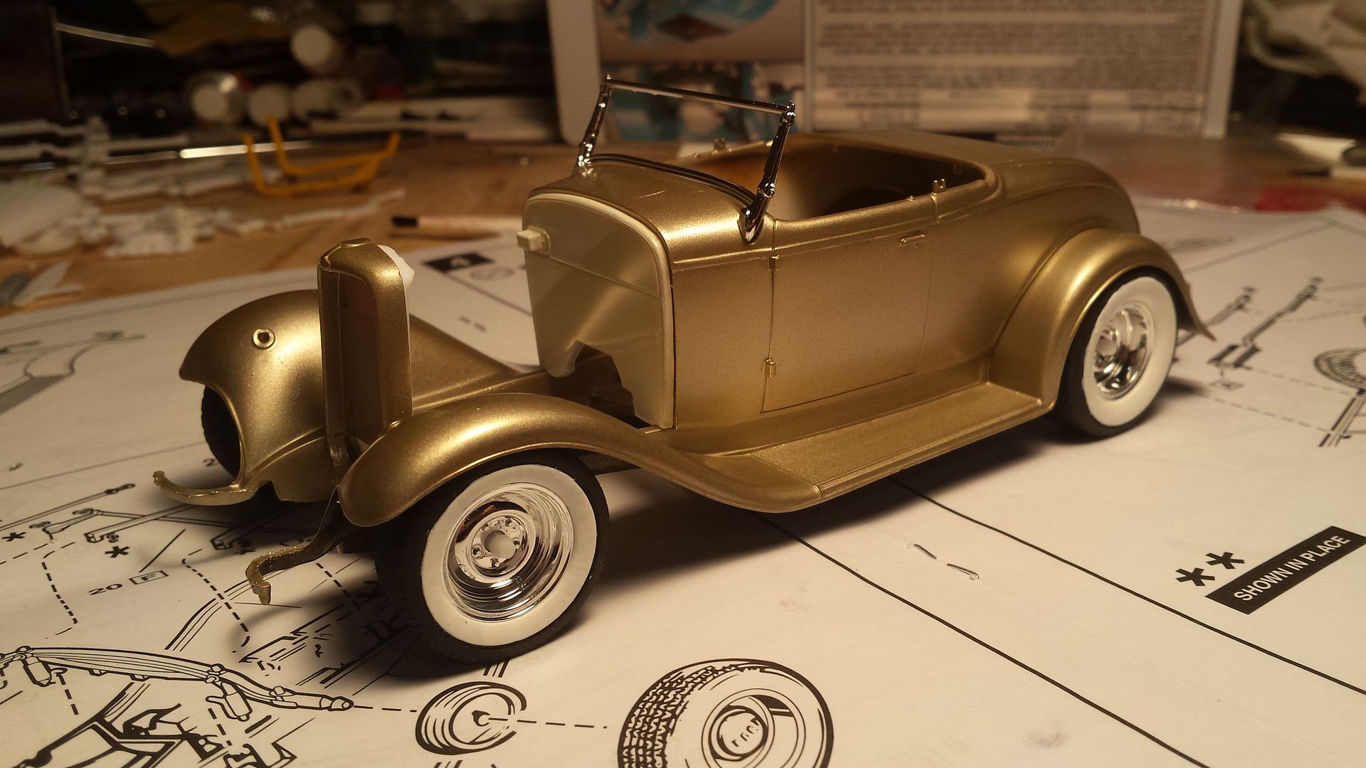

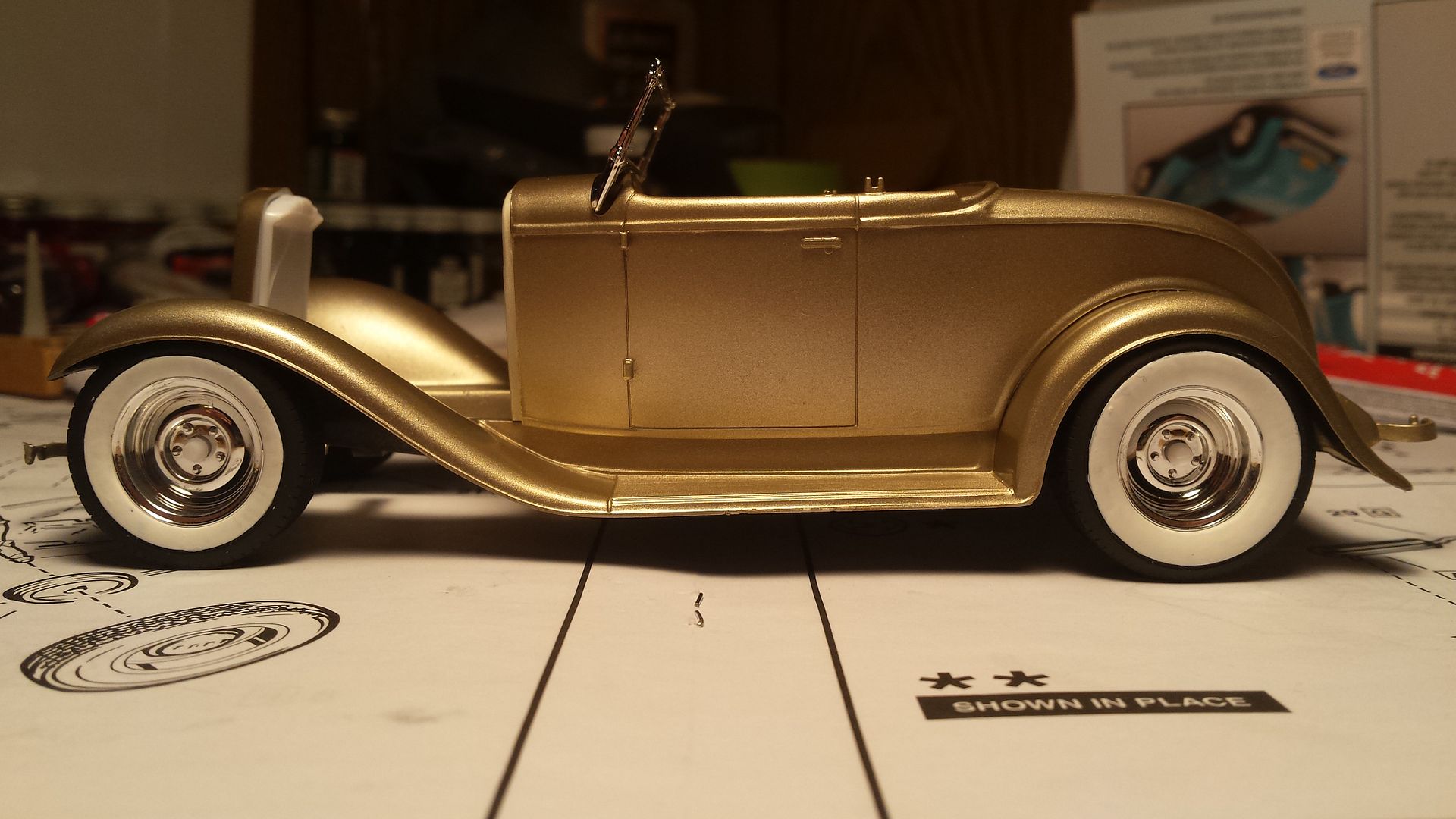

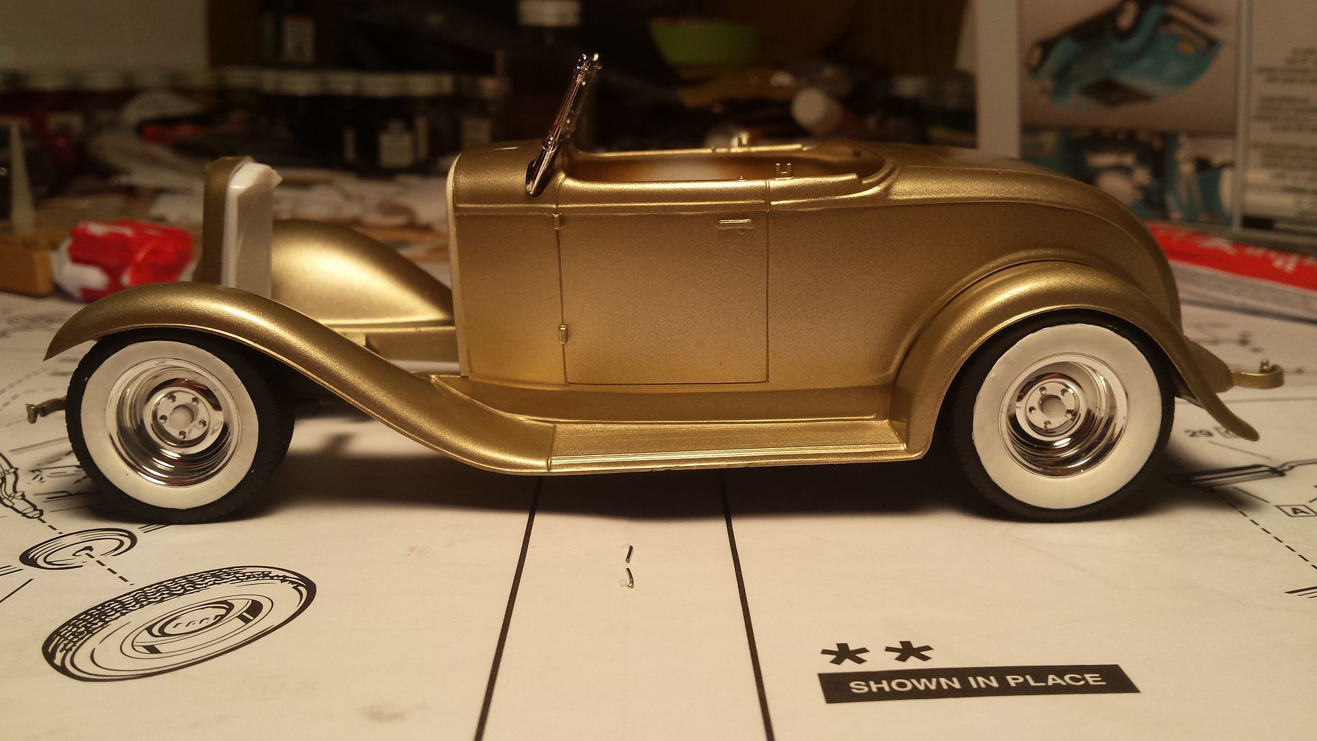

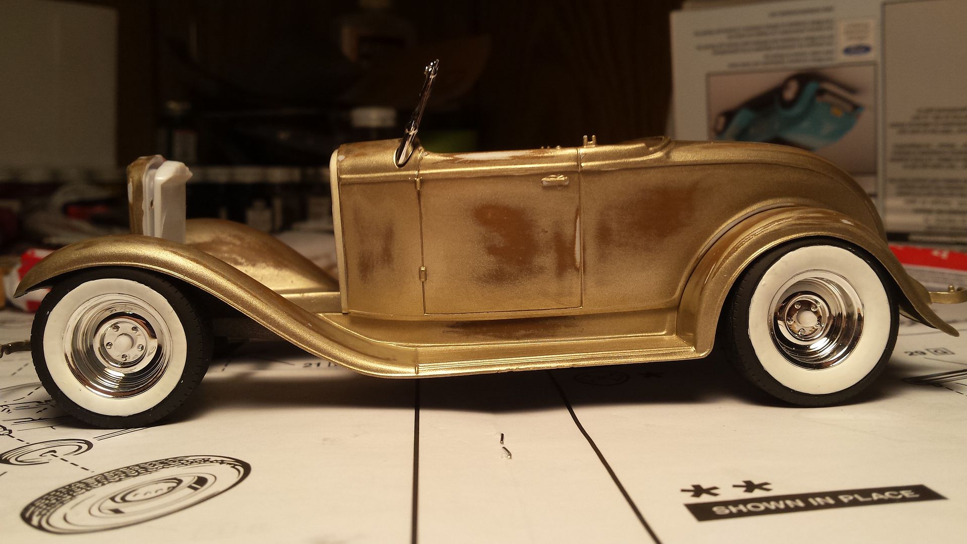

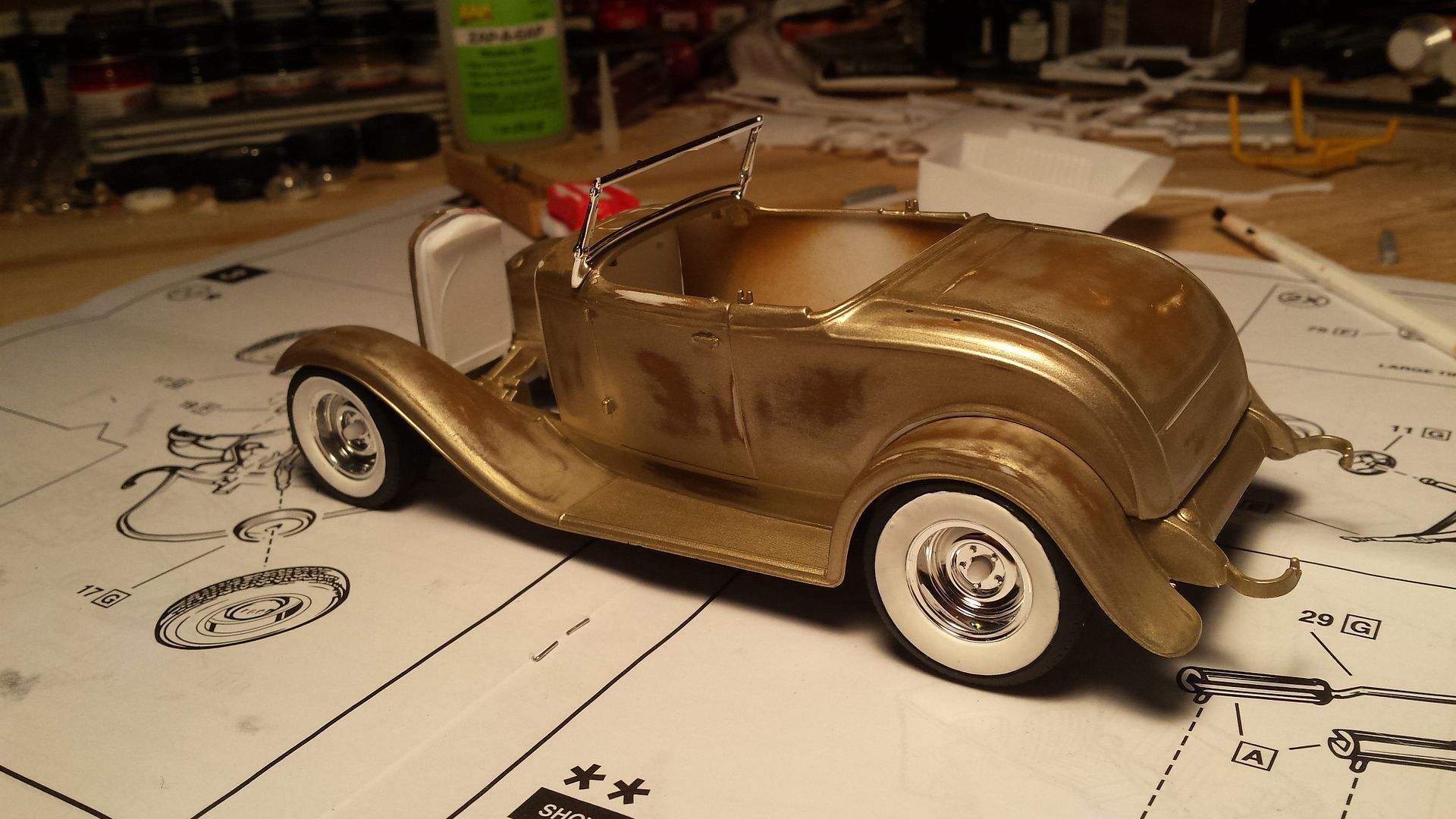

JTalmage Posted July 13, 2015 Author Posted July 13, 2015 So this weekend was looking good until I couldnt help myself... and you'll see why. So at first I wanted to make this thing a worn looking ride. I thought it would look good. Turns out I'm not so good at that yet. So here's how it started out That's when I decided to try and make it looks like an old custom car that was showing its age. I had originally painted it w/ tamiya red brown underneath to simulate an old red primer that might have been used in the 50s/60s. Then painted the titanium gold over it. Well at that point I started to really like how it turned out... but curiosity got the better of me.... and... this happened... So then after that, I said ok the spots I went thru the paint on, I'll touch up w/ sophisticated finishes rust and then flat clear the whole thing. that's when I decided I really liked the shiney look... So it went into a bucket of purple power.

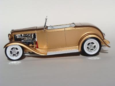

Flatout Posted July 14, 2015 Posted July 14, 2015 (edited) Jesse...nice color choice Here's one I built back in 2008, I think they look good in Gold too! The whitewalls turned out pretty nice...what paint did you use for them? Hope you have better luck with paint the second time. Edited July 14, 2015 by Flatout
JTalmage Posted July 14, 2015 Author Posted July 14, 2015 Wow! A splitting image! That looks great. I just painted them with testors bottle paint and then flat cleared them. Purple power is having a rough time stripping the Tamiya paint.... might have to resort to brake fluid. Didn't want to but we will see. Going to give it a few more days.
superbike-shaun Posted July 14, 2015 Posted July 14, 2015 J,I have heard 70% Rubbing alcohol will help y'a get it stripped or go and get some easy off hd.that will get you back to square 1.Shaun
Ace-Garageguy Posted July 14, 2015 Posted July 14, 2015 Wow. Gold IS a good color for a full-fender '32 roadster. I never woulda thunk it.
charlie8575 Posted July 14, 2015 Posted July 14, 2015 (edited) Actually, I think you did a nice job on the weathered look. It's not overdone at all, but rather looks like a car that was well-cared for and simply needs a little freshening. If you decide to use the Model Master Honduras Maroon, that comes out semi-gloss before applying the clear. It looks good for a weathered paint job that needs a good compounding to bring it back, if you want to go for a look that suggests that. Charlie Larkin Edited July 14, 2015 by charlie8575
slusher Posted July 14, 2015 Posted July 14, 2015 I can't blame you for stripping it the gold looked beautiful...
