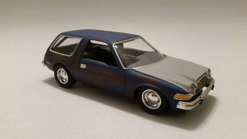

Boy, am I glad to have this one done. Well, nearly. Still have to fabricate an upper radiator hose and come up with a side mirror or two.

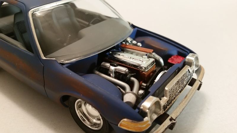

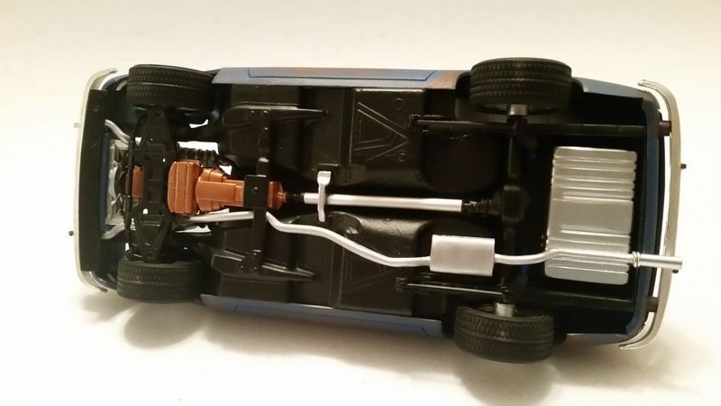

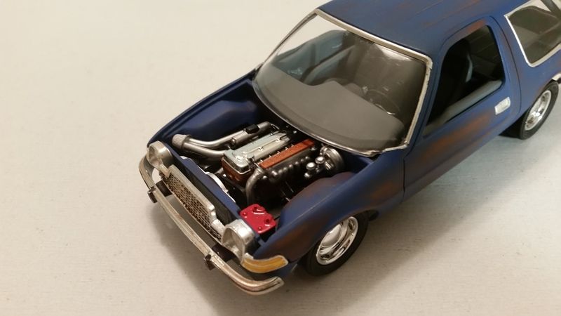

Anyway this is an AMT '77 Pacer Wagon. It's been build as a sleeper for this years Cannonball CBP. It's set up as a racer/drift car. I've added the twin turbo Toyota 2JZ from the AMT Supra kit. The turbos are plumbed backwards in that kit so some creative fabbing had to be done. I added an 90's Corvette front subframe and suspension. I modified the kit rear suspension, adding traction bars and a panhard bar. I built a six point roll cage and tucked it as tight to the roofline as possible to keep it as hard to see as possible. I fabbed a drift-style e-brake, using the arm rest as place a 1:1 builder would hide the brake mechanicals. Paint is Krylon and I used a chalk based weathering kit for the surface rust. On to the pics. It's not perfect, but I think it's a pretty convincing sleeper. Also, thanks to Ace-Garageguy for invaluable engineering advice.
