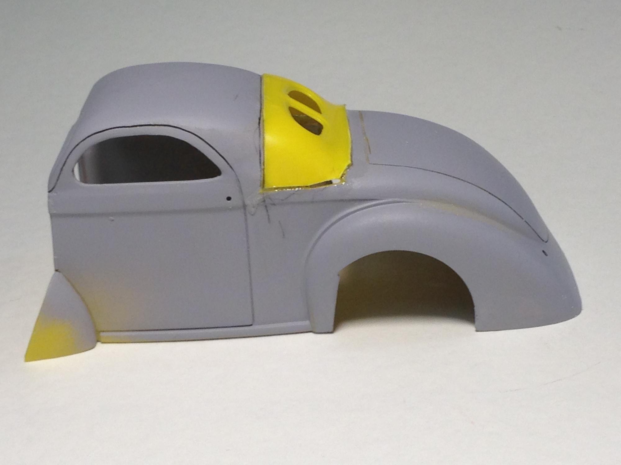

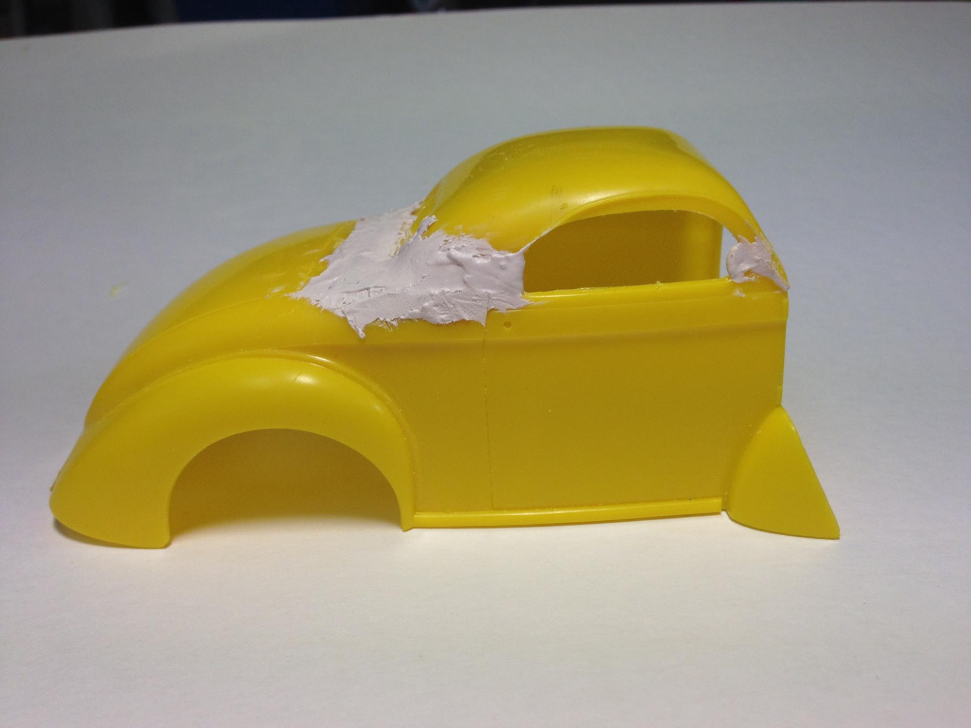

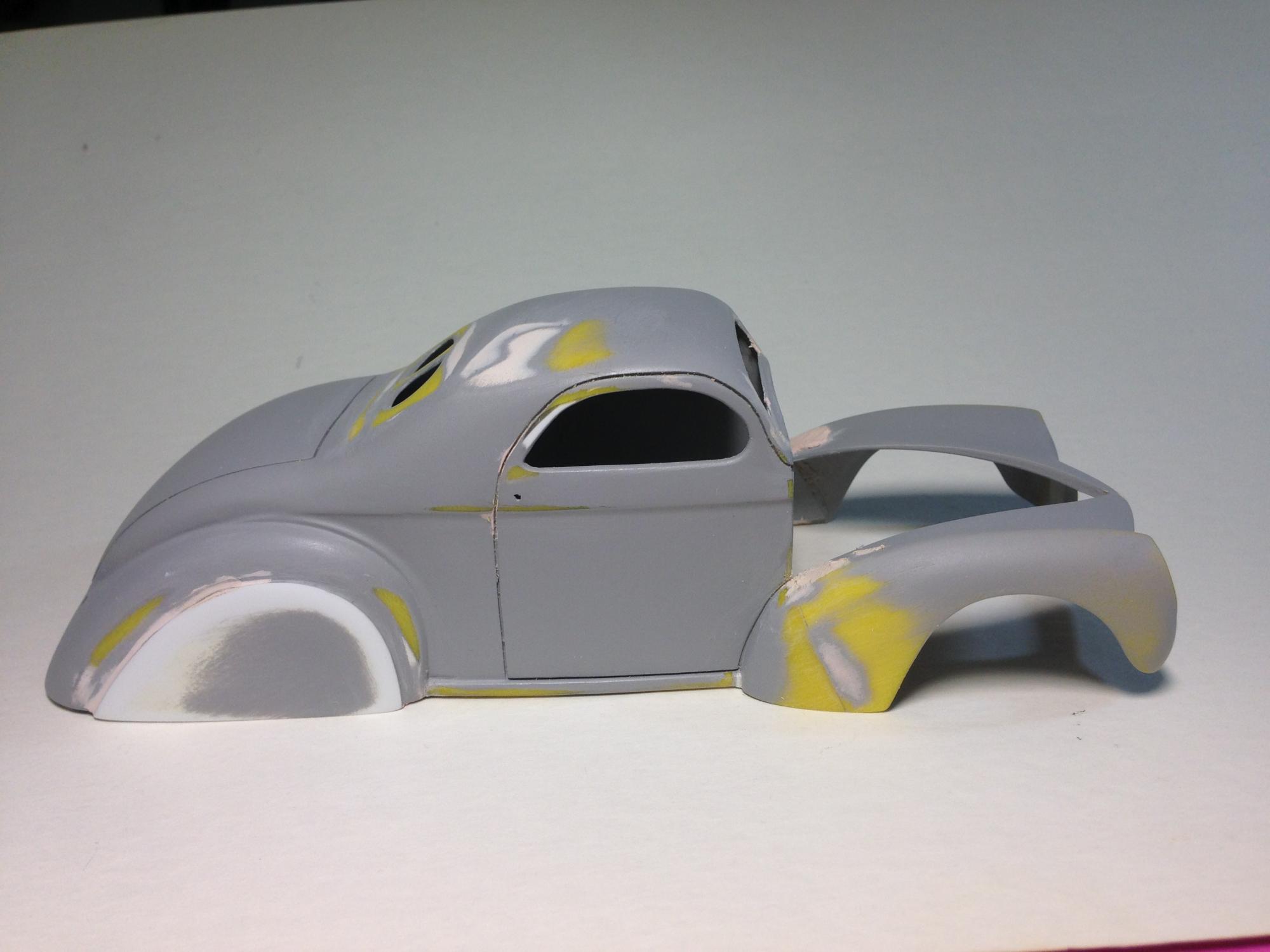

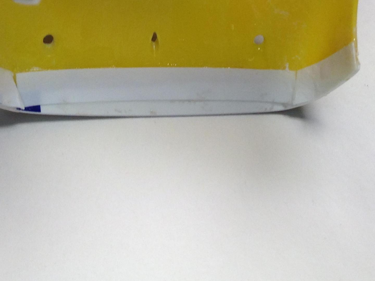

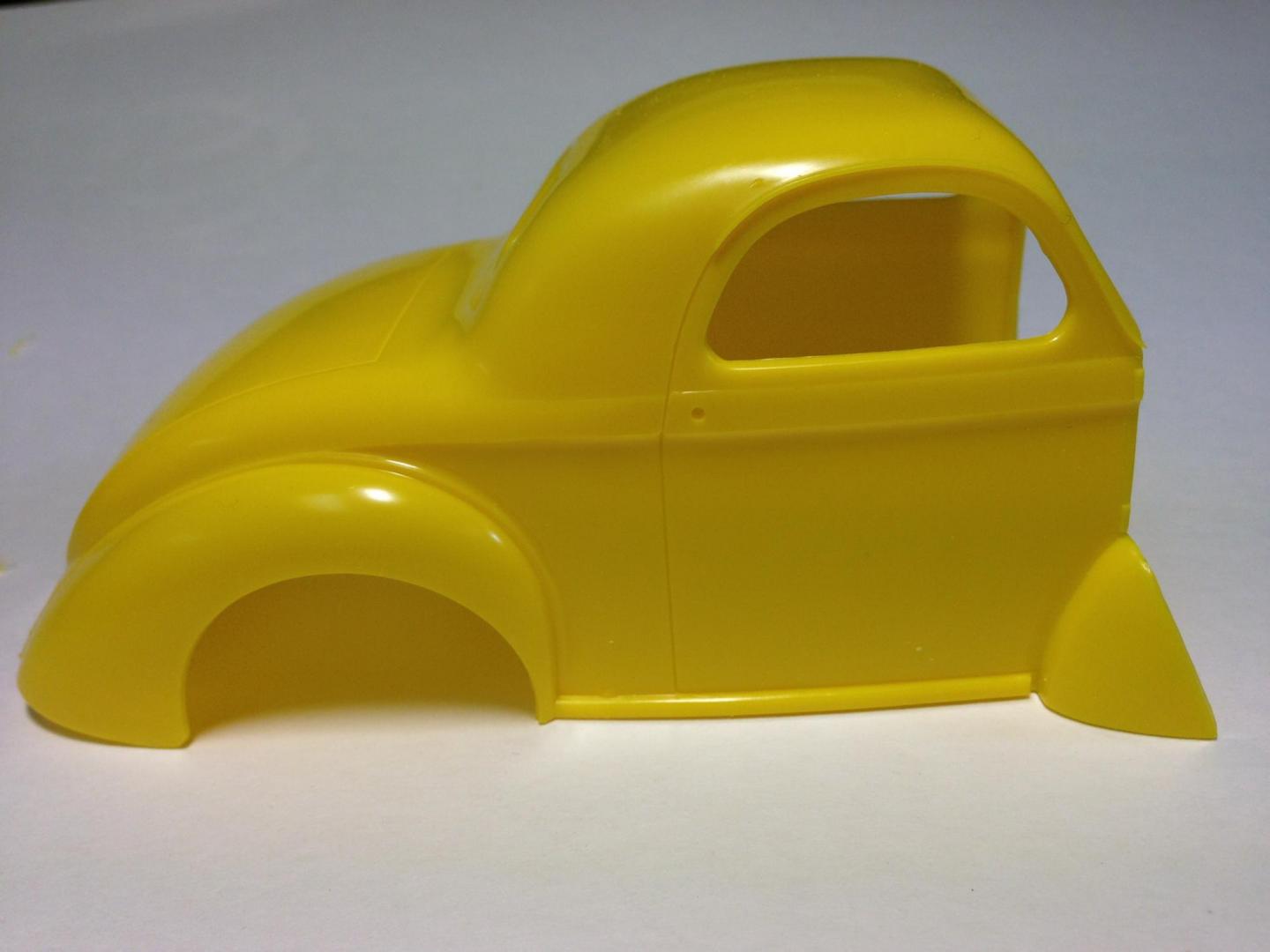

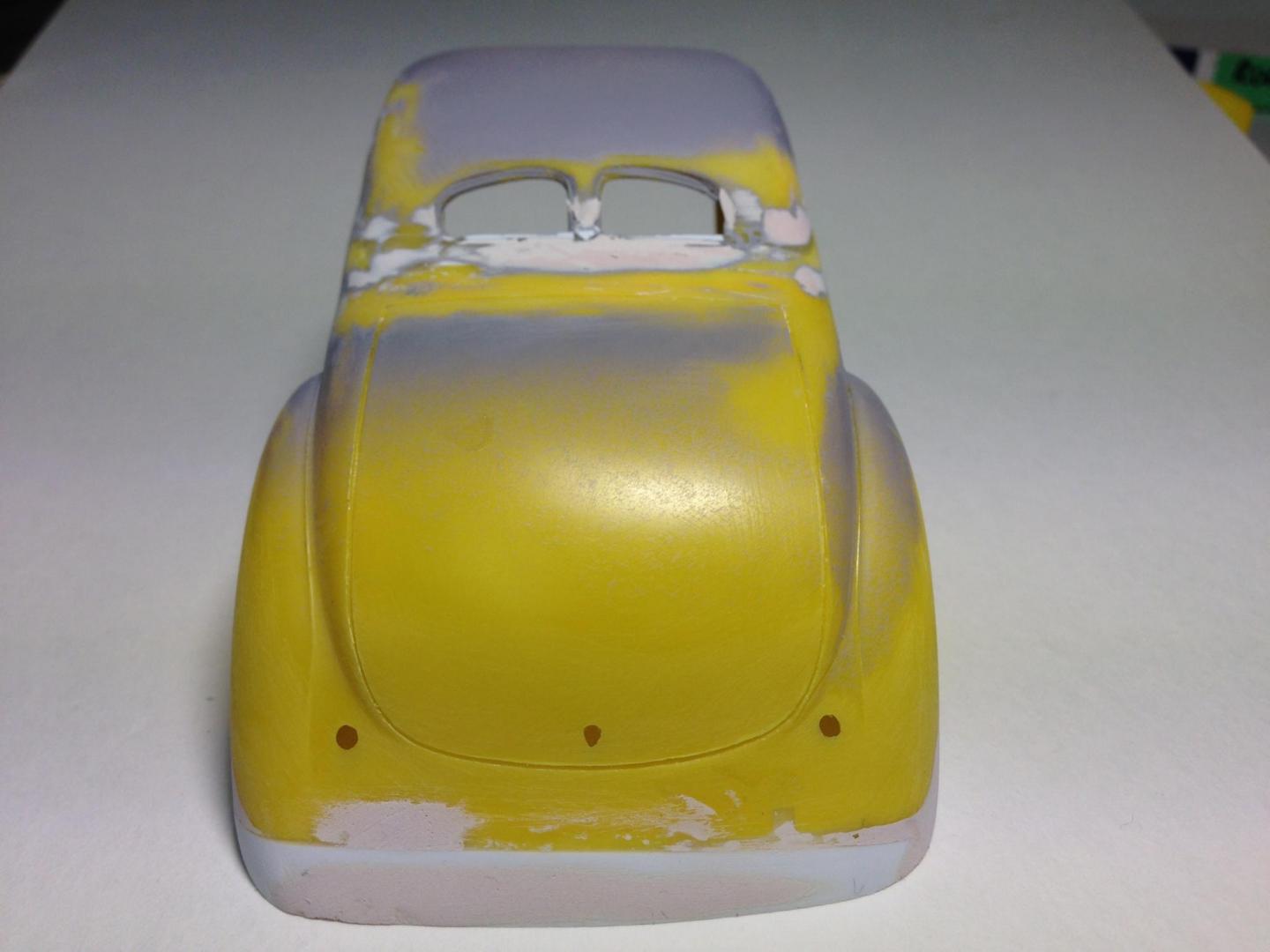

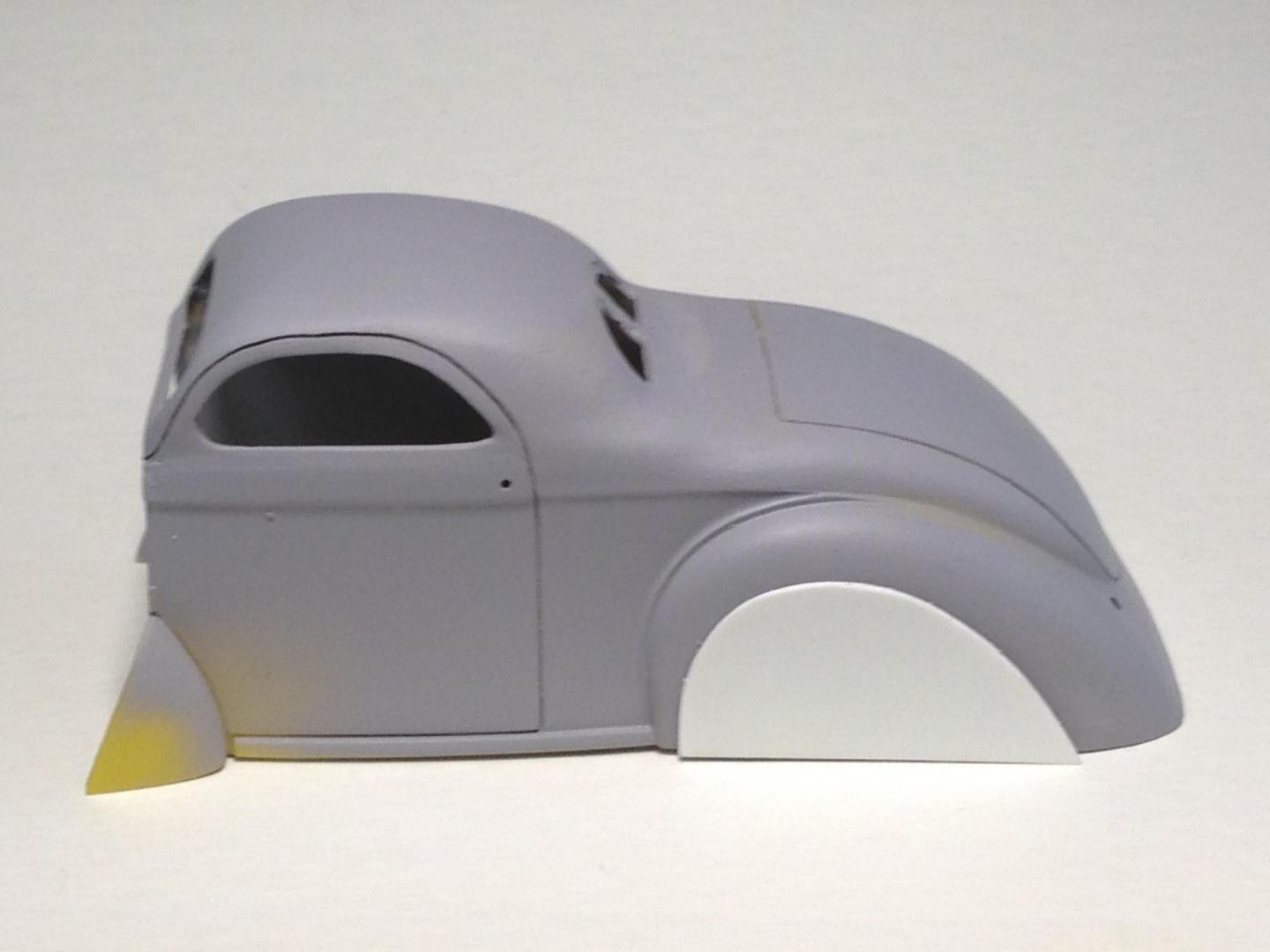

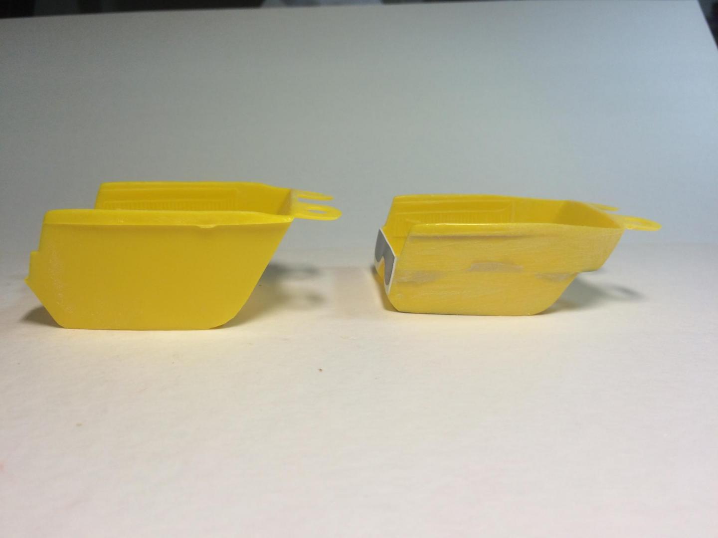

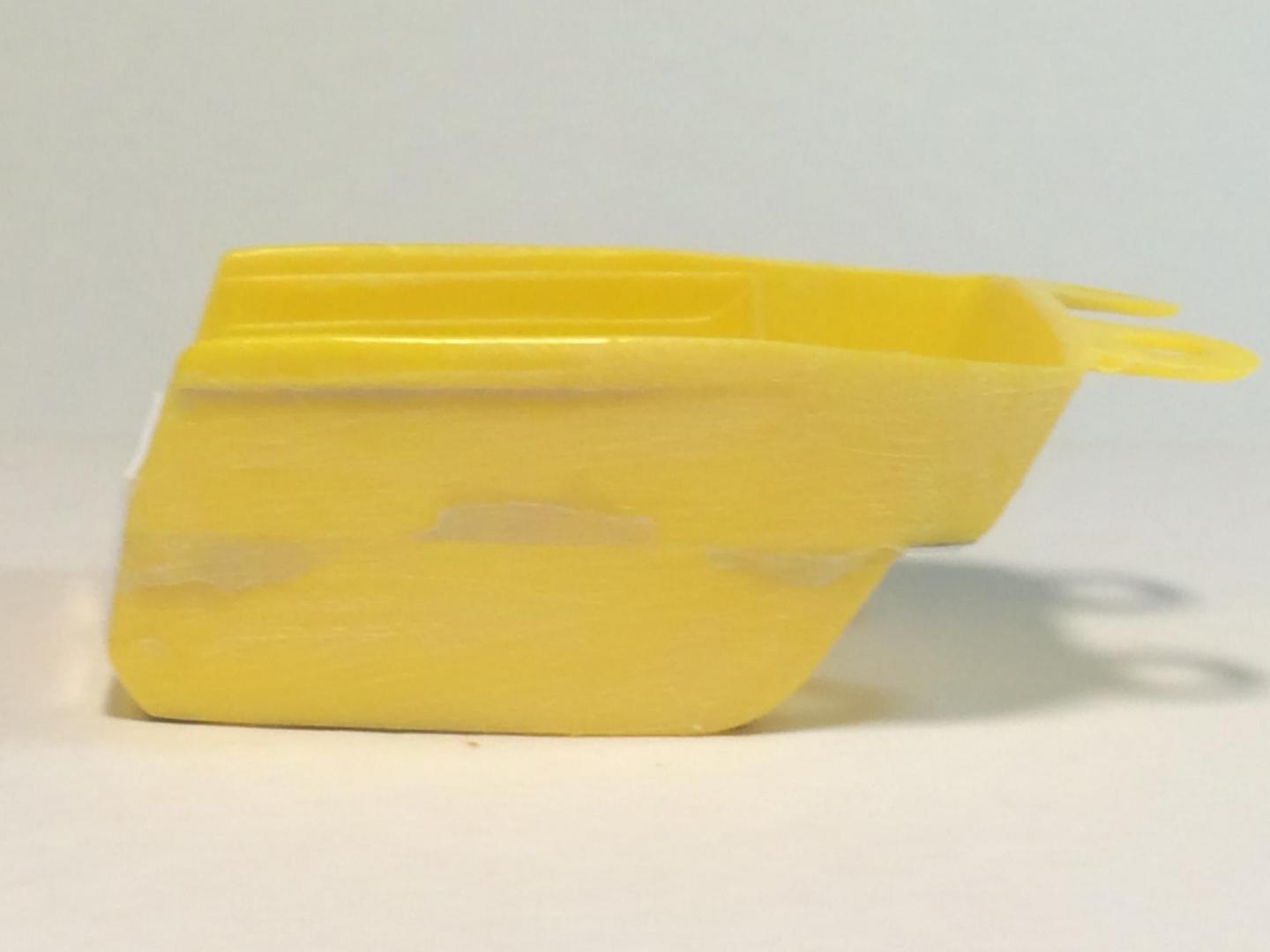

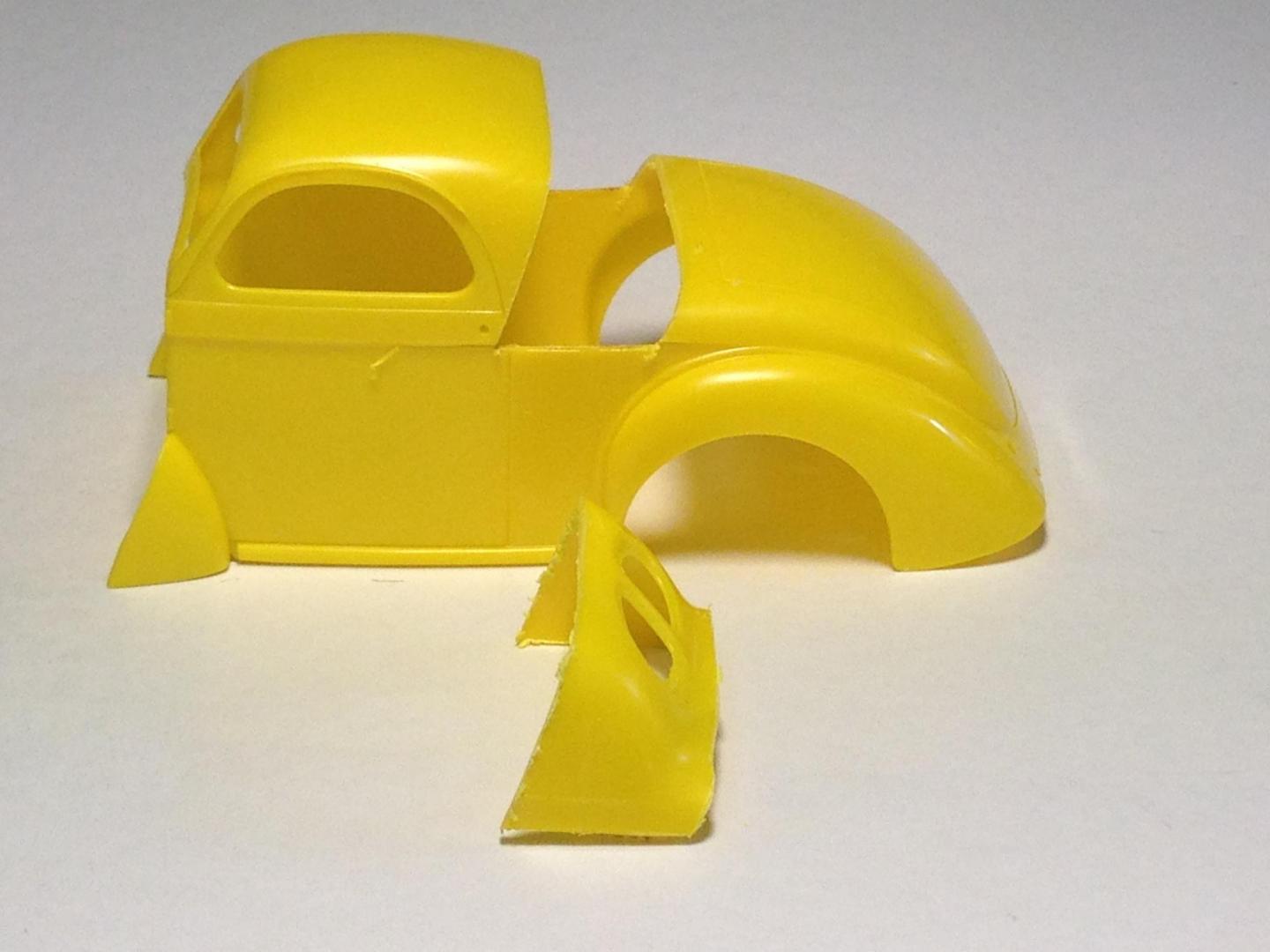

I chopped the top, Moving it forward a bit on the A pillars. I then added some material at the rear fascia below the trunk...the rear end of the Gasser looked bobbed.4_Chopped_Willys.thumb.jpg.b3a816275ce265_Chopped_Willys.thumb.jpg.160acad0d96b23_Chopped_Willys.thumb.jpg.bdf92f7189928
You can see the material at the bottom of the trunk...I like it. I'm not so sure about the chop though, as I cut through the windows...gonna' have to fix that.
I then roughed in a pair of skirts.

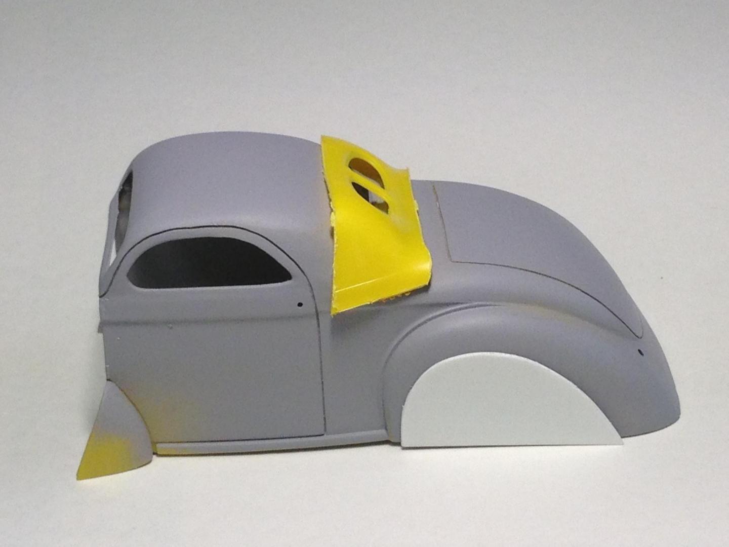

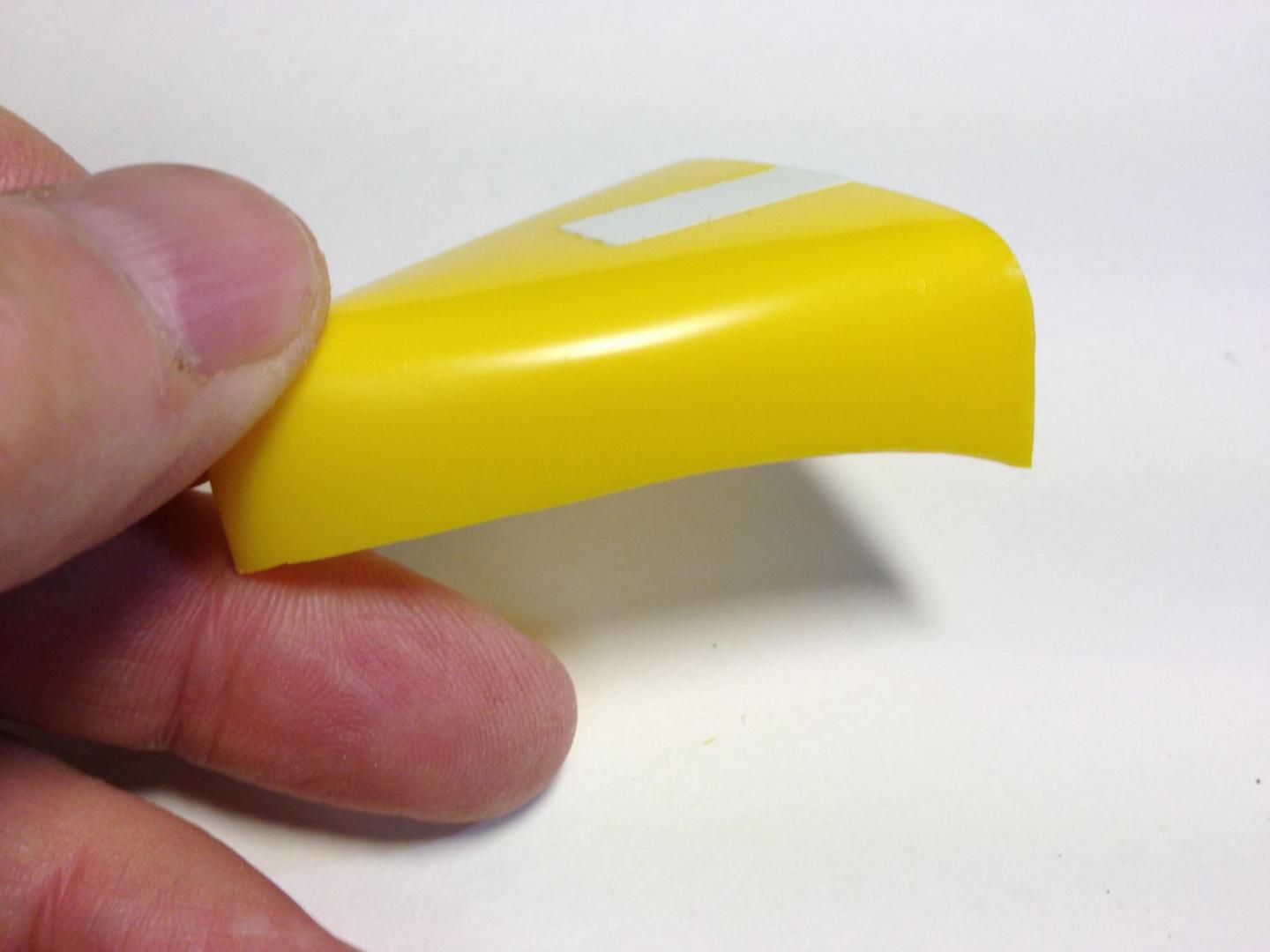

I'm changing the top.
Thank goodness I had an extra coupe body from a Club Member that had built the pick-up from the kit instead of the coupe.
I'm cutting the windows out as a wedge, and will cut them in to my recently chopped top, getting full windows and a nicer slope as well

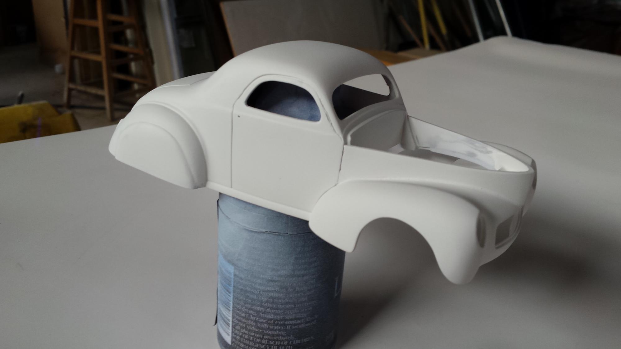

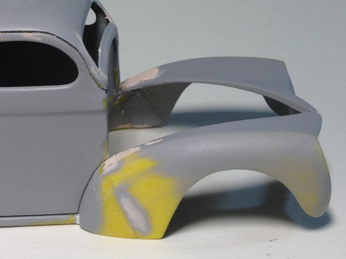

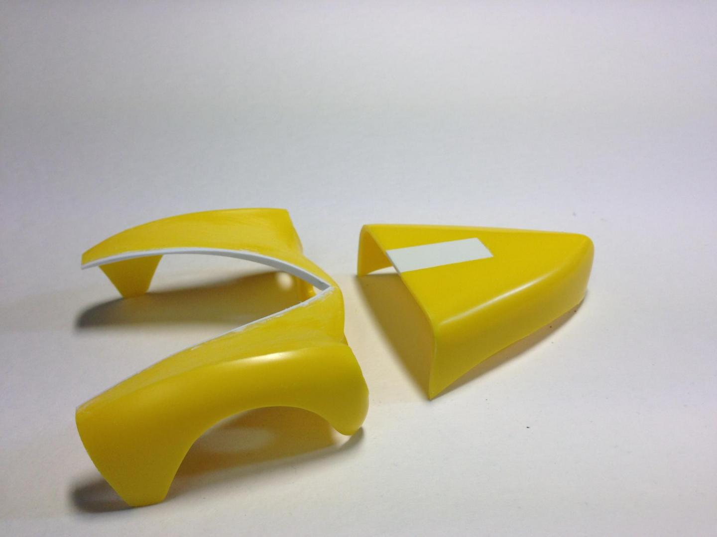

Now to start on the tilt-nose.

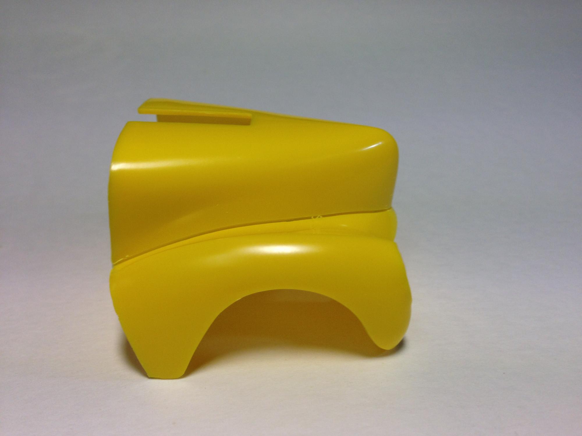

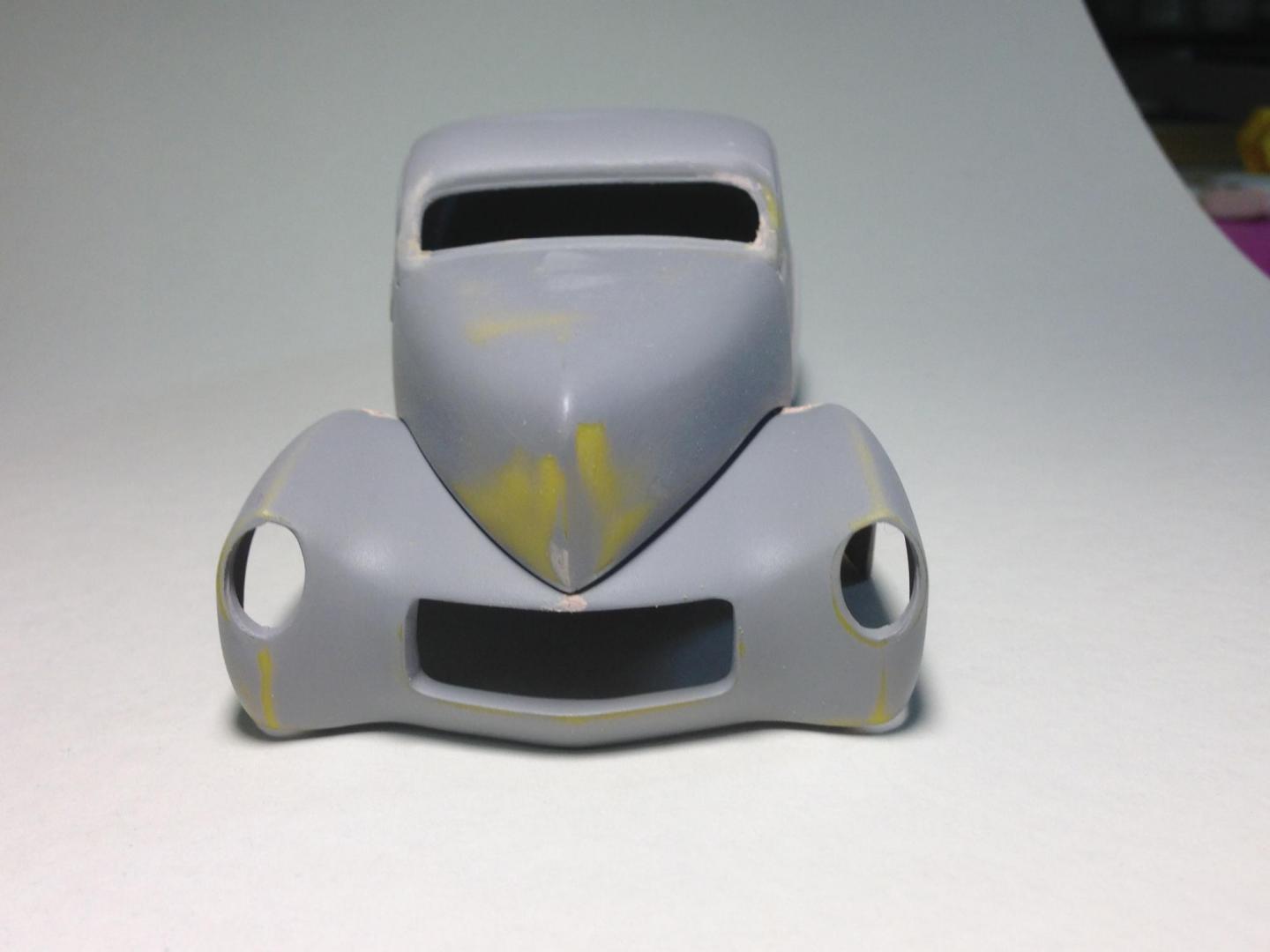

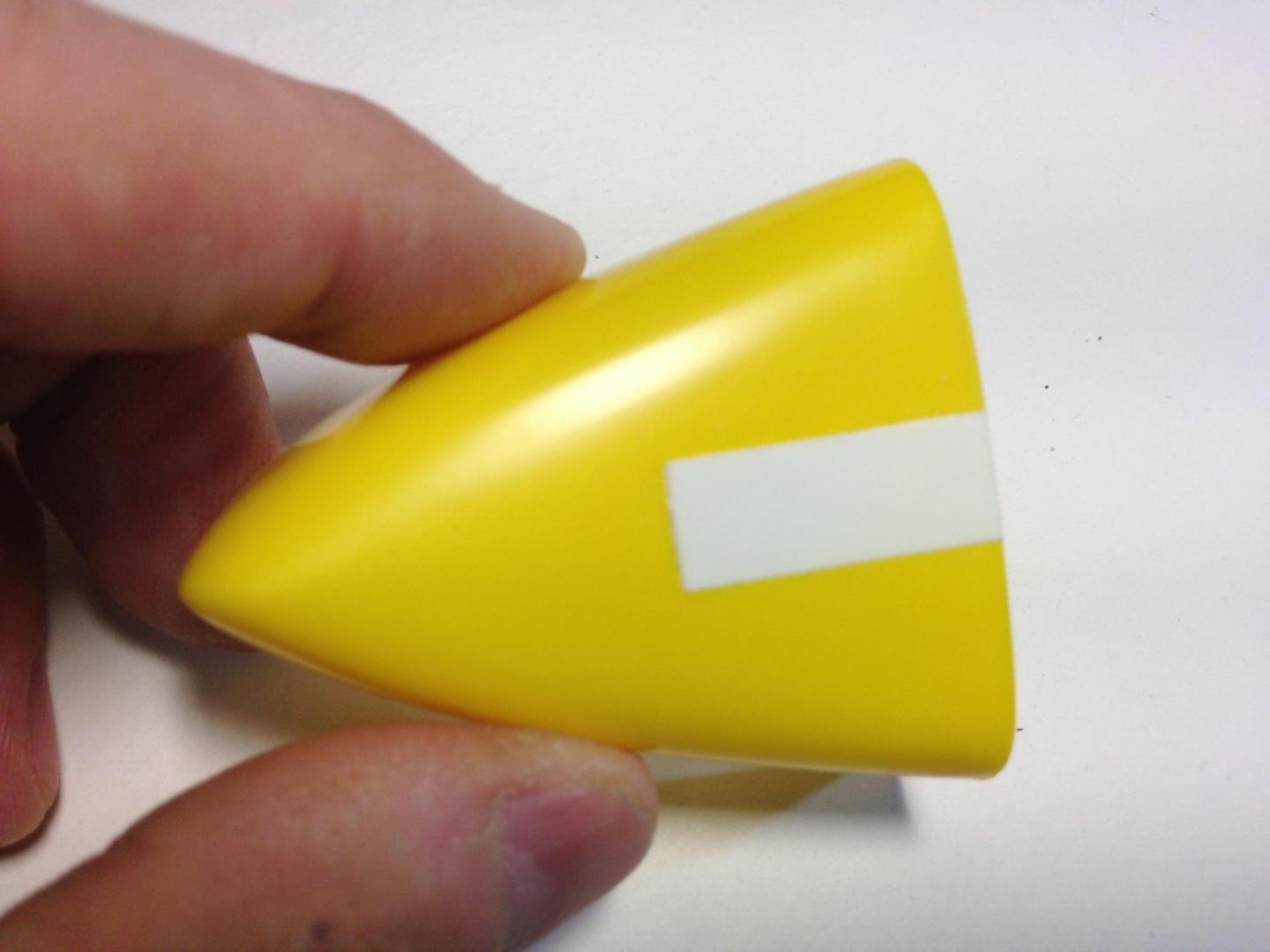

I used the bare metal scribe tool to part the hood from the fenders, and then filled the blower opening with plastic stock.
I then cut some plastic stock to trim out the fender edges

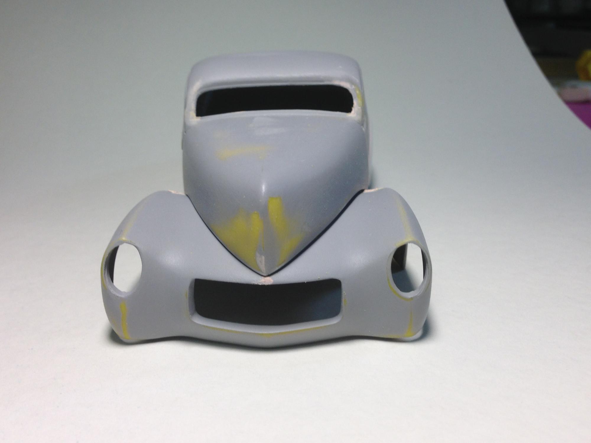

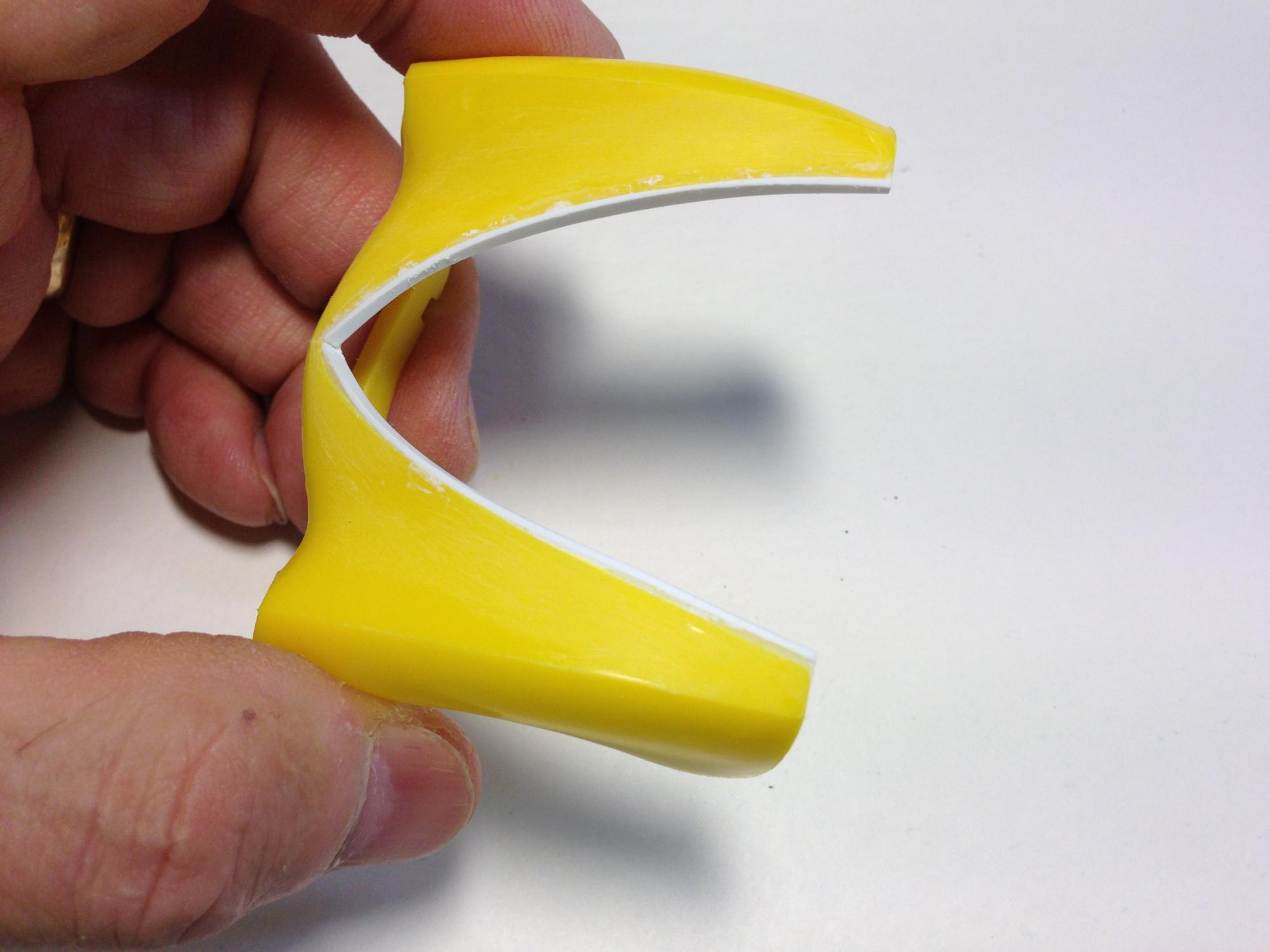

Front fenders are now ready to attach.
I glued some plastic stock inside the fender to strengthen the joint where the fender separated, making sure the fenders were straight and level. (Took a couple of tries.)
I like the way the chop and the skirts are coming together.
The hood looks like a big nose...hope it is just a bad angle, but a little fitting to do still.

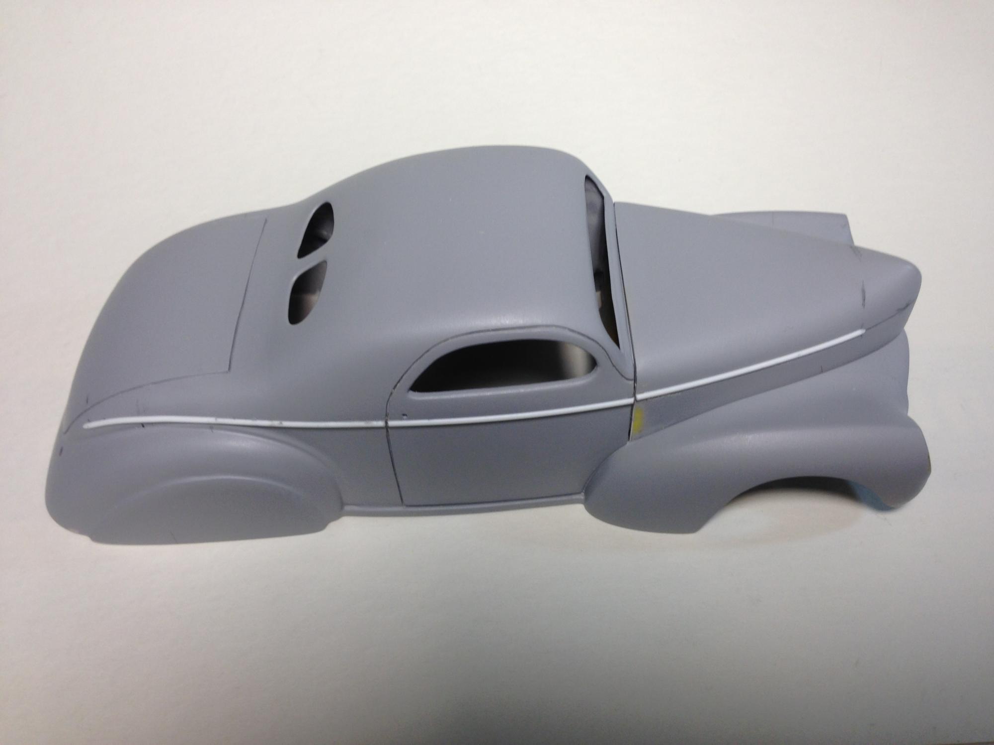

At some point I scribed new door lines where the drip edges were removed.
I also added some material (I can't recall exactly) to bring the window opening down slightly.

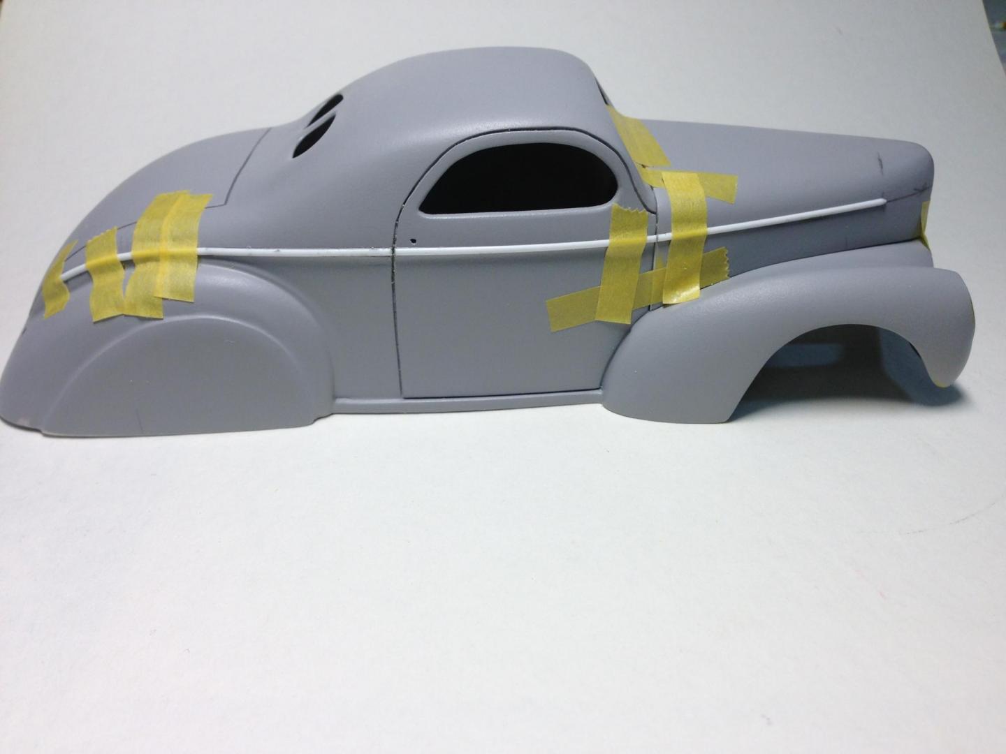

Here, I am adding side-trim, to be chrome foiled once primed and painted.

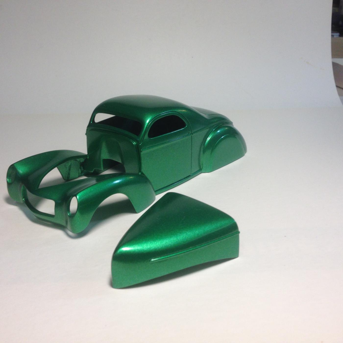

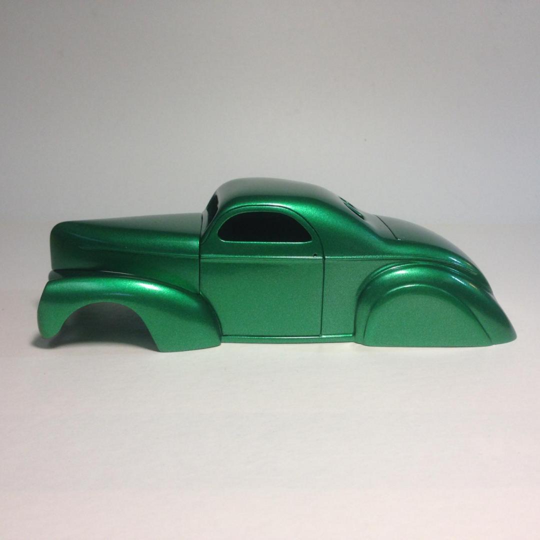

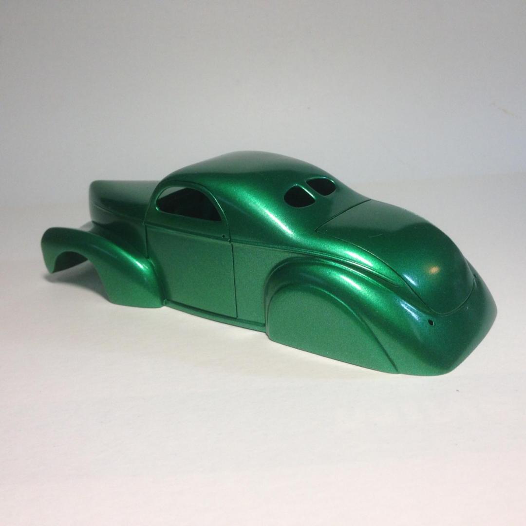

I love it when the colour goes on!
I decanted and air-brushed Tamiya TS20 metallic green.
I will clear coat it with their clear, decanted and air-brushed.
I am quite happy with the shape of the body, and can't wait to see this up on wheels..

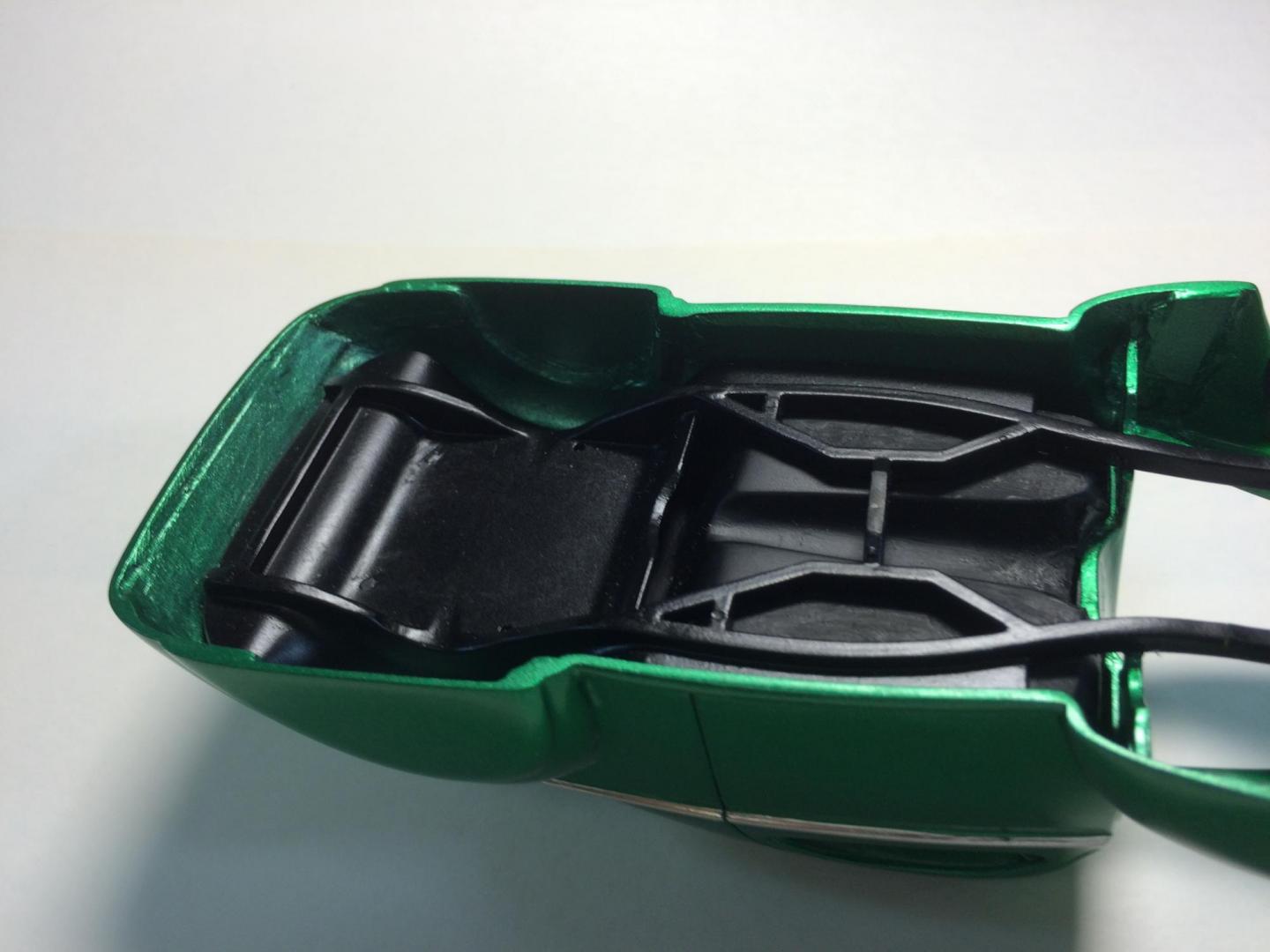

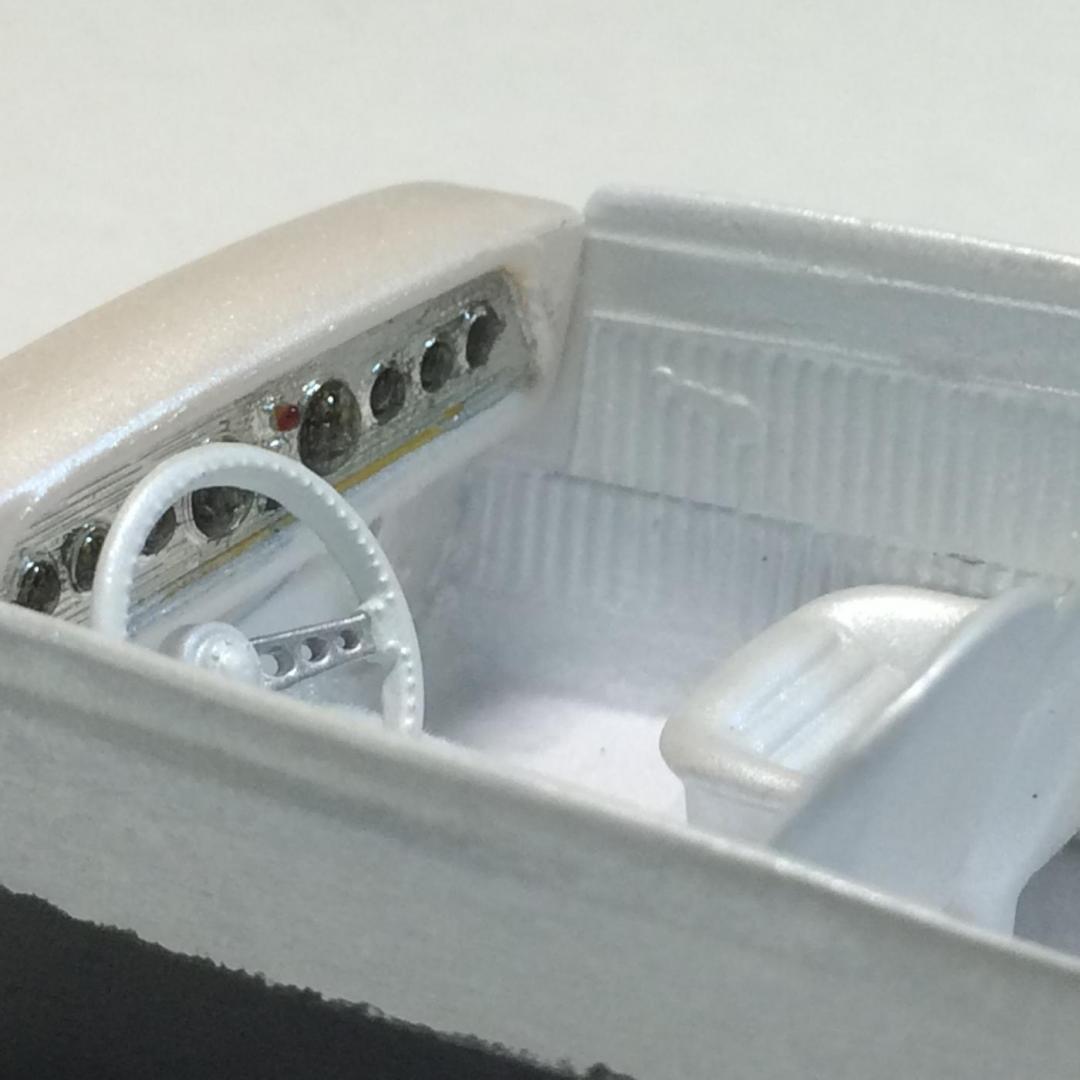

Next up was to section the interior so I could bring the chassis up into the body. The stock interior is beside the sectioned one, and the change gave me the room I needed for the chassis.
I used smaller bucket seats and it looks proportional, but Oops...The finished interior still shows the section line, which I was going to place a trim line over. (but obviously did not) Shoot.

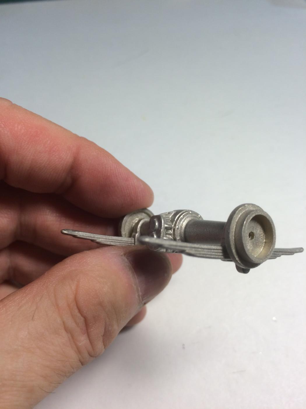

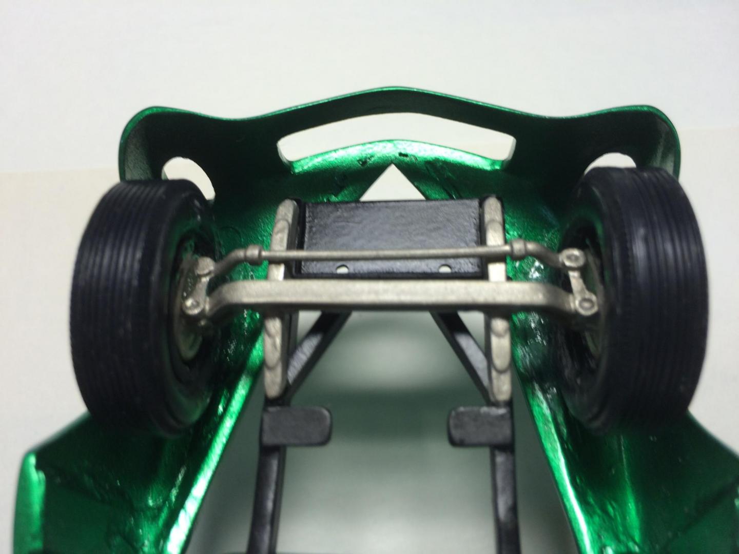

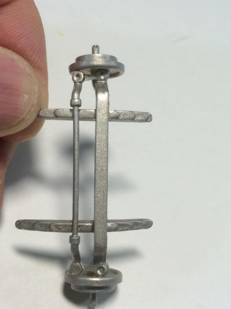

Next was getting the chassis lowered. The Gasser has curved springs sitting high on their perches. I shortened the springs and relaxed their curvature, getting them closer to the chassis.

I installed the interior and frame up into the body...In the one photo, you can see how far up into the body they are...I'd like to get this sitting low.

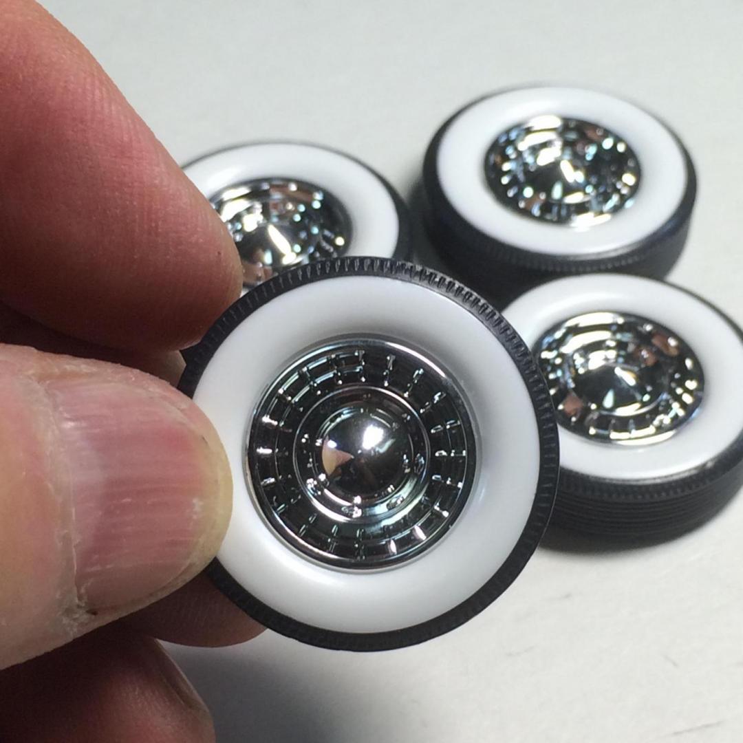

I'm really happy with the look of the wheels and rubber. The wheels are stock wheel covers from the AMT Cameo Pickup...cool eh?
The tires are equally cool, beautifully done from Modelhaus. They will push the car a little taller than I wanted, but I like the look.

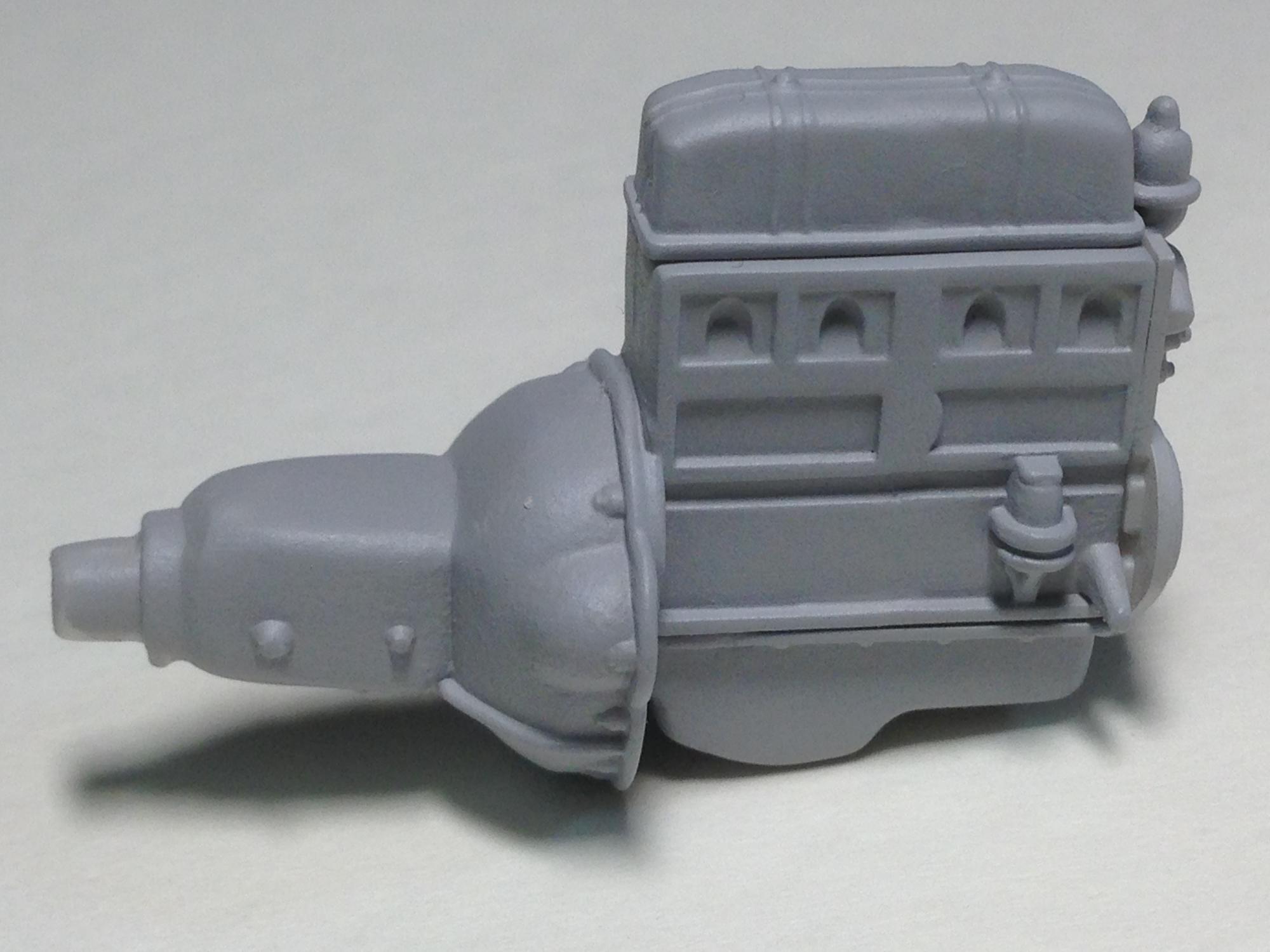

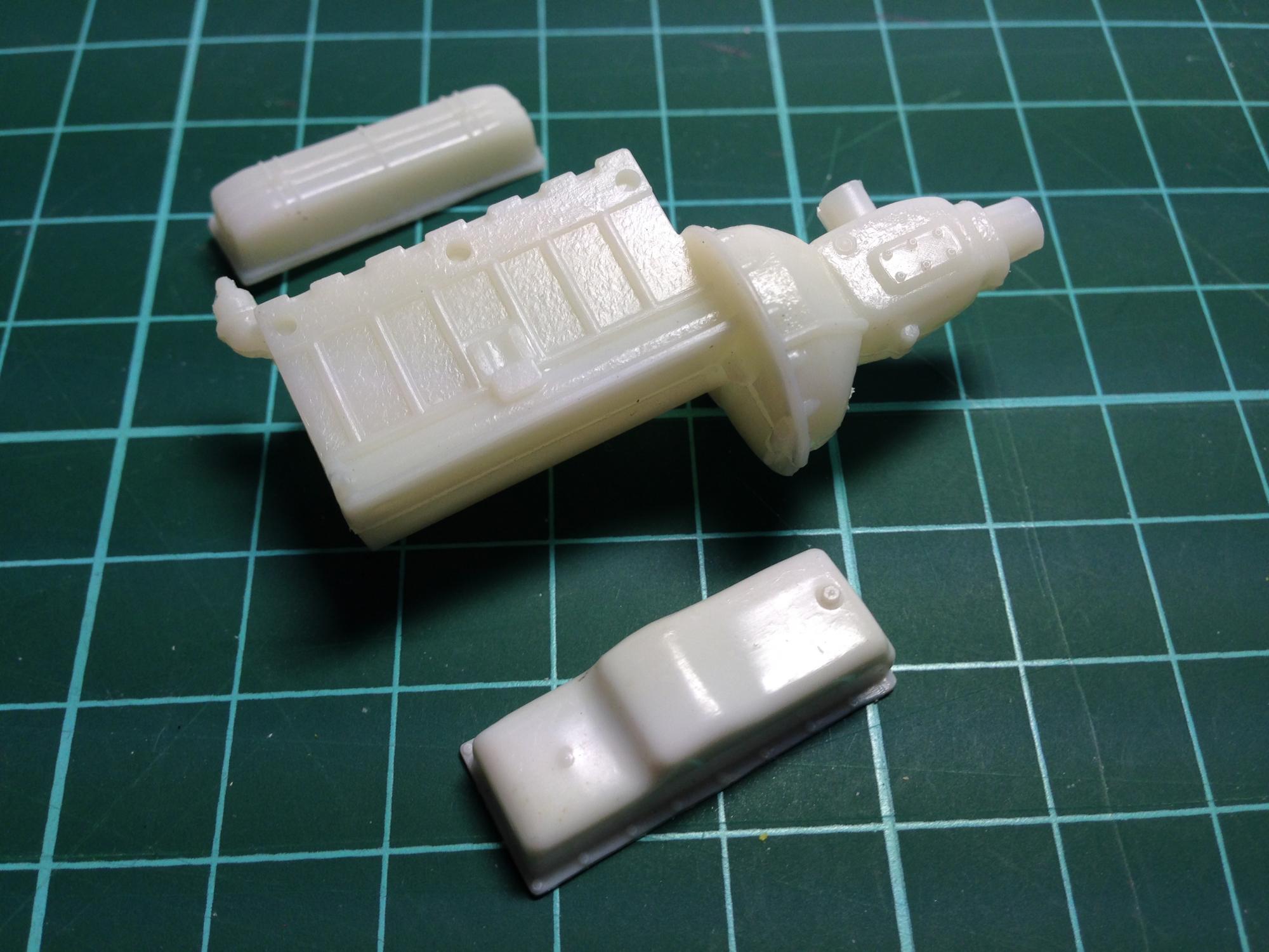

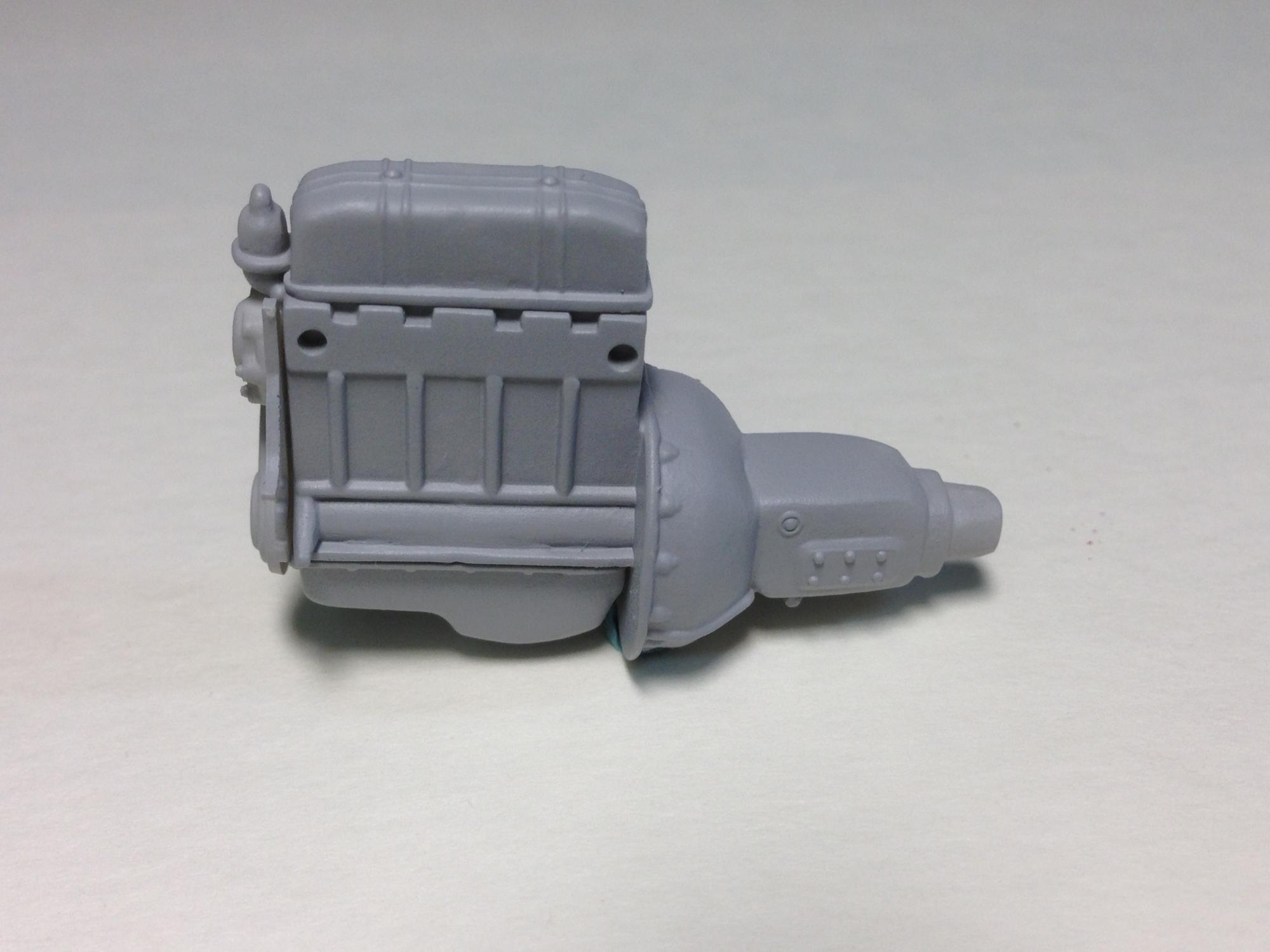

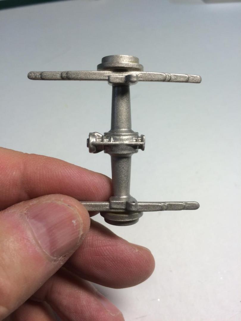

The '40 Willys had a straight-four in it, so I want to use a four as well, just not a flathead. I've modified the chevy stovebolt 6 from the AMT '37 Chev coupe into a straight four.
I just felt like it.

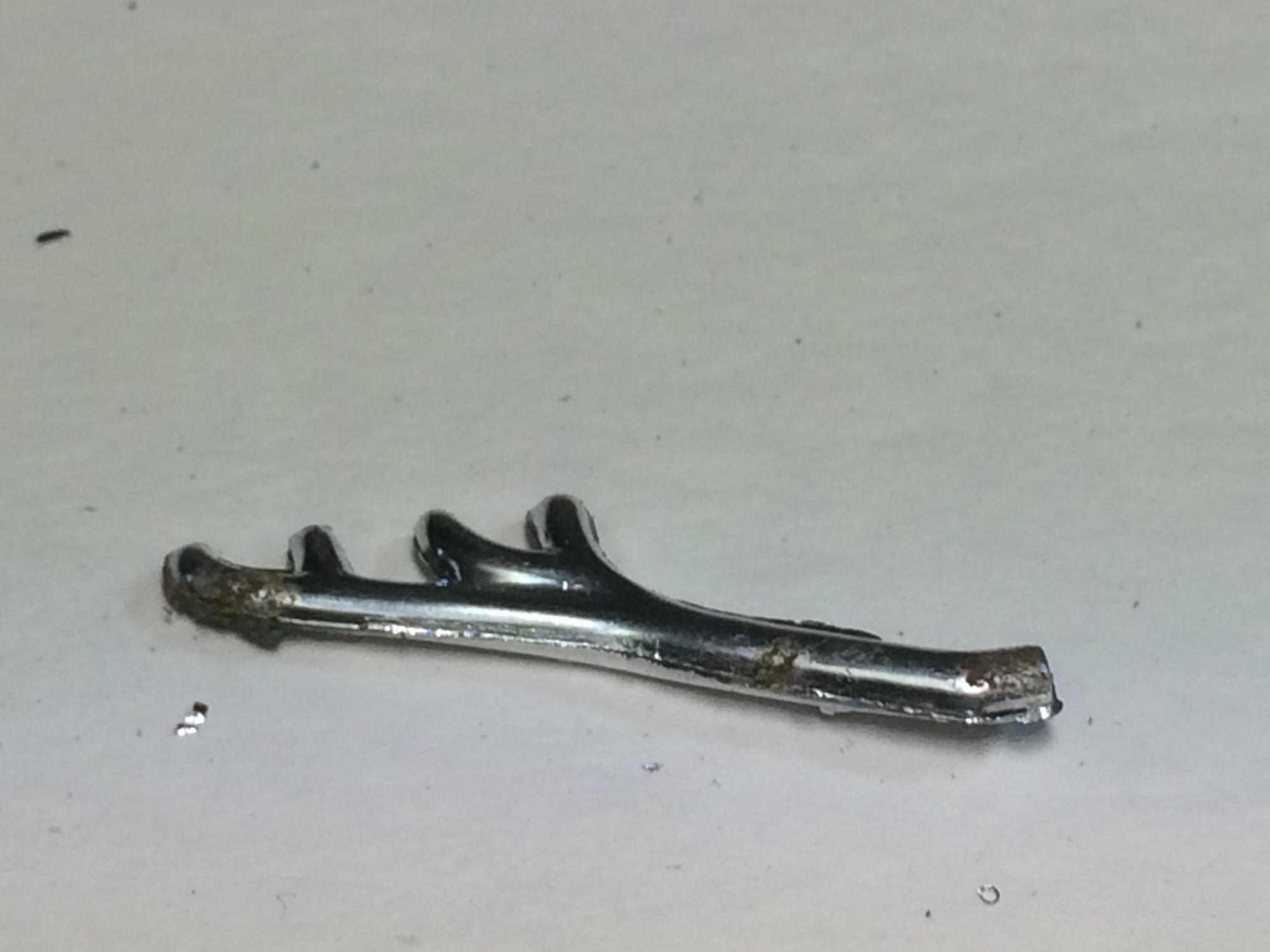

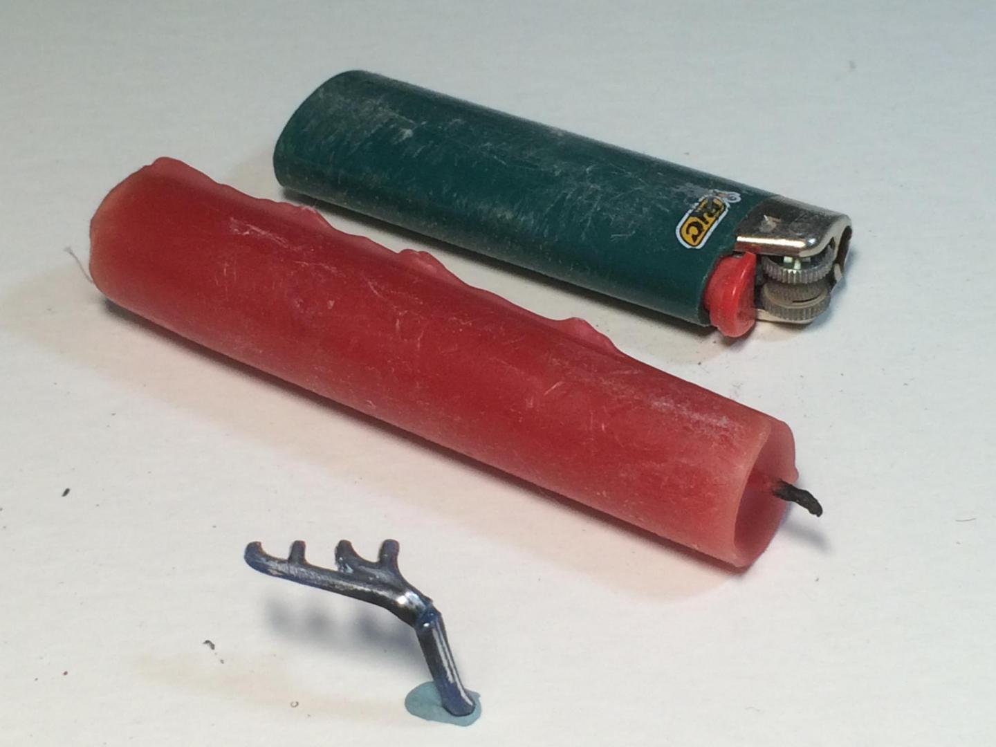

I want to add a few modest speed equipment items, so will start with a header.
This header came from my parts box, so I don't know what it is from.

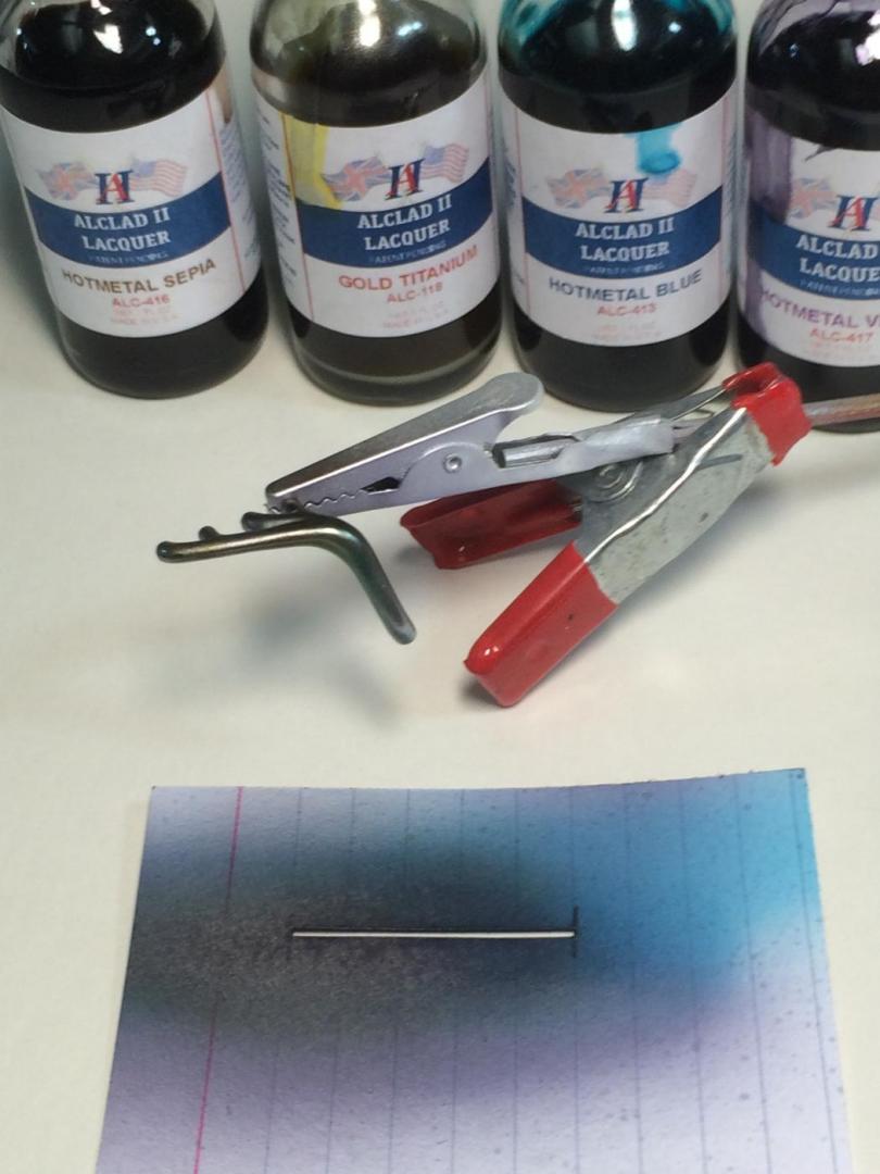

I bent it, puttied it, and chromed it before adding a little heat staining. Am still trying to figure out that less is more with the heat staining stuff, but am learning.
