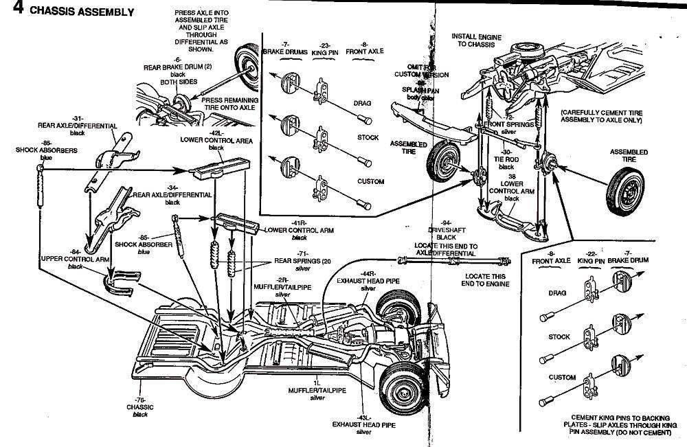

Fat Brian Posted December 15, 2015 Posted December 15, 2015 I had a 90s issue of this kit and I don't think it has a hole in the engine, I swear mine had a crankshaft that went in between the block halves and oil pan. Edit: here is a picture of the instructions showing no hole in the block.http://images34.fotki.com/v1606/photos/4/844424/13744977/AMT1958Impala002-vi.jpg
Junkman Posted December 15, 2015 Posted December 15, 2015 Yes, there is a crankshaft and even a rod and piston assy.You need to leave the crankshaft out if you want to drill a hole for the metal axle.

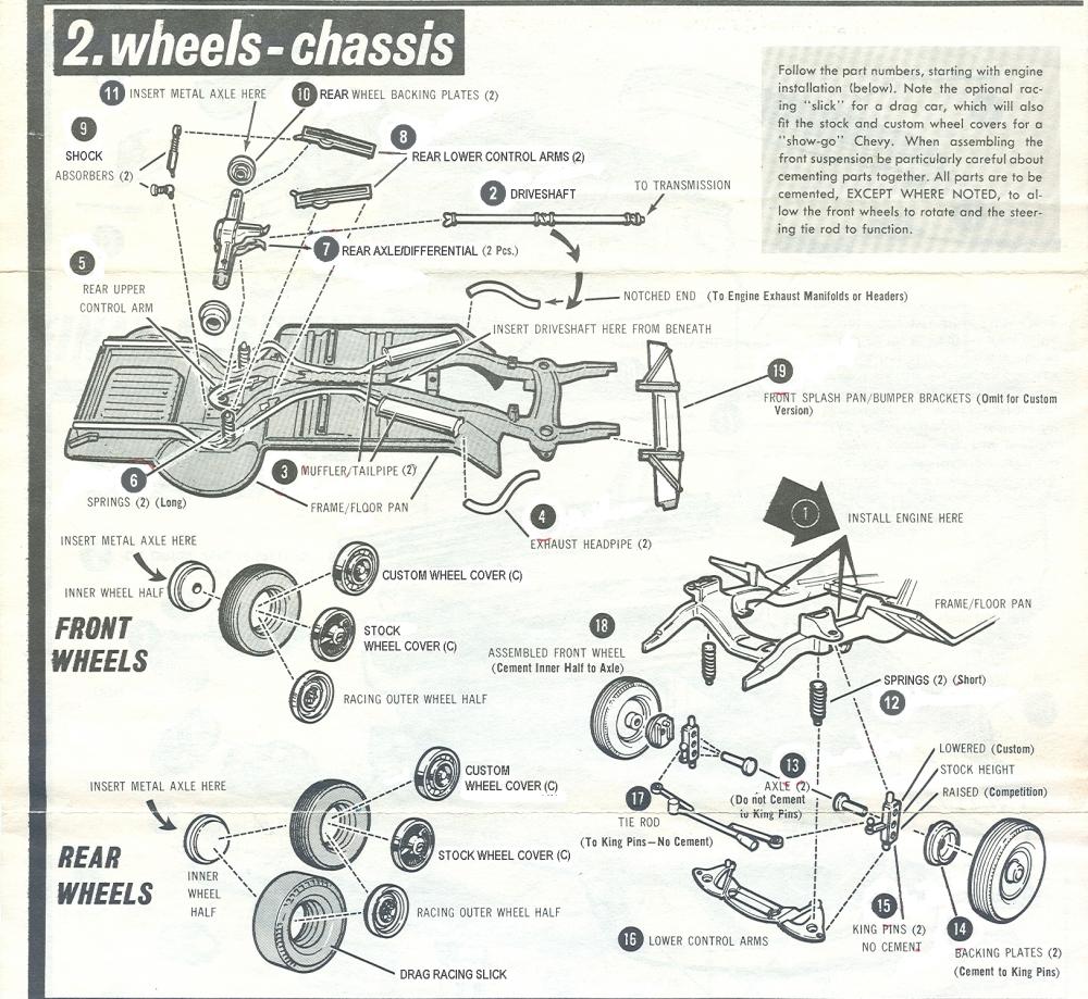

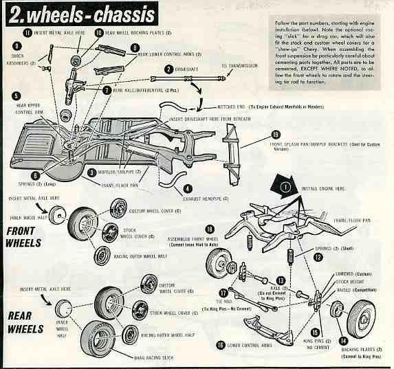

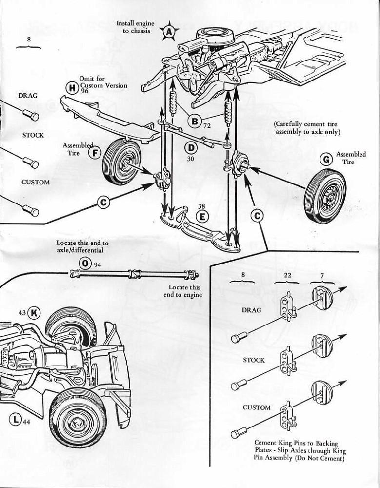

SfanGoch Posted December 16, 2015 Posted December 16, 2015 It would again be nice if someone could show photos. By the way, I have never seen this kit with the option of a wire front axle. I'd also like to see pictures of that. No release of this kit had the option of a wire front axle. You can check out four sets of instructions covering as many releases and they only show poseable steering
Bob Ellis Posted December 17, 2015 Posted December 17, 2015 I just checked on the Drastic Plastic site and my thoughts were confirmed; The original AMT 1957 Ford Fairlane had the option of using a plastic pin with steerable wheels, or running a steel axle through the holes from one side to the other .Not sure if the latest had that option. The AMT 1958 Impala (2nd issue) did not.
