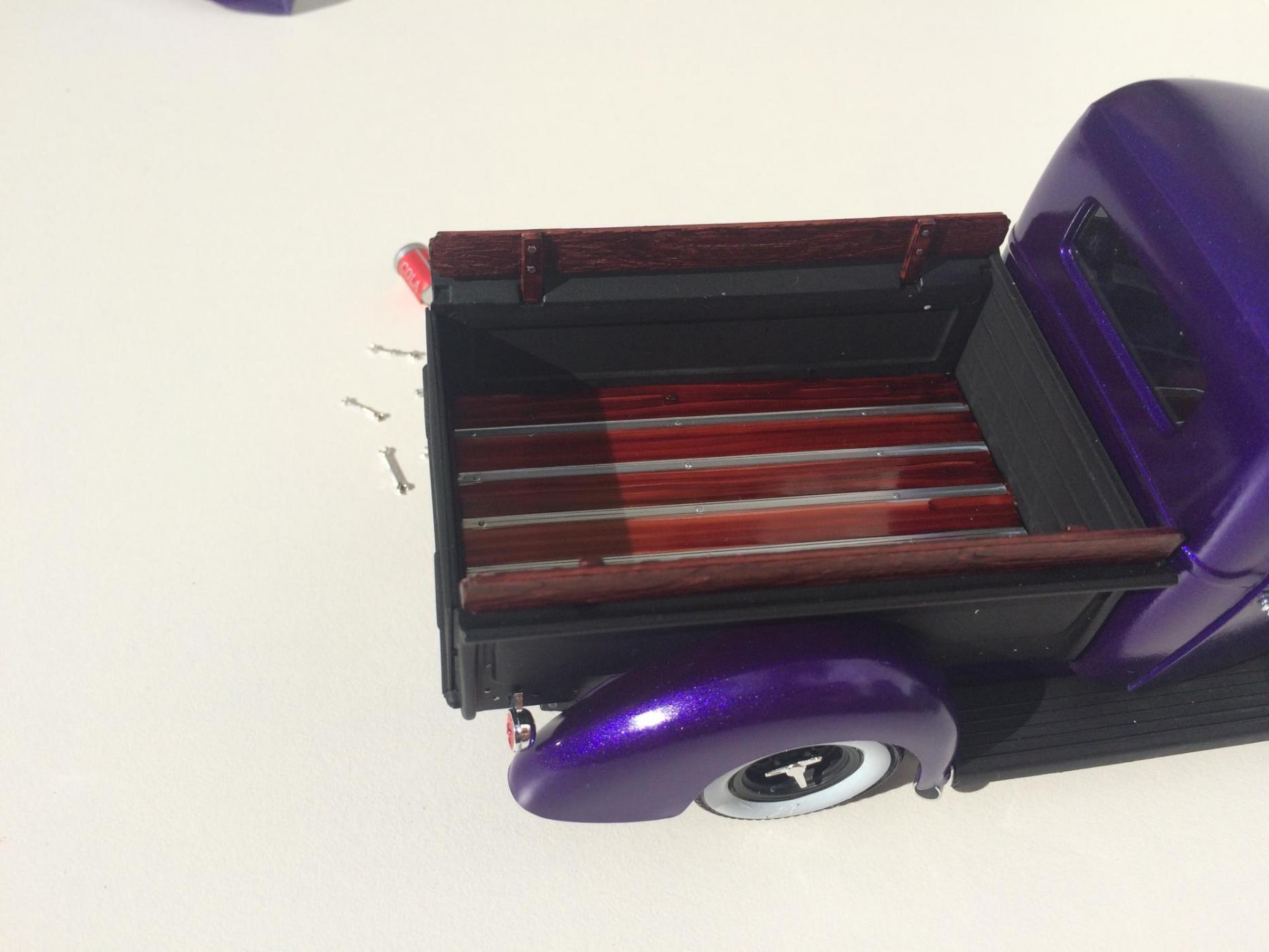

I use a brown sharpie with excellent results over the common white plastic. I can post a picture of a truck bed if you would like to see.
Post it, Steve! What brand?
I just use the brown Sharpie brand marker. Make a few passes and you'll see how you can control the color for darker and lighter shades. This will help you create a nice wood grain look, I did the bed as well as the bed rails with a sharpie.

Looks great! Thanks!

the side rails were engraved. The bed was not engraved if I remember correctly. The marker did all the work, give it a try!
Man, that looks GREAT !! Thanks. You made my day.:D
