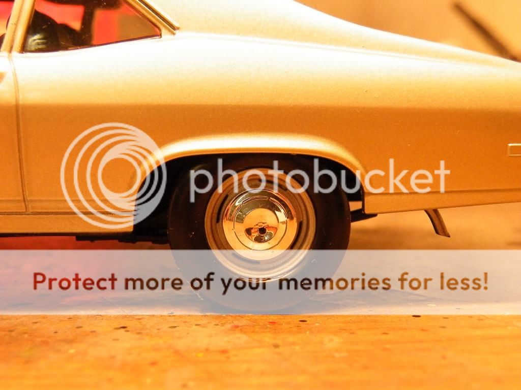

Casey Posted March 2, 2012 Share Posted March 2, 2012 (edited) Here's the Revell 1/25 '69 Nova SS exhaust in place on the Revell 1/25 '69 Camaro chassis: There are six mounting studs on the topside of the exhaust system which won't allow it to fully tuck up to the Camaro's chassis as it should, but the fit is near perfect. Definitely better than the Revell '68 Firebird's exhaust system, shown below: Another shot of the Nova exhaust/Camaro chassis combo, showing the transverse muffler positioned in front of the fuel tank: A few more detail pics from the '69 Nova kit, starting with the Centerline Convo Pro wheels, in a very narrow width: The rear wheels: Pretty decent 14" Rally wheels: The optional traction bars: Nice dual snorkel chrome air cleaner: Fiberglass-look cowl induction hood, viewed from the underside: Edited March 2, 2012 by Casey Quote Link to comment Share on other sites More sharing options...
Casey Posted March 2, 2012 Share Posted March 2, 2012 (edited) Yeah, the three mufflers thing seems odd to me, too. I recall a single transverse muffler for most applications, but don't recall all the possibilities. The rear anti-sway bar mounts are odd looking, crazy long, and are nothing like any 1:1 rear sway bar I've ever seen. Edited March 2, 2012 by Casey Quote Link to comment Share on other sites More sharing options...

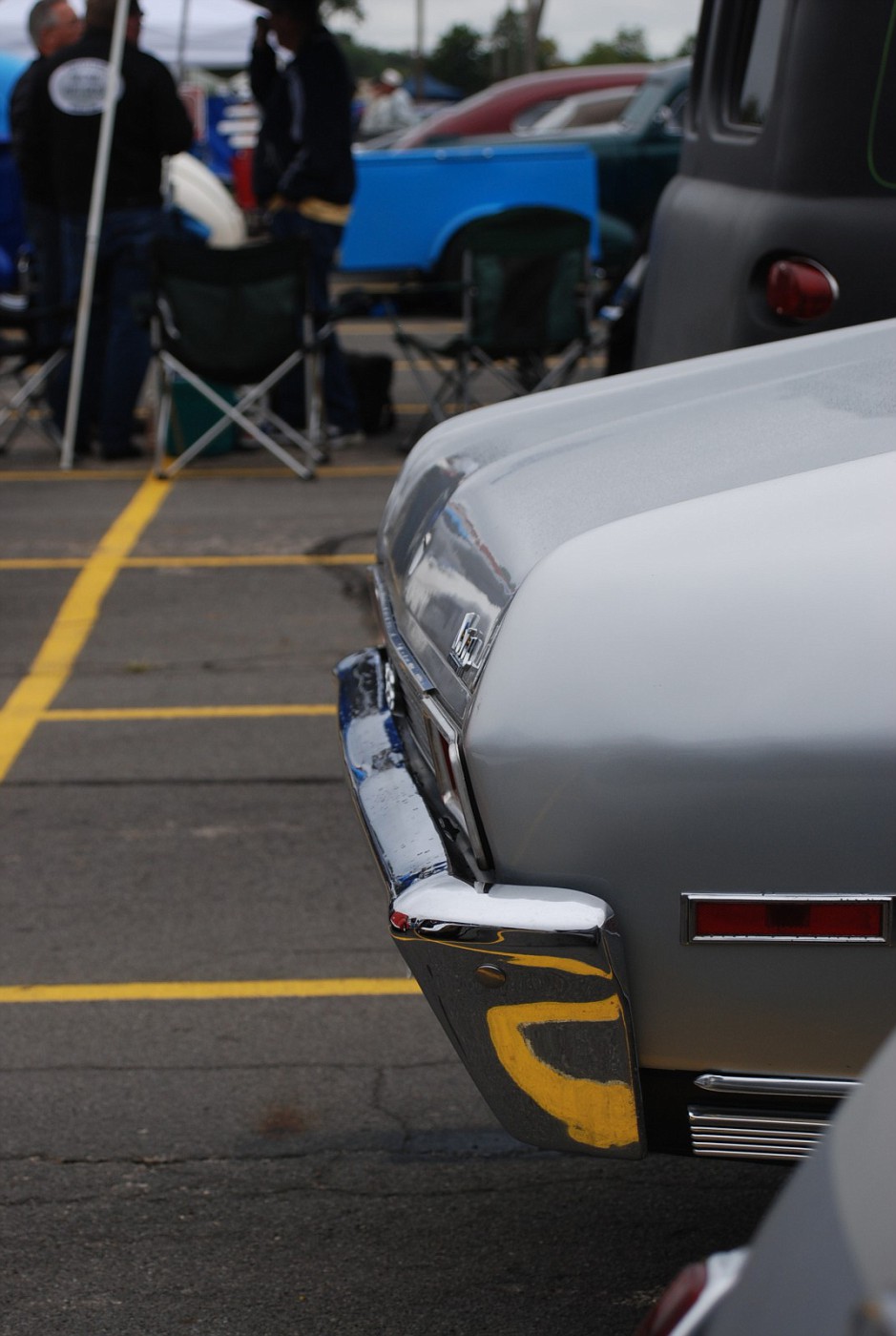

tim boyd Posted September 29, 2014 Share Posted September 29, 2014 (edited) For anyone working on an ultra-authentic Nova build using the otherwise excellent Revell kit, I photographed several of the real cars at the NSRA Street Rod Nats Plus in Kalamazoo a few weeks back. Four different shots of the rear taillamp area (which needs to lean inward as the surface goes downward - a fact that has always cooled my jets on building the Revell kit ever since it came out), and also of the front and rear wheel well openings which have been critiqued as well, with equal justification. Sorry I couldn't get any straight-on side / profile shots...cars spaced too closely together. Here's a link...http://public.fotki.com/funman1712/correcting-or-kitba/1968-72-chevy-iinova/ TIM Edited September 29, 2014 by tim boyd Quote Link to comment Share on other sites More sharing options...

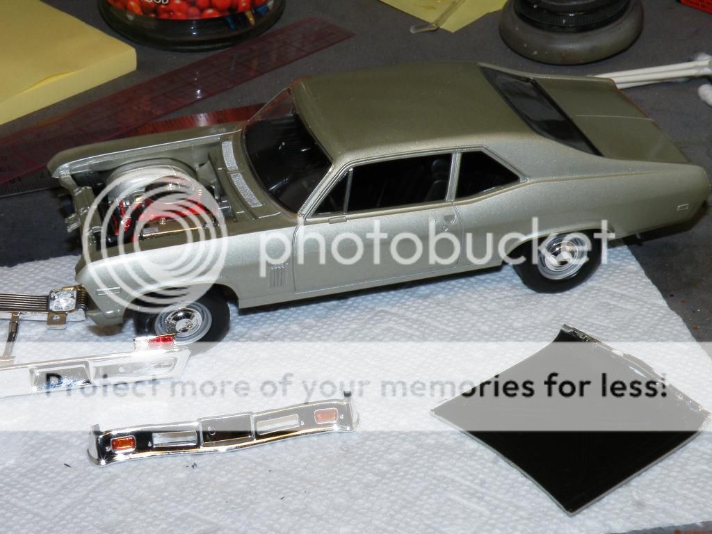

Snake45 Posted September 29, 2014 Share Posted September 29, 2014 I managed to mount an AMT '72 Nova rear panel and bumper on mine. It's not a direct drop-in and it takes a little work but it can be done and it looks 1000% better than the kit parts. If anyone's interested, I'll try to dig up the old in-progress photos and post them. Quote Link to comment Share on other sites More sharing options...
unclescott58 Posted September 29, 2014 Share Posted September 29, 2014 I managed to mount an AMT '72 Nova rear panel and bumper on mine. It's not a direct drop-in and it takes a little work but it can be done and it looks 1000% better than the kit parts. If anyone's interested, I'll try to dig up the old in-progress photos and post them. Can we see it? Scott Quote Link to comment Share on other sites More sharing options...
