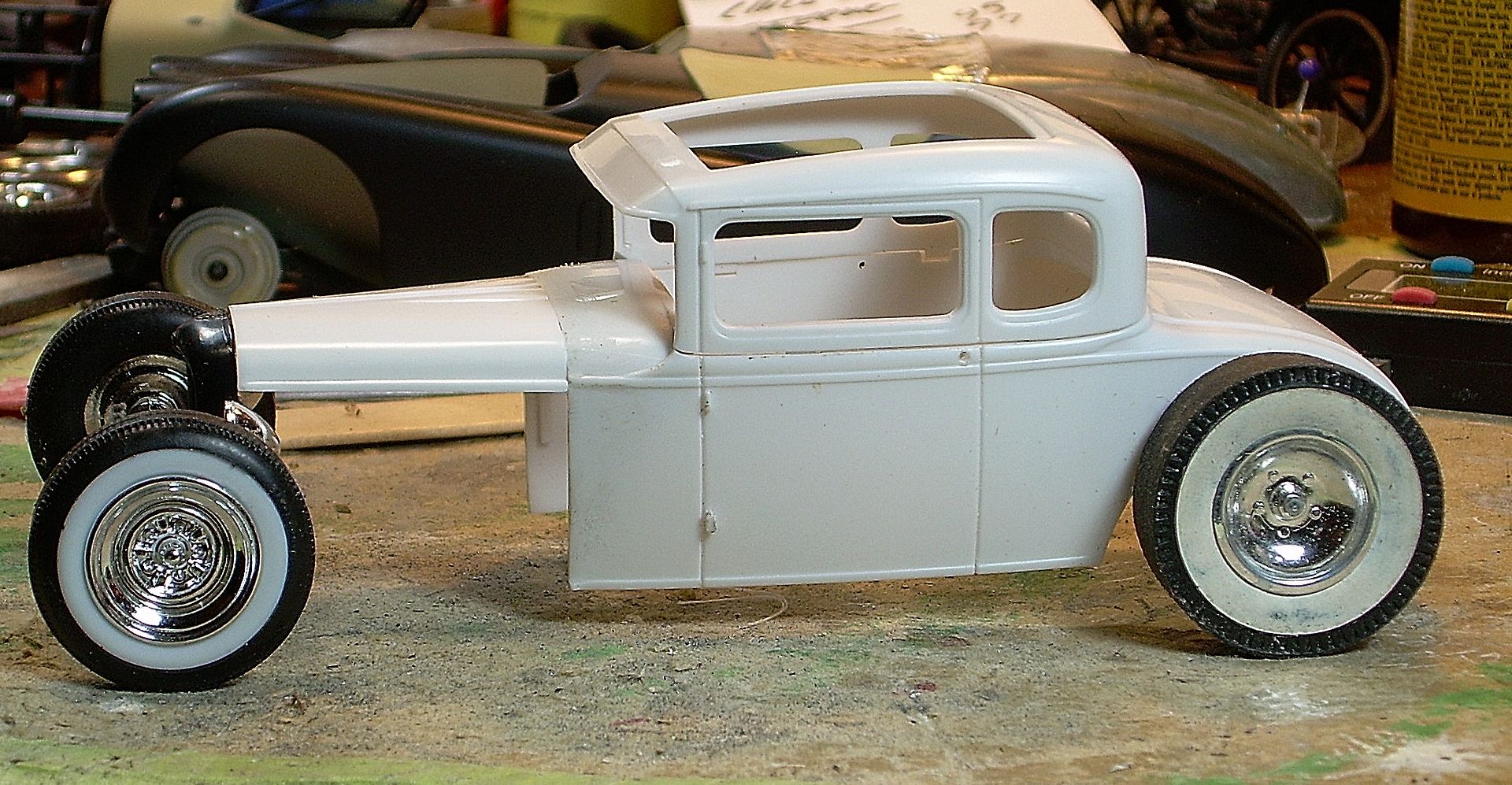

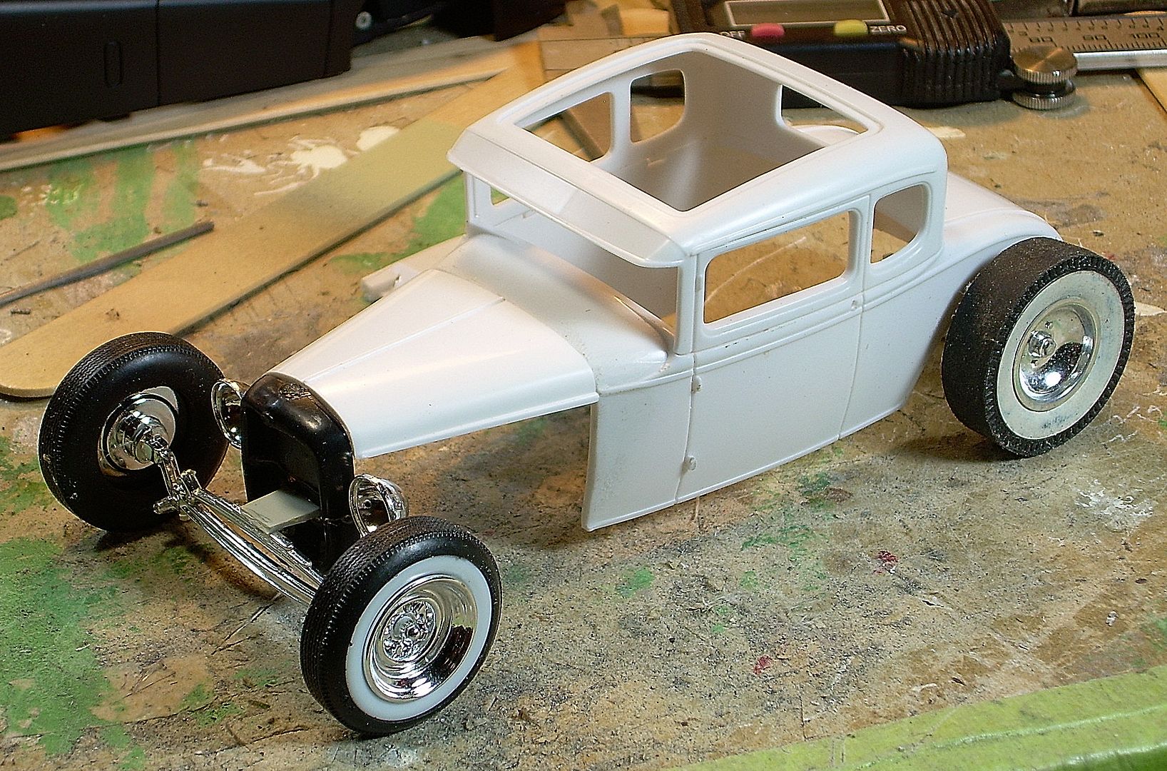

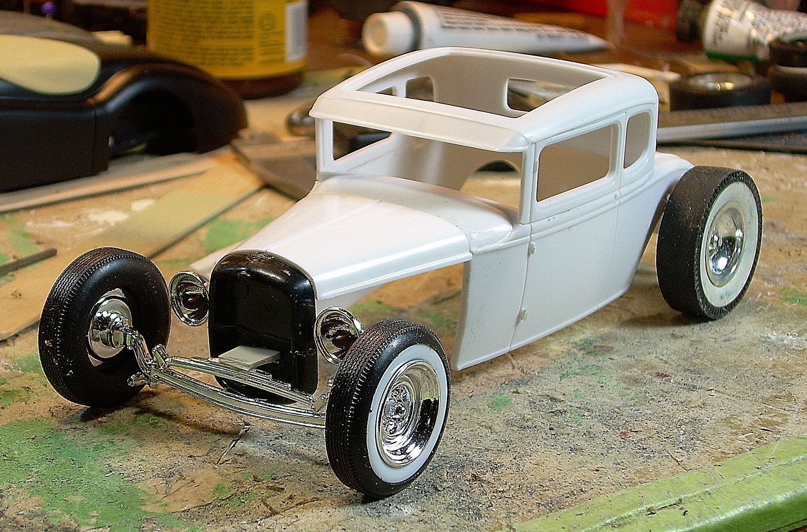

Ace-Garageguy Posted July 27, 2016 Posted July 27, 2016 (edited) Having this new kit on the shelf and having already done some work on the firewall to improve its appearance as well as coming to the realization that it's the right width for a stock '32 hood got me to thinking... This is the mod I ended up doing to the firewall, for anyone who hasn't been following the review thread. Since the cowl is the right width, more or less, to take a stock-width '32 hood (it's WAY too wide to take a '30 hood), I thought I'd see what I could come up with using a stock-length '32 hood and a chopped '32 grille shell, as well as a more radical channel job than you get with the kit. The results so far. The wheelbase is stretched beyond the kit, and a suicide perch would be fabricated out in front of the radiator. Both ends of the new '30 kit "channeled" frame will need to be zeed to get this stance, but it's easy to do the way Revell designed it. Even though the mockup here is a LOT lower than the Revell version, it would still have sufficient ground clearance to be actually drivable. Edited August 29, 2016 by Ace-Garageguy

Ace-Garageguy Posted July 28, 2016 Author Posted July 28, 2016 Thanks fer the innerest, fellers.So Bill, are you going for an old skool look or a modern look with the build? I'm thinking old-school car, probably a 4-71 blown flathead this time. Works with the narrow no-name piecrust recap slicks and early-style Palamides / American solid mags on the rear, though the front wheel / tire combo needs to be changed for narrower bias-ply tires and (?) wheels.

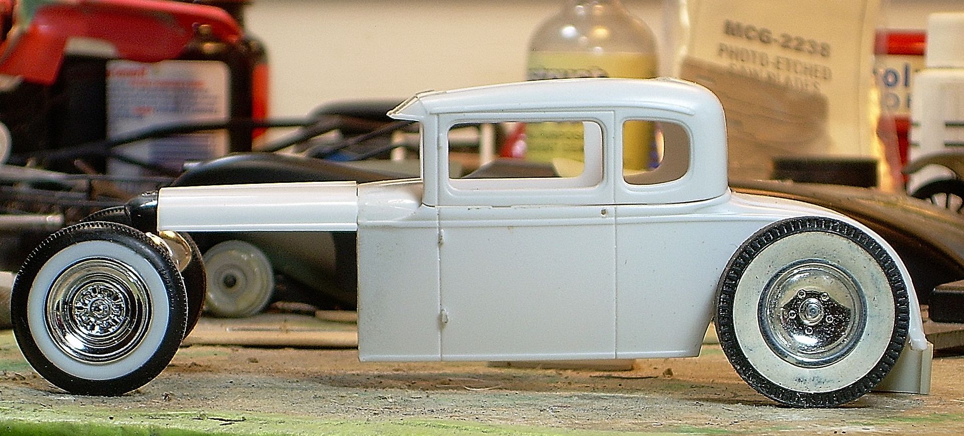

Ace-Garageguy Posted August 27, 2016 Author Posted August 27, 2016 (edited) the blower out of the original AMT '57 Chevy (last released in the Boyd Coddington series) has the perfect supercharger for you, it's a pretty good rendition of the old ScOTT blowers that were so popular with early Hot Rodders. Yeah, the blower in the old AMT'57 Chebby looks pretty good, I agree, but it's not really accurate for a S.C.o.T unit...not enough fins on the housing. I've been working on figuring out what the AMT kit unit looks the most like in 1:1. The S.C.o.T blower is shown below, on a flathead Ford manifold. The GMC 3-71 and 4-71 units were popular in the early post-war days and well into the '50s on flatheads. Barney Navarro is usually credited with being the first guy to run the venerable GMC unit, pirated from a surplus landing craft engine, on this dry-lakes racer in 1948. The problem I'm running into on all my old-school blower setups is doing the multi-V-belt drives that were common before the Gilmer belts took over. This is Navarro's 3-71 equipped engine. The V-belts were a problem for him too. I may just use a chain drive to get this one done without having to machine a bunch of tiny pulleys. Edited August 29, 2016 by Ace-Garageguy

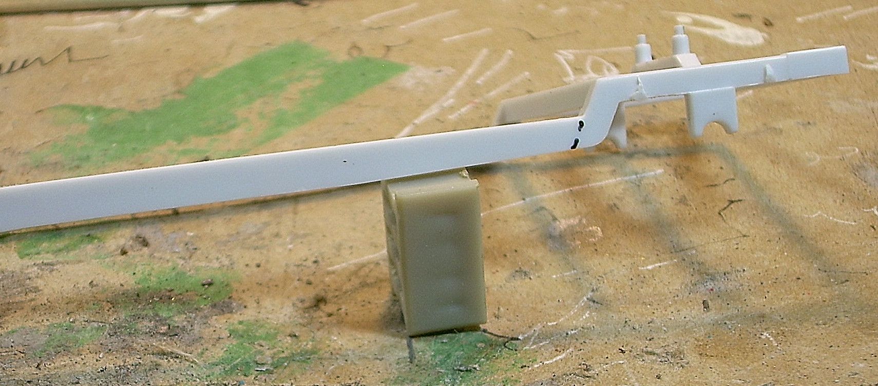

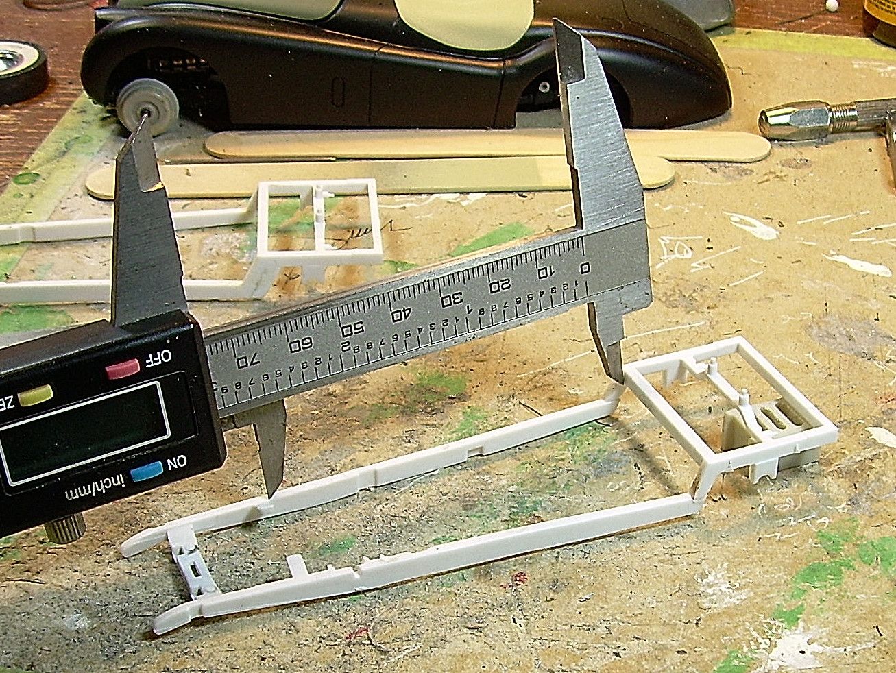

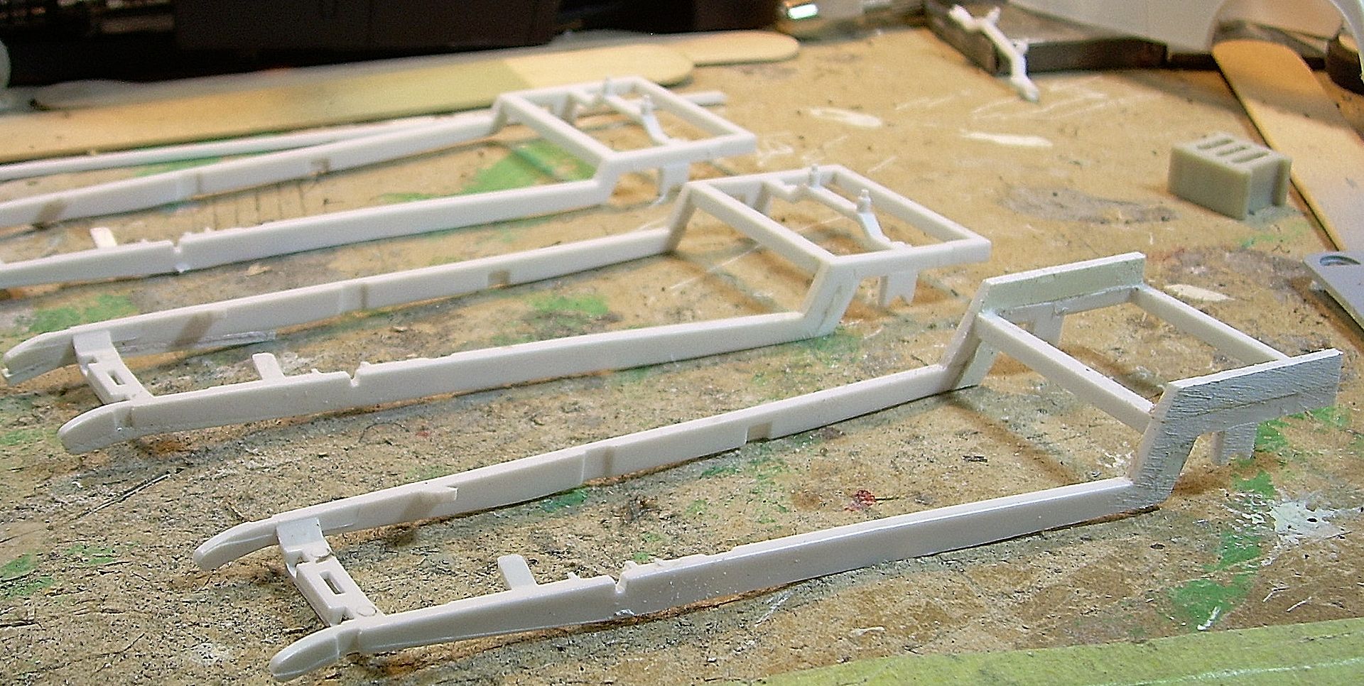

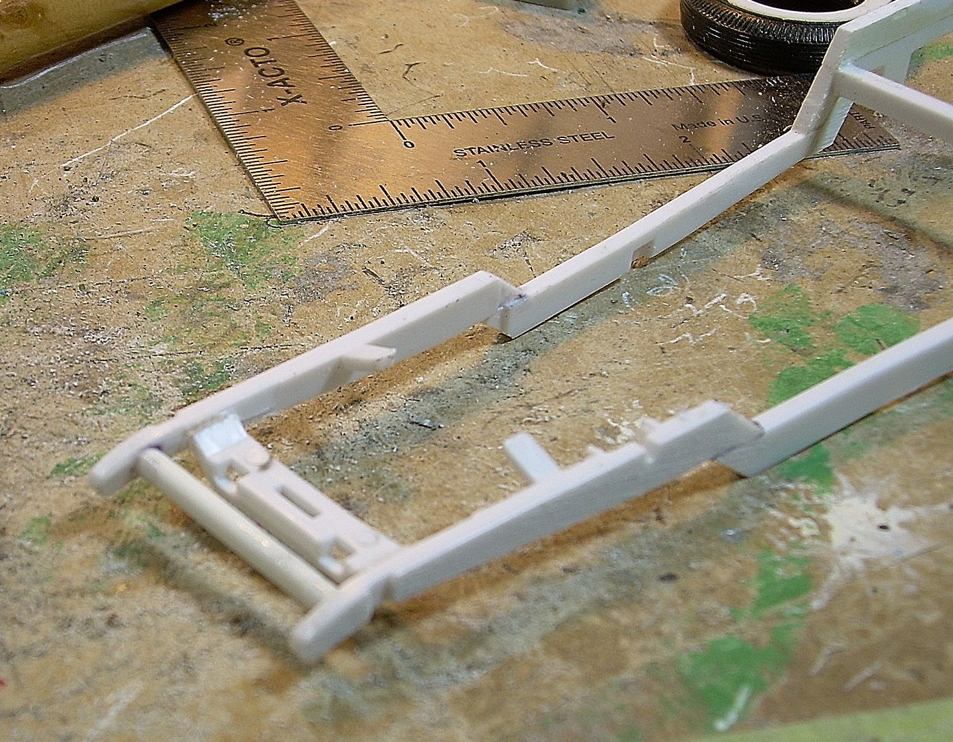

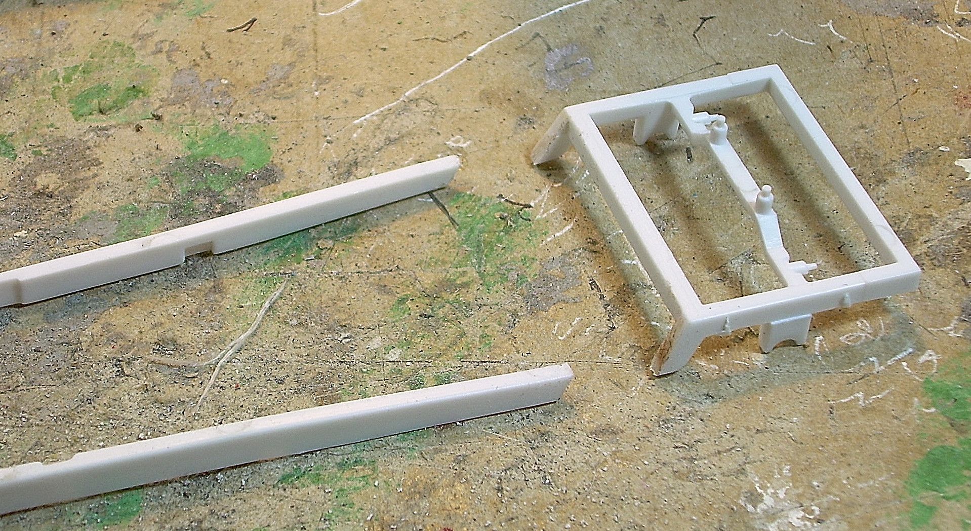

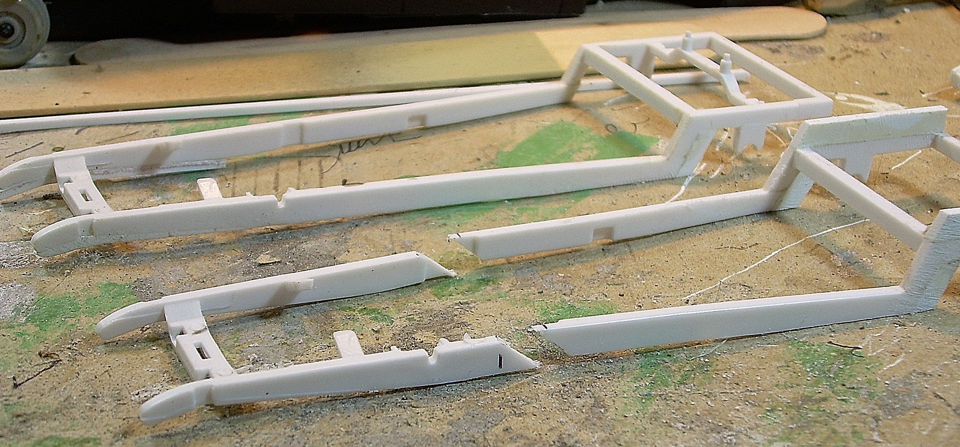

Ace-Garageguy Posted August 29, 2016 Author Posted August 29, 2016 (edited) Time to zee the frame. I ALWAYS get the look, stance, ride-height and proportions dialed in before doing anything else. We got all that in the last installment, so now it's time to get it all carved in stone. Since we have a mockup on the bench to measure from, it's not hard to figure out that the frame is going to need some major work. First job is to cut down just in front of the Revell-supplied zee. You simply stack the loose part on top of the ends of the rails. If we'd cut at a perfect 45 degree angle, we wouldn't have any shortening effect. Since we cut on a shallower angle to match the slope of the existing vertical members, we WILL end up shortening the frame just a tad. Doesn't matter though, because everything gets moved around to suit the look we're going for anyway. MEASURE to keep everything square. So...when we fit this enhanced zee up next to the body, it's apparent we'll have to go further. Cutting a lot of loose pieces and getting them all to stay aligned is a real PITA. It's much easier to do things as shown below. Follow along. The frame in the rear is stock. The center frame has the previously explained zee completed, and a strengthening piece stitched in behind the vertical member. The frame in the foreground has additional rails added to the tops of the existing rails in the rear, as well as the strengthening pieces, as above. The added height of the rear rails allows you to cut clearance for the rear axle from the underside of the old rails, and everything stays aligned...plus, the work goes quickly. Now for the front zee. We want the zee to be hidden inside the body on this car, behind the firewall, just because. Some people put the zee forward of the firewall. Some people split it AT the firewall. Personal preference...though putting it forward of the firewall is really better, as it gives a little more foot room, and an easy place to hang the ends of the radius rods for the front axle. I zeed this one this way because Spex had already done his somewhat similar build the smarter way. Anyway, after you decide where you want it, mark and cut at 45 degrees, and stack the cut piece on top of the original rails. REMEMBER: cutting at a 45 degree angle means we do NOT shorten the frame by doing this. We've also added a tubular front crossmember for the suicide axle perch between the ends of the front rails. We were able to figure out exactly where this needed to go by measuring off of the first mockup. Edited August 29, 2016 by Ace-Garageguy
