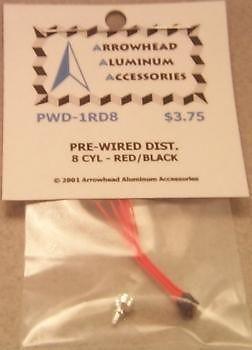

Yes, the pre-drilled/wired distributors are nice, but seeing a plug's porcelain and a boot on it is also very nice.
You can do the same thing with these.
If you look at the photos, you'll see that a length of heavier gauge wire is included for each distributor to be used for boot material.
You could easily slip a piece of white plastic rod into the boot to simulate the plug.
