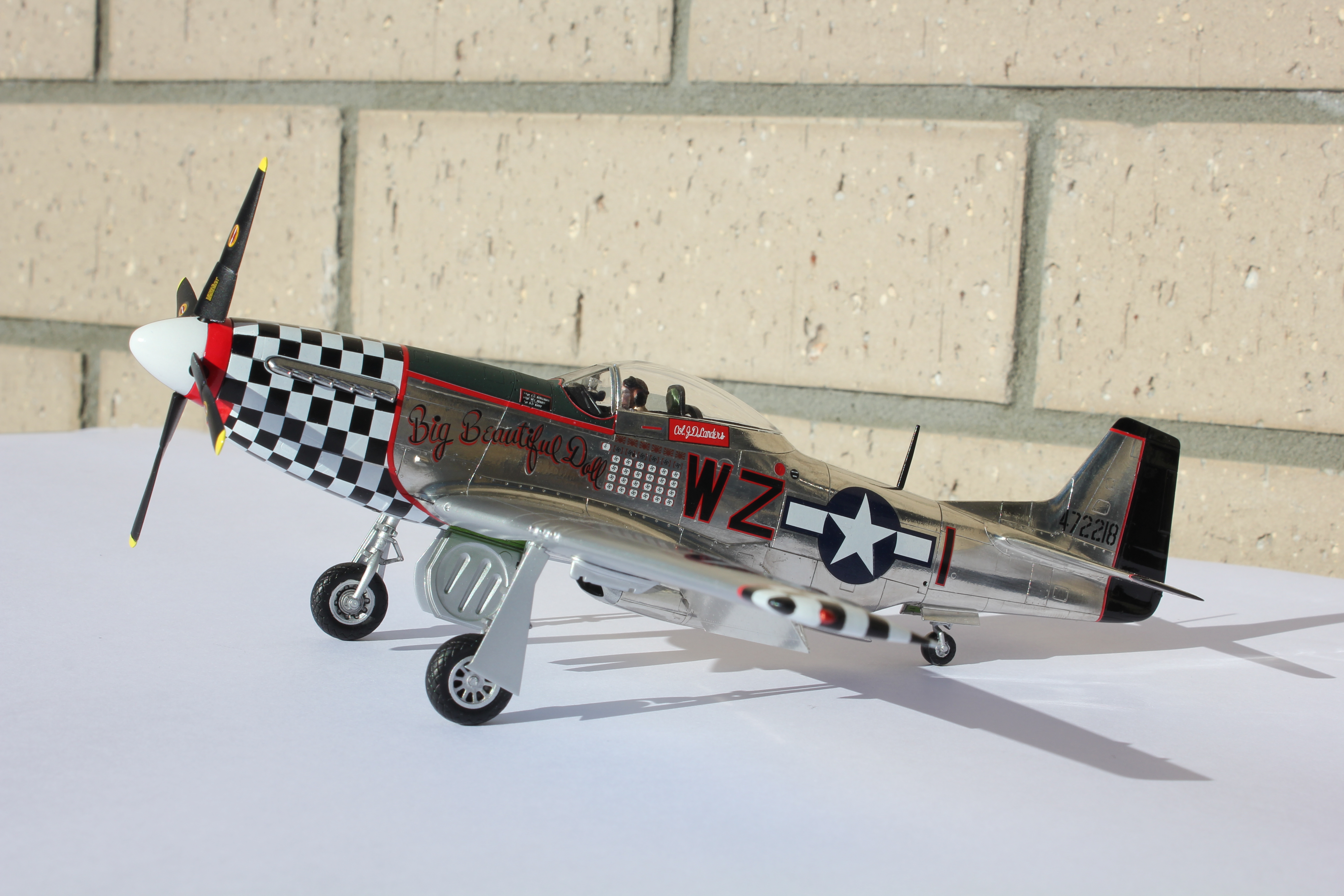

Michael jones Posted August 6, 2021 Posted August 6, 2021 New improved chrome turned out pretty good here...
TransAmMike Posted August 6, 2021 Posted August 6, 2021 looks good Michael and cool looking P-51 too.?
