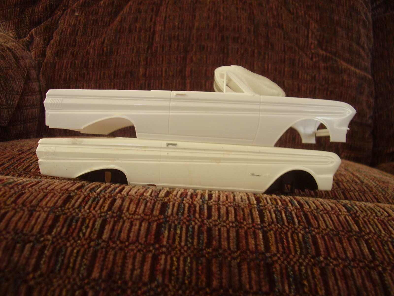

mk11 Posted April 23, 2017 Posted April 23, 2017 That's looking pretty slick, JC. Great capture of the 'look'. Fwiw, here's a pic of the trumpeter and amt falcons together to help with massaging the trmptr body. A lot of improvement can be made by simply rounding the lower edges of the body to get rid of the slabsided look. Should have a 3/4 view here too somewhere...
Maindrian Pace Posted April 23, 2017 Posted April 23, 2017 Very nice, the Mustang chassis is a great fit. I'll keep this in mind for my eventual Trumpeter Ranchero build. Ironically, I did this same chassis swap from a Shelby GT350R into a '64 Falcon - in 1:18 scale. A few filler panels here and there, a slight wheelbase adjustment...
afx Posted April 24, 2017 Author Posted April 24, 2017 (edited) That's looking pretty slick, JC. Great capture of the 'look'. Fwiw, here's a pic of the trumpeter and amt falcons together to help with massaging the trmptr body. A lot of improvement can be made by simply rounding the lower edges of the body to get rid of the slabsided look. Should have a 3/4 view here too somewhere... Thanks Mike. I have a few of the AMT Falcon but for this build I wanted to work with the Trumpeter. And yea I rounded off the lower edge of the body. In addition I took a wedge out of the rear valance. This allowed me to get even more lower body roll. I may to do some reshaping of the wheels well as well. Do you own a 1:1 Falcon? What are your thoughts on the Trumpeter compared to the AMT? Edited April 24, 2017 by afx

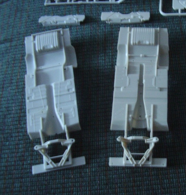

mk11 Posted April 25, 2017 Posted April 25, 2017 (edited) Turns out the 66 amt fairlane/comet chassis could be made to fit as well and has bigger rear wheelhouses. It was adapted for the recent '65 comet release with some fresh engraving to bring it closer to the actual comet/falcon floor stamping. mike Edited April 25, 2017 by mk11
afx Posted April 25, 2017 Author Posted April 25, 2017 Thanks Shay.Mike, I'll check out the '66 Fairlane chassis. Not for this build but I have the convertible kit as well.
