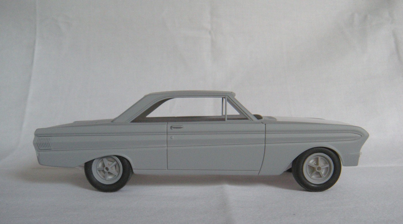

Finally got some primer on the body.
DSCN4593DSCN4596
I think it compares favorably to the AMT.
DSCN4599
As you said...'not replica stock accurate but it will work for a race car' ;)
Works for me ^_^

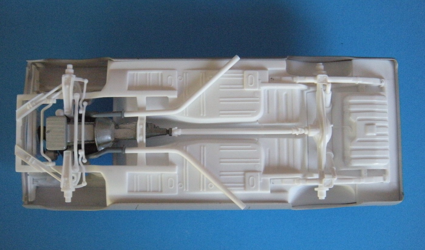

Made up a set of dump pipes. Cleaned up and shortened the drive shaft due to the forward position of the rear axle.  I think the chassis is ready for paint.
DSCN4602

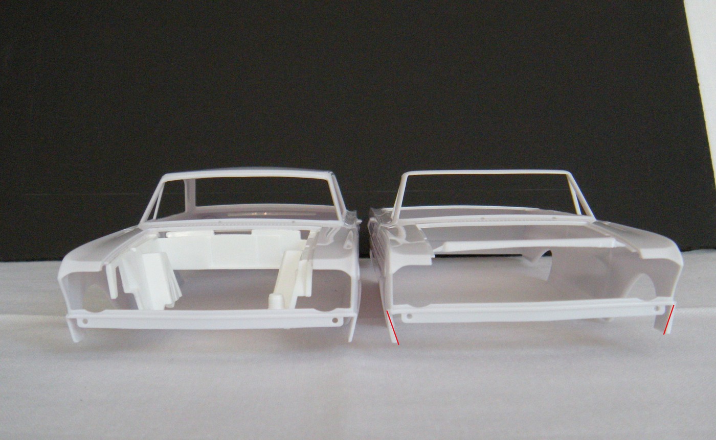

Very impressive work! HOW exactly did you modify the sides of the body?
Every time I open the box of the Trumpeter i cringe, obviously this is the body's biggest problem, the slab sided look.
So , how'd ya do it?
Again, very impressive COOL work.
Thanks Bob.
I'll try to explain what I did Gary.  If you have any questions just ask.
Trumpeter Falcon Body Mods
  • Set the body on a flat surface you will notice the top line of the fender slopes upwards.  Sand the bottom edge of the body to bring the top line of the fender down to a more parallel position.
  • Aggressively sanded the outer bottom edge of the body to give the appearance of more curvature top to bottom.
  • The bottom line of rear fender, behind the wheel should slope upwards.
  • The front edge of the front wheel opening is too vertical.
DSCN4566
  • Remove a wedge of material in the rear valance and pull the lower edge of the fenders inward.
DSCN4518DSCN4569
  • Carefully bend the lower edge of the front fenders inward.
  •  Soften all edges of the body lines.
