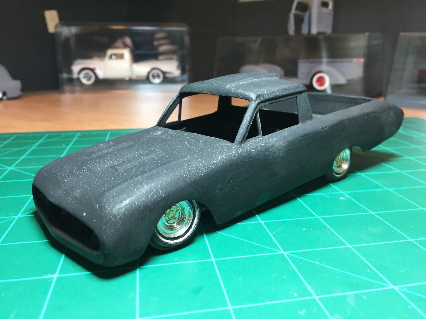

Greg Pugh Posted May 18, 2017 Posted May 18, 2017 Well, I must be a glutton for punishment! I happened upon this poor '61 Ranchero in a recent vintage kit score I purchased. I took it to last Sunday's club meeting because I thought it was cool to see somebody's unfinished custom from back in the 60's, but I also wanted to offer it up to anyone in the club that wanted to take on the challenge of finishing this bad boy up! No one stepped up. And I can't blame them! Lmao! I was literally walking it to the trash can the next morning when the voice in my head ...said "Oh heck..." So in the tank it went and I'll be danged if it didn't clean up pretty good! The plan is to follow the original builder's vision but to do it up right this time and add a couple of things here and there. I'll post pictures as I bump along. Here are a couple before and afters:
Greg Pugh Posted May 18, 2017 Author Posted May 18, 2017 The front grille piece is from AMT's '57 Chevy and the rear piece is from a '61 Thunderbird I believe. They're both wider than the Ranchero body by a good 1/4" on each side if that gives you any idea how much putty they used! They completely smoothed the sides out to where I didn't see any of the coves on the sides, door handles, scripts...nothing! There must've been a good quarter of a cup of mud-like putty at the bottom of my container when I pulled this poor thing out! In this picture, you can see how the front grille/bumper was married to the car. The sides protrude out from the fender. That's not going to work.
Greg Pugh Posted May 18, 2017 Author Posted May 18, 2017 The first thing I did was remove the lower end of it so that it could set flush with the body. In place but too wide... ...I then cut it in the center to remove some material. Then attached my two sides. Now time for some automotive grade spot putty!

Greg Pugh Posted May 20, 2017 Author Posted May 20, 2017 I started working on getting the front end smoothed out. You can also see that I filled in four of the holes that were in the tops of the front fenders. I can't believe this is the same car!!
Greg Pugh Posted May 20, 2017 Author Posted May 20, 2017 (edited) I think I have a pretty good idea of what I want to do out back so I moved back there. First, I started by smoothing out the tailgate and shaved it of it's emblems and the hinges. I also filled the gaps on the sides of the tailgate as it will be "welded shut". There were a couple of sink marks where the locating studs are to screw the body to the chassis plate. The black marks were to remind me where to put filler to fill those in. Edited May 20, 2017 by Greg Pugh
Greg Pugh Posted May 20, 2017 Author Posted May 20, 2017 (edited) This is how the taillights/rear bumper rested against the body where it was originally glued and then the original builder went crazy with the putty. I wanted to pull them closer into the body. And by grinding away at the backside, I was able to do just that. Just like the front, the rear will need to be narrowed to fit the body as well. So this is going to be my method. I will shorten it from the ends rather than section it in the center. More to come. Stay tuned... Edited May 20, 2017 by Greg Pugh

Greg Pugh Posted May 21, 2017 Author Posted May 21, 2017 Wow! Thank you for putting it that way! It's very flattering! If you look at the first couple of pictures after the car was stripped, you can see some blue paint on the roof. The layers of paint went: black, silver, blue, then black again. I believe the black to be primer, the silver the base, and blue must've been the desired color. When that didn't work out, the blue was then primed over again in black. Judging by the cracking in the black, I would guess that the primer was too hot for the blue and crazed which most likely ended up killing the progress of this car. Sorry to go all CSI on you but in keeping with the original builder's vision, I will be painting the car blue.
