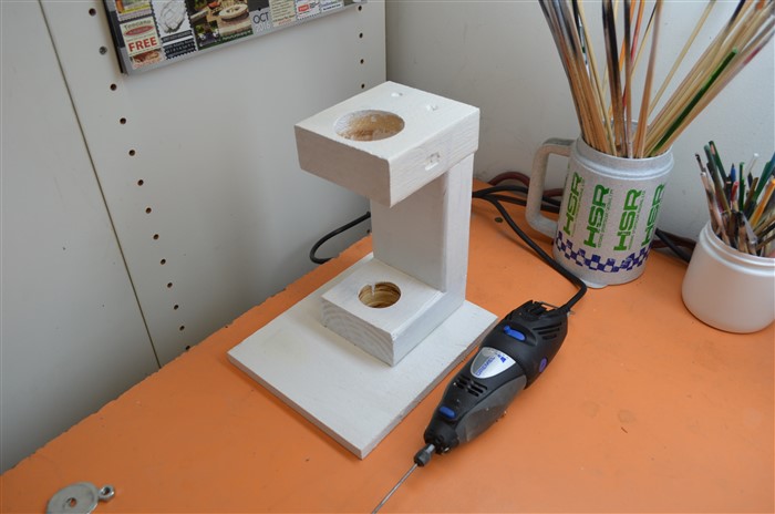

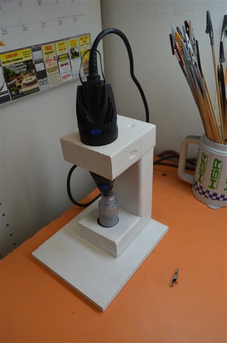

Miatatom Posted June 11, 2017 Share Posted June 11, 2017 I made a fixture to hold my variable speed Dremel. The stirrer is a short piece of coat hanger bent 90 degrees at the end and flattened a bit. Works like a charm, no sitting there holding it, and cost pennies if you have some scrap wood. Quote Link to comment Share on other sites More sharing options...

dlh Posted June 14, 2017 Share Posted June 14, 2017 I made a fixture to hold my variable speed Dremel. The stirrer is a short piece of coat hanger bent 90 degrees at the end and flattened a bit. Works like a charm, no sitting there holding it, and cost pennies if you have some scrap wood. Thanks, this is a great idea. After my Badger craps out I'll use that shaft in a Dremel. (It helps to have two Dremels!) Dave Quote Link to comment Share on other sites More sharing options...
