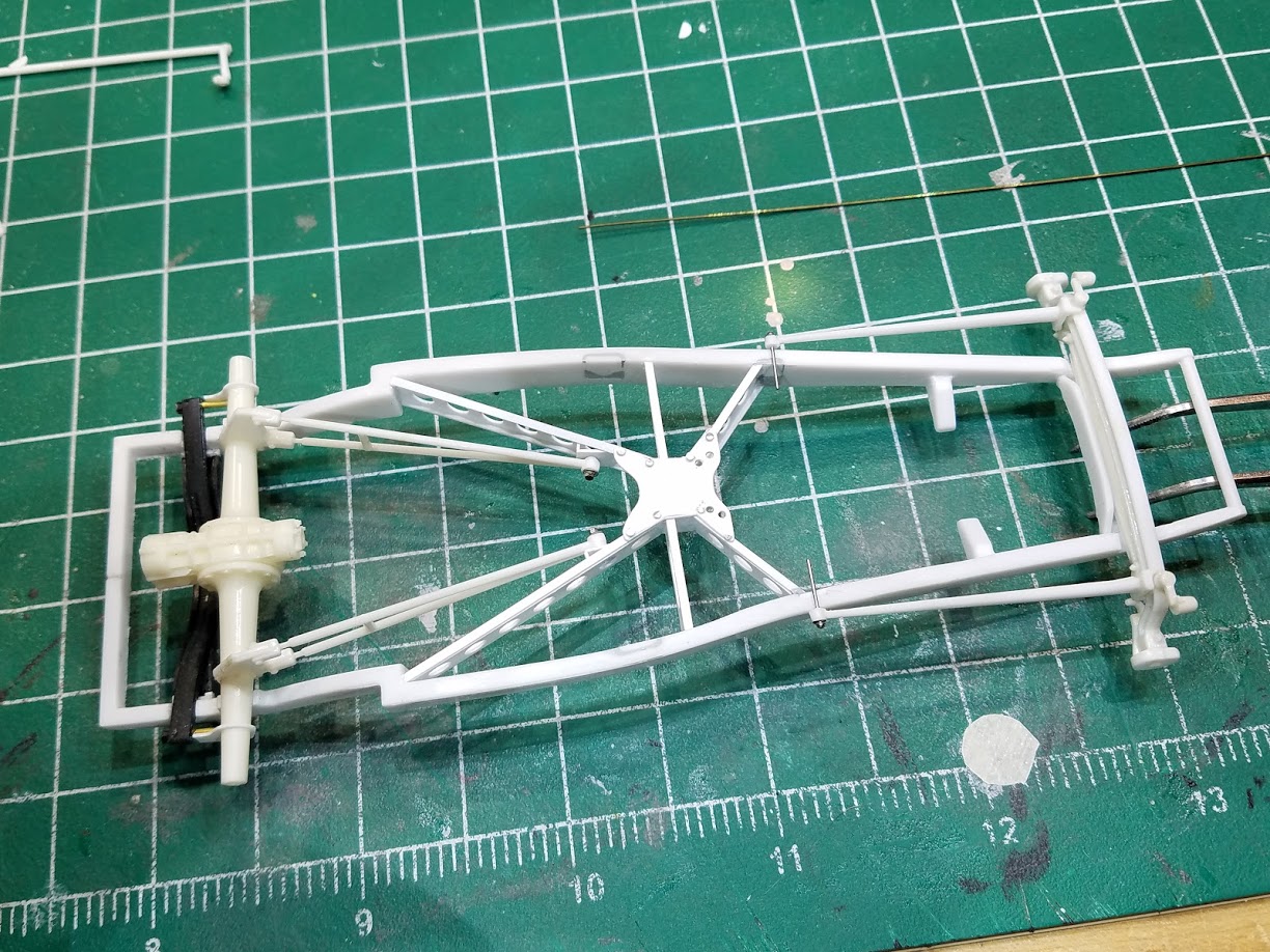

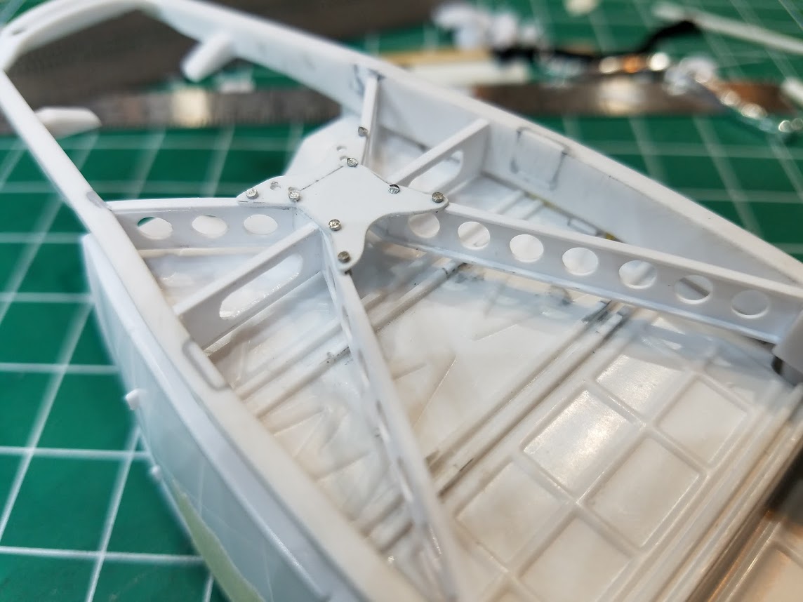

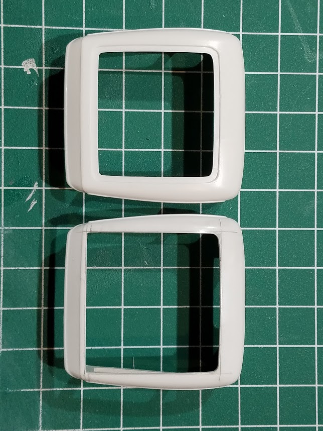

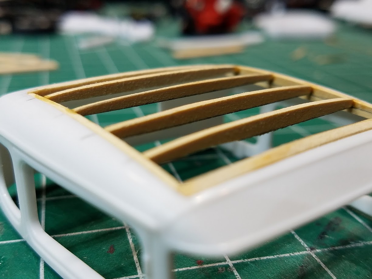

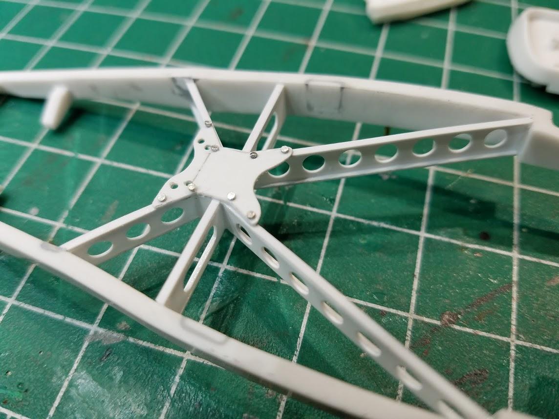

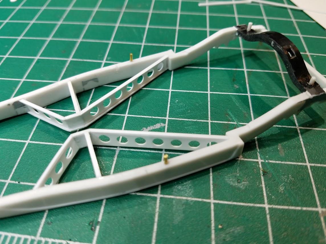

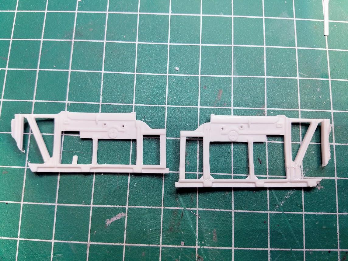

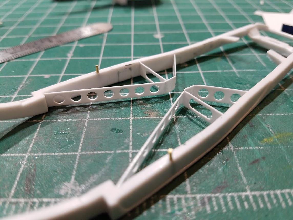

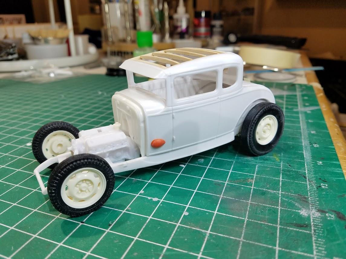

Taxdude Posted November 11, 2017 Posted November 11, 2017 (edited) Ahead of tax season when all building comes to a full halt I thought that I would do a quick build. Well this went sideways quickly. Decided to use the bare interior panels but unchanneled them. But regular bench seat but without the pleats. Built the wood framing for the roof. More difficult than I first thought to get all of the curvatures just right. Used the 32 frame but with changes. Model A front crossmember, quick-change rearend with transverse leaf and all assorted suspension parts. Also scratch built the center x-member. So yea just kept the side rails. Engine will be a Y-Block so that will take some work and custom scratchbuilt headers and exhaust. So basically change everything quick build. Edited December 2, 2017 by Taxdude
Ace-Garageguy Posted November 11, 2017 Posted November 11, 2017 Yeah, that's the way you do it. Nice...
Modelbuilder Mark Posted November 11, 2017 Posted November 11, 2017 That happens, but it will be cool!

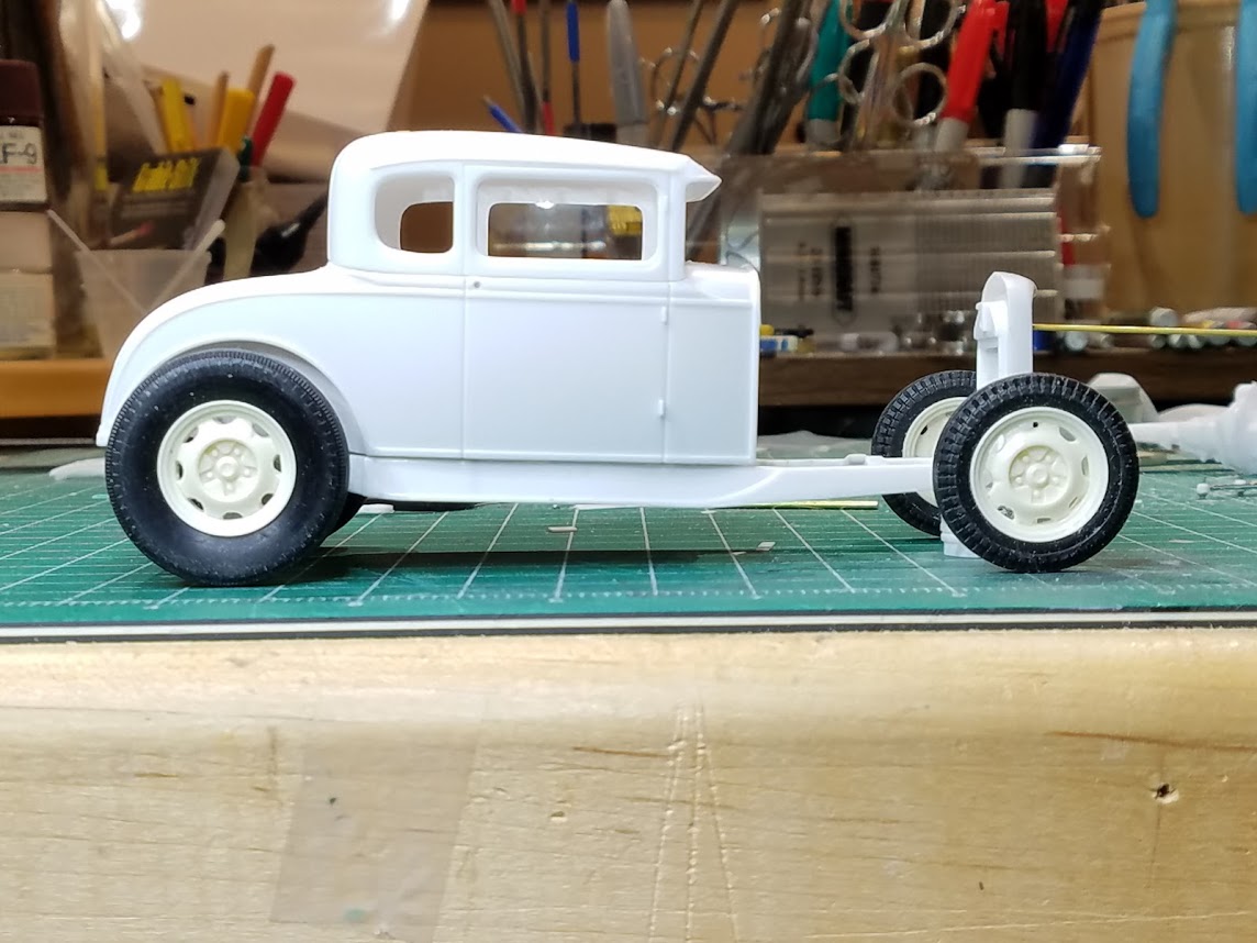

Draggon Posted November 11, 2017 Posted November 11, 2017 The proportions are perfect in that side shot.
TooOld Posted November 11, 2017 Posted November 11, 2017 Definitely some fine fab work there , keep up the good work !
espo Posted November 11, 2017 Posted November 11, 2017 Great chassis work, I like the wood insert support. Did the wheels come in this kit ? The wheel centers look different.
Taxdude Posted November 11, 2017 Author Posted November 11, 2017 (edited) On 11/11/2017 at 5:15 PM, espo said: Great chassis work, I like the wood insert support. Did the wheels come in this kit ? The wheel centers look different. Those are Divco milk truck wheels. Problem is I have no idea where I got them. They came with soft vinyl tires. The wood top was a bit difficult finding the right spacing fo the cross slats. Edited November 11, 2017 by Taxdude
1930fordpickup Posted November 11, 2017 Posted November 11, 2017 We all need copies of those wheels. LOL They are nice and different from the normal wheels we see.
Spex84 Posted November 11, 2017 Posted November 11, 2017 Sweet, this is all kinds of right! Love the new x-member, stock-style roof opening and bows, and the tall rear tires with those Kelsey Hayes high-clearance wheels. The wheels probably came from Modelhaus?? Bernard Kron would know...he's done at least one project using them.The Y-block is going to look great in this thing.
Dennis Lacy Posted November 11, 2017 Posted November 11, 2017 All I can say is: This is already killer. Nice work building the frame center "X" and top bows. Really digging the "Divco" wheels and Y-block, too. I love this kind of hot rod building!
502 Posted November 12, 2017 Posted November 12, 2017 Well it doesn't get much better than that. I look forward to seeing more of this one. The scratch work on that x-member is so clean! Here is a link to some 3d printed "divco" wheels. https://www.shapeways.com/product/QM85PWE6K/1-25-scale-18-quot-kelsey-hayes-artillery-wheels?optionId=63159613&li=marketplace
Taxdude Posted November 12, 2017 Author Posted November 12, 2017 On 11/12/2017 at 4:03 AM, 502 said: Well it doesn't get much better than that. I look forward to seeing more of this one. The scratch work on that x-member is so clean! Here is a link to some 3d printed "divco" wheels. https://www.shapeways.com/product/QM85PWE6K/1-25-scale-18-quot-kelsey-hayes-artillery-wheels?optionId=63159613&li=marketplaceThanks for the lead on the Divco's

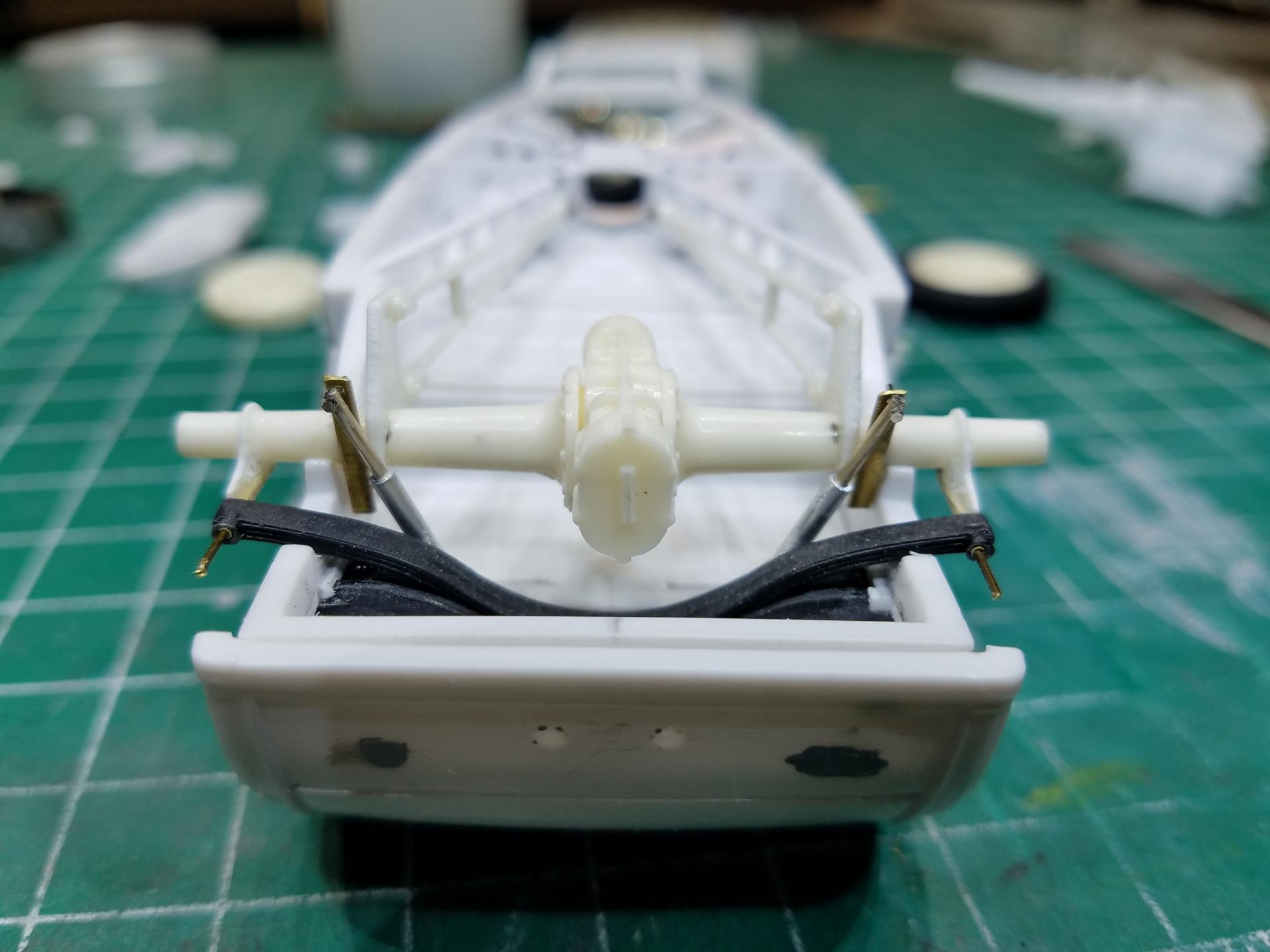

Taxdude Posted November 12, 2017 Author Posted November 12, 2017 Got some work completed on the suspension. Still need to fab up some shock mounts for the rear-end and shocks too. Front end needs shock mounts along with radius arm frame mounts.
Spex84 Posted November 13, 2017 Posted November 13, 2017 That looks killer, Fred! I'm digging the pinned mounts and spring hangars. Looks solid.*side note: the Shapeways 3D Divco's are something I made. Kinda neat to see them pop up here.
Taxdude Posted November 13, 2017 Author Posted November 13, 2017 On 11/13/2017 at 12:11 AM, Spex84 said: That looks killer, Fred! I'm digging the pinned mounts and spring hangars. Looks solid.*side note: the Shapeways 3D Divco's are something I made. Kinda neat to see them pop up here.Thanks and more to come.Those are your Divco's, very cool. So let me ask you about 3D printing. Could it be possible to do a see-thru 32 Ford grill?

Spex84 Posted November 13, 2017 Posted November 13, 2017 On 11/13/2017 at 2:42 AM, Taxdude said: Thanks and more to come.Those are your Divco's, very cool. So let me ask you about 3D printing. Could it be possible to do a see-thru 32 Ford grill?Thanks! Re: a see-through '32 grille...the best way to achieve that given the current technology is probably a photo-etch grille. Shapeways can't yet produce thin bars as narrow as deuce grille bars, without them deforming due to heat and handling.
Draggon Posted November 13, 2017 Posted November 13, 2017 (edited) I believe the Divco's are Modelhaus. I've seen them on a few builds here. Edited November 14, 2017 by Draggon
Taxdude Posted November 14, 2017 Author Posted November 14, 2017 On 11/13/2017 at 4:31 AM, Spex84 said: Thanks! Re: a see-through '32 grille...the best way to achieve that given the current technology is probably a photo-etch grille. Shapeways can't yet produce thin bars as narrow as deuce grille bars, without them deforming due to heat and handling.I had a feeling. A PE grill is nice but to have round grill bars would be so cool. Well I'm sure they will get there someday right after we figure out this how to fly issue

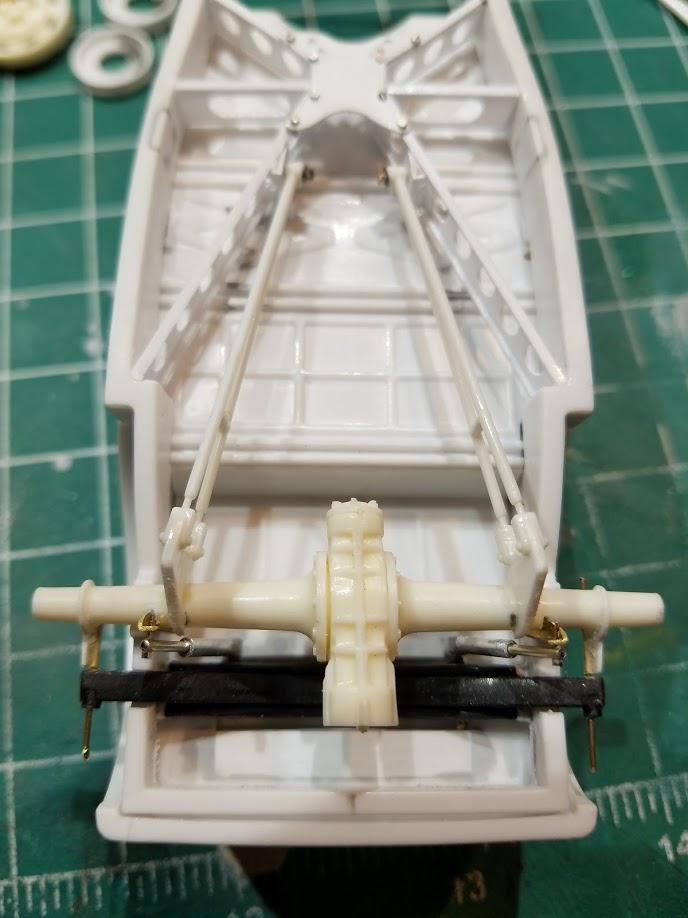

Taxdude Posted November 23, 2017 Author Posted November 23, 2017 After a few days away I came back to build the rear shocks and mounts. Still needs to be finalized but posting what I have done keeps me going.
Bernard Kron Posted November 23, 2017 Posted November 23, 2017 (edited) On 11/11/2017 at 7:59 PM, Spex84 said: Sweet, this is all kinds of right! Love the new x-member, stock-style roof opening and bows, and the tall rear tires with those Kelsey Hayes high-clearance wheels. The wheels probably came from Modelhaus?? Bernard Kron would know...he's done at least one project using them.The Y-block is going to look great in this thing.Gorgeous build, and great style, too. Yeah, the Divcos and the tires are from Modelhaus. They made two sets, one with big 'n' littles with pie crust detail and one with the same tires all around, simple ribbed tires, like tose often seen at the dry lakes. I bought one set of each and used them both, I still have the ribbed tires which I'm saving for a dry lakes build. Most Monogram 1/24th tires, like the ones from the '37 Ford Delivery Van, fit perfectly. Like everyone else regarding things Modelhaus I wish I'd bought more. Chris, what are you're Divcos made to fit, tire wise? They look terrific. Your line of parts it's rapidly becoming formidable. You are on my wish list for 2018.... Edited November 23, 2017 by Bernard Kron
