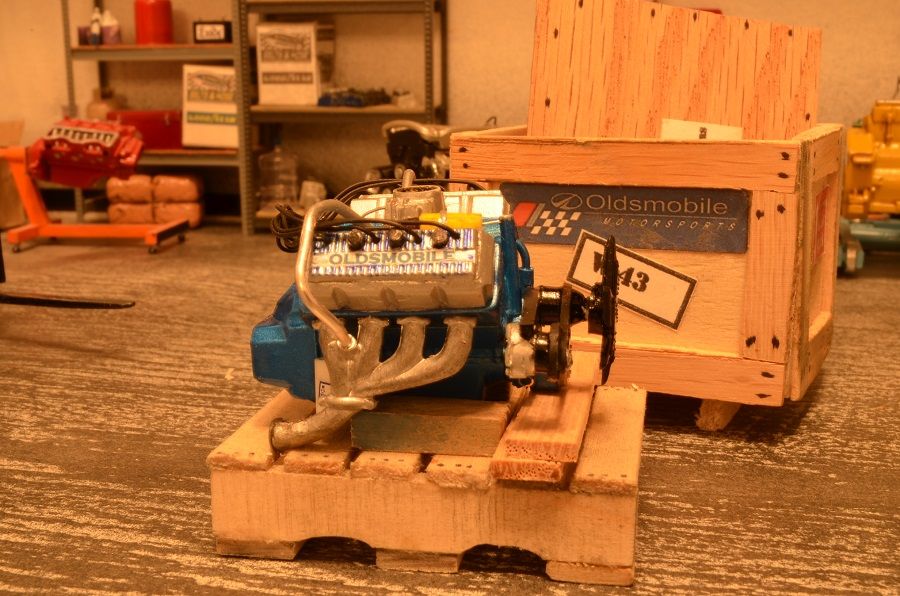

I thought that I'd seen a scale version of the 455 Olds Hemi ! Are you planning to install that bad boy into a Cutlass ? The heat crossovers seem to indicate that the engine was darned close to production (cold-start emissions from c.1971) ...
Expand
No. It is sitting in my engine collection.

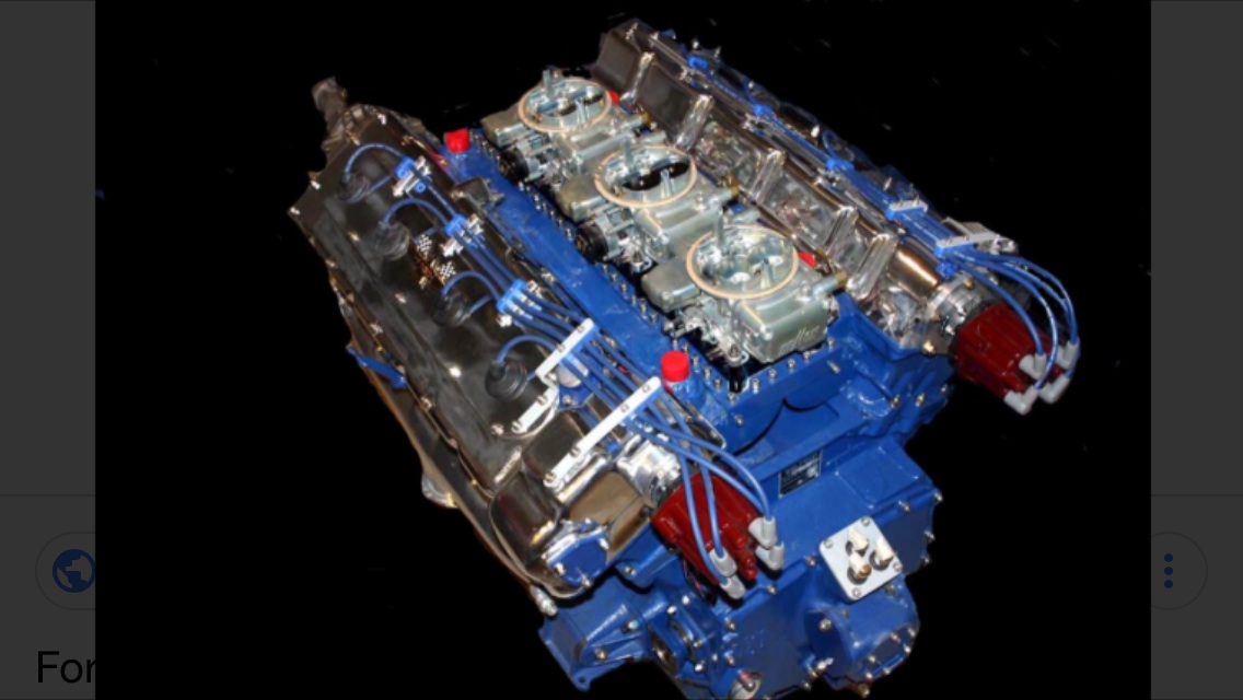

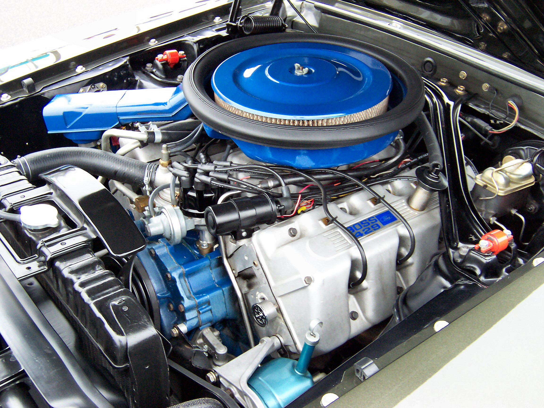

As we talk about distributors.
There is a reason why they are placed where they are, the distributor is driven from the camshaft through a sprocket and the distributor drives the oil pump in the engine, so on OE cars the distributors are right above the oil pump.
So most of the Ford engines has the distributor at the front of the engine pointing straight up and the oil pump are under inside the oil sump, Ford Y-block has it at the rear at an angle towards the passenger side and the oil pump is on the outside of the block on the bottom drivers side, the flathead V8 is different as the distributor don't drive the oil pump, the distributor is mounted at the front of the timing cover on the early Flathead V8's and the later 8BA-CM has a angle drive on the upper timing gear and a regular distributor is placed at an angle on the passenger side.
The Mopar big block including 426 Hemi has it in front of the head on the passenger side at an angle and the oil pump is located at the front bottom outside of the driver side of the block.
Buick 66-forward and Cadillac 67-forward OHV has it the opposite way, distributor on the drivers side at an angle and the oil pump outside of the block at the bottom of the passenger side.
Chevy big and small block, Mopar small block and early Hemi, Pontiac, Oldsmobile, Cadillac 49-67 OHV and Buick Nailhead has it straight up at the rear of the engine and the oil pump under inside the sump.
On many modern cars there are no distributors at all, they have coils for each cylinder and the ignition is timed from the computer through sensors on the engine.

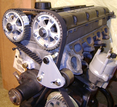

And then there is also the Ford 2.3L.............
Image result for Folvo
And then the Folvo.......Ford 2.3L block with the Volvo B234F/R head. Wired just like the Ford 2.3L, as the Volvo has the same firing order/rotation as the Ford.
Edited by MarvinGardens

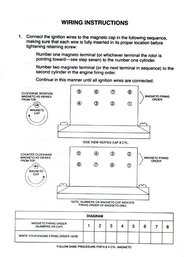

  On 12/10/2017 at 5:30 AM, #1 model citizen said:
Ok. I knew it took the place of the distributor, however the wires don't pug into the top like a distributor. Looks like maybe they all come out of a slot about 1/2 way down the side?
Expand
What you refer to is a Vertex Magneto. The cap has 8 holes placed in the side of the cap. The wires still go to each terminal, they are just arranged inside the cap with terminals and secured with screws to the terminals inside. Firing orders are still the same as that is determined by the crank and cam cycles. There generally is no coil on a vertex mag but companies offered conversions to run one sperate from the internal generator. Tip, DO NOT rotate a mag in your hand and touch the terminals. Most being self energizing with shock the unholy H. E  double hockey stick out of ya! There are or have been conversion caps for this style of magneto to run normal style external terminal wires.
Edited by mr68gts
Thanks Paul. This is pretty much the way figured they work, although they have always been somewhat of a mystery to me. (Something I should have researched but never have :unsure: ) I am really more interested in the way they look in order to convincingly wire a model engine. Your explanation & photo of the cap(?) helps.
Could you maybe provide a photo of the outside of the magneto with wires in place. Maybe a photo of one on a engine? Anyone? Maybe different styles /brands?
Edited by #1 model citizen
Expand
Here are some pics of the outside of some magneto
