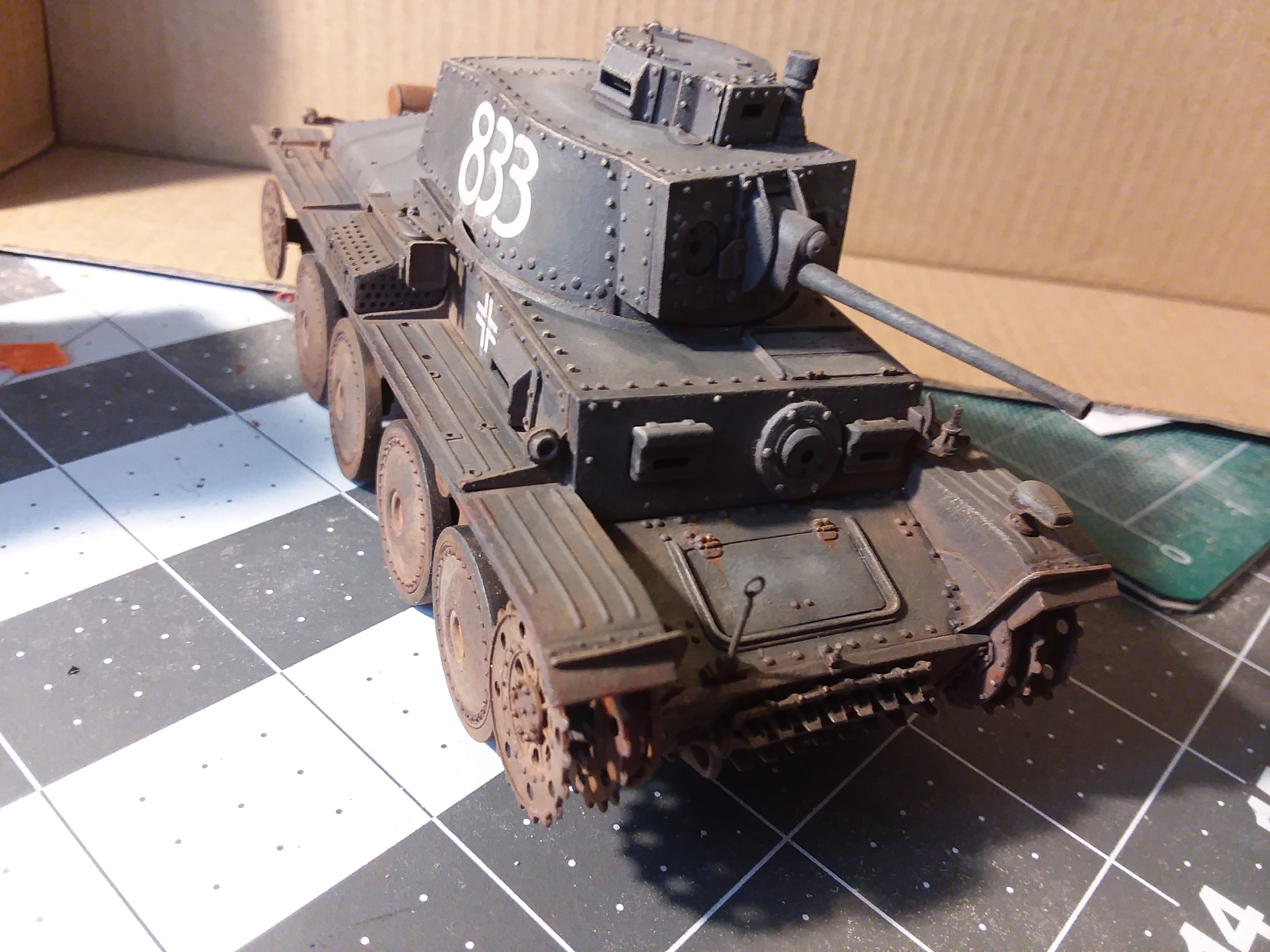

Pat Minarick Posted April 16, 2018 Share Posted April 16, 2018 (edited) 2 hours ago, Jantrix said: Excellent work. i still have work to do on my patina as well. I use similar techniques and this stuff. http://www.bragdonent.com/smpic/nweather.htm I have just started using weathering pigments, the type for tanks . I'm always trying new stuff. I'm learning stuff from the armor guys too ! Edited April 16, 2018 by Pat Minarick Quote Link to comment Share on other sites More sharing options...

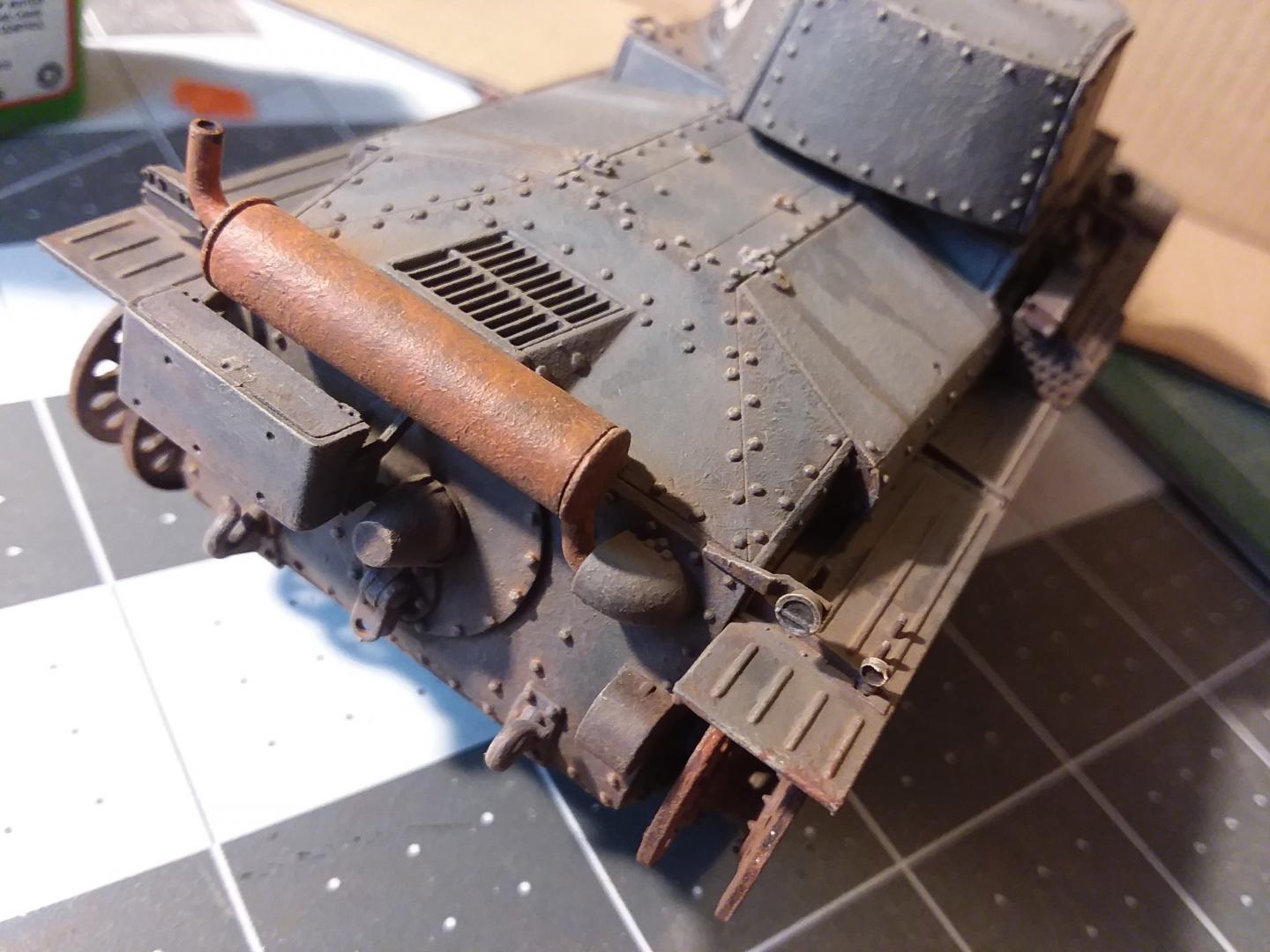

Lunajammer Posted April 16, 2018 Share Posted April 16, 2018 Pat, I'd say you're learning well from the tank guys. Quote Link to comment Share on other sites More sharing options...
Pat Minarick Posted April 16, 2018 Share Posted April 16, 2018 (edited) 51 minutes ago, Lunajammer said: Pat, I'd say you're learning well from the tank guys. My first one. Still need to finish it up. Edited April 16, 2018 by Pat Minarick Quote Link to comment Share on other sites More sharing options...

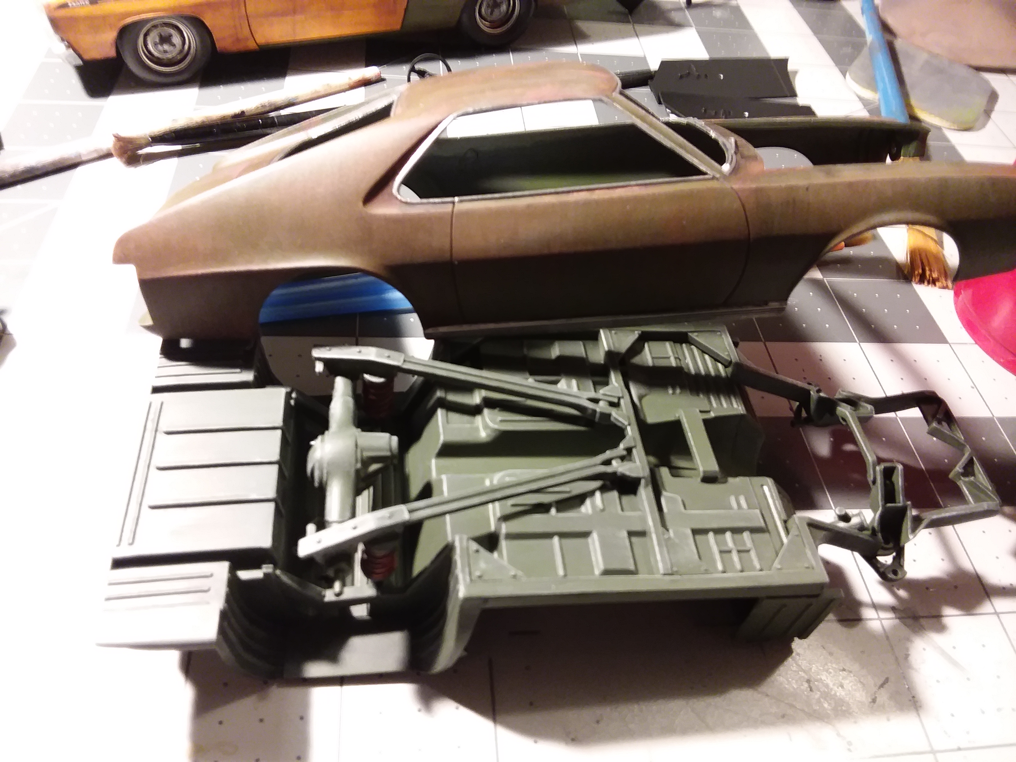

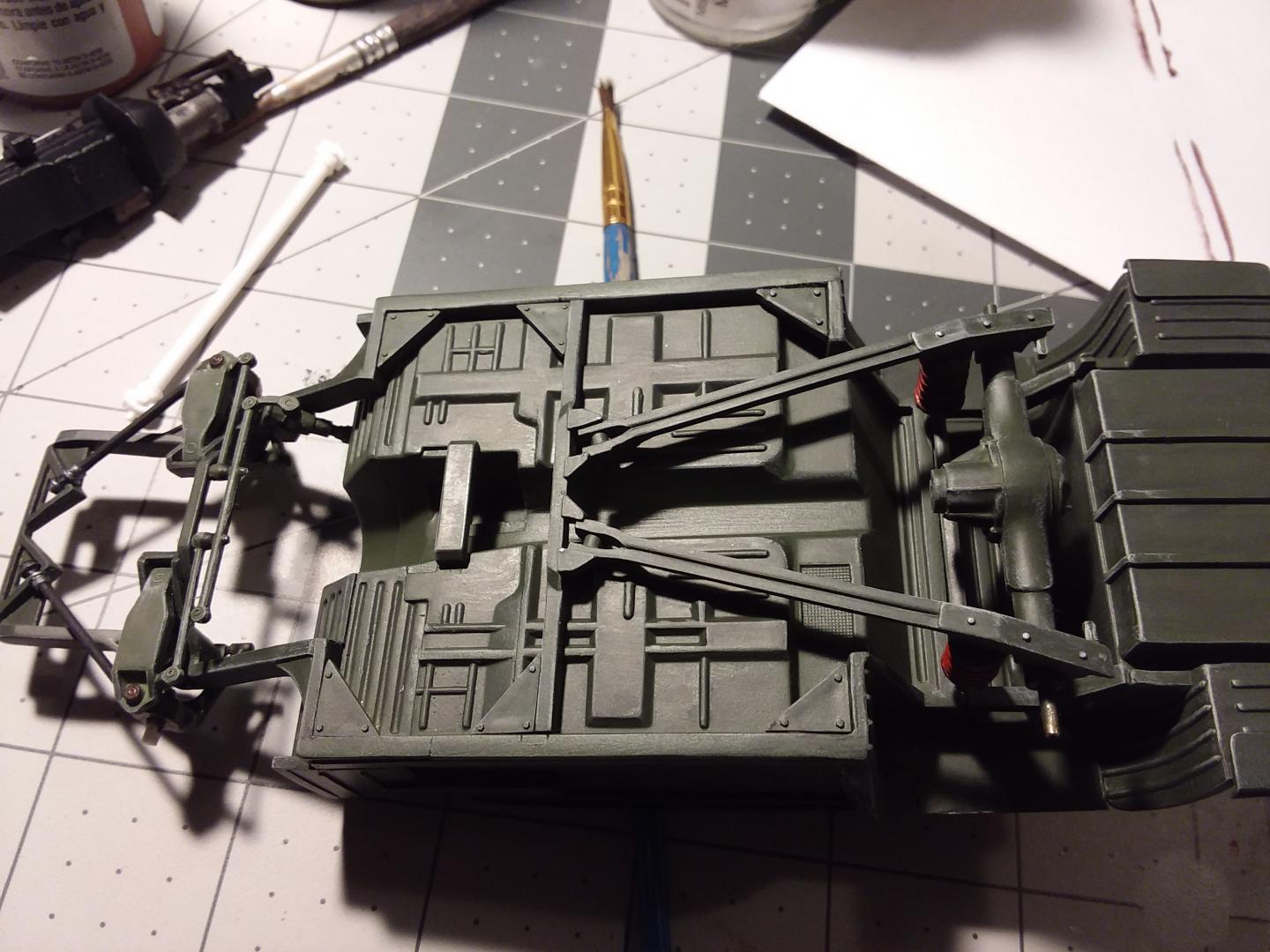

Pat Minarick Posted April 21, 2018 Share Posted April 21, 2018 Got the interior pretty much done. Still need to add the pedals . Forgot them! Started on the chassis and engine. Quote Link to comment Share on other sites More sharing options...

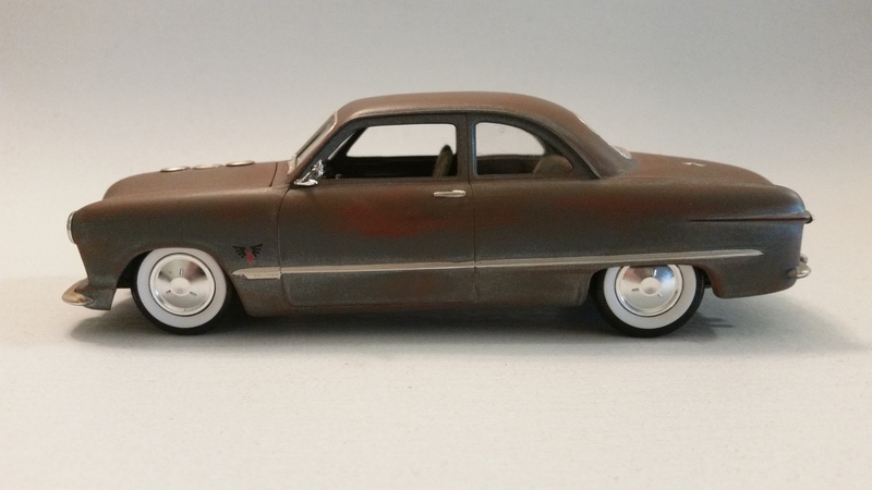

disconovaman Posted April 21, 2018 Share Posted April 21, 2018 Hey guys, I've been plugging away at the Cannonball challange. From the moment I got this kit the idea was always to build a neglected shop truck. The patina/weathered look seems to be a popular paint theme here this year. It's the like that old sayin "great minds think alike". Anyway I painted this a month ago and I've slowly been gettin it together... I've got more weathering to do but here is how it looks for now. Quote Link to comment Share on other sites More sharing options...
Pat Minarick Posted April 22, 2018 Share Posted April 22, 2018 12 hours ago, disconovaman said: Hey guys, I've been plugging away at the Cannonball challange. From the moment I got this kit the idea was always to build a neglected shop truck. The patina/weathered look seems to be a popular paint theme here this year. It's the like that old sayin "great minds think alike". Anyway I painted this a month ago and I've slowly been gettin it together... I've got more weathering to do but here is how it looks for now. I like it. Quote Link to comment Share on other sites More sharing options...

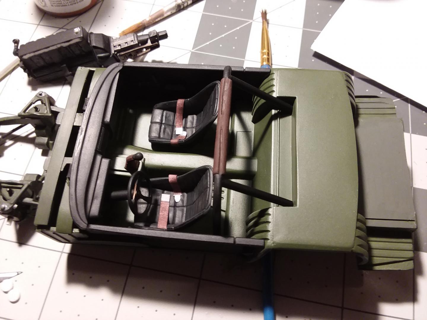

Jantrix Posted April 23, 2018 Author Share Posted April 23, 2018 Anthony, Pat, that's some terrific work. Some work on the Willys. Quote Link to comment Share on other sites More sharing options...
Lunajammer Posted April 23, 2018 Share Posted April 23, 2018 I sure like what I'm seeing here guys. Super clean Rob. Quote Link to comment Share on other sites More sharing options...
Pat Minarick Posted April 23, 2018 Share Posted April 23, 2018 Looking good Rob , what is the green color you used on the interior ? Quote Link to comment Share on other sites More sharing options...

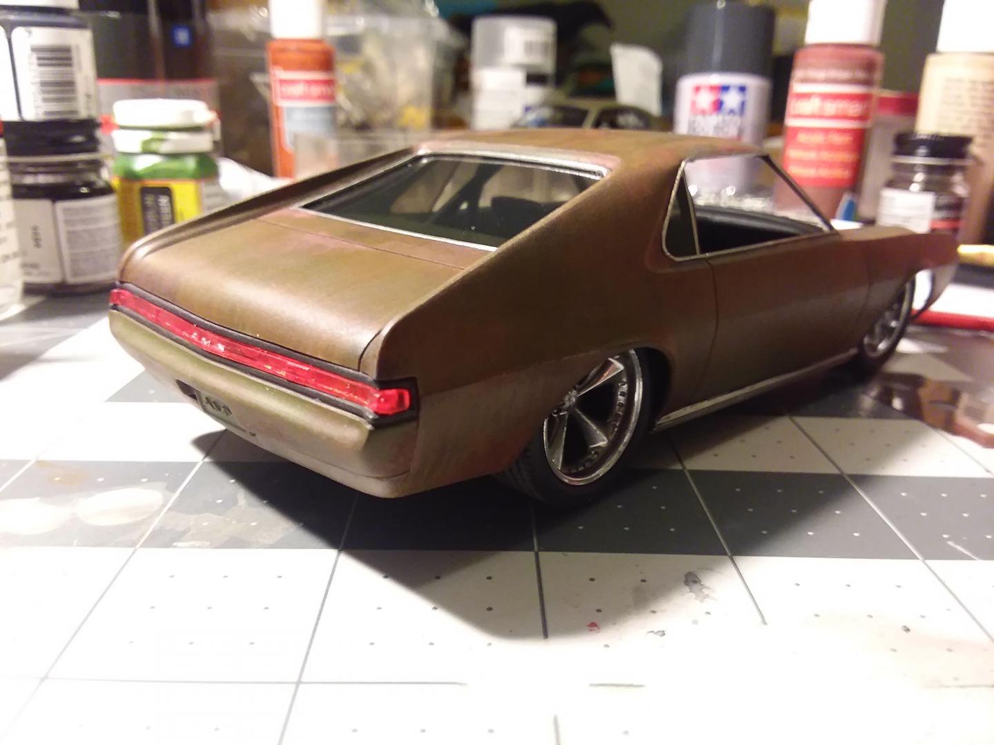

Pat Minarick Posted April 24, 2018 Share Posted April 24, 2018 It's getting there. Quote Link to comment Share on other sites More sharing options...
Jantrix Posted April 24, 2018 Author Share Posted April 24, 2018 20 hours ago, Pat Minarick said: Looking good Rob , what is the green color you used on the interior ? It's a Valspar green. I'll check out the name when I get home. Quote Link to comment Share on other sites More sharing options...

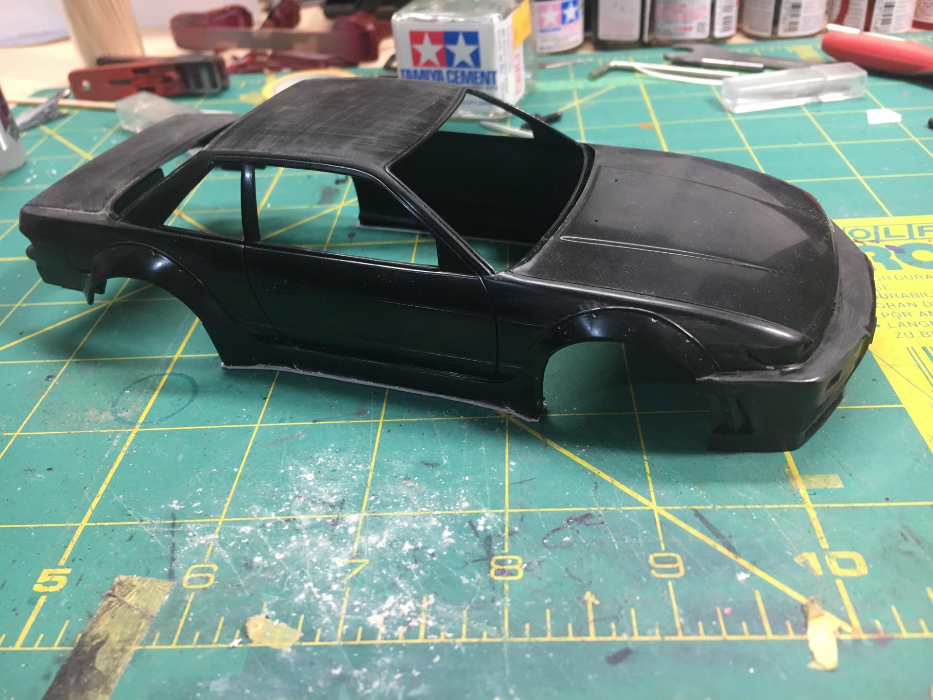

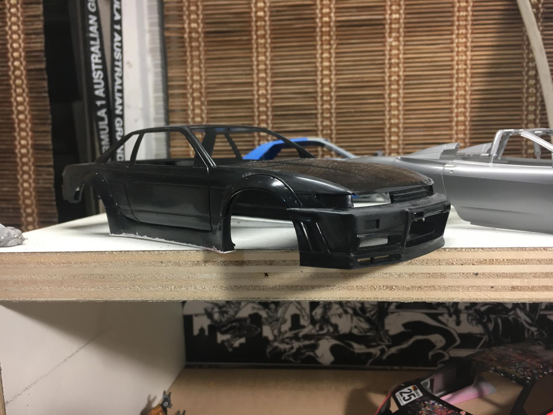

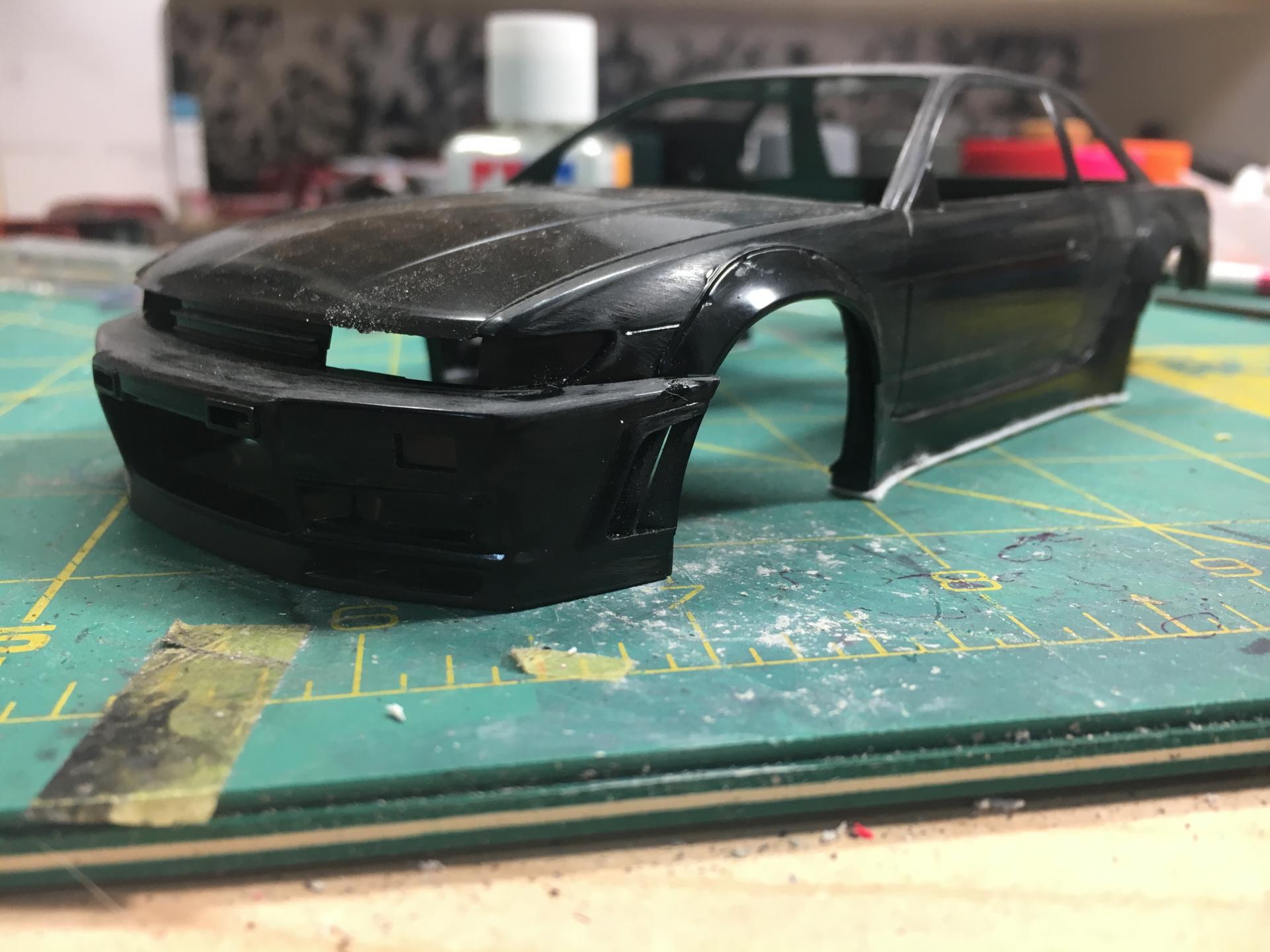

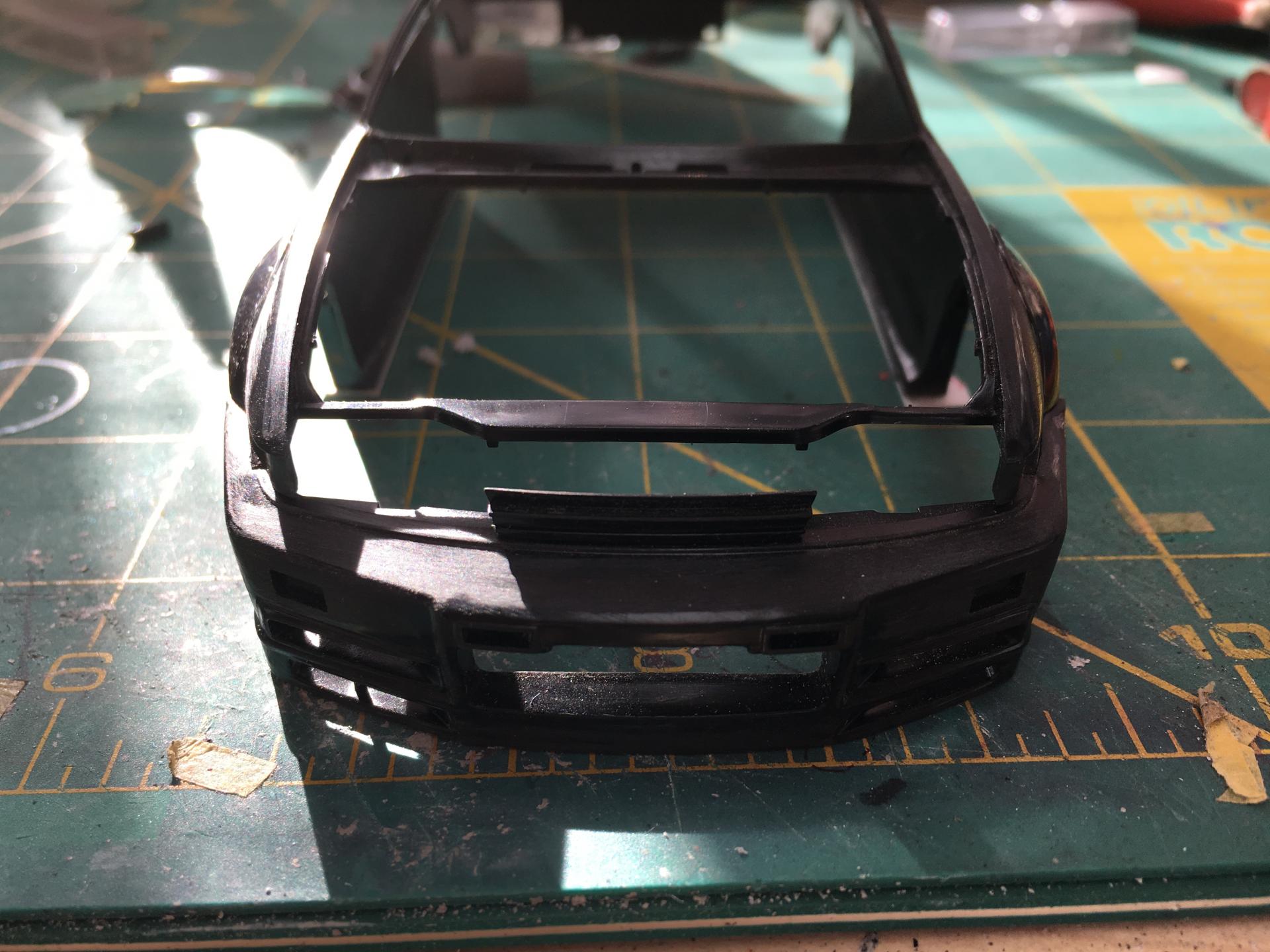

da_ashman Posted April 26, 2018 Share Posted April 26, 2018 Great work Guys! That AMX is looking sweet & love the Rotiform wheels on the Mustang! Ive finally been able to make some progress on the Soviet Silvia now that the SF70 & a couple of other builds are out of the way. Managed to get the bodykit attached, spent a few hours getting the right fit, & flattened off the side skirts. One of the fenders needed to have the gas cap flap cutout & backfilled. Ive also ordered an interior set that will really set this build off, next step is fitting an engine bay into it & hunting down the BLAH_BLAH_BLAH_BLAH UPS man whos got my rear bumper.... Stay tuned. Ash Quote Link to comment Share on other sites More sharing options...
