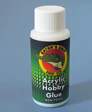

SfanGoch Posted December 31, 2017 Posted December 31, 2017 Try Gator's Grip Acrylic Hobby Glue. It dries clear and is strong enough to hold styrene together. Windshields and other clear parts stay attached. I use it to test assemble a model so I can check fit and placement of parts. Other guys have used it in building armor kits. It can be painted over with enamels or acrylics This stuff is great for attaching PE, too. It won't hold in high stress areas; but, it'll do the job for everything else.
