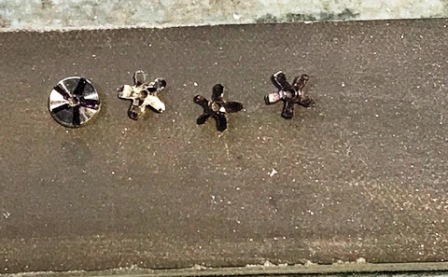

each shock has an outer disc that I punched from .005 copper sheet
then I made the clips - that look like mechanical spiders
these are hand filed from additional machined nickel discs and then simply marked black with a sharpie
the shocks are attached with some castle nut castings from that Russian aftermarket company - they make the nut/bolt assembly in different sizes - I am drilling holes in the 1.6 mm size and then cutting them from the bolt casting - probably finish these with a silver sharpie - the real things are cast and therefore have a relatively dull finish ...

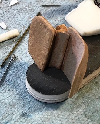

the friction shocks are done so its on to the seats - just about the last parts that I need to make ...
renshape again - different sizes and shapes - mostly hand tool shaped with random tooth files and sanding sticks
Link to comment

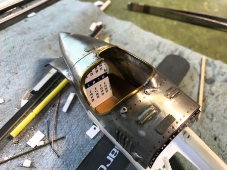

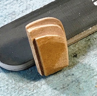

the driving mechanic seat back is recessed on this car - it's a neat feature
but I have to piece together the renshape parts to follow the contour of the cockpit opening
once I got the part roughed out I began to think about the finish ...
Link to comment
I tried shaping the part to show some creases in the  seat cushion - but it wasn't working well on the mechanic seat back ...
so I pulled out a bag of leather scraps and found some brown leather that matches the color on the car
the grain is fine so I think it will look okay with some work to finish the leather folds at the top of the seatback
and it was reasonably thin - I don't often use leather in 24th scale - but this will do ...
will have to figure out the seat cushions - either cover them in leather or make "leather" cushions ...

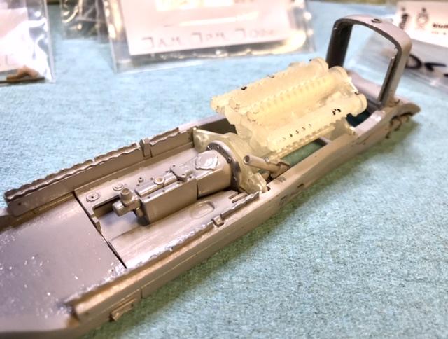

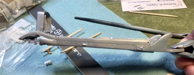

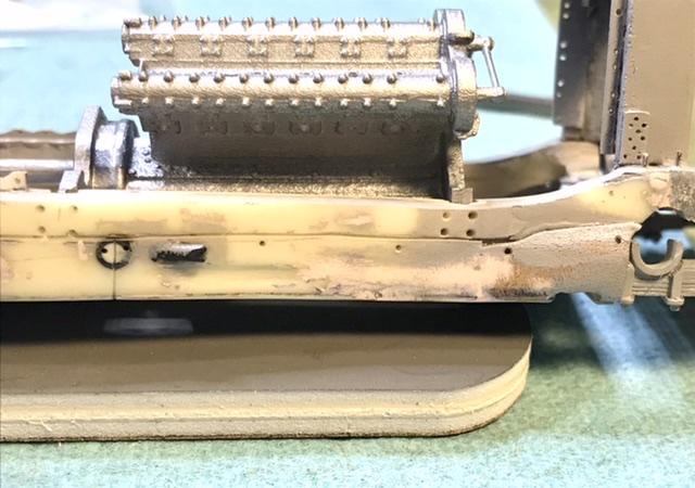

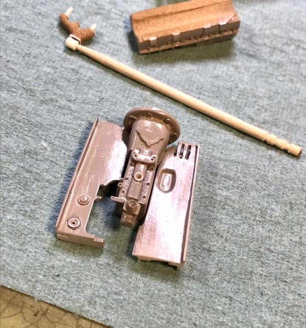

Asleep for two years - i’m waking sleeping beauty …. Most of the parts have been finished - but need paint - i have to re-do a few things - and then work on the finish applied to the body work - first im gonna try to get a chassis / drive train painted and assembled …
Link to comment

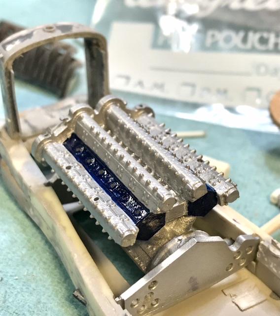

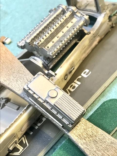

Building a Gloster Gladiator for an IPMS show cub display gave me chance to get familiar w Tamiya’s acrylic laquer paints - good stuff - i hand painted the cyl head royal blue - and then set off the sump pan bolts w some gun metal …
Link to comment

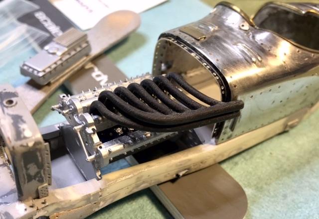

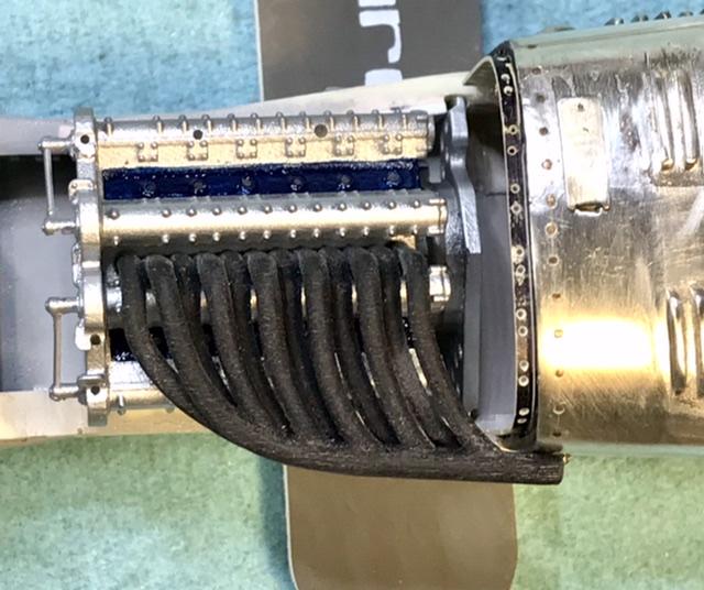

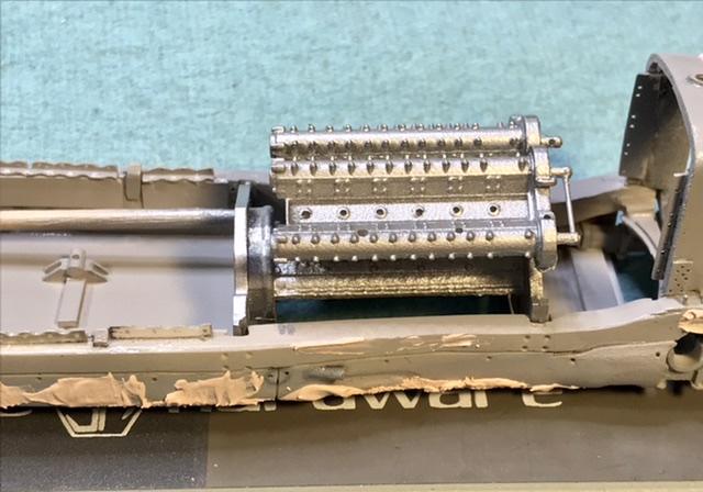

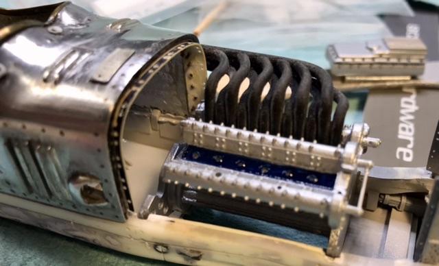

The exhaust manifold is really cool - forty years before BRM (and later Ferrari) swept the exhaust pipes out of the center of their DOHC engine - Delage tried it in their new 12 cylinder engine - spectacular looking but maybe not the greatest packaging ???
Link to comment

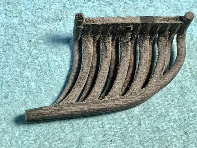

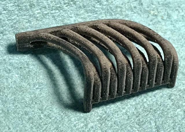

Pico has told me that the design was complex - but its the only way to produce this unique part ….  The printed part is very strong - but is a nylon-like material requiring tedious prep - but worth the effort - ill finish this in either flat black or maybe gun metal   - tbd -
Link to comment

Gun metal or fl black for the pipes  ??
today's Question
where does flat black end and gunmetal begin  ???
How about flat black, rubbed with some powdered graphite, then flat coated, as needed? Maybe mix the barest hint of dark brown pastel in with the graphite.
Link to comment

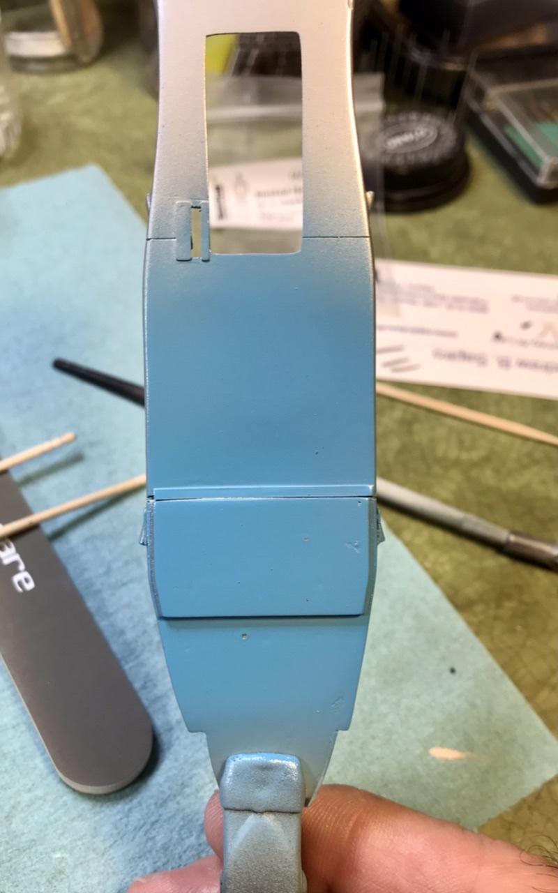

I like the idea of hi-liting w graphite - gracias - initially airbrushed gunmetal over the blach resin - will add some hi lites later - used the MRP paints gun metal - which is marketed to the military guys ….   They also happen to offer this nice shade of sky blue …
