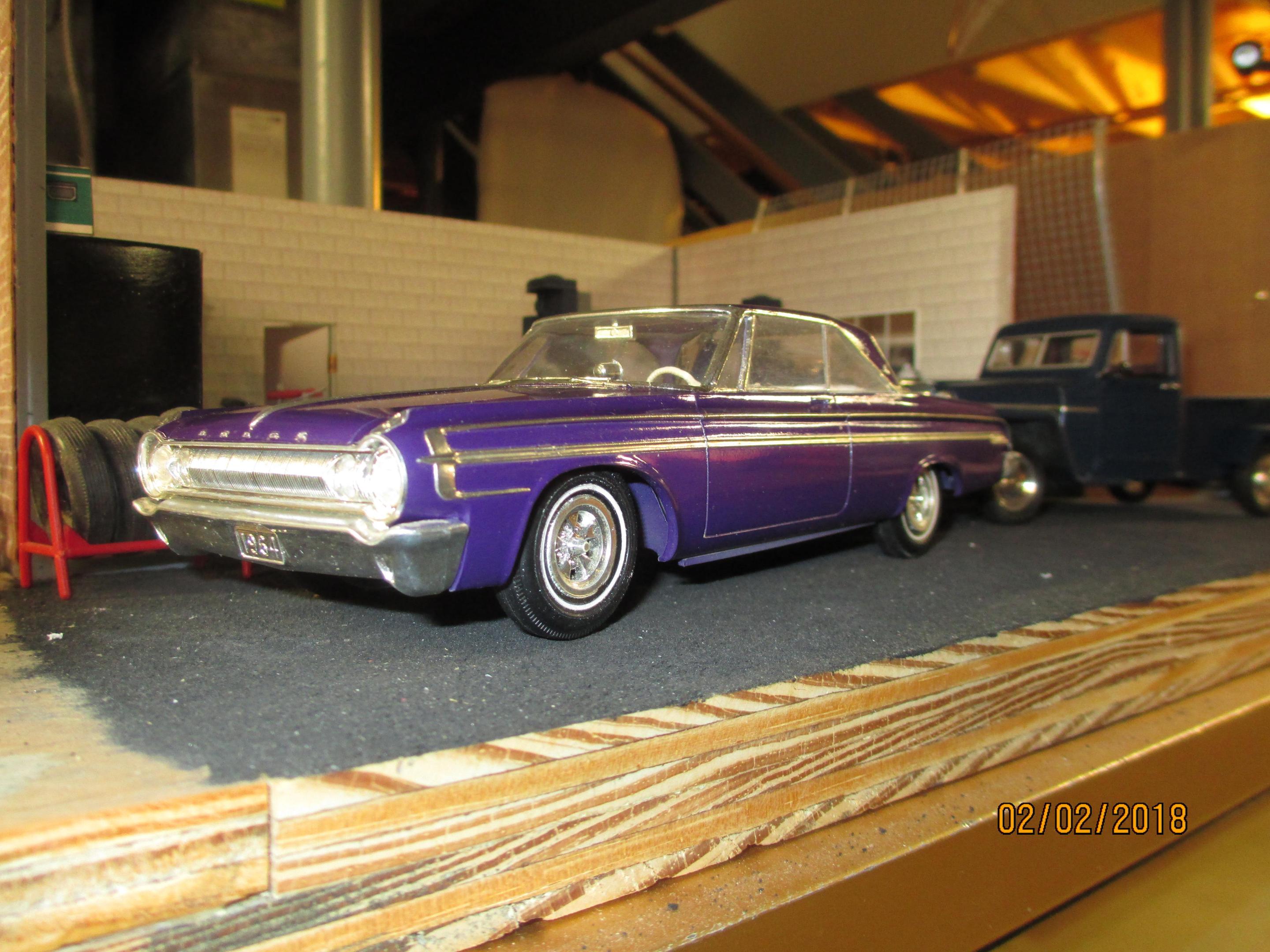

Here you can see what I started with.
This is another Dodge that I used for the mold.

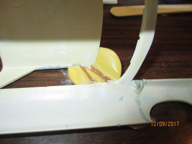

What I used is Amazing Mold Putty that I got at Micheal's craft store.  It's a two part putty that you mix 50 50 and place it over what you want to make a mold of.
Here you can see the results of making the mold.  It only takes a few minutes for this to harden up so you can use it.
Now, here I taped the mold to the broken body.
Here you can see the fingernail resin that I use to fill in the mold.  The resin I got at Sally's Beauty Supply store.  It's a powder and liquid that you mix together to make the part.  This liquid has a real strong smell and should be used in a well ventilated area.  This cures pretty quick.  I made a few passes with the powder and liquid until it filled up the mold.
Here is the results after the resin sets up.  There is some clean up to do and it is pretty easy to do.  This resin is hard but is easy to work with.  At least for me it is.
Here it is after clean up.  Looks like the original.
After priming, you can't tell it from the original.  That's about it fellas.  I hope this helps someone in restoring missing parts.

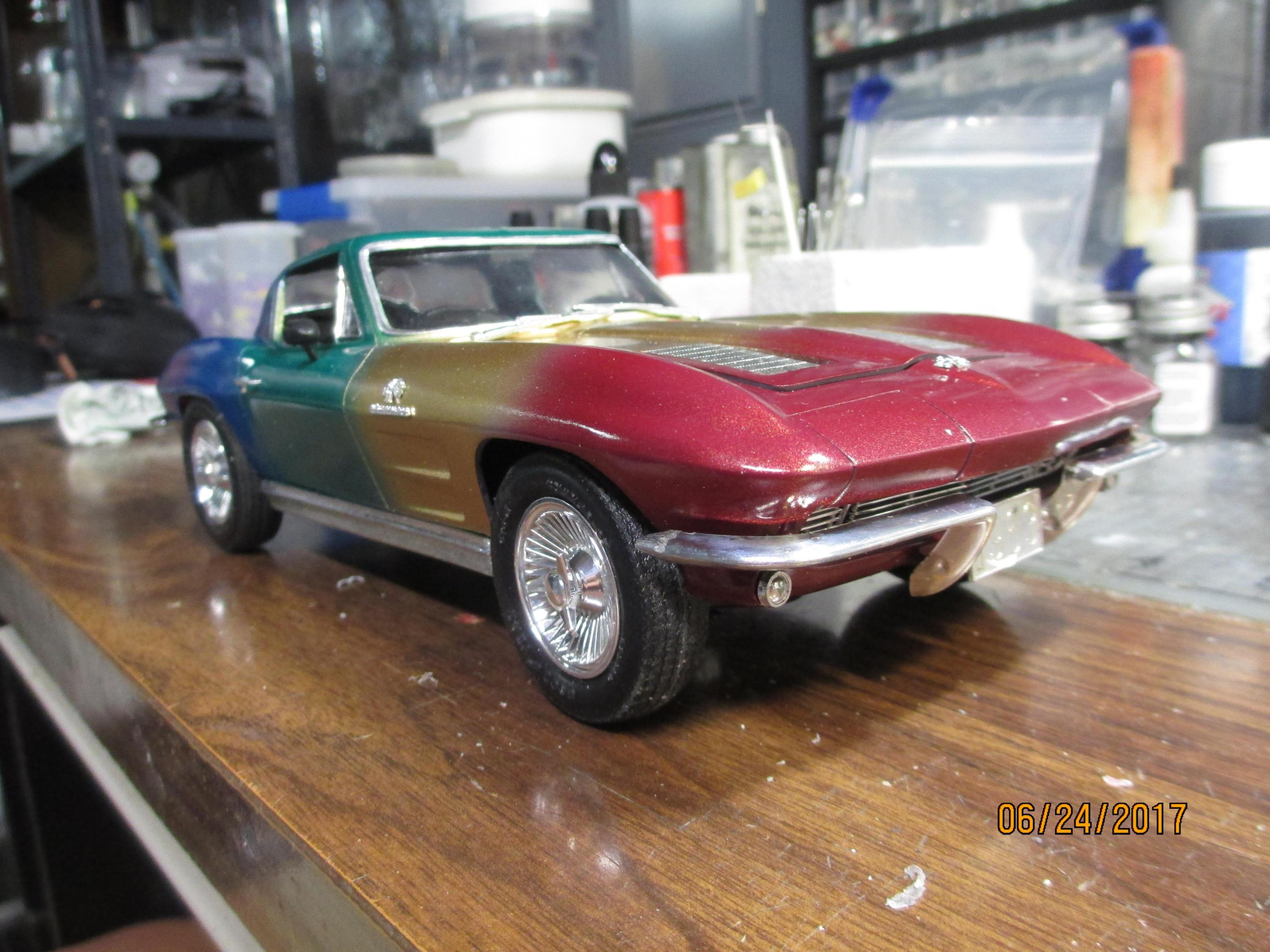

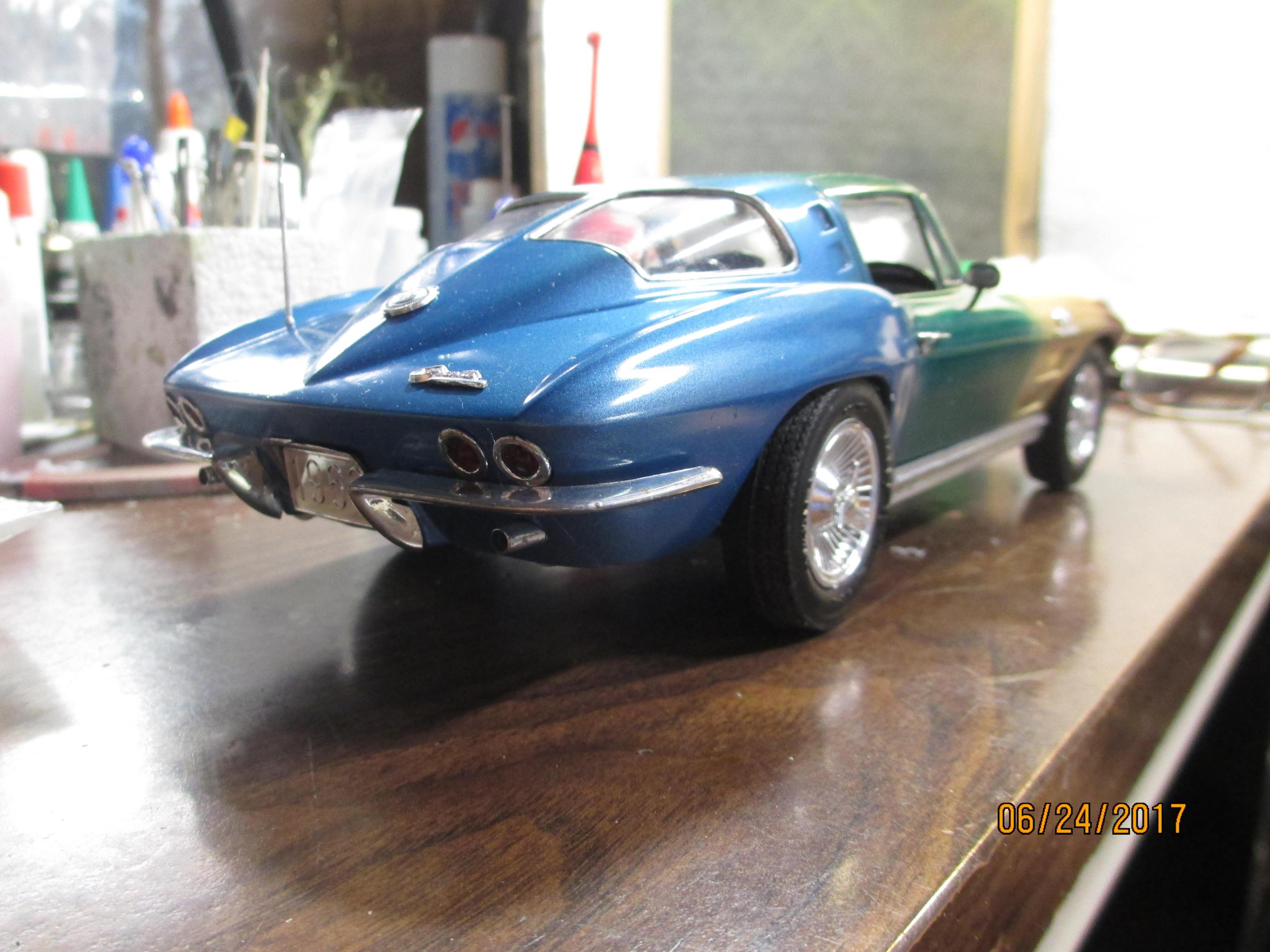

Thanks for all the responses guys.  For me this stuff works great and it is strong.  It bonds very well to the plastic.  This stuff is almost like the dental resin, just a tad different and not so potent as far as the smell goes.  It does have a good smell to it though.  Here is a couple pictures of the fender wells of a 1/16 Corvette that I used this stuff with and I'm very impressed with how it turned out.  I'm really sold on this stuff for repairs.  The last picture is the car as I rebuilt it and painted it the same as it was before.  Dan

Thanks guys and thanks Ricky for the explanation.  In the case of the Corvette fenders I had to add the resin and liquid a few times to get the results that I wanted and you can see in the last picture of the Vette , the repair looks great.  You can't see the repair.  I was very happy with this result.  Sd with anything you have to experiment and have a lot of patience.  The ending result is amazing in my opinion.  Dan
