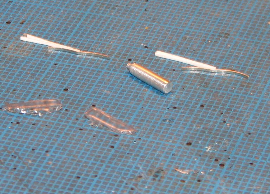

Speaking of marker lights...Here's what I did with them, and how I did it. I hope someone finds it useful! I began by measuring the recesses of the molded-in lights. In this case, they were 5/64" by a scant 1/4". Anyhoo... This first shot shows what I was hoping to accomplish, and the tools I used to do it. The files pictured are a square mini-file, a small square file and a small flat file. I also used a pin vise with a #72 bit and an X-Acto knife.
I began by drilling a series of holes along the inner perimeter of the marker/turn signal, being careful to stay within the lines, to avoid having to perform extra bodywork.
Now, using the knife, slowly and carefully begin to connect the holes, opening up the entire recess. It cannot be stressed enough to be deliberate and cautious and stay within the lines...IMG_3919.JPG.8c5fb9968b9c06cf426c9ea8c30b879a.JPG
Continue working the knife until the marker opening looks like this (except probably not so blurry!):
Begin working with the files to fine tune the opening. Square the corners, and straighten the ends and sides of the opening, until you are satisfied with its shape.
Next, cut two small sections of thin sheet, to back up the newly opened holes.
Install them inside the body. It may be helpful to curve them, to improve their fit. The red arrow points to the backer installed on the far side of the body. Also visible here is the lens itself, being fitted.
I used a tab I removed from an amber sprue. I then sanded the ID numbers off and polished it using those three-way polishing sticks. The reflective inner surface will be created using the foil from a cigarette hard pack.
Next, I cut the amber "lens" to size and smoothed the edges, and tested the fit...
After a bit more fine sanding, the lens fits the opening, almost perfectly!
Finally, I popped them out, cut the foil to size, and dropped it in, behind the lens. It was a fair amount of work, but, I'm happy with its appearance. This effect could not be achieved using paint. Since this is a curbside build, I want to create as many interesting details that I can, in order to generate "interest" in the subject. I am considering ways I can do something similar with the head and taillights.

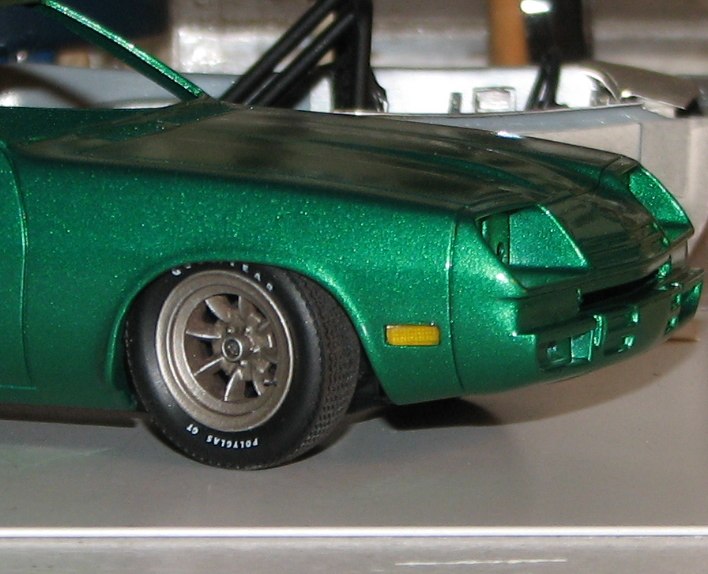

Thanks, Dan! I was hoping that trick would work! Here're a couple of shots with primer. I can't believe I got them to fit so nicely.
Wow, that is some attention to detail.  Overall build has that racy look, really like what you are doing.
Real nice, well done looks like it should look.
