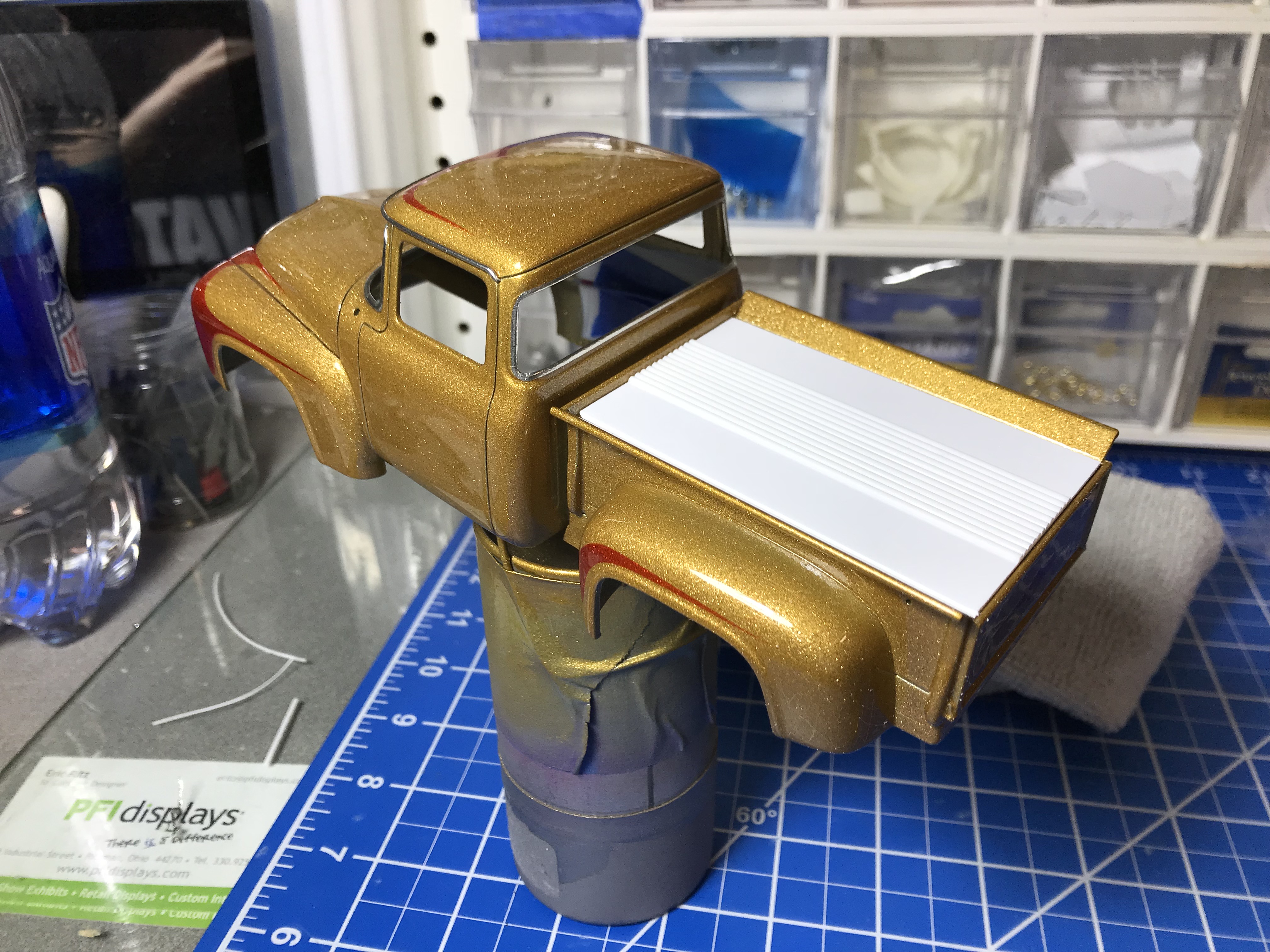

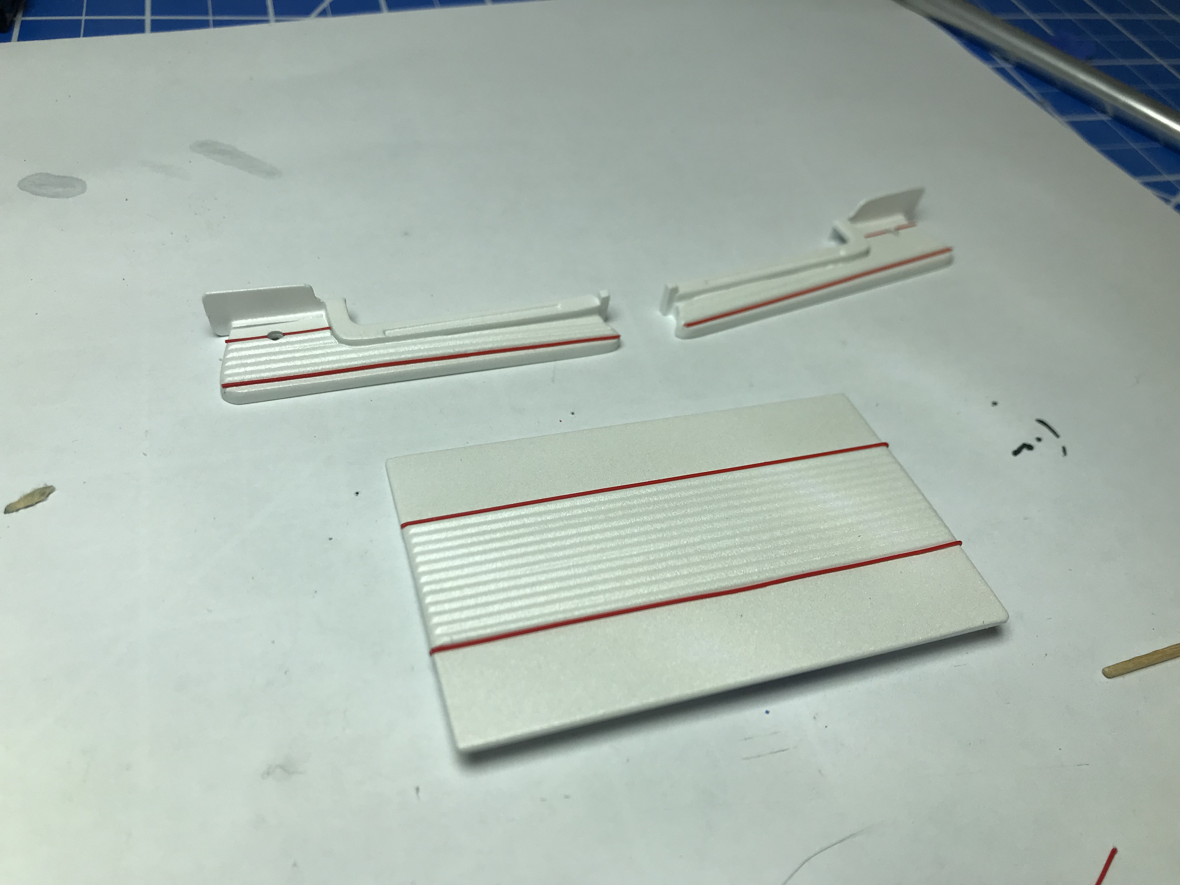

Worked out some minor body modifications.. (shaved handles, fuel filter and wipers, filled bumper holes front and roll panned the rear) I attached the body to the bed, and then separated the running boards, they will be white tuck-n-roll like the tonneau cover.  The hub caps and tires are the 1/24th scale items from the 58 t-bird... the slightly oversized tires seem to fill the oversized wheel wells nicely.

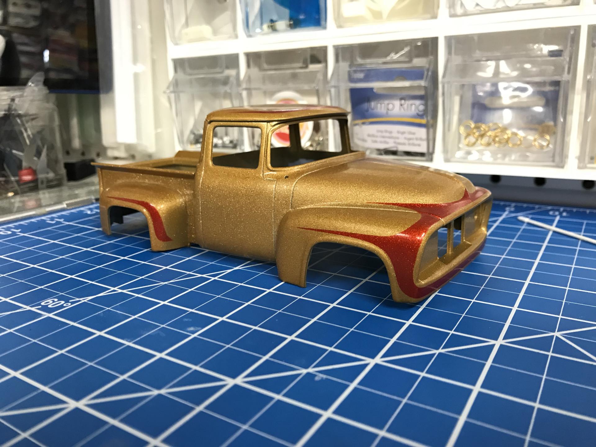

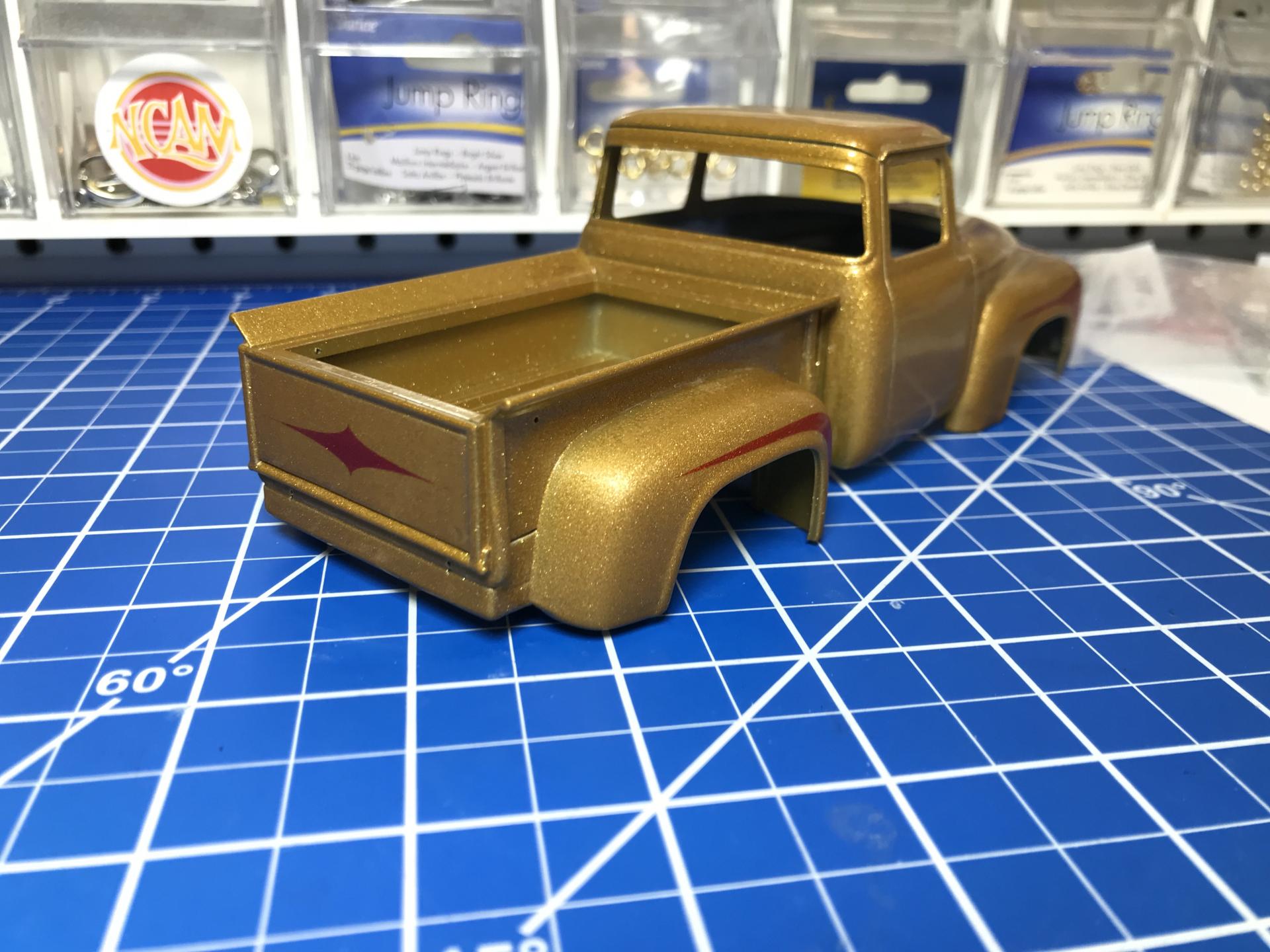

Next up was some testors pure gold as a base coat....   followed by a few coats of .002 gold flake from TCP Global in a carrier clear..
Finally some urethane clear to make it really sparkle.
Edited by Impalow

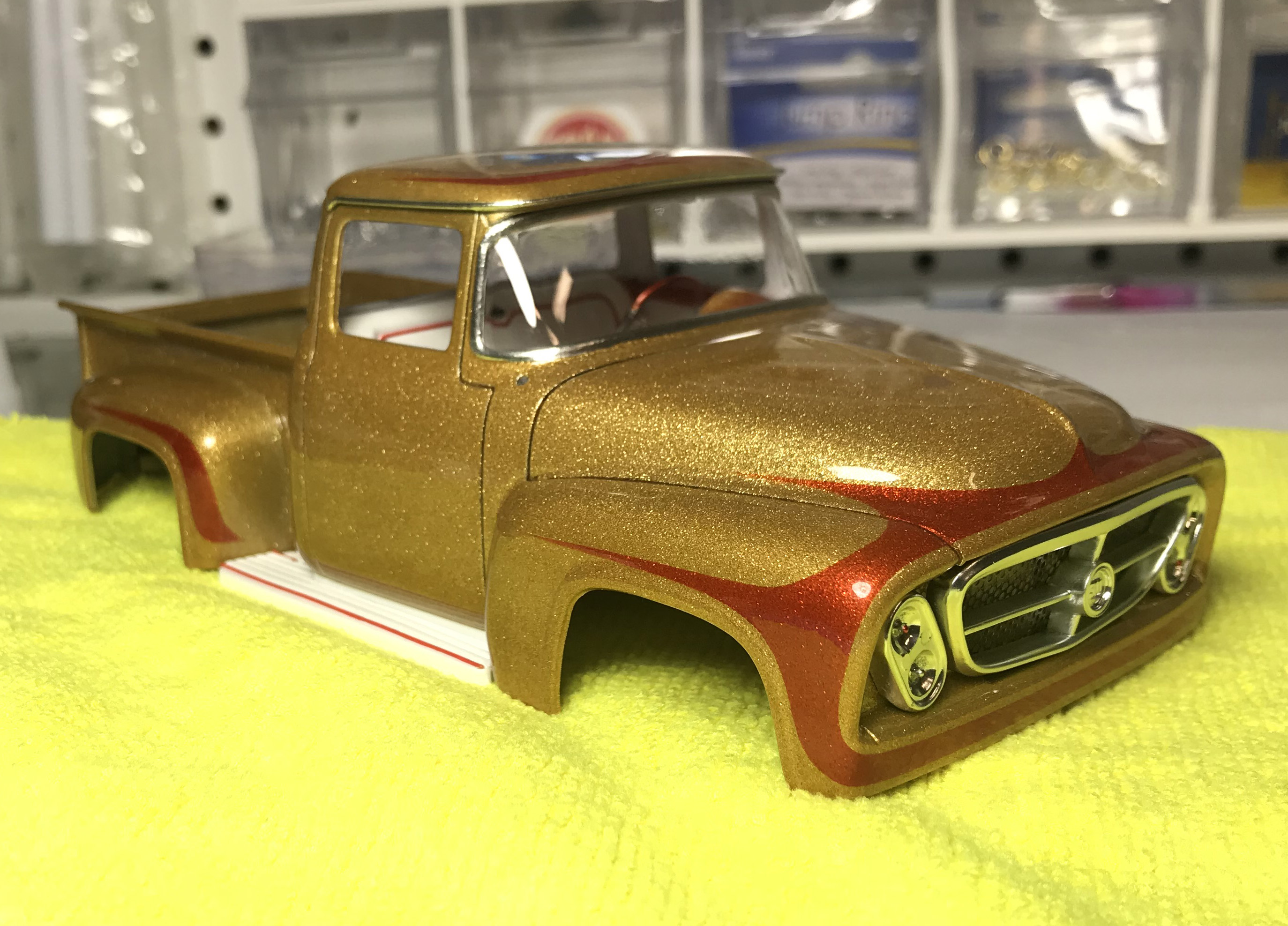

Sand all down with 3000grit and then came the scallops...  hand masked with some 1/32" FBS Micro Tape...
Tamiya clear red thinned with lacquer thinner.
All done and ready for some more clear

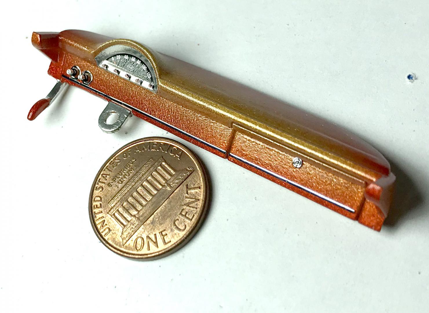

Can't forget about the dash....  more interior photos later, that will be the next day or 2.
Sweet! Love it so far!  Great idea starting with the Foose body, which has already had some important modifications made, like the front wheel arch re-location.
The paint is punchy and the scallops look period-perfect.

Then I knocked out a quick pleated tonneau cover... Flat stock and some .060 half round for the pleats.

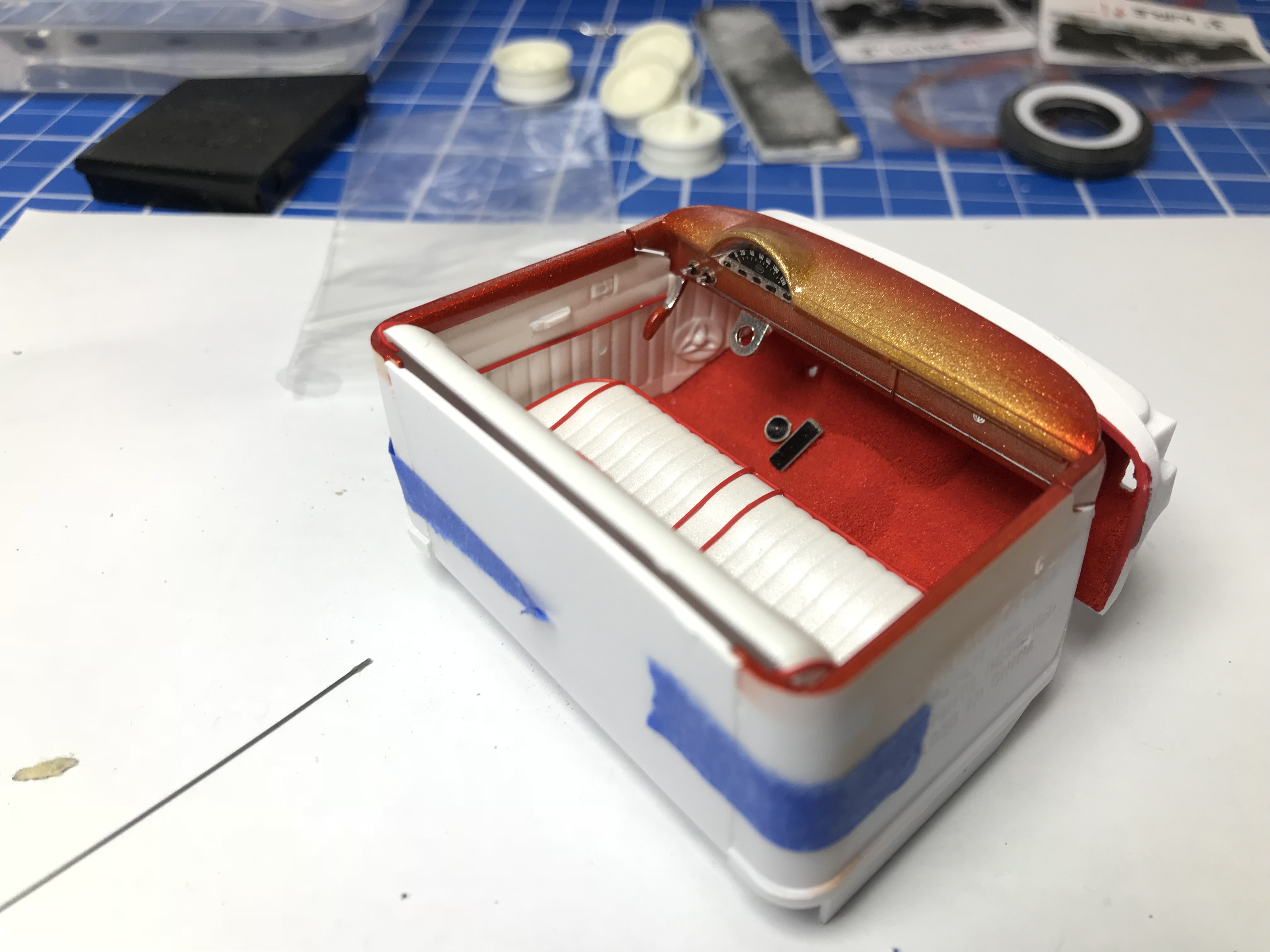

Mocked up the interior.. Pearl white paint really took this back a couple of decades... Thinking the red piping will make it pop quite nicely, the red carpet was done with embossing powder.   Im going to use some Replicas and Miniatures door handles and window cranks to further backdate this thing.

Making more progress...  got the dash all detailed up last night....  more updates soon... I would like to have this done next Tuesday for our club meeting.
Thank you Jim and Jonathan!   Lay'ed about 3ft of piping last night!   Took some time, but the results are well worth it.
IMG_7411.thumb.JPG.1b322ff3c7bddf0a39c16a439b12f8a5.JPGIMG_7412.thumb.JPG.a95f97975341391afca39a6bc507f38e.JPGIMG_7415.thumb.JPG.2941fd968f3768267bdc3c01e9e3bd69.JPG
2 hours ago, bobthehobbyguy said:
Nice work on the interior. What glue do you use for piping? What is your process for gluing the piping?
Thanks Bob!    I use the Bob Smith Industries - Super Gold CA Glue.. Its the foam safe stuff, which doesn't really matter to me, but if does not fog at all...  so no chance of white frosty piping.    I put some in a spoon, and use a piece of .025 piano wire to apply it to the red wire,   then i press it in place with the blunt end of a toothpick...  just slow and steady about 3/4" at a time unless its a long straight piece.
The hardest part for me is keeping my big dumb fingers from pressing it down,  if you do that the glue oozes out and you get fingerprints.... always using the toothpick helps.   If you do get to much glue on it, the worst thing you will see is a bit of glossiness around the piping,  you can get rid of that with a final coat of matte or flat clear after the pipe. .. luckily i didn't have to do that on this build, the pearl white helps hiding things... its pretty forgiving.
Once you get going and develop a technique, it actually goes pretty quick..  I really enjoy the process and how detailed it makes the seat look.

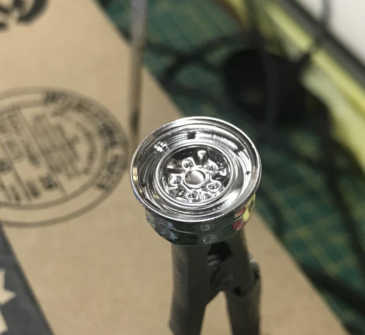

I also decided to go with chrome reversed wheels, red candy centers and spidercaps,  so the first step was to molotow chrome some steel wheels.
