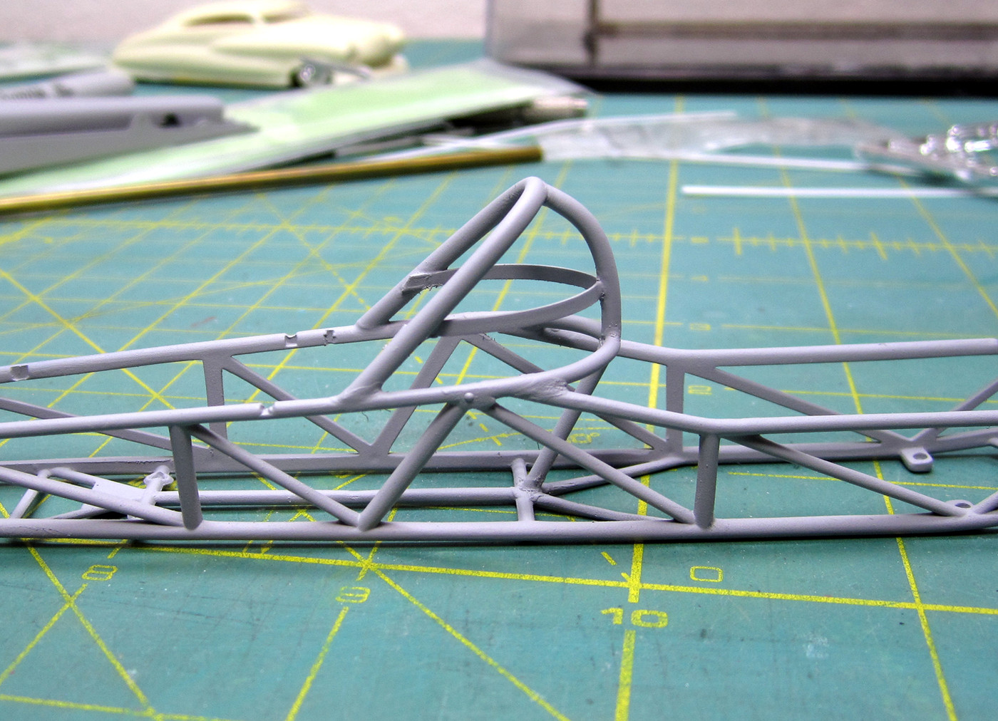

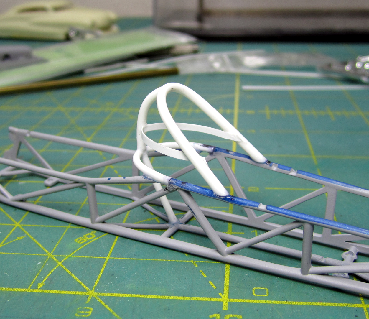

Hello Fellas... I think it is time for an update. I have done a little more work to the Goose's Chassis. I wasn't 100% happy with the kit roll bar and didn't like that one of the chassis tubes was molded into the rear seat. So I decided that changer her up just a tad. She isn't perfect but good enough for me, I still need to clean the joints up and hopefully be ready for paint after that. Here are a few pics....
Here I just used some Evergreen Styrene Rod to make my parts:

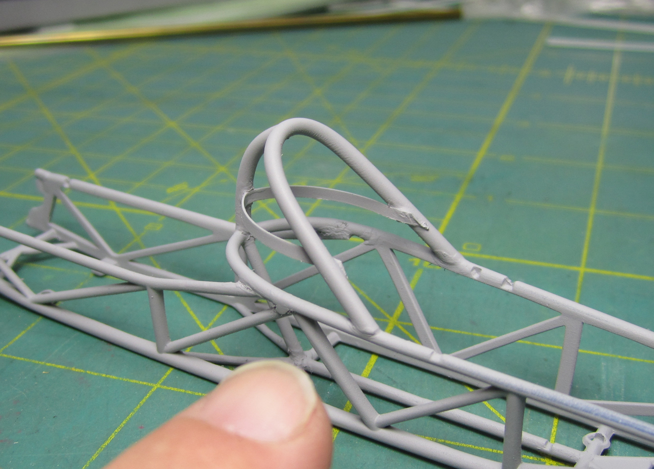

Next I was able to shoot some Tamiya primer on it to see how much more I need to fix the joints.... and I learned it needs a lot of work...lol:

Nice! How to do you bend your styrene rod? I don;t see any obvious heat marks.

Bernard... Believe it or not I actually used a hair Dryer to heat the tube up and I used various Items to wrap the tubing/Rod around to get the shape I was wanting. I tried a lighter at first to heat it and had major failure doing that...lol
I need to get in gear and get back to mine! Looks like some nice cage work Chris. Time to get that baby painted!!
Thanks Clay.... I need to do a little more cleaning up and then it will be ready for paint. Hopefully it eint take much. Maybe I will get lucky and be able to get some paint on it this weekend :D

One thing I"ve always found that works for shaping small pieces like this is to use a small block of wood that you can measure and draw out your shape, tap in some brad nails to use as a jig and go about shaping your piece. The hair dryer trick definitely works as it"s usually hot enough to soften but not hot enough to melt.

Wayne... Thank you very much,  I never though about using a block of wood with some nails. That's a great tip, Thanks. I found when I was trying to use a Lighter that the rod and tube would get to certain point and basically melt it so that's when I decided to give the hair drier a try and it seemed to work pretty good.

My question is how did you get the pieces to stay together. I'm trying to just do the roll bar without the head restraint....I can glue it but its temporary at best.
Mike... I just glued the roll cage to the chassis with Weld on #3. So the rear hoop on the chassis that I added that the seat butts up against I actually drilled  a .020" dia hole and added a .020" dia brass pin. I glued that hoop first and then I made the main bar for the cage then the back bar. I glued those in place before I decided to add the little flat bar for the head restraint. After I let the Weld on #3 dry I went back around each join with some Zap a Gap CA glue.
